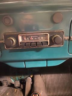

Mine is a 1967 6v.
It has a 'Le Chaperon' AM radio.

This is a period radio but not typically stock for a VW as far as I know.
It's more of a universal radio for all makes/models.
My Bus has a pullout Le Chaperon picnic AM radio, it's kind of cool since you can take it out and it still plays using batteries.

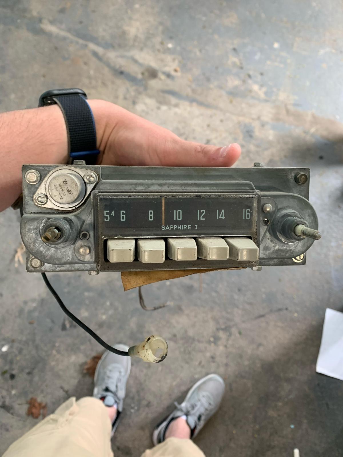

FWIW my original family 64 has a Sapphire 1 still is 6V. I am keeping stock but will clean it up a little. I am using a Redirad to inject modern tunes. The downside though is you still have the single speaker but i am not going for modern sound.
For me the hard part is getting the chrome surround to look good again...

This is my concern, right up with the proper inner workings of the radio is it looking as nice as the rest of the car.
My radio is in similar - if not a bit more worn - condition to yours. I'm a bit worried about the buttons on which the paint seem to be worn down.
Agree about the buttons. Yours are nicer than mine. I will figure out how to remove them and restore them since finding better ones is not only expensive but not easy either. Have already spoken to a few radio guys and they say it can be done but difficult. Worst comes to worst i will 3D print replacements.
Otherwise in talking with radio guys they recommend replacing the capacitors and then cleaning everything with deoxit. I figure i can't mess mine up any more so will give it a go.

Anyone have tips for re-finishing the chrome on the faceplate of these? The middle area is sort of sand cast in roughness. how do you clean these up or even re-plate them?

If the chrome isn’t all pitted and crusty, you can scrub it good with a brush and citrus de-greaser, the follow up with some chrome cleaner/polish.
If the chrome is really shot, it’ll need to be stripped and re-chromed by a plating shop. This will be pricy for such a small part, so it might be better to just buy a nicer one from here in the classifieds.

Or alternately, clean it, and paint it using a so-called "chrome" spray paint, clear coated for protection. It's won't be chrome, but it will look clean and bright.

I haven't found any chrome spray paint which makes metal or plastic look anything more than dullish gray. Do you have a good product you recommend?
