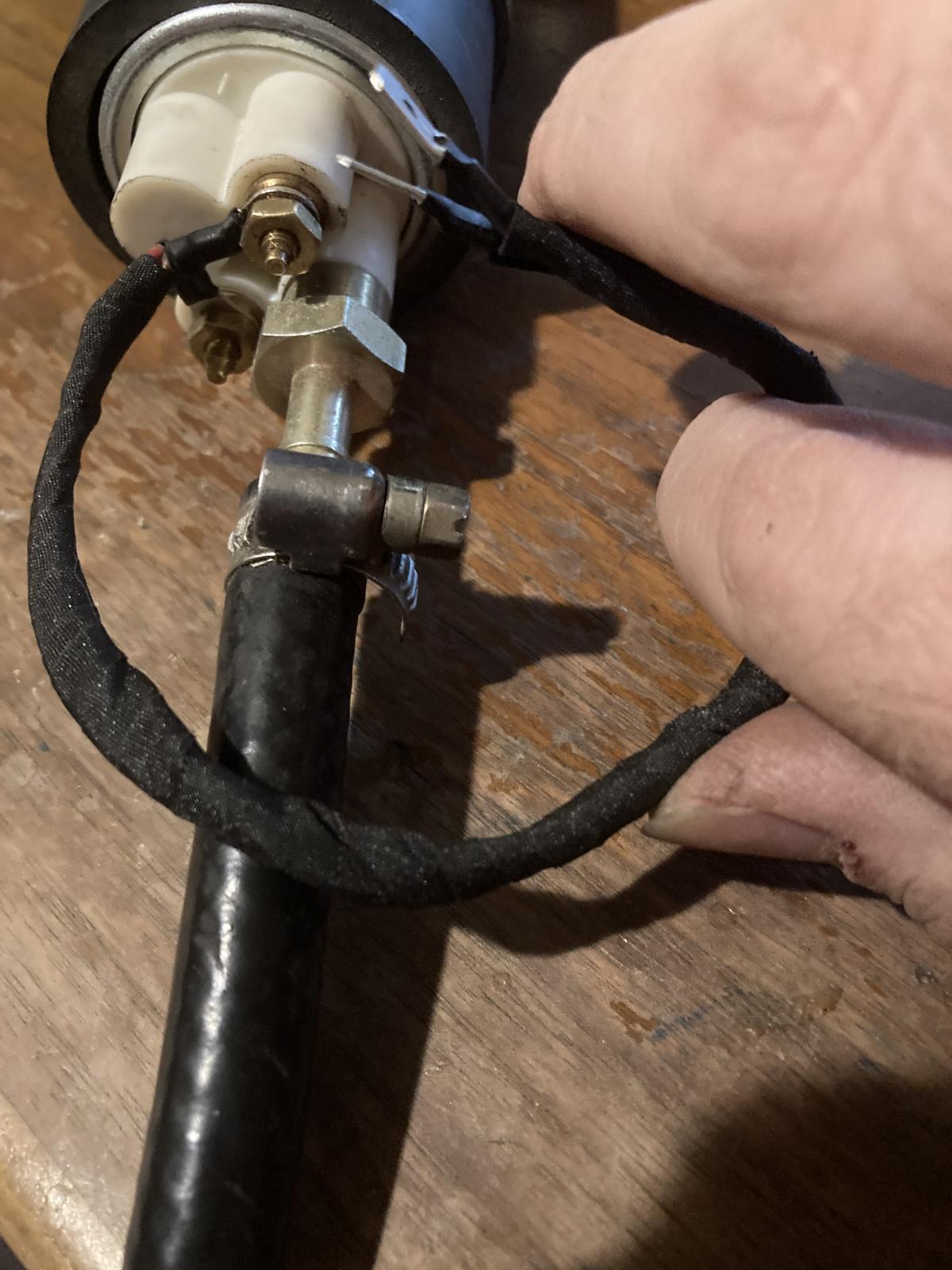

Plan was to remove the tank sender to do a quick inspection and this happened... Apparently the EvapoRust depite being well used and weak did its job converting corrosion.
https://scontent-lax3-1.xx.fbcdn.net/v/t1.6435-9/1...e=60C9C7B7
https://scontent-lax3-1.xx.fbcdn.net/v/t1.6435-9/1...e=60C81D3D
The tank doesn't look bad, especially the pickup bowl, just need to pull the tank and clean.

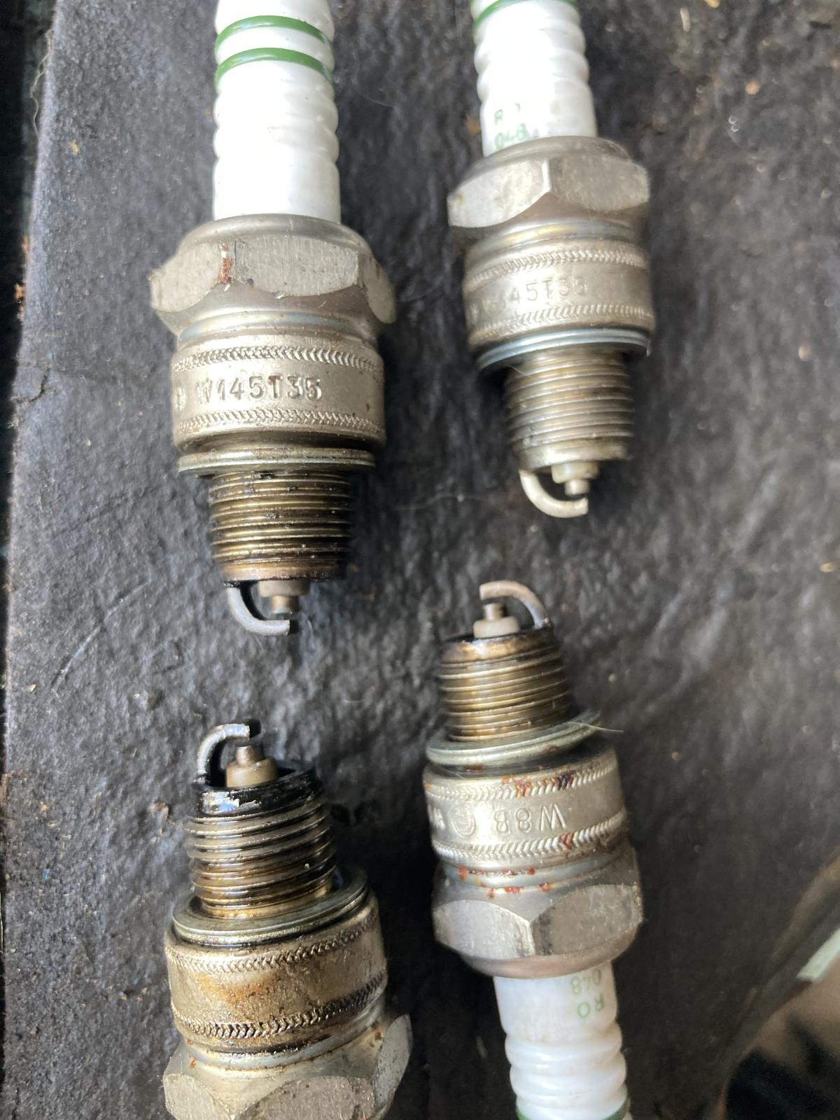

Spark plugs removed, SiliKroil in the cylinders removed, spark plugs and their leads installed, injector's leads connected, points removed, points got filed, points installed and gapped using German metric feeler gauge, and ECU put back (removed when welding).

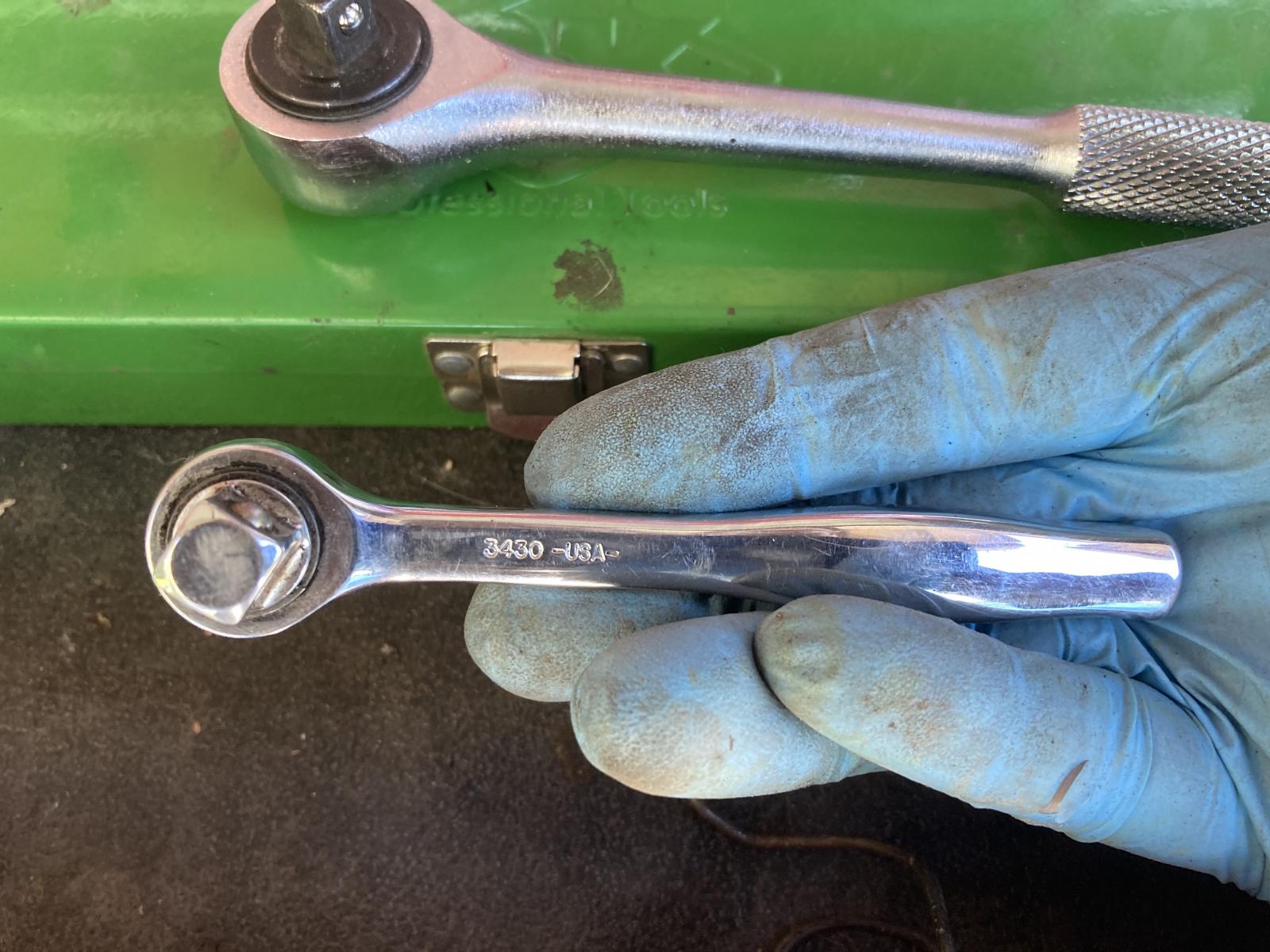

Had trouble with the top right exhaust nut, and remembered that took half the time. I was able to remove the pulley from the shroud, and tried pulling the fan. Instead, the shroud started spreading.
While working, came up with an idea to get at that troublesome nut: 3/8 drive socket (way smaller than the half), and an extension. Came right out! Got the left top out the same way, and loosened ….

Seasurfnbird wrote:
This solution! I’m going to try this on my 67’ Squareback. Installing a stock exhaust and the passenger side upper heat exchanger is in the way of my 13mm socket to tighten the upper cylinder 2 exhaust port nut to stud.
Maybe I’ll try a 12mm nut. Only a open wrench 13mm can barely get around it but virtually no leverage area to tighten it! This is still in the vehicle on a dirt ground, so not ideal but it’s all I got. I realize this forum was a while ago but thanks anyways!
I hope this helps and get it on.
As for working on soil, so long as no gravel, not too bad. Done a lot of that, still do now and then. A big piece of cardboard helps, partly as not getting grit into everything.
Speaking of getting into tight spaces, I absolutely love this Wright Tools ratchet. The size of a 1/4" drive with a 3/8" drive. Less money than a set of 1/4 inch drive sockets, especially as rarely needed. I also use it where don't want a lot of torque, like today the oil pan nuts. As a bonus, feels great in the hand. Maybe it get to the nut with leverage?
