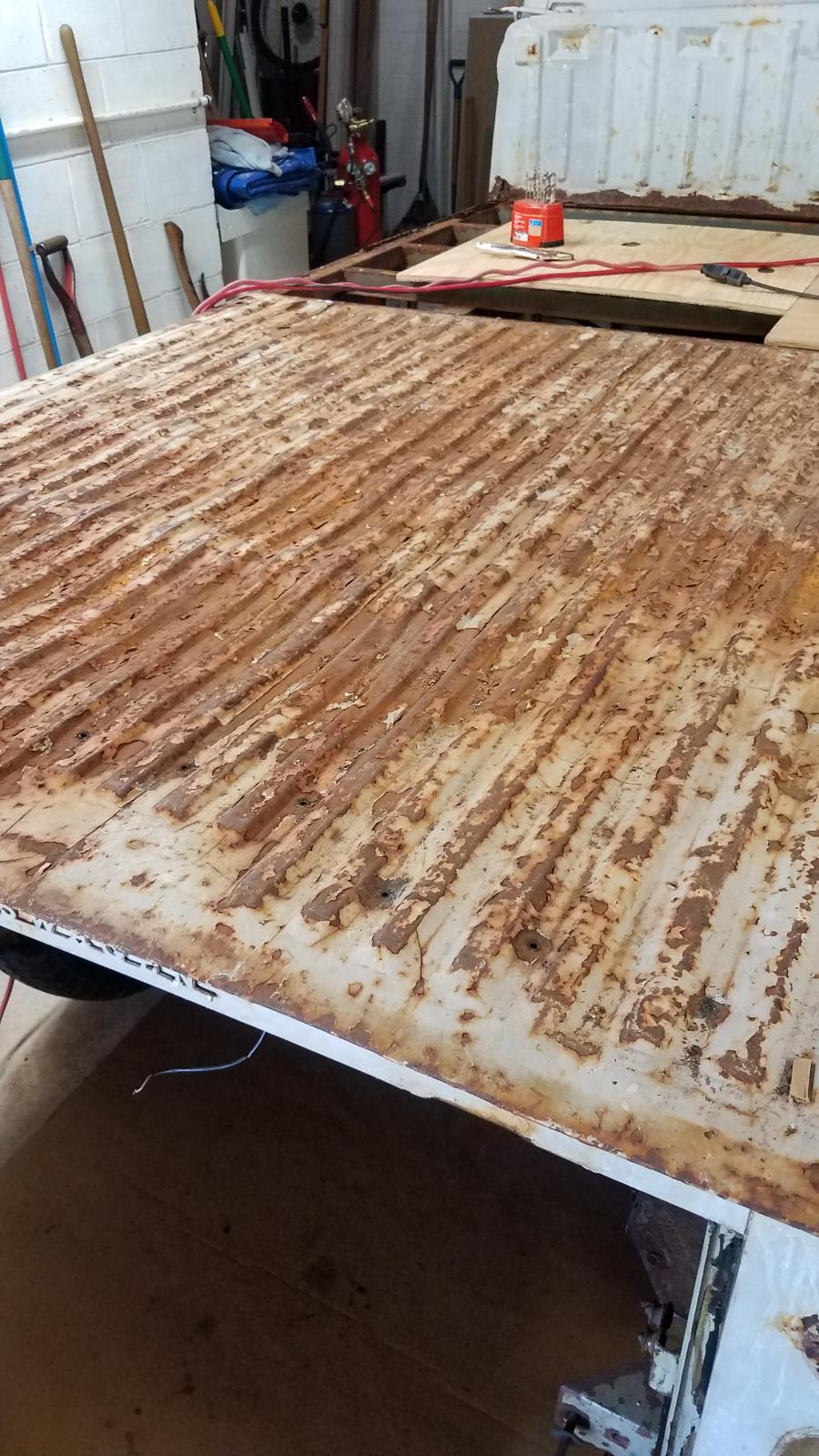

Removing the load bed made getting to the rust so much easier. Crawling in to the treasure chest area isn't easy and I have 2 doors to get in to it. I couldn't imagine restoring a SC with only one door , I'd have to cut a hole in the other side.
Had to cut the load bed where it meets the bulkhead because the bulkhead goes on top of the load bed. Load bed gets installed first then the bulkhead.

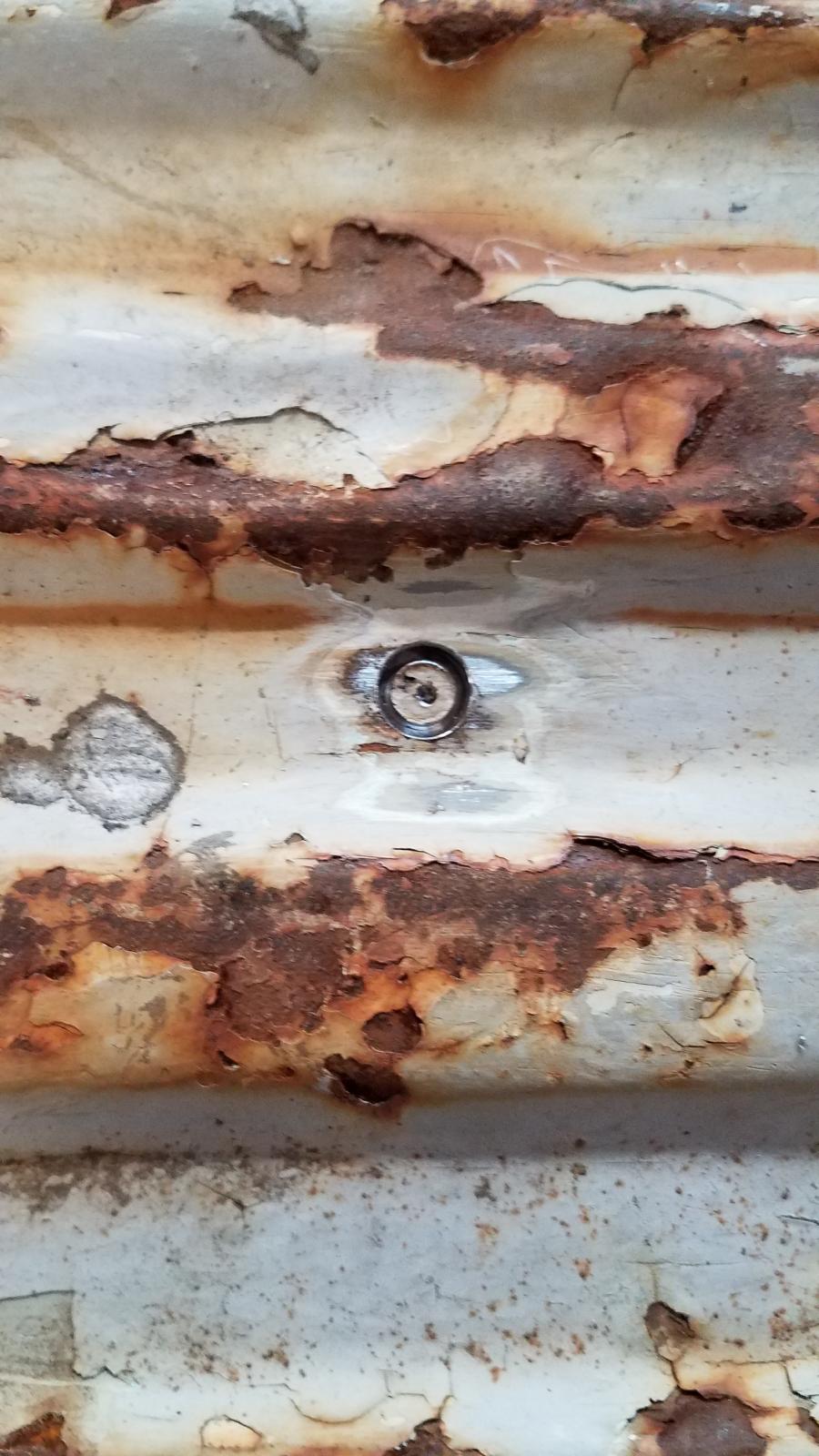

I used a spot weld remover/grinder from Eastwood that I have had for a long time. It is very important to drill a pilot hole in the center of the spot weld with a 5/64 or 3/32 drill bit. You have to start slowly at first then pick up speed when the circle is halfway through the metal. I think there were 230-250 spot welds to free up. Also important to see the spot weld, I use a fiber wheel/disk to clean the paint off so I can see the outer circle of the "spot".
Damage /rust that I will address soon

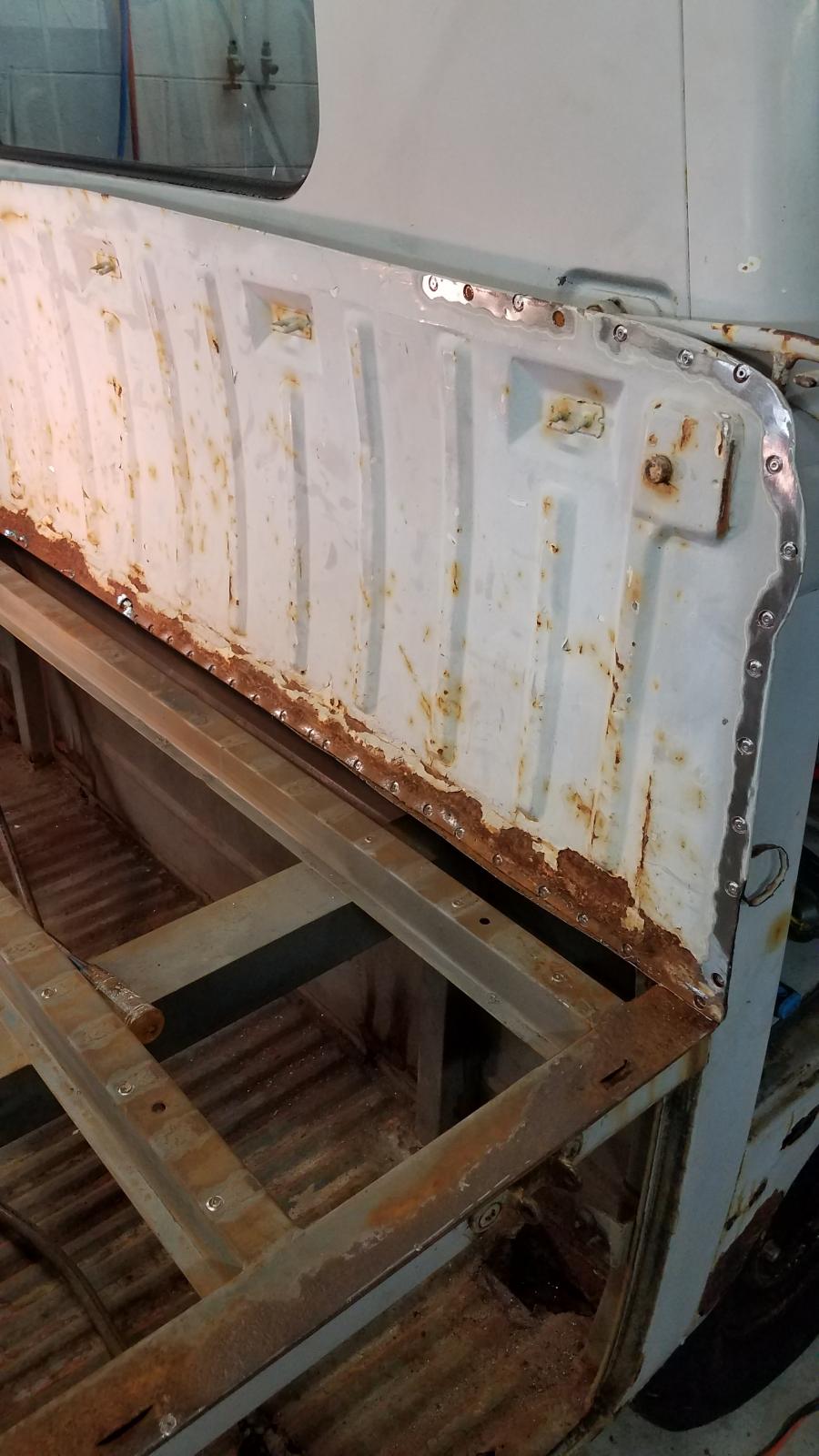

Bulkhead removal

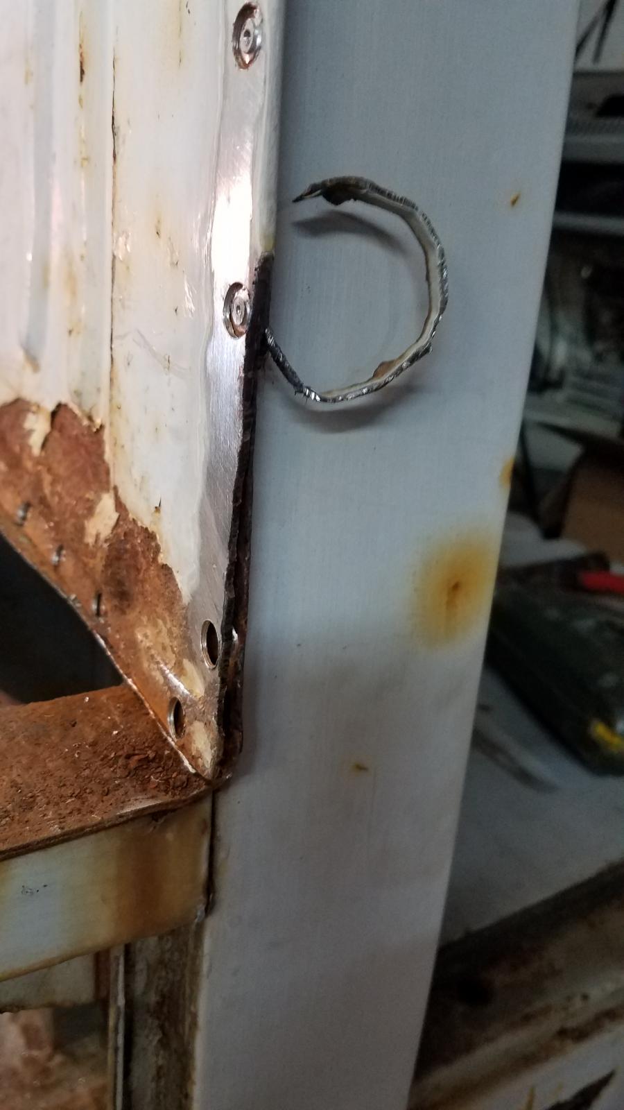

Peeling off the edge by grinding. Takes some time but it seems like the only way because of the window panel an inch away.
Finding all the spot welds is a challenge. Sneaking a putty knife in between the panels being welded together helps locate the next "spot". The top section had a high row and a low row with no repeatable pattern, makes you earn your money.
The hammer is for the putty knife.
Mission accomplished

PostPosted: Thu Jun 10, 2021 9:54 am    Post subject: Re: Rusty 65 SC restoration Reply with quote
For those spot welds I use an extremely sharp hatchet and hammer to work down the line. Light hits until you get one then drill out.

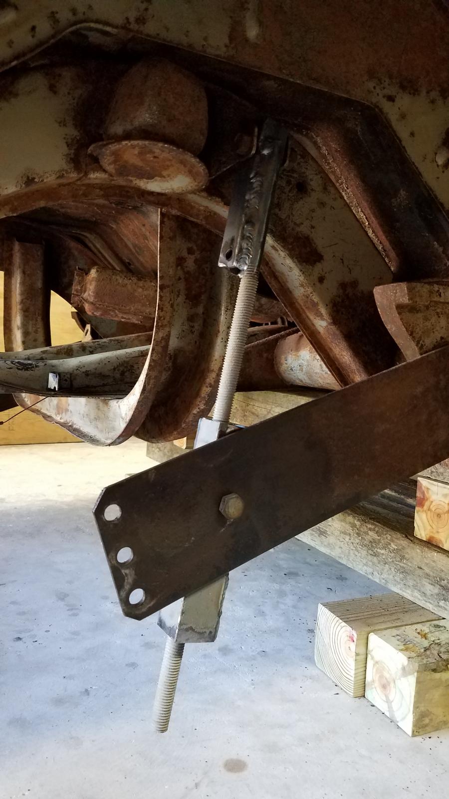

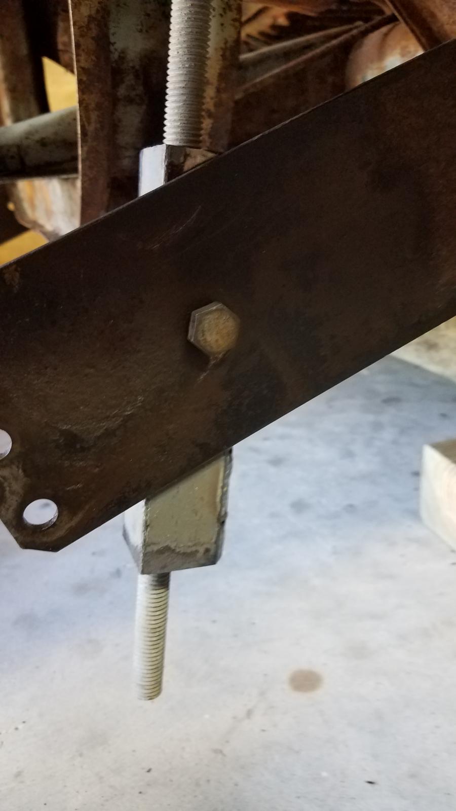

Pulling the transaxle off so I can start building the rotisserie. I didn't have the tool that the Bentley book showed so I made one.
Used a threaded rod that was welded to a bracket that was bolted through the shock mount. Then tapped a hole in a square piece of steel that then bolted through the torsion arm. Slid that over the threaded rod and had a bolt and washer to start raising the arm. Worked like magic.
Ground the galvanization off, I read that it wasn't to healthy to breath the welding vapor.
Final product, probably need it for reassembly. Need to put it some where I can find it in a couple years.

Is that tool so you can remove the spring plate?
Kb65single
Joined: July 24, 2019
Posts: 340
Location: Obxnc
Kb65single is offline
PostPosted: Fri Jun 11, 2021 4:43 am    Post subject: Re: Rusty 65 SC restoration Reply with quote
Yes it is. The 63-67 Bentley manual Section H-10 page 2 has a picture. Luckily VW drilled a 4th hole in the spring plate for securing the front of the reduction box to the spring plate. That helped hold the tool in one position. The Bentley tool looked like it might have the ability to slide so I included the bolt through the spring plate. The shock mount bolt goes through the tool at an angle so pay attention to that if anyone is considering making one.

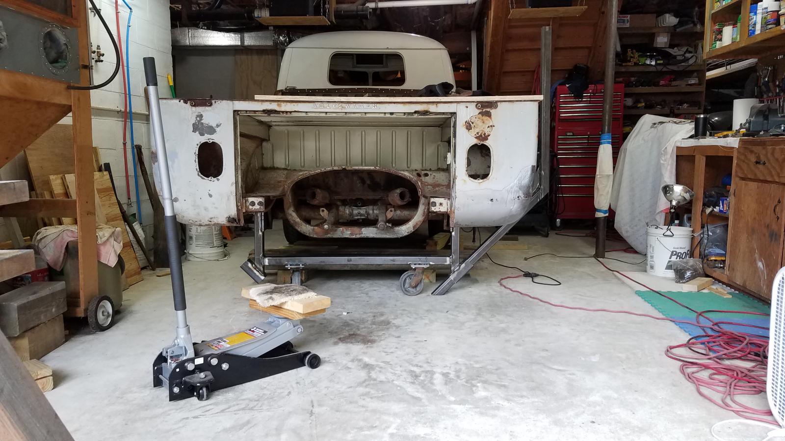

Trying to figure out what type of rotisserie to build is a challenge. I searched through the internet and the samba. The size of work area automatically eliminated a Glideking type of rotisserie because my garage door opening is 82 1/2 " tall. I had to be able to move it in and out of the garage to sandblast and get out of paint and welding fumes and enjoy the good weather every so often. My opening was 117" wide so that was good. I've never restored a bus before which made choosing difficult. Being 64 years old poses all sorts of challenges that the younger crowd doesn't think twice about. Just common sense told me that turning the bus on its side would make it easier to work on. I finally narrowed my choice to the Jimb0w design. No height problems and tipping it from one side to the other requires minimal effort. Here's the link for the design and measurements Thanks Jimb0w.
https://drive.google.com/drive/folders/1U2rrXX19iUVmOLirkAxg0nYiwSPcdXSS
I started on the arms that the rotisserie tips on. The bed of the SC turned out to be a handy surface to work on.
Screwed strips of plywood to create a repeatable pattern since two arms are required
Clamping before welding
Welding the joints
Cutting the reinforcement metal with a sabre saw
Welding those in place
Now I can move on to the sections that attach to the bus.

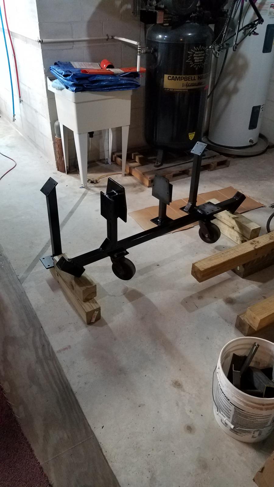

PostPosted: Sun Jun 20, 2021 2:25 pm    Post subject: Re: Rusty 65 SC restoration Reply with quote
I started on the rear section of rotisserie first. It's best to look at the drawing of Jimb0w's design while reading this, it's hard to explain without having the dimensions in front of you. I leveled the bus from front to back and side to side first. ( My garage door opening was 82 1/2" so I set the bus height at 79"). Then cut out and drilled holes in the rear plates that attach to the bus. I used Sgellis's rear plate design they were excellent thanks. Sgellis,s rear plate moves the cart more toward the center of the wheel well which gives you more room to work in the front of the wheel well. I bolted the plates to the bus parallel to each other. Parallel is important because getting the cart on and off is impossible if you don't ( I found out the hard way). I attached my wheels to a 2x4 ( with a 1/2 inch strip of plywood screwed to it, steel is 2x2 boxed 1/8 inch thick) so I could determine where they needed to be welded to the 421mm piece. I did not change any of the lengths of boxed steel in the drawings. I did need to slide the 1150mm piece down because Jimb0w's wheels were much larger than mine.
Plate bolted to the bus
Mocking up to verify where to weld wheel height
laying things out
welded all together
painted black
finger got in the way of the sabre saw ,that hurt
installed rear section of Jimb0w rotisserie. On to the front

Just a note this will be easier to follow with Jimb0w's drawings. I included the link in a previous post.
Things I would do different on the rear section would be making the horizontal pieces that stick out of the wheel well removable. This would eliminate thigh and leg cuts and bruises while passing by. Would also make the 4x4 plates that bolt the arms to the cart larger. 4x6 would be better, that would give you more room for placing the bolt holes. My weld width got in the way of putting a socket or wrench on the bolts. I had to grind off some of the weld to tighten the bolts properly.
Now on to the front.
Jimb0w's wheels were 300mm (11 1/2") tall, mine were 7 3/4" (200mm) tall. In the rear axle section it was easy to make the change to compensate for the wheel height change. All I had to do was slide the bar that holds the wheels down approx. 3 1/2". All the dimensions of the pieces stayed the same. The front component of the tipper cart requires you to change the dimensions of some of the individual parts. The front [ 275mm (10 13/16") ] piece was made 3 1/2" taller which helped compensate for the shorter wheels. Increasing that dimension forced the 1542mm piece to become shorter. The cart has to "tip" evenly on both sections. In order to make them match I traced the rear section on a piece of 4'x8' plywood. I just used the tracing to determine the length of that piece (1542mm on the drawing).
I also decided to make one side of the frame attachment section removable. I tack welded both sides in place but it was to hard to get it on and off. Hopefully it will make it easier to not scratch the paint behind it. Making one side removable is so much easier for one person to handle. I also decided to make the horizontal arms that stick out of the wheel well removable. I knew I had to replace the doglegs and I had b-pillar and a-pillar issues. Not beating my head to a pulp made the extra work an easy decision.
Welding the fixed section , decided to add an extra 45 deg. brace
Making the removable section
Fixed side with removable horizontal arm
removable section bolted to cart and bus
Painting the finished product
Had to make a passenger and driver side removable horizontal arm so 4 pieces total.
I am now mobile and able to shake from side to side
