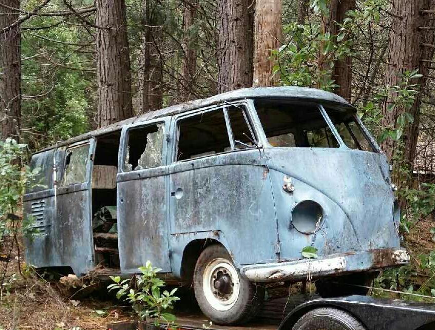

1. 1958 Kombi
Picked this up from a guy in Canada who got it out of the woods of California. She is a bit crusty but will come back to life nicely. Plan to keep it patina. Mechanical restore, fix needed rust, build custom camper interior and drive daily and camp.

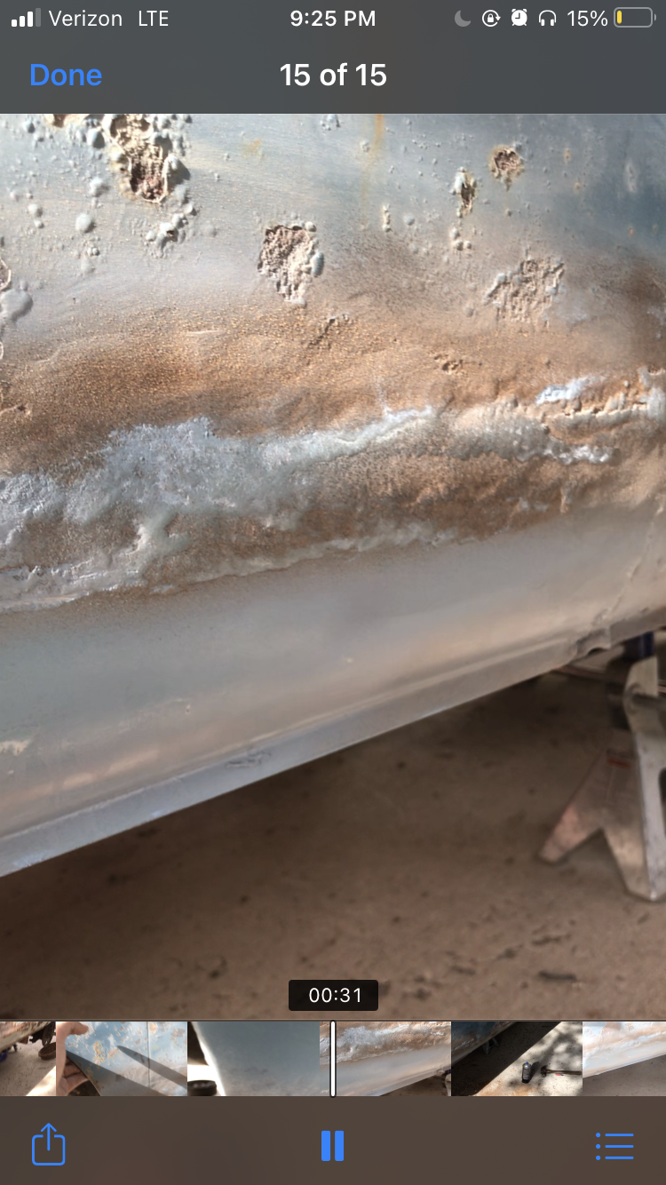

Update today. Installed my first rocker: driver side.
In my years of owning Volkswagens I have never quite learned to weld. Never had to. Each bus I owned was in good enough shape.
Today I got schooled. Welding is insanely challenging. Way harder than the videos and threads make it out to be. So hard not to burn through. But none the less had a blast.
The result is not amazing. But luckily it’s a rocker and the bus is patina. Frame is solid so no fucking around with safety thank goodness. I think if I welded the frame I would die going down the road.
Needles to say happy to be learning and picking up a new tool. Will post some photos some photos tomorrow. Honestly a little embarrassed to post my work. Y’all are masters here.

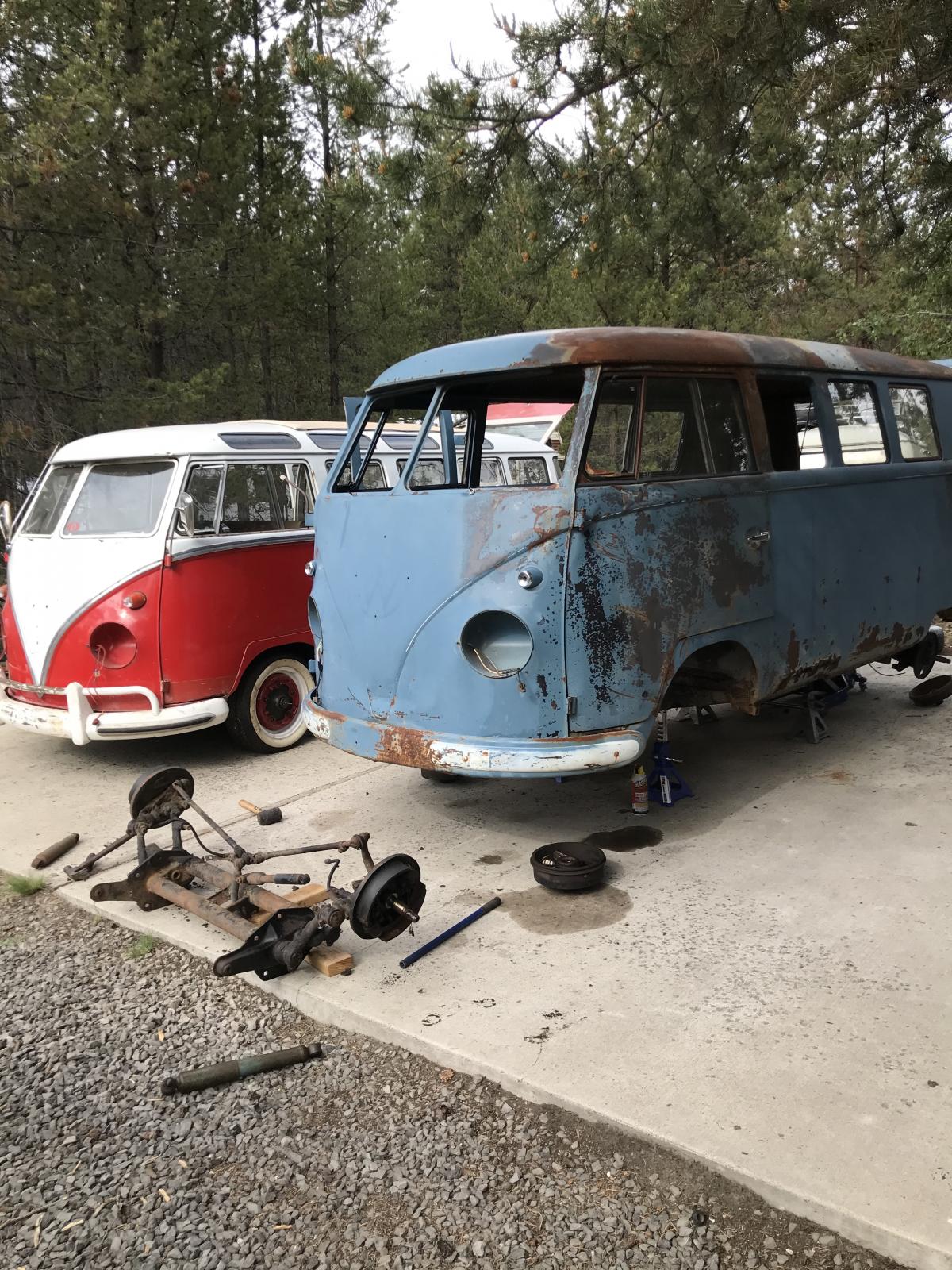

Updates:
58:
Pulled, cleaned, inspected and painted the front beam. Everything looked great minus tie rods drag link and a few seals.
Made an order for the remaining metal. Should show up next week. Stoked to get more metal on this bad girl!

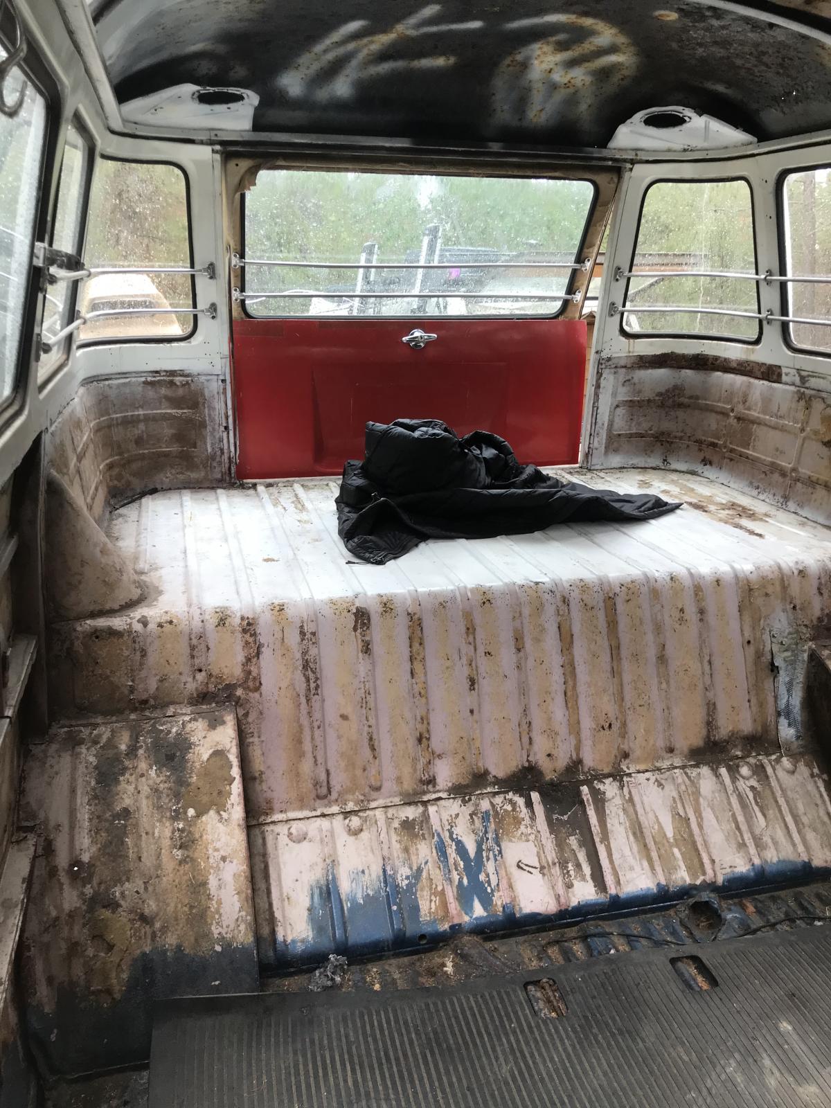

Also started grinding the interior for metal repair and paint. Going to spray a grey primer than a sound insulation like lizard skin. Maybe? Anyone ever use this product? My buddy On the coast put it in his bay but that’s all I know who have used it.

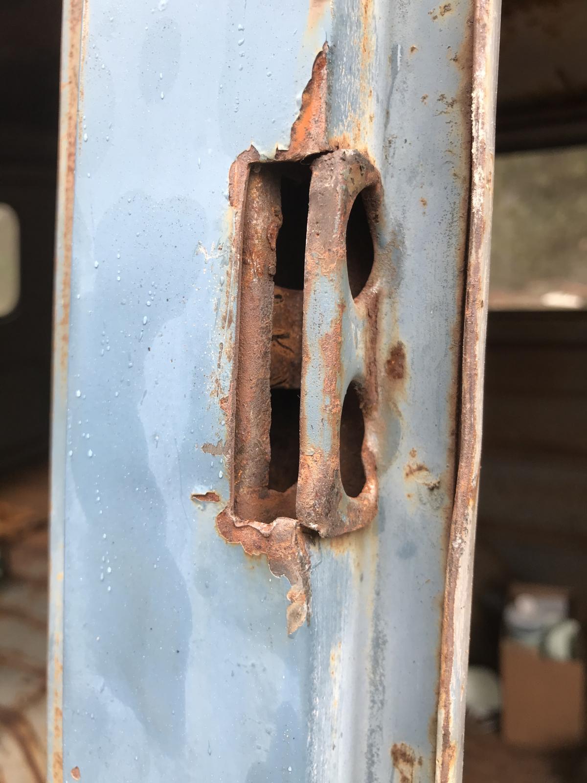

Trying to figure out what to do with these broken hinges
61:
Pulled the engine. It’s a new motor but kinda performance parts esc. Thinking about removing the Weber and going with a stock carb but seeing as it is a dual port we will see.
Found a local buddie to trade transmissions. So I should soon have a stock big nut tranny.
Sadly upon further inspection it looks like they might have sanded down to bare metal when they painted. Sad. Might respect with the stock color. Unsure.
