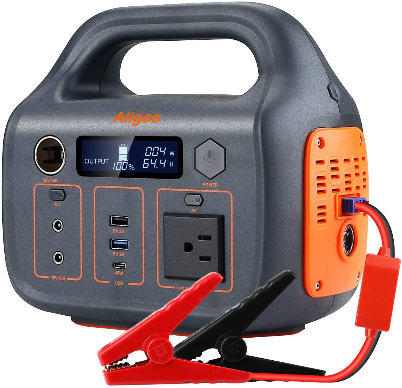

"Portable Power Station"?!! Didn't we used to call these batteries?
It just bothers me that the manufacturers of these batteries with accessories are referring to them as "power stations" or similarly-misleading names. There are a lot of unsophisticated people who don't realize, until they buy the "power station", that they have to go home, plug it in, and only then have "power" in their "station". The marketing materials then use W/h to make the units appear to have more power than they do. All deep-cycle battery companies use amp/hours to allow apples-to-apples comparisons. Not so with Yeti, River, etc. It's not right.
Here's a real portable power station:
By comparison, here's a battery with a handle with attached inverter and accessories so that you can tell your envious friends that your 18-pound flashlight will definitely outlast the power in their wimpy REI headlamps.
Old technology in a wanna-be slick package with a handle on top.
It reminds me of when television manufacturers used to put a handle on top of a 50-pound TV and call it "portable". Fine for Ward Cleaver to move, not so much for June Cleaver. The Beaver? Forget it.
I'm sure it's a fine product, but wish the marketers would call it what it is - - a battery with a handle and gew-gaws.

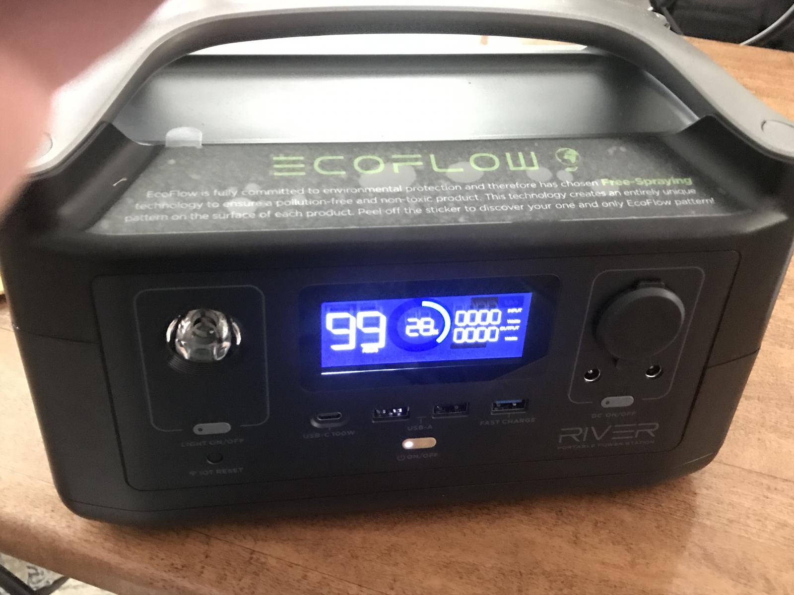

I've been using my EcoFlow for about two weeks now.
No surprises, it does exactly what .i wanted it to do and thought it would do.
It is REALLY NICE having refrigerator onboard on a daily basis for drinks and food.
The only downside is that I haven't yet wired in an ignition controlled lighter outlet so I can charge the EcoFlow while driving.
I also have a 110 v AC Shore power plug designed for boats that I want to mount on the Vans side panel behind the drivers door somewhere.
This will be handy for charging the unit without removing it from the Van or running an extension through a window at night.
I currently bring the EcoFlow in to charge it every few days.
All of this wiring needs to happen before I head West in the Fall.
Color me pleased, yes, I know that I could have more capacity for about the same money if I had DIY'd something. But this little package is just so portable and handy to have.
I'm not limited to using the refrigerator in only the Van.
In the short testing period to date, This has ended up being the ideal power solution for me.
I never liked the complexity or space my house power took up in my 86 Weekender.
(I did end up getting the additional battery making my EcoFlow River a "Plus" model.)

If you go the EcoFlow route, keep in mind you still need a battery separator for alternator charging (which is limited to only 10a with EcoFlow).
Ben
'85 2WD Westy w/ Peloquin TBD + 2.2 Subi (Kurt Vannegut)

I went with a cheapo brand, Aligoo 300Watt Portable Power Station generator with 12V Car Jump Starter power bank, 266Wh lithium backup battery, Pure Sine Wave AC/DC outlet. It's on sale right now on Amazon for $159, https://amzn.to/35EFkpJ.
Even though I have two house batteries, sometimes when it's cloudy they don't get charged enough from solar, so this is my backup. I'm trying not to kill my AGM house batteries by running them down too low. It actually works great!
One feature I really like is the watt consumption readout on any device that is plugged in. For example, now I know my big "Endless Breeze" 12v fan uses 15 watts on low, 22 watts on medium and 32 watts on high. I always wondered how much some of the devices draw and now I know. My fridge uses about 70 watts during startup, but settles down to around 43 watts after a couple of minutes. It also will tell you how long it will last based on the current draw and how long it will take to charge based on current input.
One reason I chose this particular model is that it comes with an attachment to jump start the van should the starter battery become low over a long camp. I can use jumper cables from one of the house batteries (and have) but this is way easier. I experimented with using it to power my fridge and it could probably go for nearly a full day before it runs out of juice.
I did have to figure out a hack to keep it going when powering the fridge... it has an auto shutdown feature 60 seconds after no load is detected. Of course the fridge doesn't run constantly, so it would turn off between fridge cycles. To fix this issue, I discovered I could plug in my phone via USB and that would prevent the unit from shutting off automatically between fridge cycles, even when the phone is fully charged.
I always have my 2000w gas generator if all else fails. Overkill? Naw, I like my gadgets!
I just finished a two week camp and got to use it extensively and it worked like a champ. I'm not sure about other brands, but this one will function fine while being charged. I experimented with plugging it into a 12v receptacle to charge while the fridge was plugged into the unit and it worked fine and would still charge with the fridge load.
Anyway, I thought I'd share this inexpensive one for those that don't want to spend a fortune and don't have huge power requirements.
