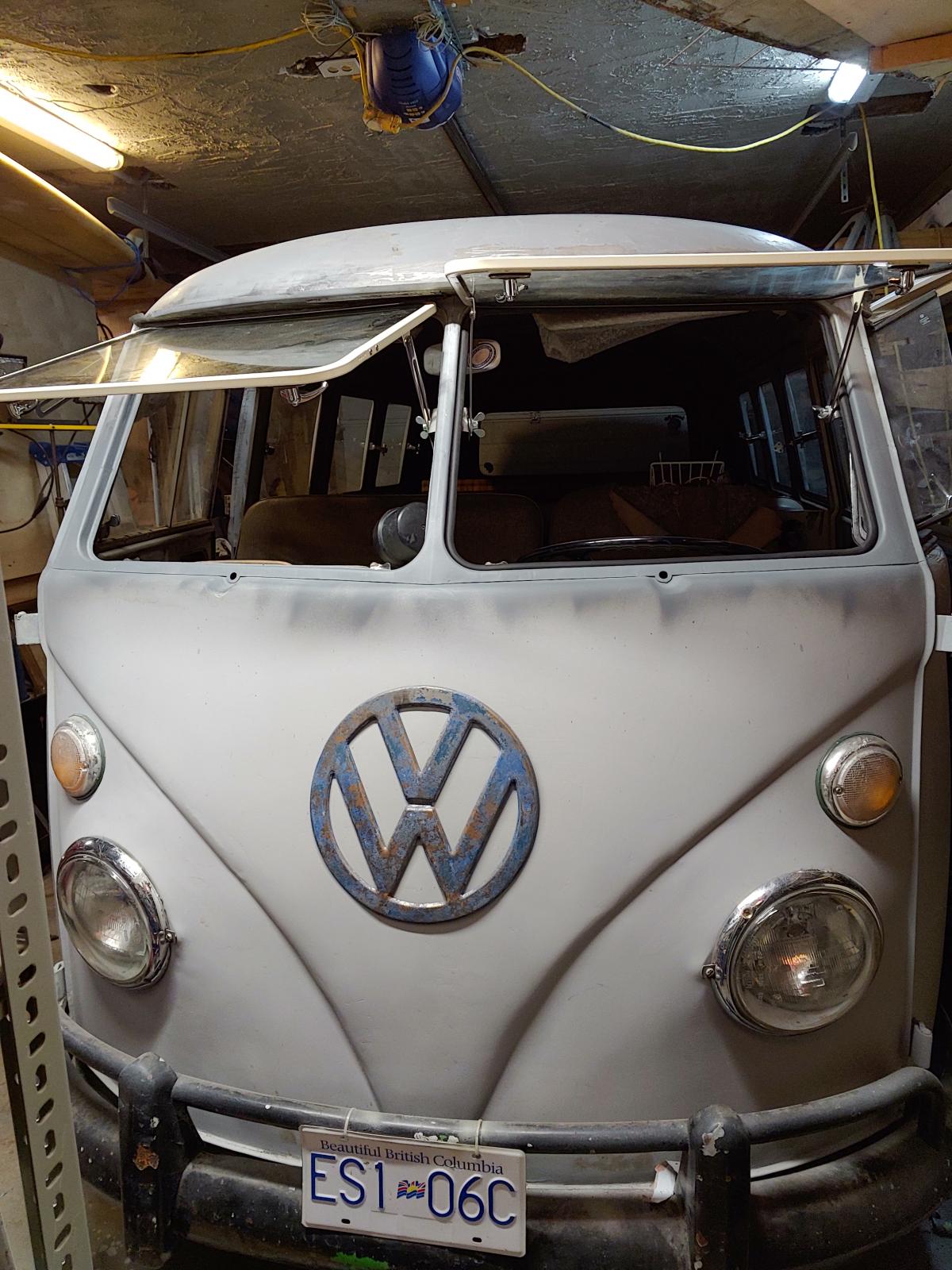

PostPosted: Sun Mar 29, 2020 8:38 pm    Post subject: 1964 Kombi safari window install Reply with quote
Safari install complete. Other than one bracket, which was missing a weld nut...
