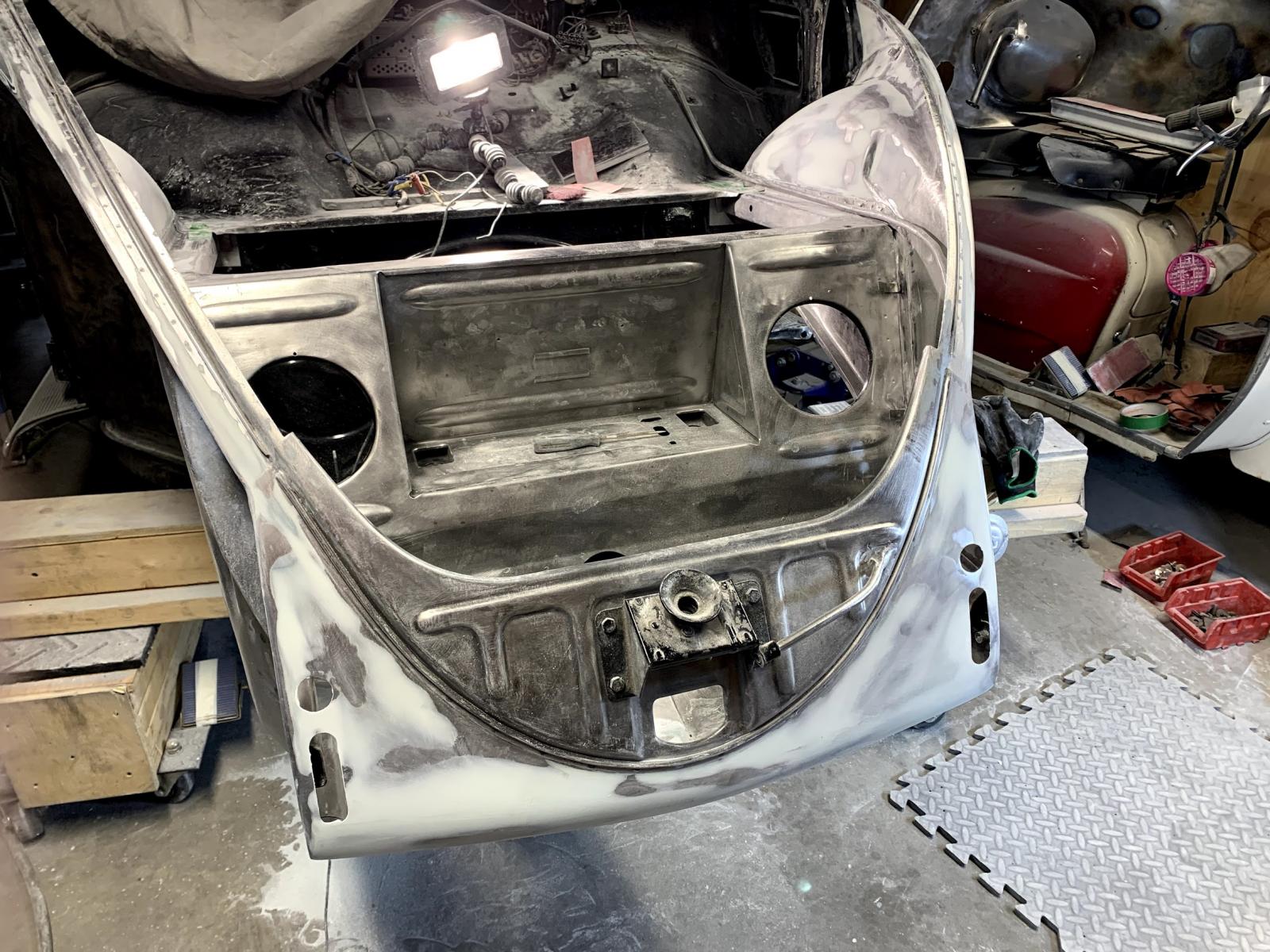

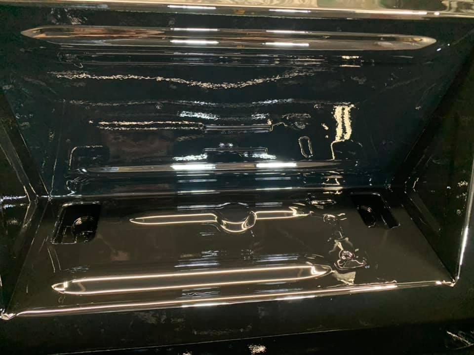

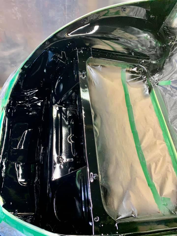

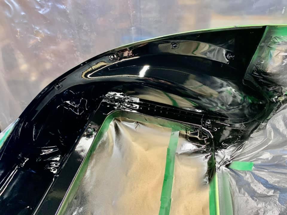

no huge update so far but in progress into the body preparation prior epoxy primer:
I just completed the quarter panel, the outer surface has been fully guide coated to address all of the high and low + guet a perfect smooth and even surface.
1st time I am doing all of this, but learning a lot and trying to keep as less as product as possible.
Now I am progressing on the outer surface of the apron + inside trunk. I will post picture once completed.
without fender
with fender:

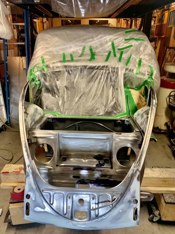

PostPosted: Sun May 23, 2021 5:42 pm    Post subject: Re: Original 1956 Oval convertible Reply with quote

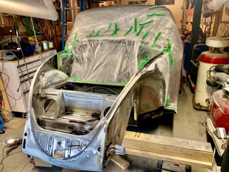

body prep of the front clip is now 100% complete:
working now to build a small paint booth:

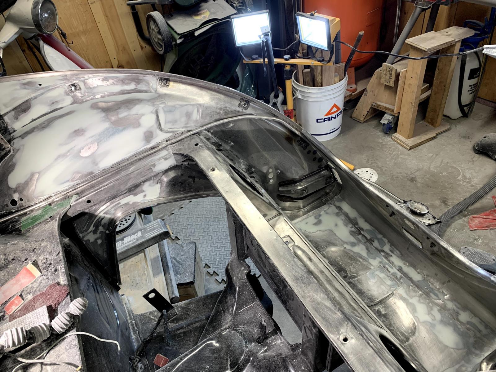

I thought I was ready for paint but found a little rust issue on the re-inforcement of the frame which I had to address before it get worse.
Here are some pictures of the repair

end result with that repair including a bit of lead work to get rid of the welding marks:

PostPosted: Fri Jun 11, 2021 7:06 pm    Post subject: Re: Original 1956 Oval convertible Reply with quote

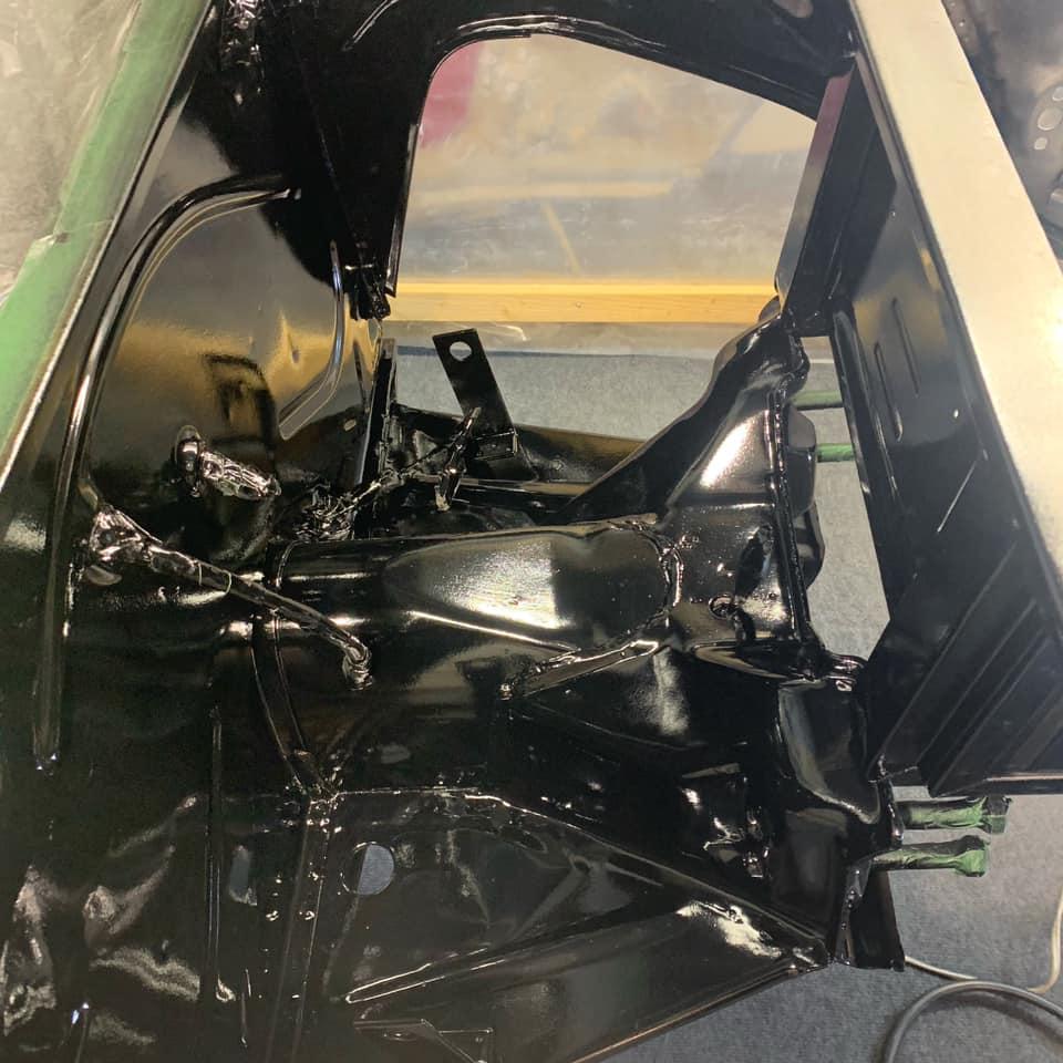

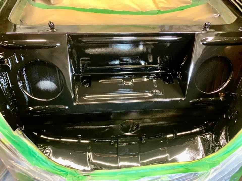

After few hours playing with masking tape the other day, I am finally ready for the home made paintboot.
goal here is just to paint where needed the rest will stay untouched.

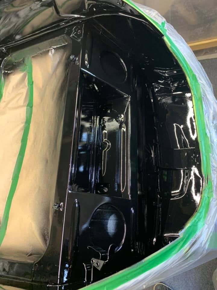

Question though. What are the dark streaks here and there? Seam sealer, or POR?

the dark mark is just rust converter I got from my paint supplier.
I could not get rid of these small little surface rust marks so decided to convert them and prevent rust to propagate under the epoxy primer I have next to come.

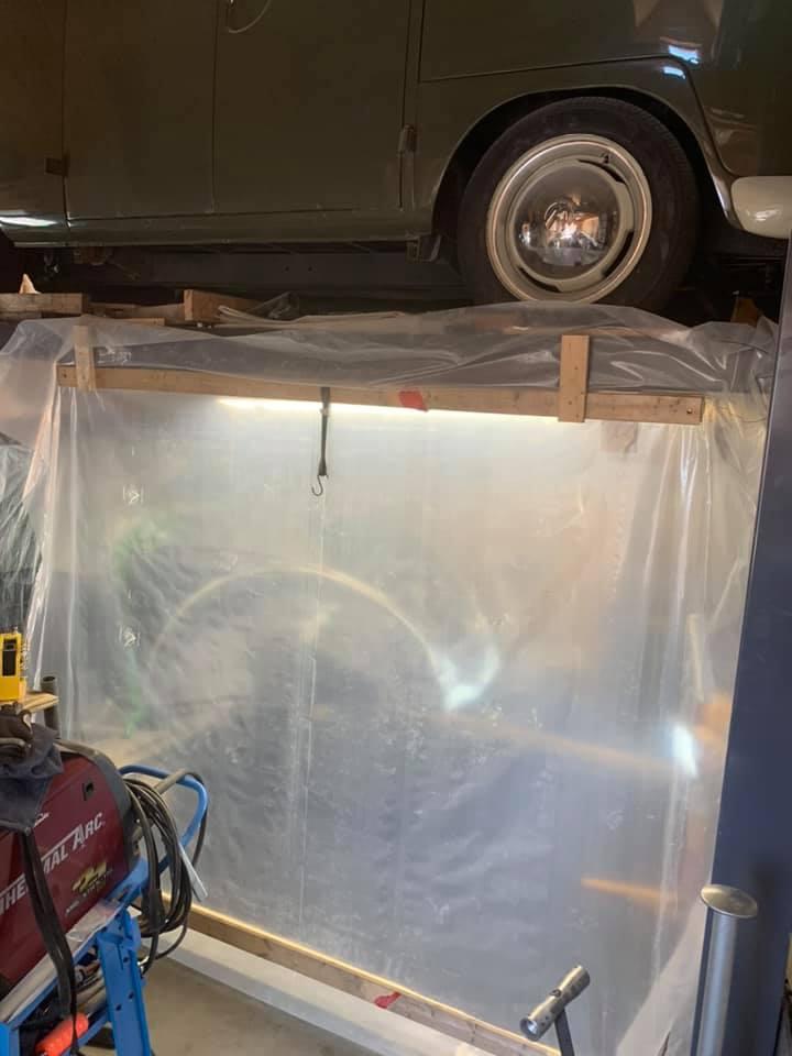

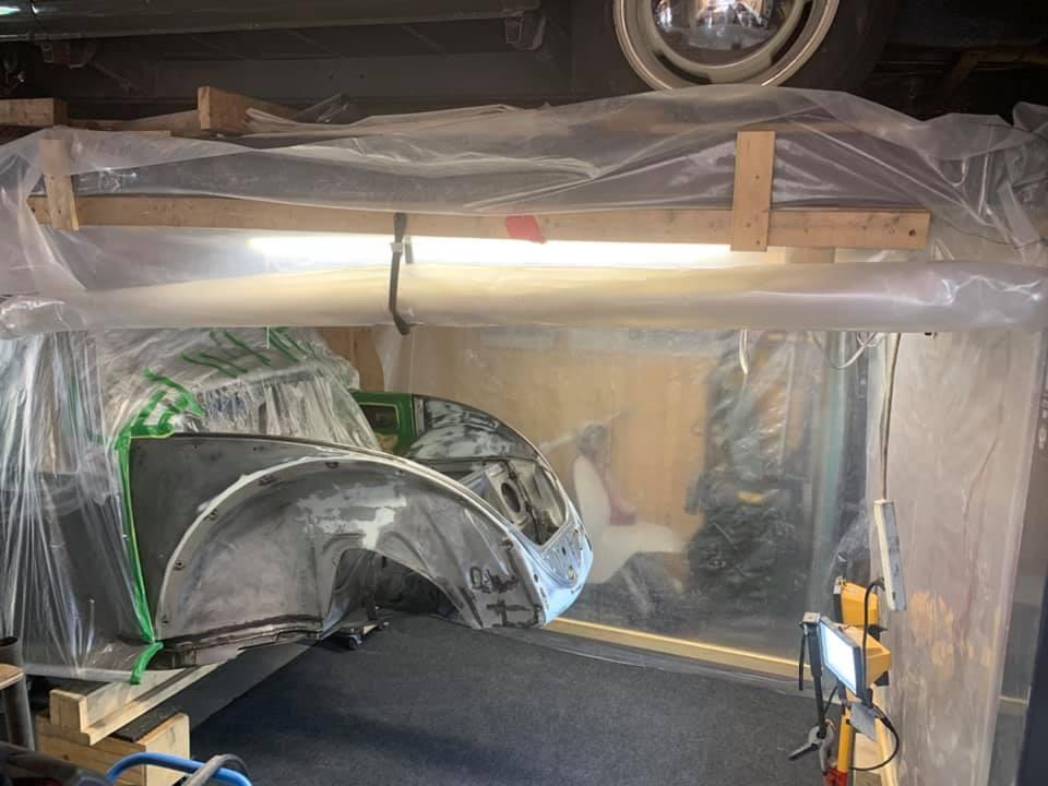

PostPosted: Sat Jun 12, 2021 5:34 pm    Post subject: Re: Original 1956 Oval convertible Reply with quote
here is the paint boot I just completed:
it is made with basic 1x2 wood and plastic polythene for the walls. I can roll up and down each wall. I used a basic exterior carpet on the floor. The walls are just clipped on my 4 post lift.

so today I was able to apply the black epoxy inside the front trunk:
I am just wondering if I should put paint on top of epoxy or just keep it the wait it is as my car is black anyway.
what do Guys think ?

Wow, that looks great!
If it were my car. I'd be happy with the results of all that hard work.
But it's your car and you are bordering on a perfectionist. So in the end of things. It's your choice on what the next move will be.
Keep it up. It looks like you are going to be able to drive the car this summer. Cool

I had a color matching made yesterday with 1 gallon of paint, so yeah I am moving into painting the inside with black so the goal is to get as less as nuance a possible with the rest of the car.
more to come !!

the inside of the front trunk is now fully painted. L41 single stage paint on top of an additional layer of epoxy sealer.
going to wait the paint to cure and will switch to the outside.
very happy of my 1st paint ever:

Looking really nice!
Did the epoxy have an open time for recoating it? Sometimes they cure so hard that any additional coats past the cure point will not adhere. Sometimes all you need to do is hit it with a red scotch brite pad, sometimes something else.
Looks great!
