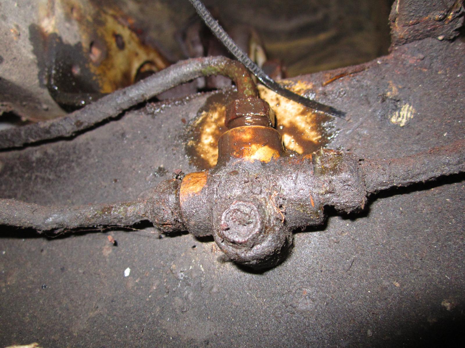

PostPosted: Wed Mar 29, 2017 7:22 am    Post subject: Re: brake line diagram? Reply with quote
No I think that T is the T I am currently struggling with...

PostPosted: Wed Mar 29, 2017 10:35 am    Post subject: Re: brake line diagram? Reply with quote
I also noticed that going to the front calipers on the diagram it is a rubber hose right to the caliper, whereas on my van the rubber hose goes to a very very short little end piece of metal pipe... are some people now bypassing this little end-piece of metal pipe, or is it just omitted from this diagram because it's so short?

PostPosted: Wed Mar 29, 2017 11:37 am    Post subject: Re: brake line diagram? Reply with quote
It's unlikely they're leaving those short sections out on the stock brakes. It was just an oversight on behalf of the person who made the diagram. I might be mis-remembering, but I'm pretty sure both types of brakes found on the T3 use those short tubing sections right at the front calipers.
