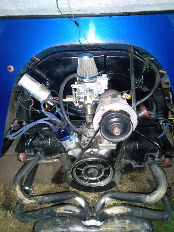

Here is a few pixs i just took. Relocate the coil might be enough room but not sure with hood closed. Swear i hate that header.no matter what i do paint burns off the dang thing.

Ok, right! I see the problem!
No I would not put a turbo under that engine cover, you would be very lucky indeed if you don't already have high engine temperature problems now! There is nothing standing in the way of hot air from the bottom of the engine and exhaust system from re-circulating into the cooling fan. Do you monitor oil or head temps at all?
This is a problem with many kit cars. You need to get some isolation between the upper and lower air flows along the line that VW did in the Beetle and Bus.
I am also thinking that air cleaner is not doing you any favours.

In the stock VWs with the upright cooling fan the upper engine compartment is sealed off by tins and weather stripping so that NO hot air from the cooling air discharge under the engine or heat from the exhaust system can get to and be recycled by the cooling fan. In a conventional Manx style Buggy this re-circulation does happen some but the engine is open enough that this is not really a big issue. Most of the designers and manufacturers of the more closed in style kit cars did not give this cooling air re-circulation any thought. Your engine compartment would definitely be in that category! Some sort of baffle between upper and lower air and shielding from the hot exhaust system should be done.
The other option, which VW did on the type 3 and 4 cars was to duct the intake for the fan into a cold air stream. In those cars it was louvers on the side of the body. Maybe just a large duct from your fan inlet forward so that it picks up cool air from above the transaxle is all you would need. I personally would still look at some sort of tin shield over that exhaust and muffler though to help reflect the heat down.
I wonder if some of your lack of power is not just due to the engine running too hot?

popeye613 wrote:
... What about removing the block off plugs for the heater ? would circulate more air around motor.
Yeah, around the motor; as opposed to keeping heat away from it. And, it'd be at the expense of air meant for the very crucial job of cooling heads and cylinders. Don't do it.
popeye613 wrote:

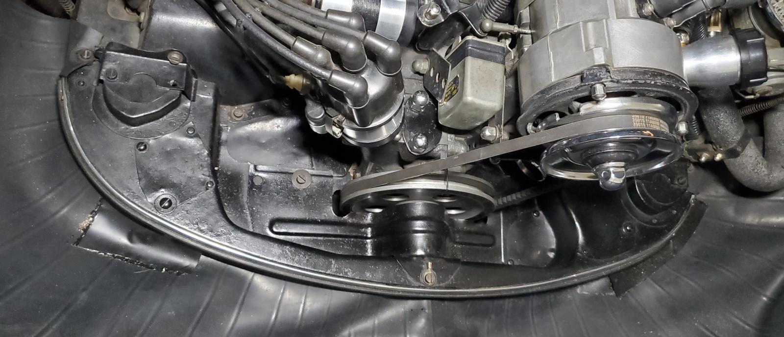

... talking about a engine skirt as i call them ?
Yes, now you're talking! Made one for my kitcar's enclosed engine compartment using an old inner tube found while at the side of some highway, probably had to pull off due to an overheated engine.
I learn'd the hard way, cook'd motors; burn'd valves, warp'd heads, exhaust valves sticking, head studs pulling, etc. Eventually built a side scoop and ducted cooling air directly to the inlet side of fan shroud; and then later, widen'd it for more air flow:
