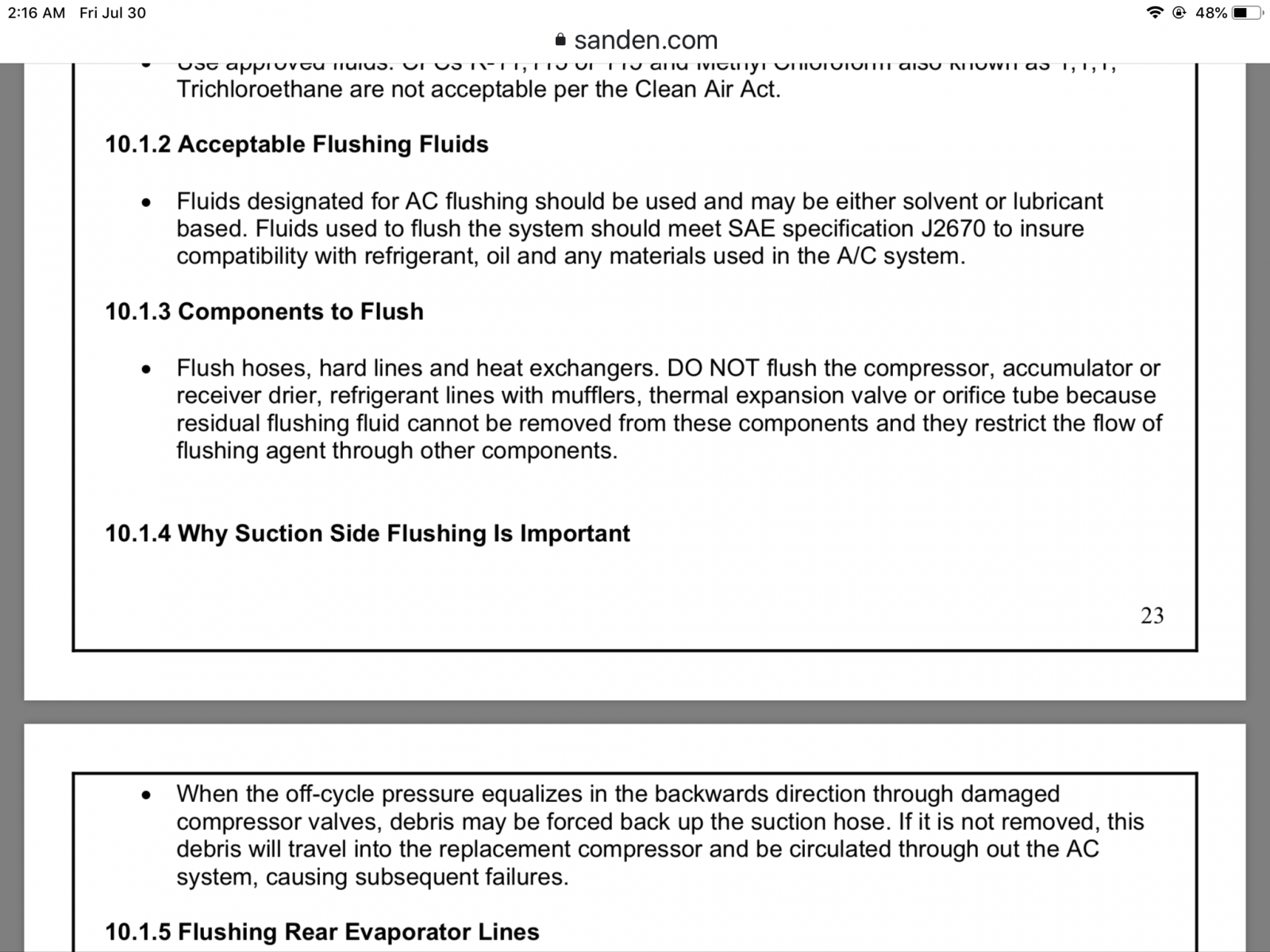

https://www.sanden.com/productlibrary/manuals/SD_Service_Guide_Rev_2.pdf
Dave

And more........
Sanden does not seem concerned about minimal mineral oil being in the compressor when switching to PAG ....... if they are not concerned, you need not worry either.
I'd be trusting Sanden over local wrench turners opinions.
I think your flushing of the compressor with mineral oil has far exceeded anything Sanden recommends or expects one to do.
0.5 oz (15cc) of oil clings inside the compressor when drained and rotated.
If you have any PAG at all still clinging inside after multiple oil changes, it is absolutely minimal.
https://www.sanden.com/objects/retro.pdf
Dave
