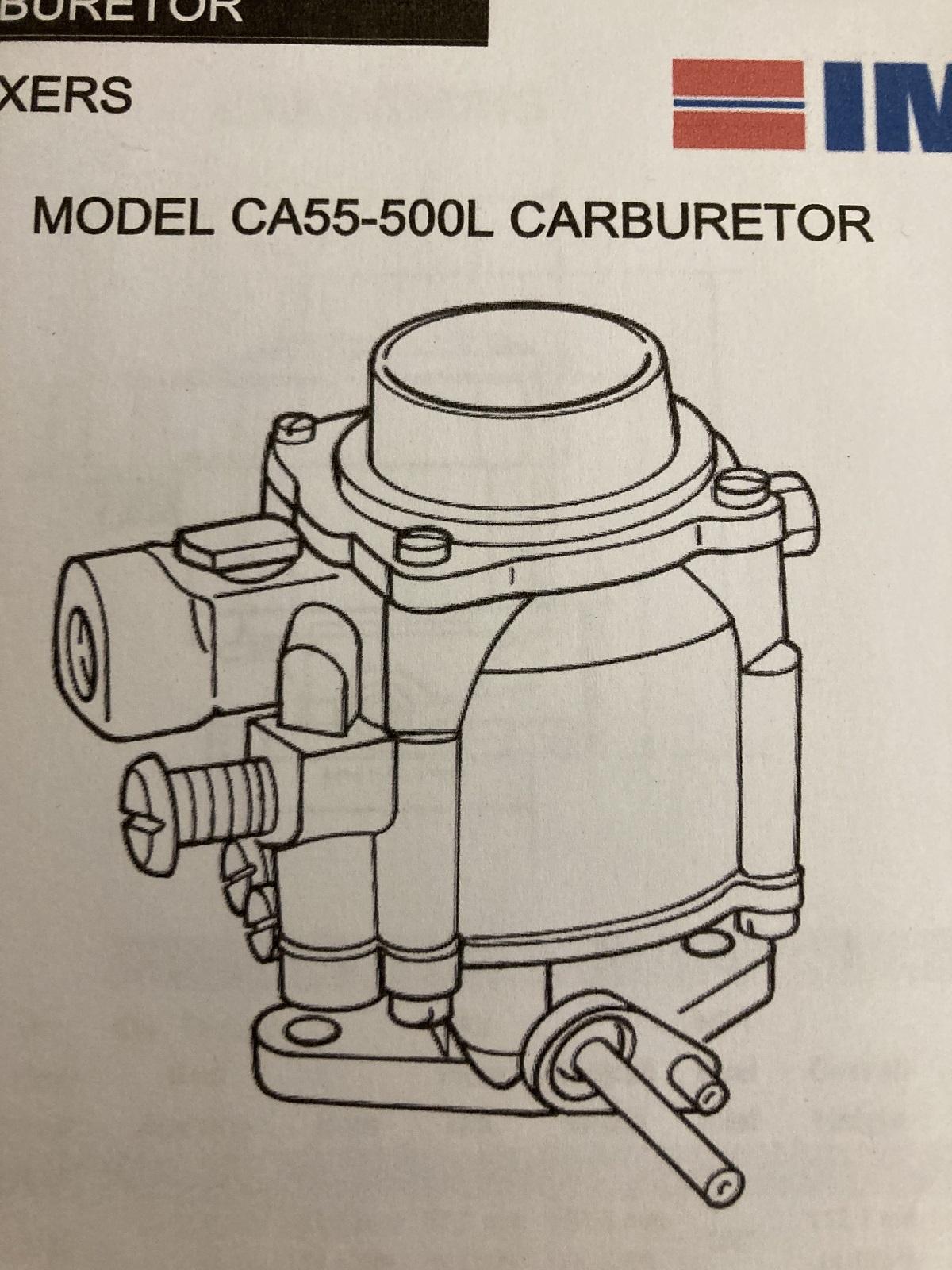

Wow! Yes, now I see the situation more clearly and why you people use gasoline for starting and warm up! That is a very crude device.
Ya! I am surprised they work at all. There is no fuel metering device to vary fuel with RPM or engine load apart from the regulated pressure.
Here is a small Impco carburetor/mixer suitable for a VW engine for single fuel only not gasoline. This one is rated for up to 75HP engines and has an idle mixture adjustment, a load sensing diaphragm with a tapered plug, item#8 (different tapers available for tuning) on it that meters the propane into the airstream for all off idle running. Then there is a valve on the fuel inlet that adjusts the full throttle mixture. The fuel pressure adjustment is accomplished in the evaporator separately too. This one is virtually the same except for size that I bought 30 years ago for my Rabbit conversion.

Think of it as a carb....in place of the TB...on a fuel injection system...with the injector ports plugged.
I mentioned LPG...but why not propane or any gaseous fuel?
Dim memory...but someone on the STF...had one in a 411 or 412 years ago from Europe. It had a spare tire shaped donut tank that fit perfectly in the spare tire well. Said he loved it. Ray
