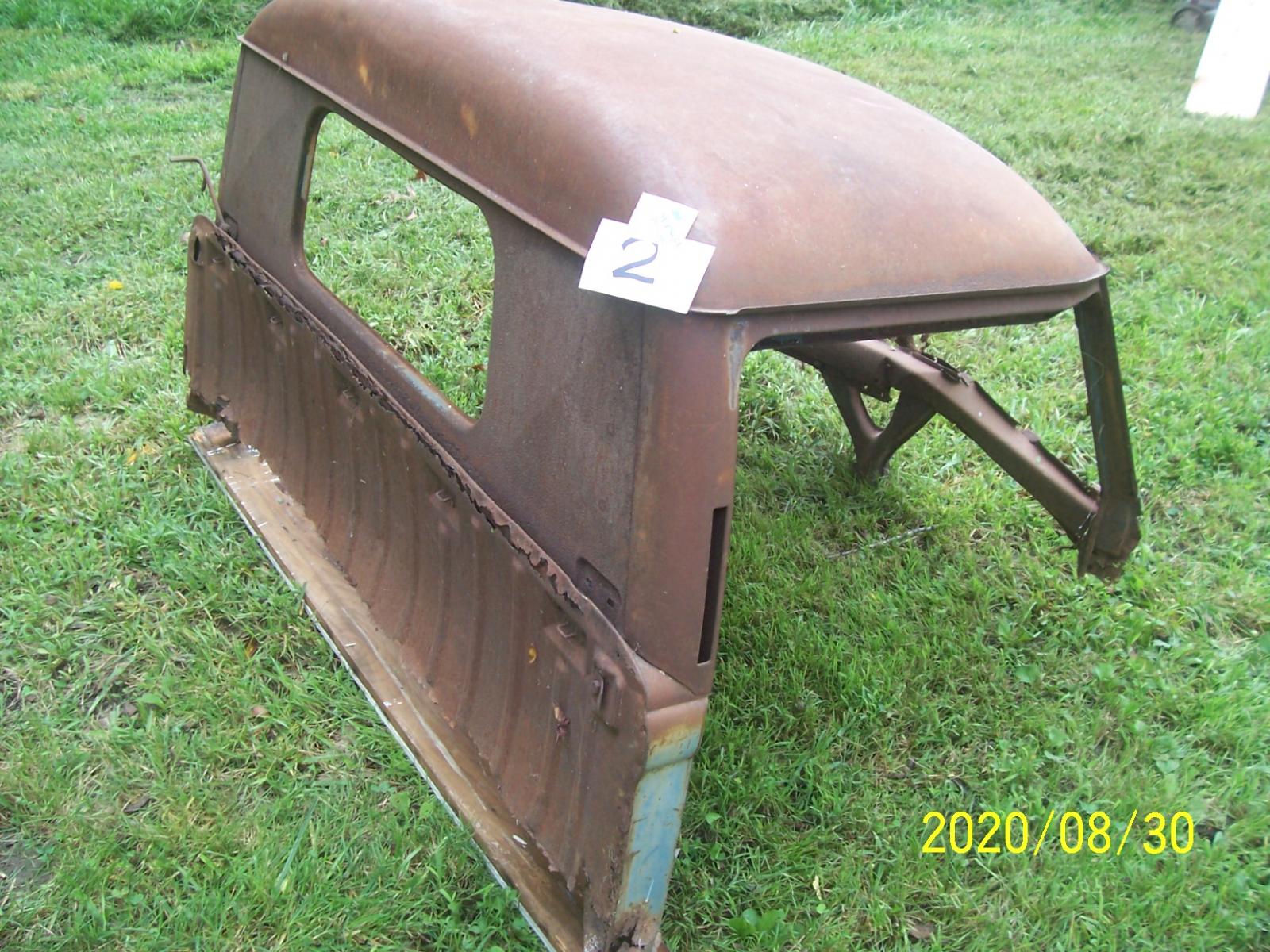

Build it!!! You can get everything it needs now. Just one state over in Missouri is going to be an auction with barndoor parts. Including a single cab roof. You may want to find out about.
Good advice right there ^^^ You cant beat a single cab especially a barndoor one.

that really is perfect. hopefully i have an opportunity to pick up one of those cabs when they come to auction. i contacted the gentleman who posted about it. fingers crossed.

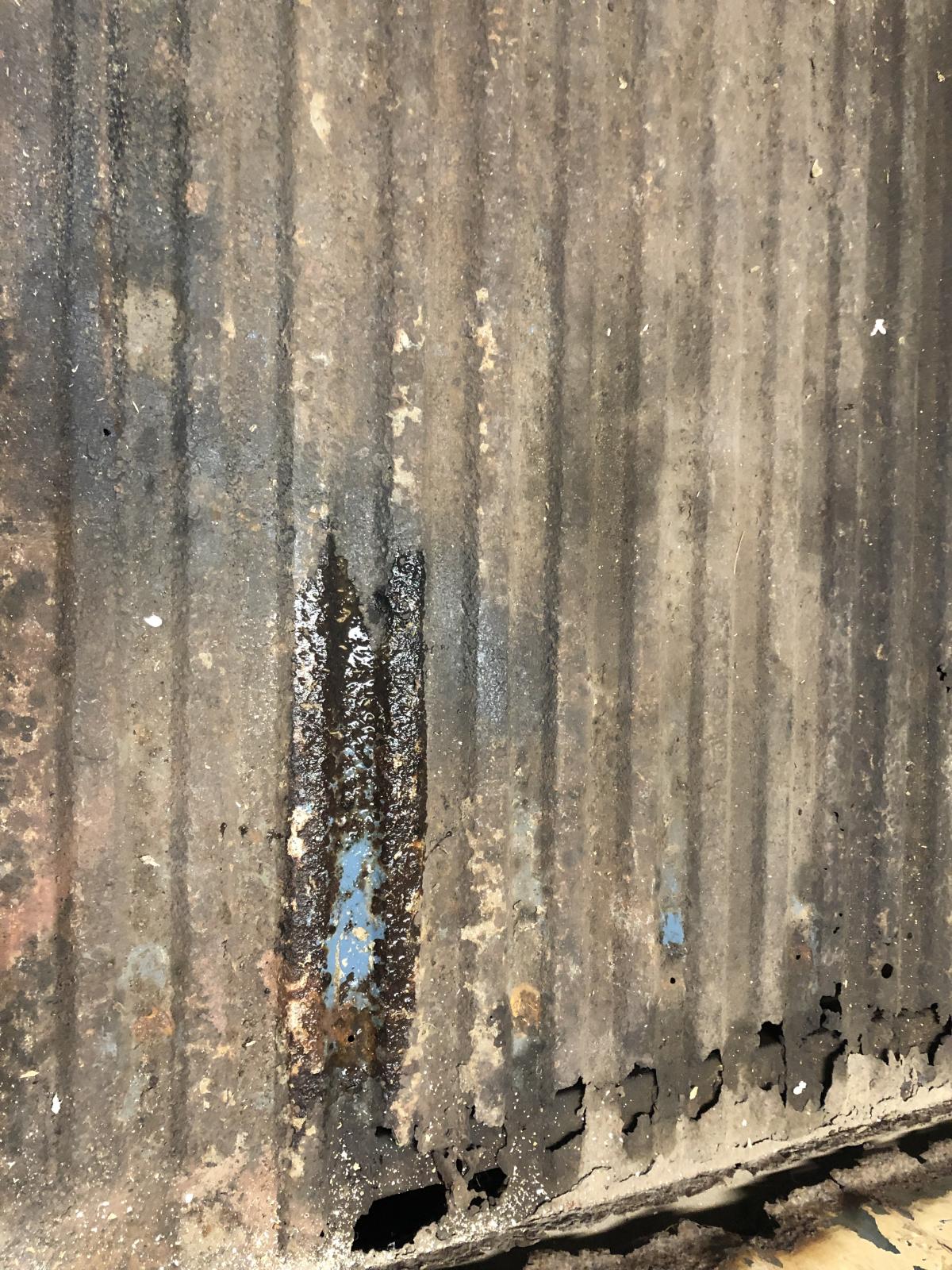

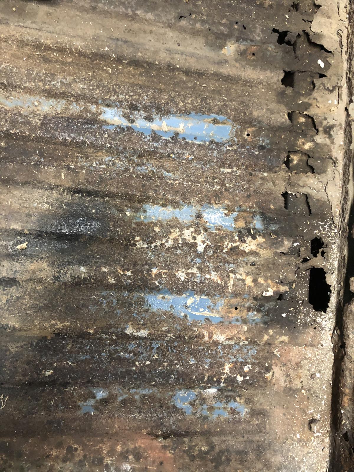

i started poking at the rust on the bed. turns out there is a fair ammount of original blue paint under all the gunk.

In my experience when an early HTF part you really need turns up, you do whatever it takes to get it. Chances are the next one will be that much harder to find and more expensive. You might wait years for another barndoor single cab clip to turn up in your area. They don't grow on trees and its pretty much a fluke that one turned up right when you got the bus, you could almost call it divine intervention.
Remember there are many many differences in a Barndoor upper cab, front windows are a different size, wiper divots, cab peak, no fresh air box, semaphores and dash to name few.

You'll make a big and important step with a suitable ''cab-clip'' if you want to restore your SC. Since the chassis looks pretty solid on the pics, the rest could be doable. I also saw a dashpot holder in one of the first pictures, so you already have that.
That Dove blue on the bed is nice but the metal looks paper thin or perforated for the most part, so has to be replaced I guess. Hopefully the under structure isn't too bad.

the bed is for sure rusted through and will need to be replaced. that is why i picked that spot to practice removal of rust and stuff. cant hurt it right? the structural stuff seems pretty solid. i plant to try moving it soon and will take more pictures at that time.

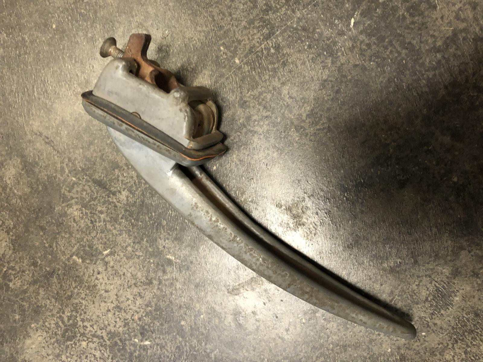

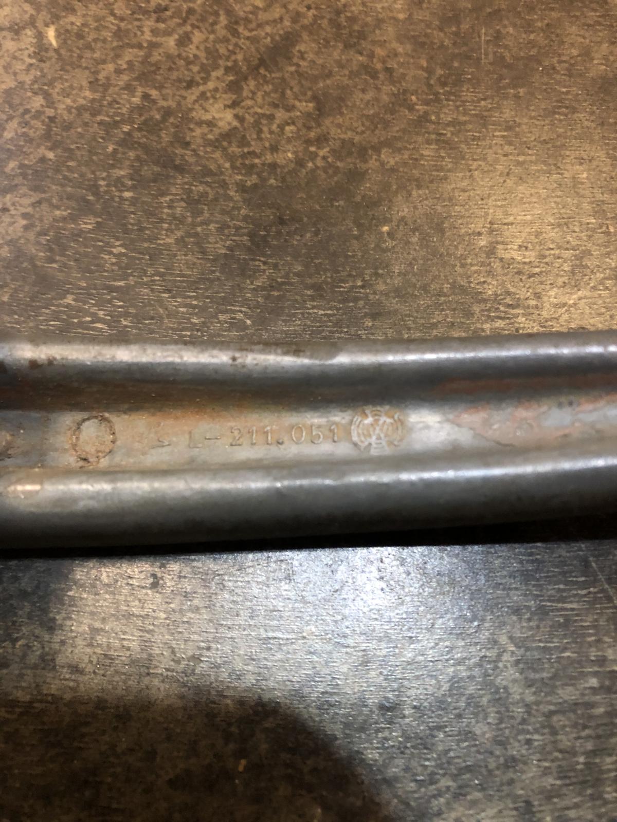

while sorting through parts i found something that i cant figure out. its a passanger side door handle. part number L-211.501. it has the kdf logo. early bus? war bug? what is this thing?

Pretty sure its Split bug. Barndoor is 29. or AL loots of good info here... https://www.thesamba.com/vw/forum/viewtopic.php?t=180629
And in the splitbus, split bug and oval bugs FAQS If you cant find it there you can search in the forums.
There's bound to be some treasures hiding your Dads parts mountain.

+2 split beetle pre-50 the kdf cogwheel logo lasted to 1949 on a few of parts.

thanks for pointing me in the right direction there! so far i think thats the first part ive encountered that started with a 2 and didnt go to a bus.

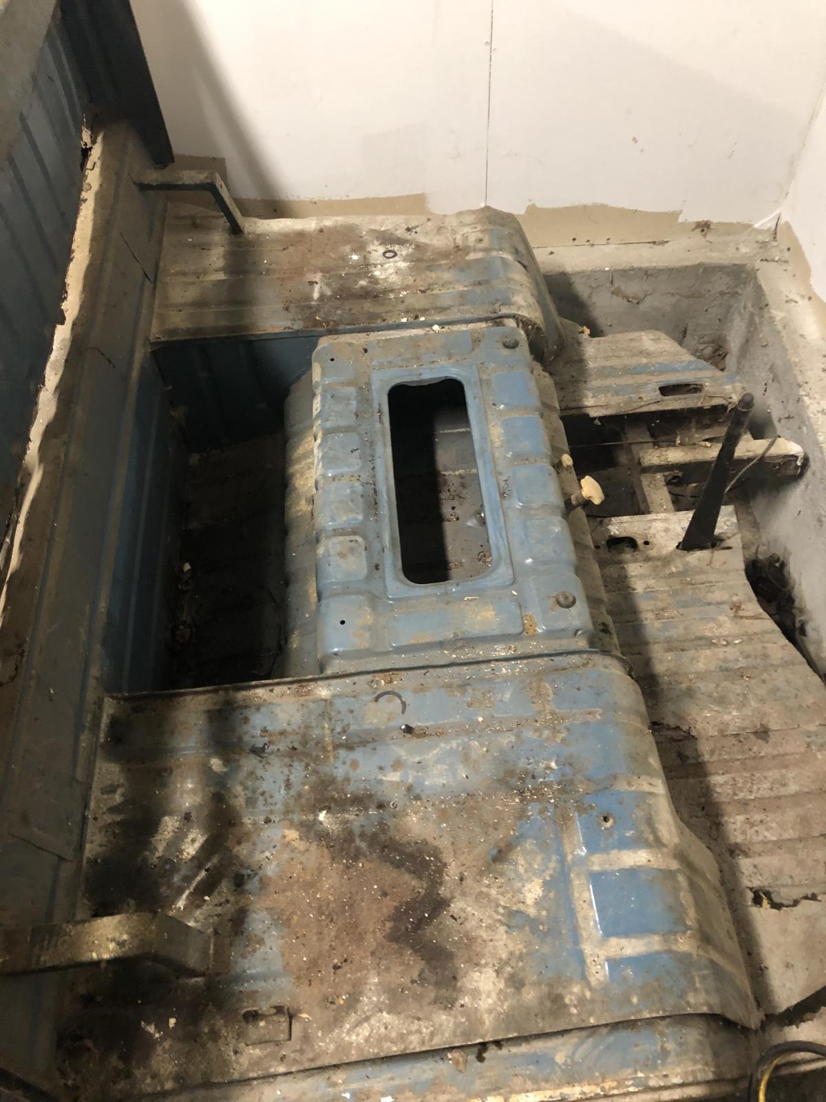

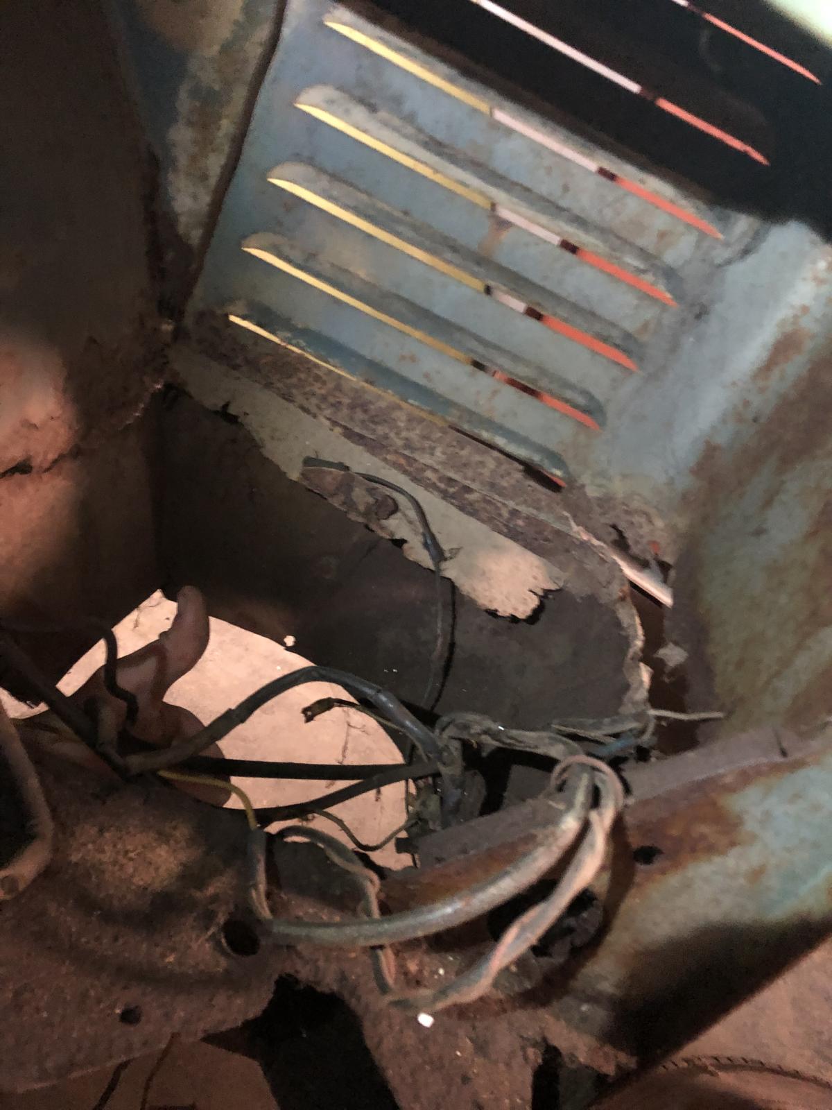

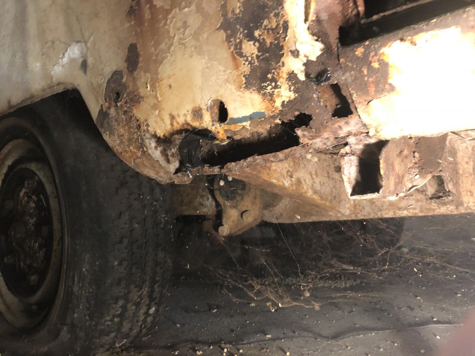

i started cleaning out the cab area in anticipation of trying to move the truck. snapped some pics along the way.
there were a couple boxes of parts in there. lots and lots of original blue. the driver side dogleg area is nonexistent. e-brake handle is just kinda hanging out.
battery area is rotten through. looks nice on the other side.
parts of the underside have some kind of plastic spray coating. it crumbles off easily and reveals shiny original paint.
november 1952 ragtop
november 1954 single cab
Posts: 71911
PostPosted: Sun Sep 12, 2021 4:45 pm    Post subject: Re: Jims 1954 Reply with quote
Undercoating that's separate over time? I've had that on a couple Buses and it peeled off pretty easily in some cases
Jimone wrote:
Anyone else sit here studying that pics for a while? Very Happy
Anyway, I see what could be the original Aluminum brake fluid reservoir in the lower left.
Jimone wrote:
Weird that the choke and heater knobs are white.
They are usually Black for a Truck
ddutch
Joined: June 17, 2020
Posts: 231
Location: Nederland
ddutch is offline
PostPosted: Sun Sep 12, 2021 6:06 pm    Post subject: Re: Jims 1954 Reply with quote
That bulkhead, the wheel wells and the remains of the cab floor all look supringly solid to me with lots of original Dove blue. Nice.
