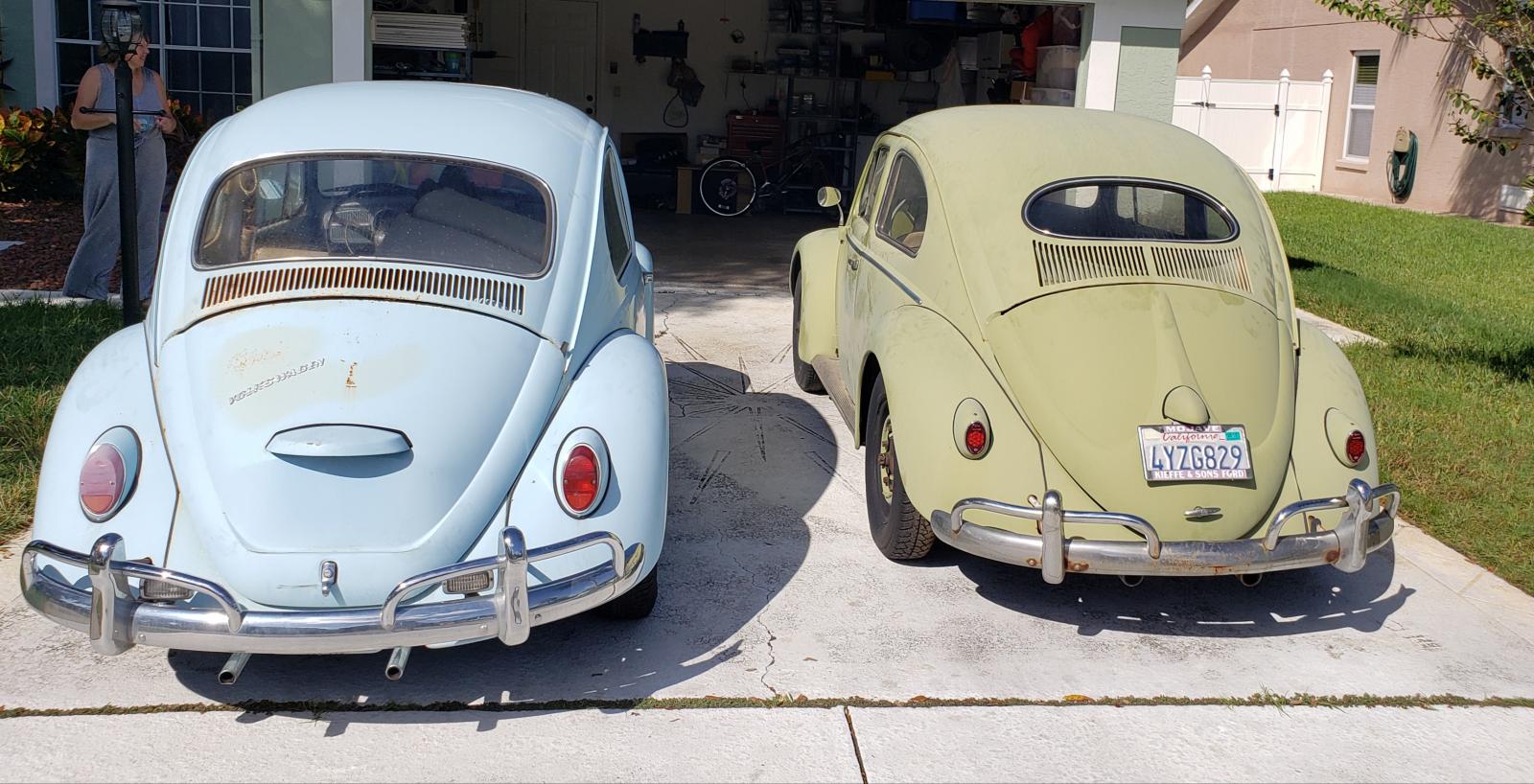

Anyway, here's what I know about my car.
1956 Body and Chassis, serial numbers match the VIN plate in the front.
1959 Engine and Dad kept a spare 1959 engine, maybe for parts?
I have not found any rust in the frame or body, I live in Florida so that is just weird!
There is surface, on edges and I imagine places where the dust wore away enough paint
They are in my garage now, which is an outright miracle since I only have a 2 car garage
I know it was converted to 12v years ago (same time Sister's Bus was converted)
The engine was rebuilt and it got am electric fuel pump and choke.
The interior needs a lot of care and the back seat back and bottom are missing.
I wonder what the most urgent task is, with the car coming from a bone dry environment to the Humidity of Florida do I attack the surface rust and seal it up with rattle car primer?
When I touch the paint I get a dry dust on my hands, could it be road dust?
I want to clean it but don't think I want to hose it down!

Very cool, it looks really dry in those pics.
Is it original factory paint?
If so, I wouldn't sand or primer ANYTHING.
The chalk is just oxidized paint, wash it to loosen and rinse all of it off, then start going at it with some polish.
TR-3 is a good product to use on original VW paint.
It will take off some paint but will also bring it back and make it shiny and protect it.

agree with Everett for the outside but I'd also be thinking of the body cavities, inside doors etc and looking to protect those with waxoyl, lanolin or similar...

Everett, I have a feeling, considering the later hood, and non-"H" rear apron, that it has been repainted at some point in time...

The hood has a few issues... it was weakened from being closed improperly (not releasing the lock) and and there is a chip showing body filler (yeah bondo)
I will find some time to go over the main body and look for original paint as well as rust in the nooks and crannies...
Of course is any repaint used matching color then I doubt I could tell the difference.
Got any tips on telling it it is original paint?
I basically figure you look in all the hard to reach places for a different color, since most painters would skip them since you can't see them.
Any other tips?

Inside the ashtray, up in the wiring area, shouldnt be hard to find some og paint.

could be reed green?

I agree with Fin. I spoke without thinking “DOH” that is your OG color…
Spend a weekend working on it…your a lucky man..Reed Green..love to see after you give it a whole lot of love.

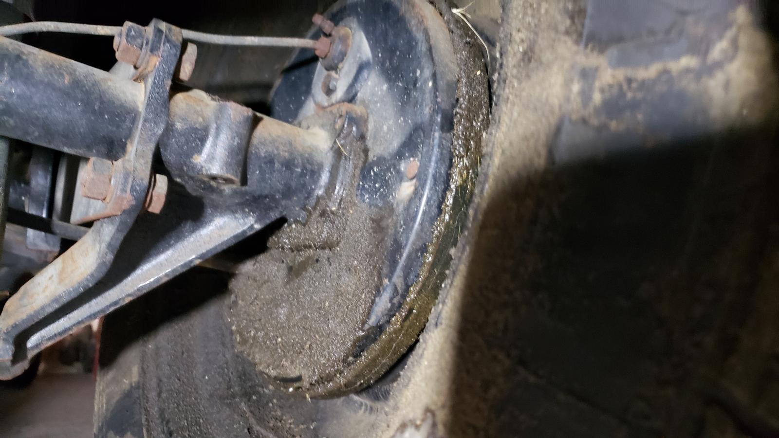

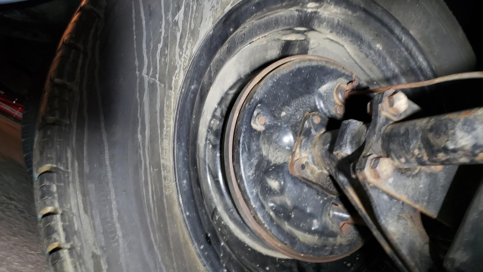

Well I am starting to figure out all the ways to show my love to that bug...
Brakes
Passenger side need lots of love
Drivers side not so bad, but it'd be crazy not to do them both at the same time
Engine bottom dirty, not sure if it leaks (it's a bug it must be leaking)
Transaxle looks clean, but I see drops under it...
So what is the story with the older brakes?
I do not see the hole in the backing plate to turn the adjuster nut like I had on my 69...
I didn't check the front yet... but I am sure they are the same

Passenger side wheel has a large transmission leak at the axle tube bearing housing to backing plate, or it is the seal. If the oil has saturated the brake shoes, they are toast! Time to reseal and install new brakes.
Adjustment hole at the drum. Outside area. Remove the hub cap.

TDCTDI wrote:
67rustavenger wrote:
I'd wager that the oil is everywhere!

I think the main reason was, it was much quicker for service techs to adjust brakes; with the access hole on the drum, that means that after each crank of the star(s) and a spin-check for drag, one has to stop the wheel rotation and re-position the hole over the adjusting stars.
However, with the hole on the inside (backing plate), the service tech would have the car up on a lift, over his/her head, working from the inside, and could keep the wheel spinning with one hand while cranking the adjusting star, and listening in real-time for the drag on the drum as it occurred.
Perhaps it was also a way to try and keep water out of the brakes; I presume it wasn't unusual for people to drive without a hubcap or two, in inclement weather. Those big holes in the drums would possibly let water intrusion occur...but I'm just speculating.

The brake backing plates are not oval era. Axle housing also looks to be the wide track version, if my eyes see it right. Funny thing is I would think a wide track tranny would have the backing plate brake adjuster holes.
Just be advised when it comes time to source new parts.

Had a coworker with *much* more VW experience that I look over the pics.
Transmission is the same style as a 67, so if fully synchronized.
This explains the read Brake Backing Plates being incorrect for the car
They are correct for the axle.

60ragtop wrote:
probably original color but not all is original paint. Hood is later, has raised spot for VW emblem. rear apron is later also. Not trying to rain on your parade, I'm jealous
Not raining on anything!
I inherited them from my Dad, I am 62, so I want to fix them up with my sons and drive them until they each inherit one each.
Those differences give me more freedom to do what I want!
I'd rather get rid of the surface rust, repaint them and know they will be good for a long time!
I am not rushing into anything!
