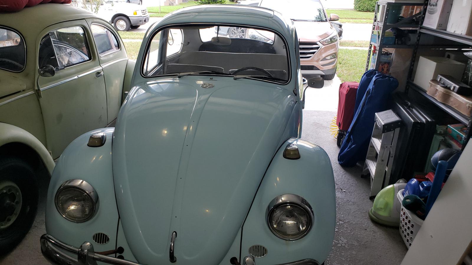

They are in my garage now, which is an outright miracle since I only have a 2 car garage

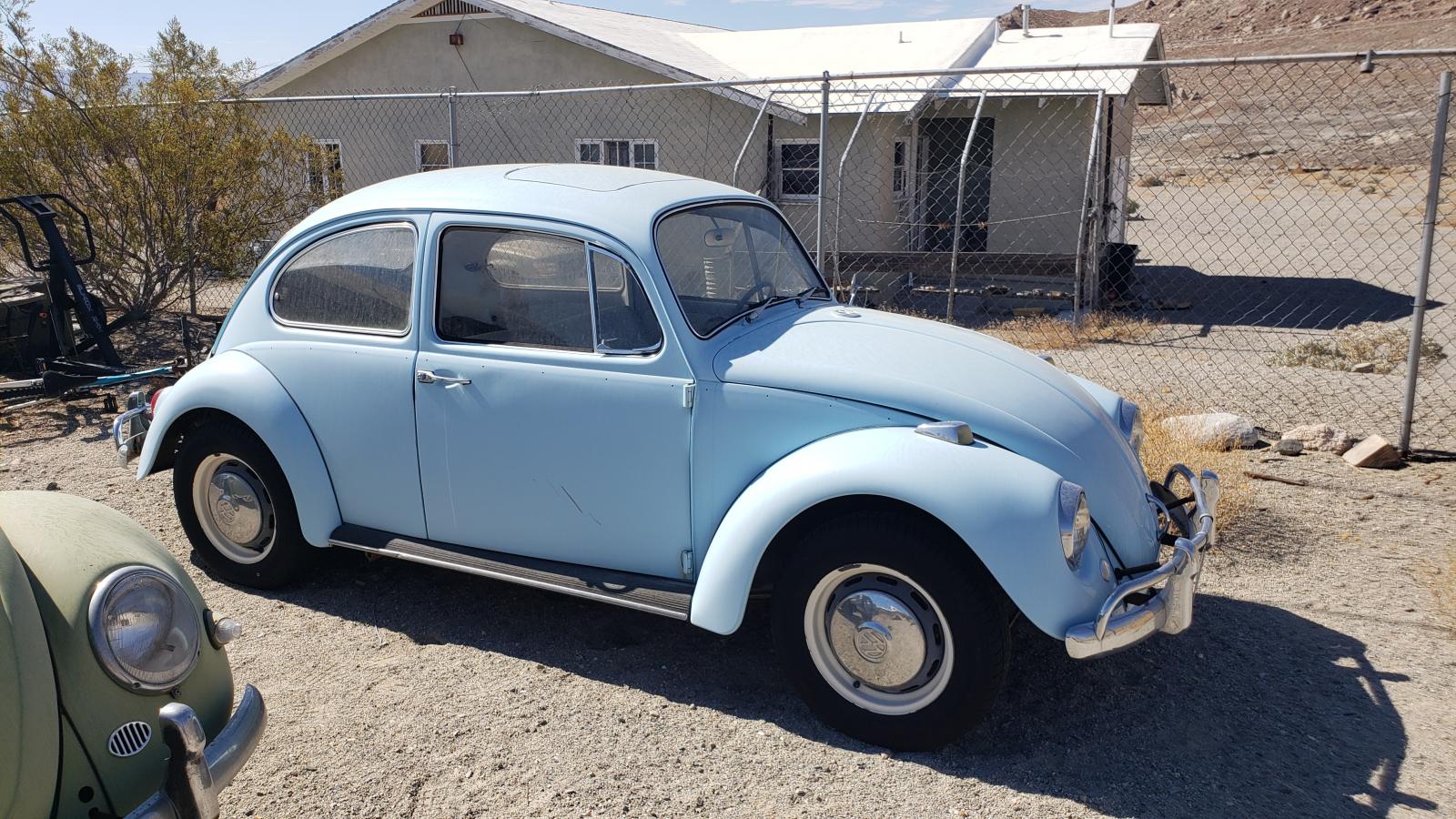

The bugs at play in their natural environmant

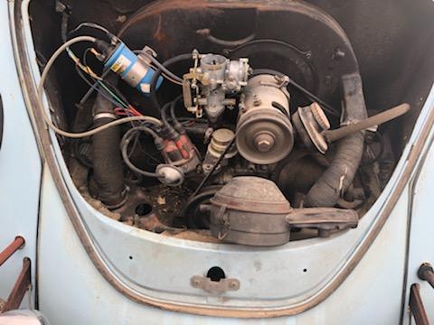

Engine
Delivery!

I spy half of a transmission case on the bench. Did you bring it back to Florida? Your dad probably used that to start engines on the bench (or ground).

Yes I agree about the jacks and the case is waiting to be unpacked.

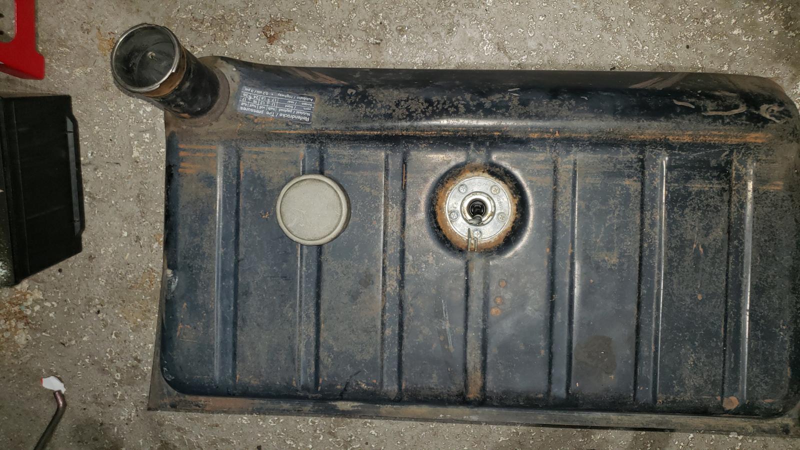

I then discovered 5 yr old gas in the tank, removed, drained and cleaned it.
Looking closer I saw this sticker and it made me wonder if this was the original tank
Oh yes, there is always a question!

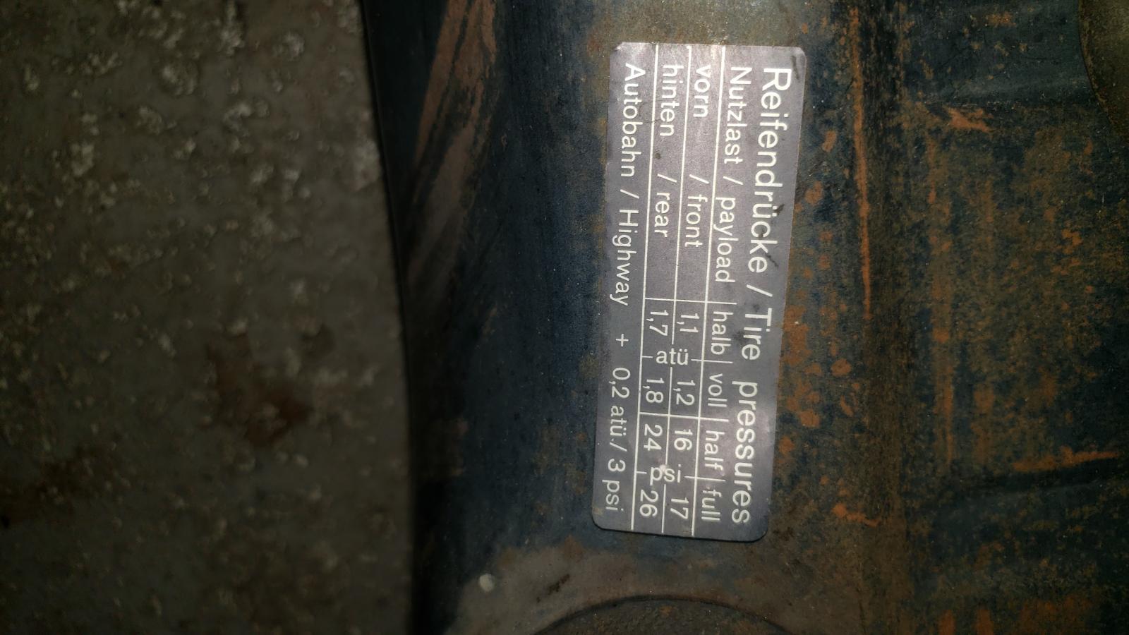

This tire pressure sticker is factory correct.
My 67 has it in the same location.
