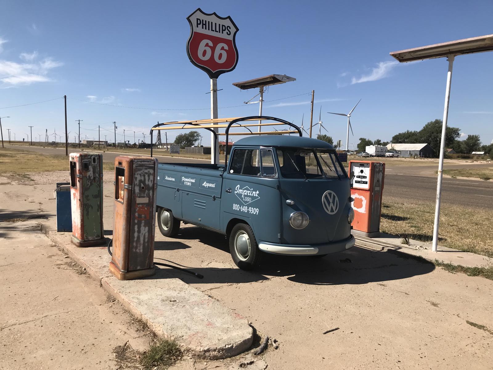

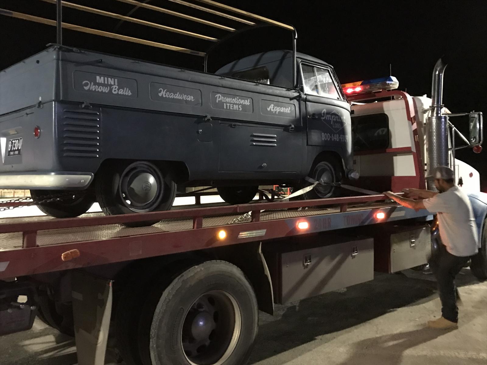

Drove this press bumper, with small nuts (bus not driver) on leg of the road trip, from OKC to Gallup NM, the last 40 miles with some help.

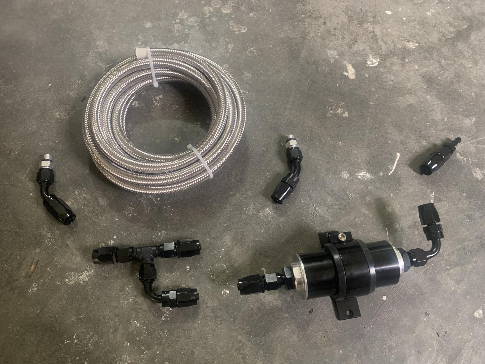

Ok - preparing for a new fuel line setup:
6an with a fancy filter
That’s sweet! What filter is that? Where do you get all that?
Evil Energy. I have gotten a lot of AN fittings from them - I just get them on Amazon which is also where I got the filter…
https://www.amazon.com/dp/B07CCM8QCF/ref=cm_sw_em_...&psc=1
I was torn between getting 4an lines or 6an - but what decided it was that the in line performance filters all have 6an as their smallest fitting. We will see - I am doing engine work starting Oct 25 or so, so this will be installed, new 92 thick walls, SuperStock ported 37/32 heads, 32 venturis with 1.45 main jets, new filler stand, new pulleys, oil leak fix and keeping the 1.25 ratio rockers. I am hoping for 125 to 130 HP with this 1968cc but we will see.

The cross country trip totally killed the front coil overs and the rear KYBs. During the trip I got a set of stock shocks but that lowered the front to the point of the tires rubbing when bottoming out! So I finally got a full set and replaced them today. Cool
