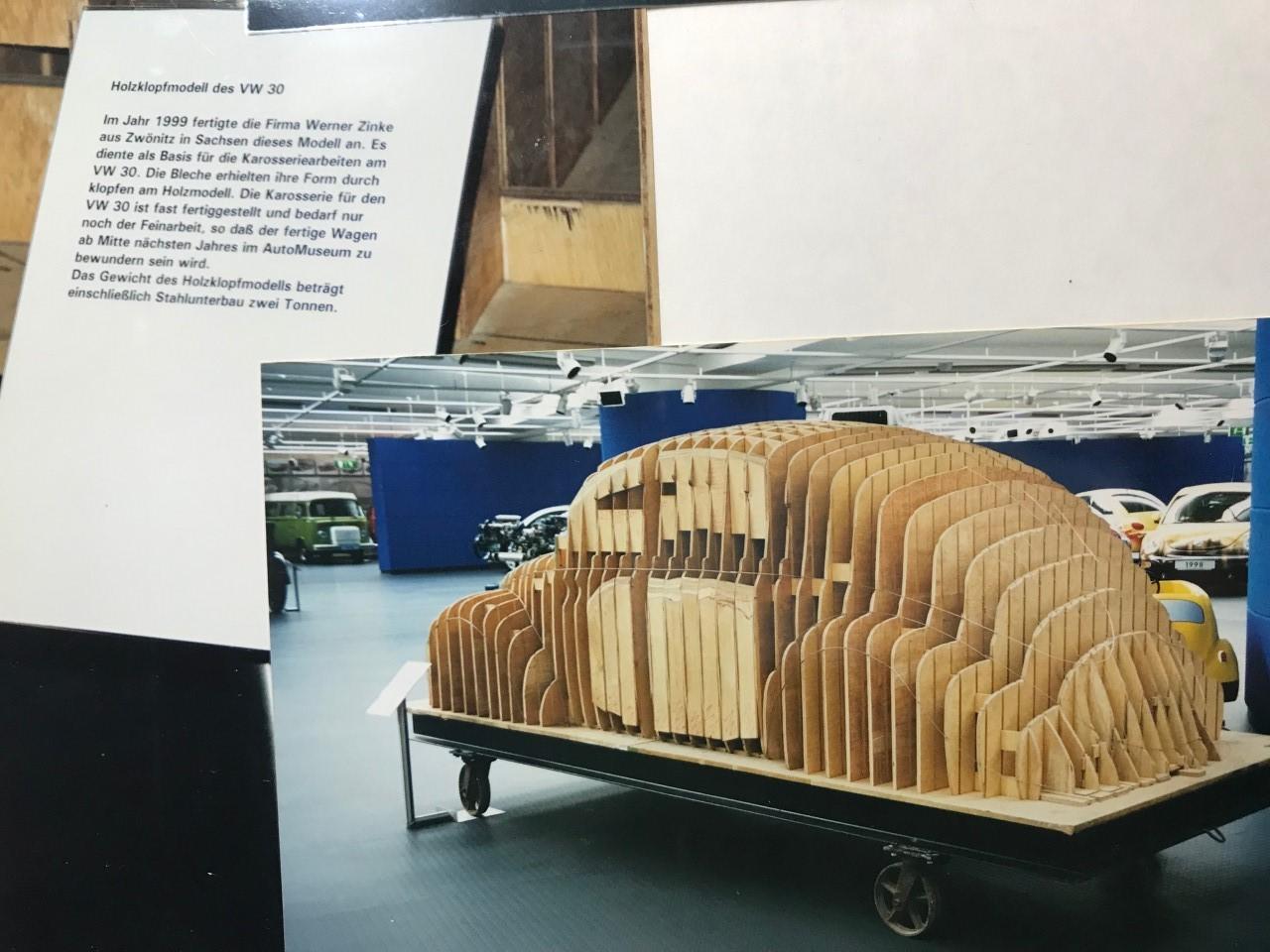

I don't buy the idea that VW didn't intend for their replica to be correct. They built their car from scratch, just like Undis. If they had gone an easier route, like modifying a production beetle, I'd understand that the lines and proportions were off. But they built a wooden body buck and hand-hammered all the panels, supposedly by projecting and analyzing the museum's archival photographs. They had all the resources in the world. I think they just weren't careful and screwed up.
For many of us it was a huge disappointment. But looking back, I'm not surprised. Unlike passionate enthusiasts, like Undis, the VW Museum often shows the culture of a corporate bureaucracy--assignments are handed down, completed, and judged against a dispassionate rubric. The VW hierarchy probably saw their replica as success. It was splashed across magazine covers and got lots of press, and, as many have said, the public probably didn't notice the inaccuracies.
But as someone in the museum field myself, I think accuracy matters. I myself would like to see an accurate replica close up--to better understand the original VW program and the car's development. It's not just the obvious design features that count, like the suicide doors or the rearward view through the cooling vents. It's also important to see how early prototypes compare to finished products in subtler ways. Were the first cars smaller, sleeker, or more aerodynamic? Did practical concessions, or the rationalization for production, improve or degrade the final design? These aspects are important too, and only an accurate replica can speak to them.
Here are some photos I took in the museum in 2002. We were very hopeful then! This is a rough translation of the museum label:
"Wooden body buck for the VW30: In 1999, the firm Werner Zinke from Zwoelnitz in Sachsen constructed this model. It served as the basis for body working for the VW30. The sheet metal took its shape by hand beating over the model. The VW30 body is almost complete, needing only minor finish work for the finished car to be admired in the museum by the middle of next year. The weight of this wooden model is two tons, including the steel undercarriage."
