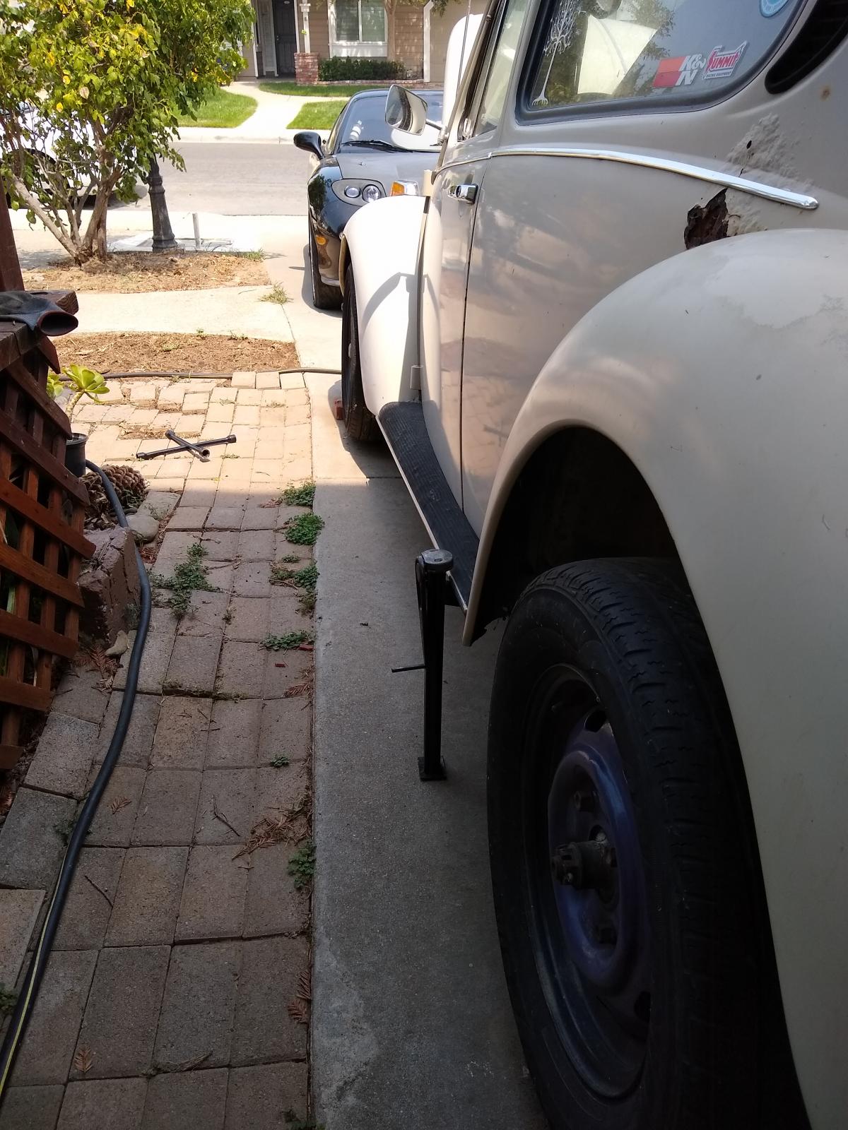

Went to a local guys house to help him clean out his junk that he wasn't likely to use. Got myself a 1970 speedometer assembly, a couple pieces of engine tin, a decklid that's way nicer than mine, and a set of five ET41 4.5j sport wheels Cool the wheels are pretty crusty but should be able to be cleaned up.
One of the tires on them is old enough to be made in Yugoslavia Shocked but they seem to fit up front with no issues. I'll call around to see about having them sandblasted and powdercoated.
I was afraid they wouldn't fit, bit I'm running tapered springs up front and have at least an inch and a half of clearance, and the ball joint clears with plenty of room as well.
I also checked the rubber mounts for my fresh air fan, they're shot. Cleaned all the junk out of the trunk too.

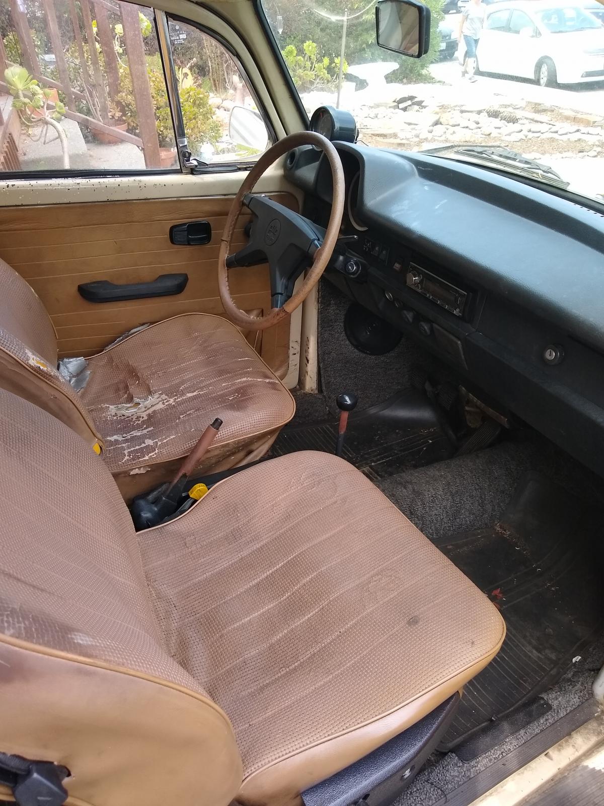

Saturrday- installed my momo prototipo wheel with the momo hub adapter. I gotta say, best aftermarket part install experience ever. Perfect fit, all parts included, easy install. In and out in ten minutes Shocked
Before-
After-
Sunday I took a long neck die grinder with a burr bit to rough up the gossy insides of the offset IDF manifolds I have, In preparation to install the 40IDF clones on my car with CSP linkage soon. Primarily I removed the internal casting seam/flash and roughed up all the glossy surfaces to promote atomization.
I also took a file to true up the surface the nuts go against on the flanges, this week I'll rub them all down on some sandpaper to true up the gasket surfaces.
Then I replaced the steering wheel bolts with stainless, since I hear the only real complaint on these is that the included hardware tends to flash rust. These are nice quality ones and look pretty nice, if I do say.
I gotta say, I love this wheel. The thicker grip is very comfortable, and the smaller diameter feels much more responsive. I don't find the smaller diameter that much more difficult to use at low speed at all. Maybe the thicker grip makes up for it? My only caveat is that the top inch or so of the speedometer is blocked by the grip. I rarely look at my speedometer anyway, but it may be a big deal for some. This is a 350mm wheel. Momo also makes a 370mm "California" wheel, but it has a thinner grip. It may be a good alternative if you added a grip wrap to make it thicker.
