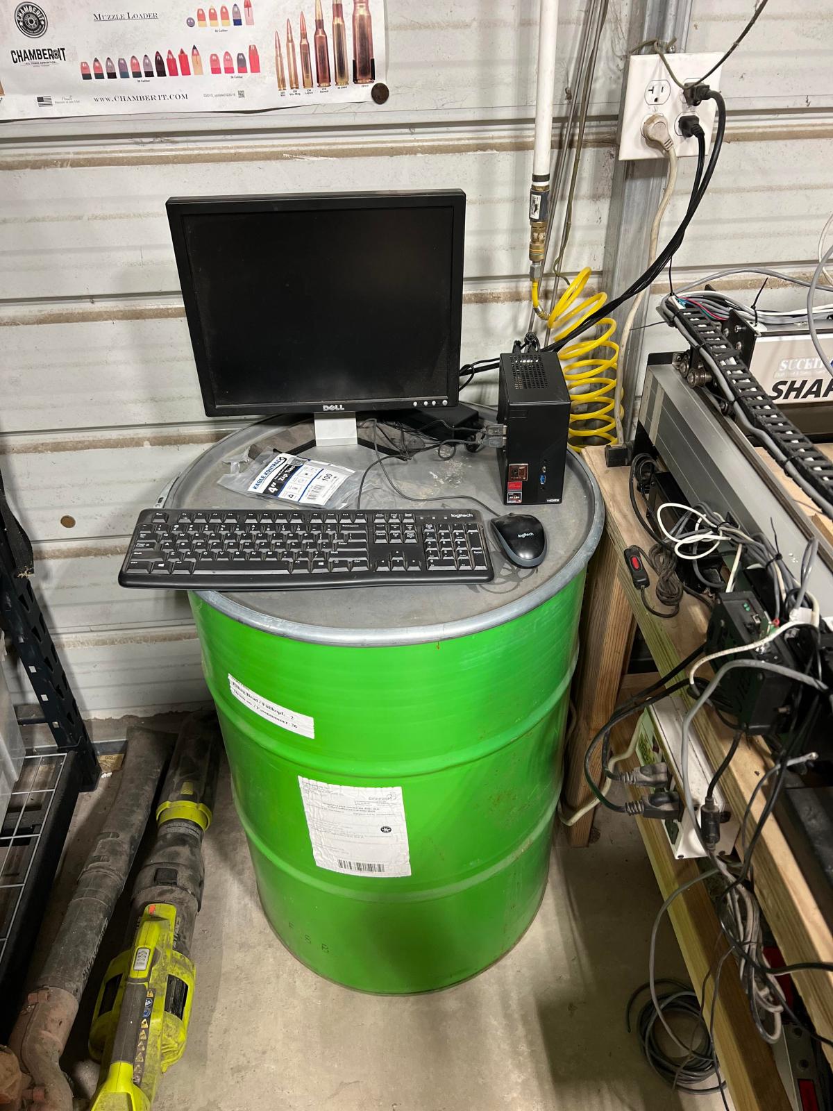

So while the bed liner cures I had another project I needed work on. Ive been putting it off for a few months since it was kinda buried in the back corner of my shop.
So here is my Shapeoko 3 CNC Router. Im upgrading the Z axis and spiondle.
I forgot to take a pic of what I started with.
But here is the machine torn apart.
Electronics box
Here is the new 1.5kW (~2hp) spindle. Its going to be a HUGE upgrade from the like 1/3 hp router.
Here the machine is all assembled again.
And my new desk. LOL
Today I need to solder the spindle connector and run a 220v line over to the machine. I'm waiting on a VGA to HDMI cable coming Monday before I can fire it up.

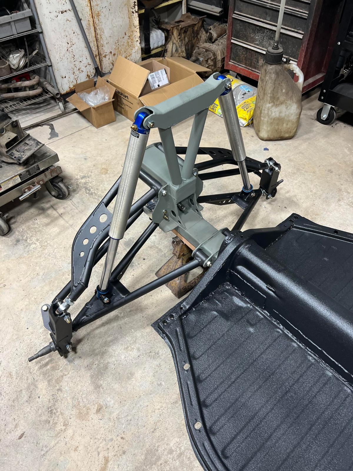

I also couldn't help myself. I assembled the front suspension. Shock tower is welded on.

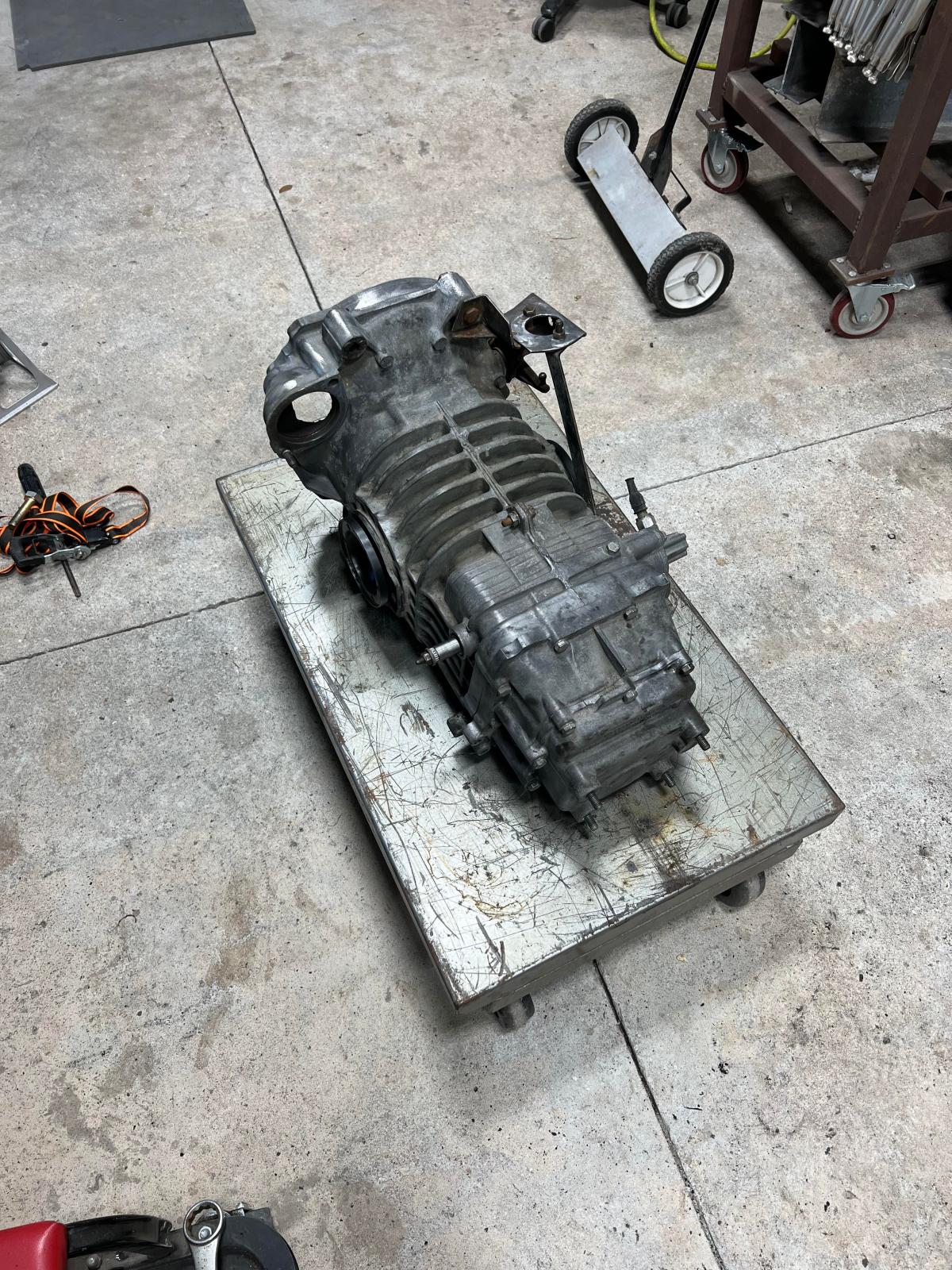

Trans has also been cleaned up.

Forgive my ignorance.
Is there any other support for the front suspension? It seems to me, that the single 2x4 box steel welded to the 3/8" bulk head is a weak point.
Sorry for the dumb question. I'm a street car guy. But always curious on what folks are building.
Yes, it gets tied back into the roll cage. I dont think it would hold up just like it is.

72BajaBen wrote:
Bad_chopper wrote:
I have been wanting to buy that A arm kit as well. my only issue is the exact width. have you got your ride height figured out yet? and if so do you know what the over all width is? like from say outer edge of spindle to outer edge of spindle? my limitations on width is my toy hauler.
As it sits right now its 61" wide...tip of the spindle to spindle. The kit is supposed to put the hubs at the same width as 3x3 arms. ~ 72-74" over all.
My 3x3 arms are 54" bearing face to face...so that seems pretty close once you include the stub axles.
Check back...within the next 2 weeks its going to be a roller and I can measure it for you again. Just hit me up again.
cool, when i called about them, i was told the 72 to 74 as well, if they are 72 im good if they are 73 im almost hitting 74 i hit. this looks like a pretty awsome build, i just did a lot of work on mine last year. my rear is done, but the front sucks, still ball joint.
check my build out looks like we are pretty much doing the same thing. i am a 97 ej22 but it is now on a stand alone ecm no longer using the subaru ecm.
thanks for the quick reply by the way
my build page http://www.thesamba.com/vw/forum/viewtopic.php?t=536267

I ordered this kit with BJ stubs on it. I already had the BJ disk brake kit on the car. I can always buy or make Link or Combo spindles if I upgrade to that in the future.
I also plan on running a 7x15 tire in the front so its going to be skinny compared to the 10.5s on the 3x3 arms.
