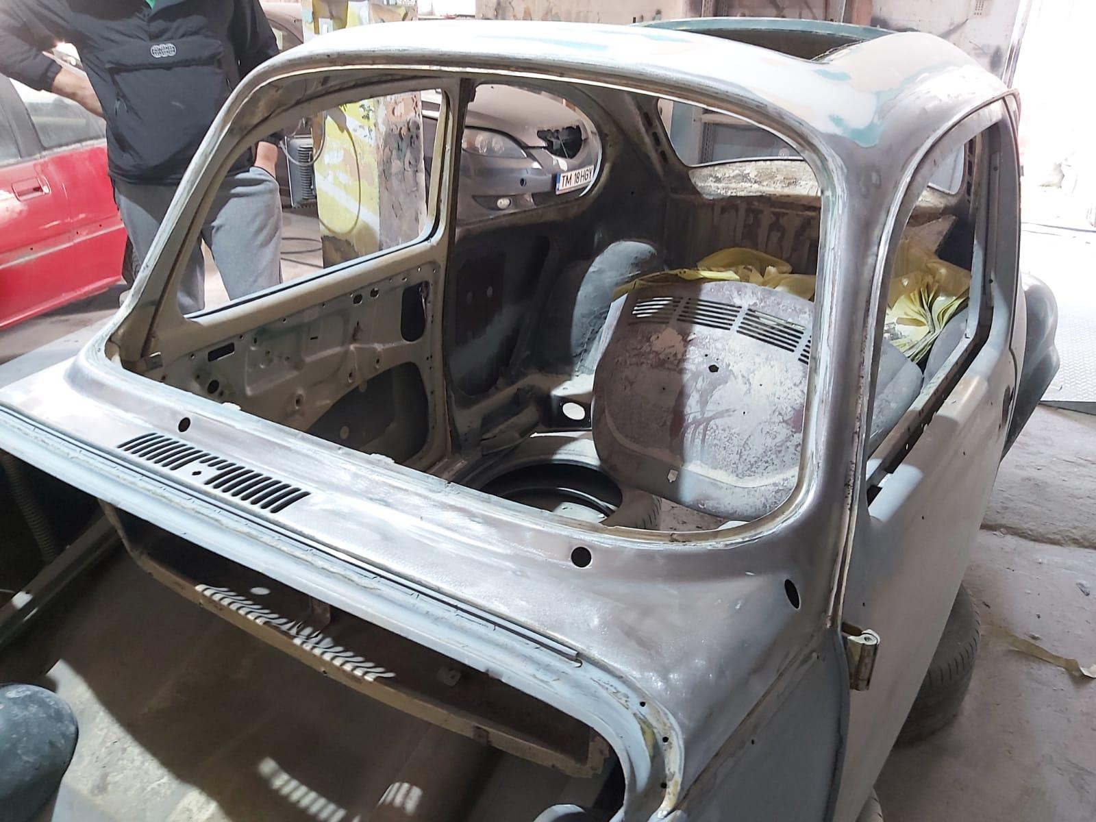

Progress! The team from the body shop re-aligned the doors and are working on preparation for paint. Unfortunately the original paint reacted to the filler and primer, so it had to be cleaned off...

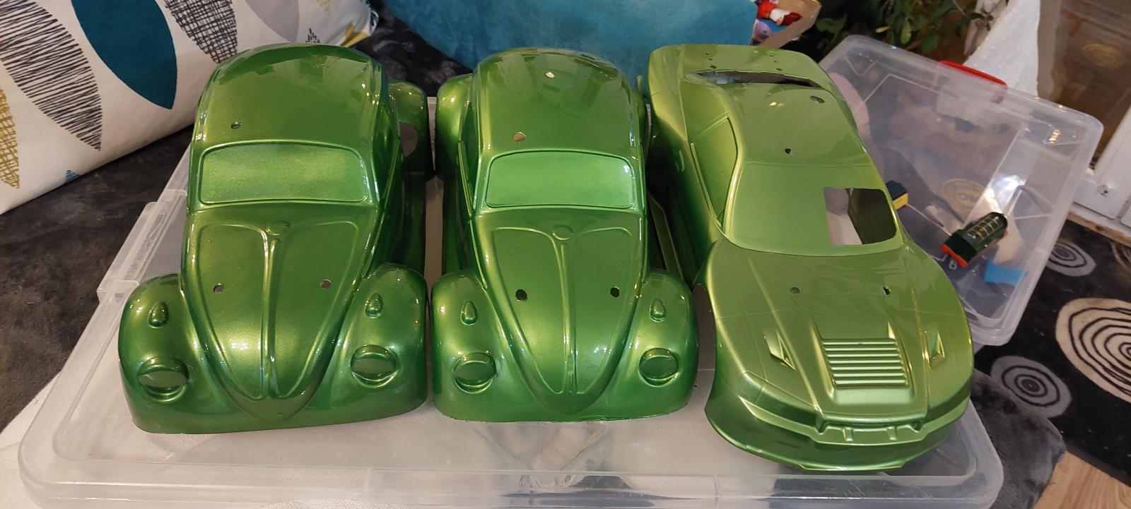

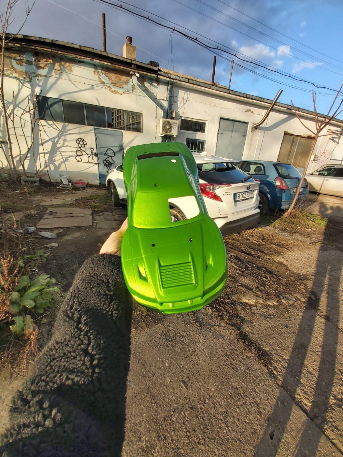

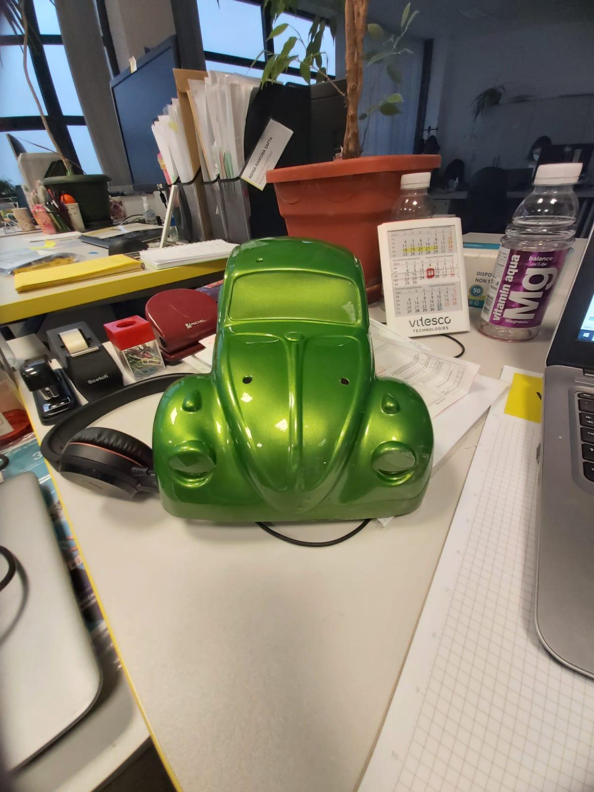

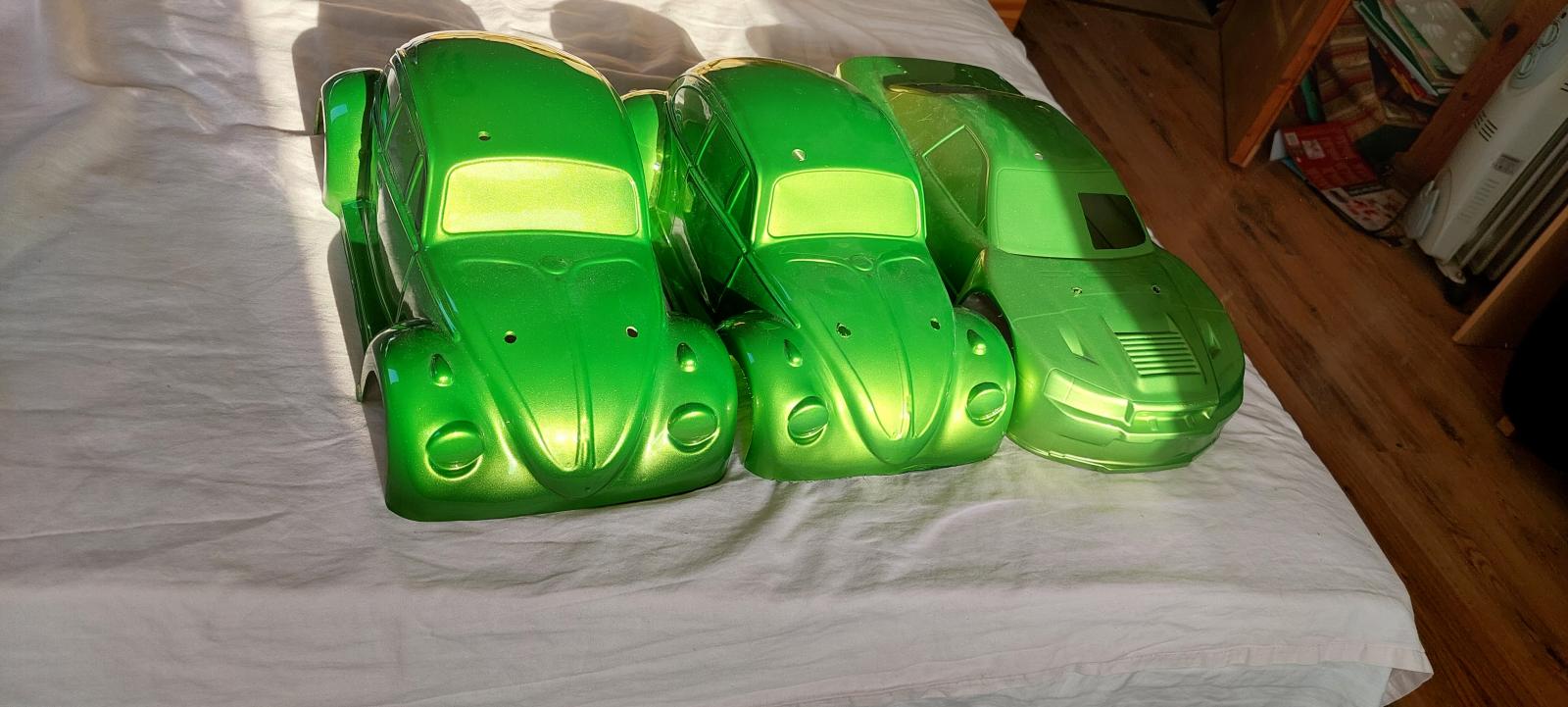

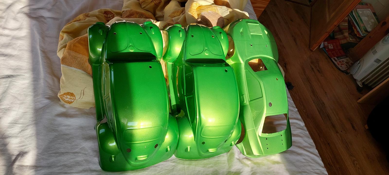

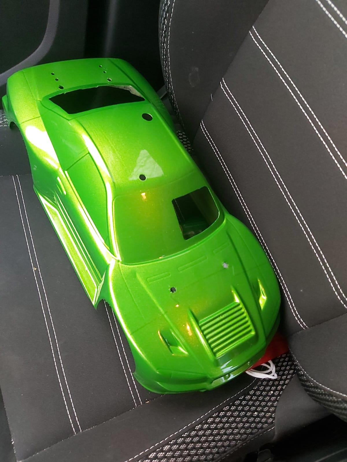

Peek preview! 1:10 scale model, combustion engine RC car.

PostPosted: Thu Nov 18, 2021 3:22 pm    Post subject: Re: Cipica, VW 1303S from '74 Reply with quote
I Looooove that color!

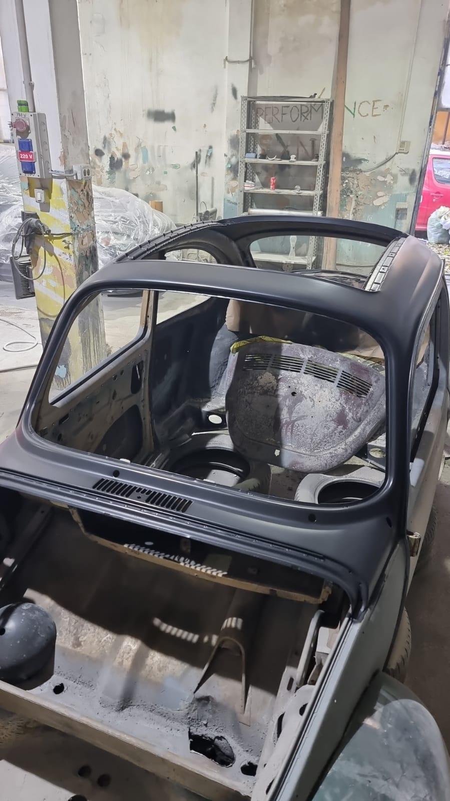

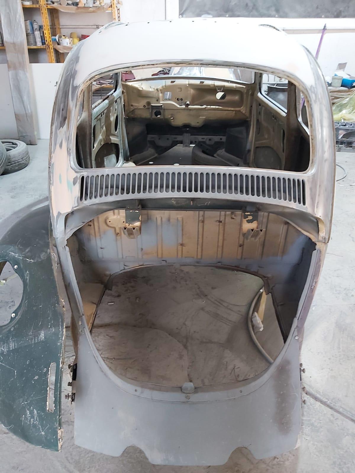

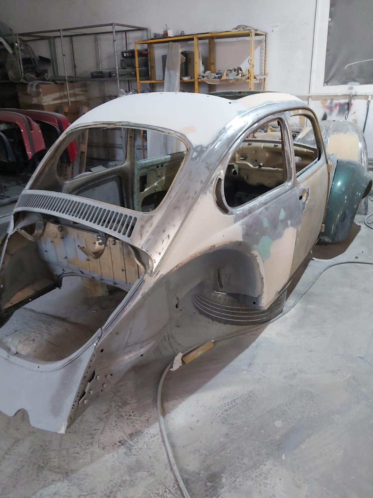

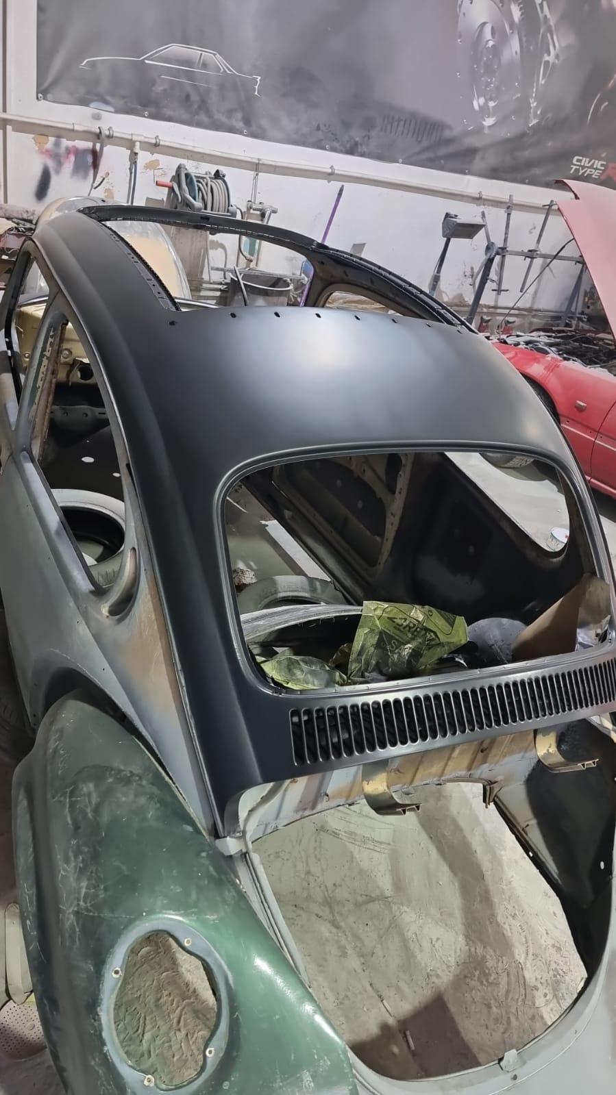

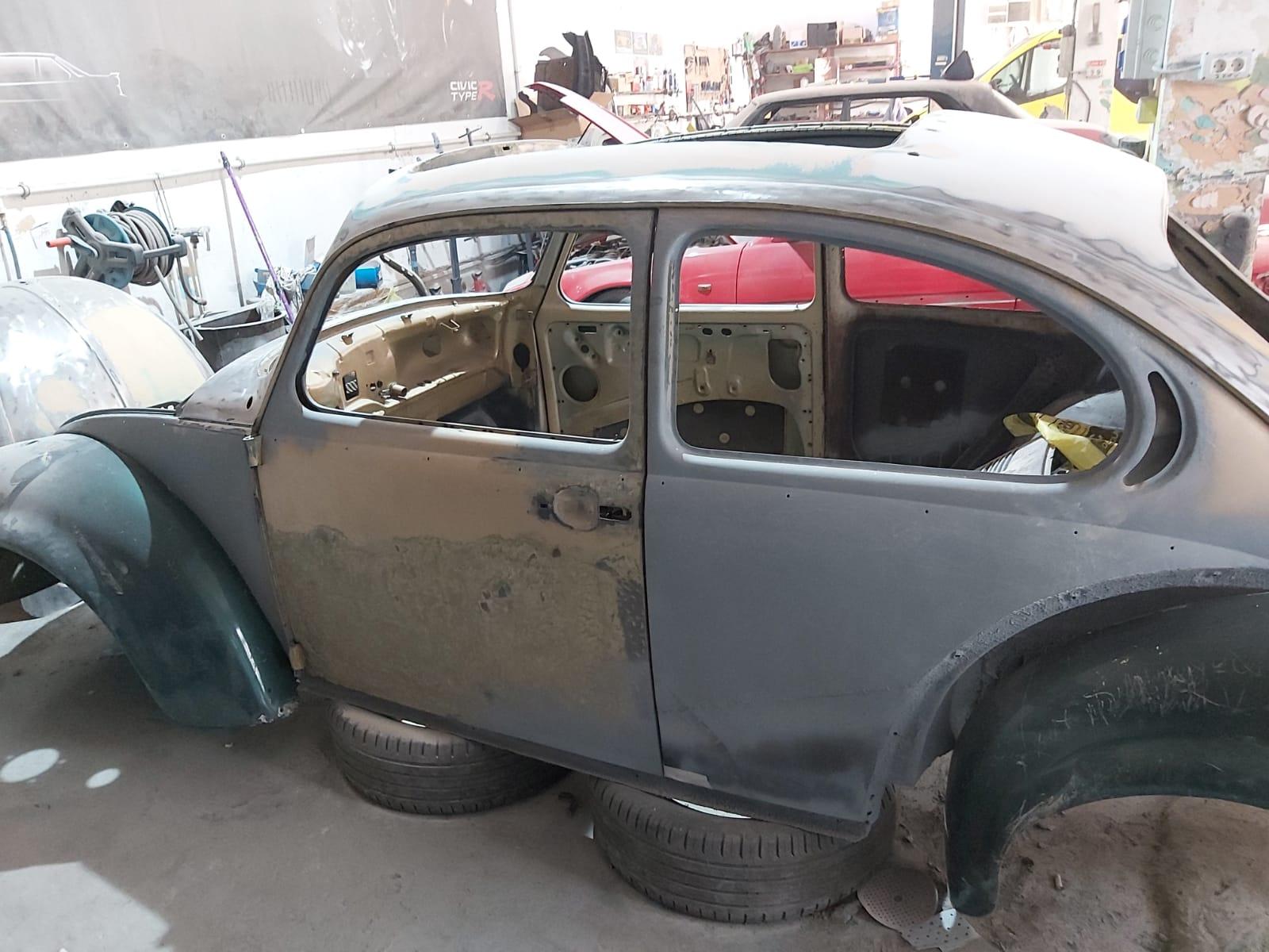

And some more work on the body: Almost all right side is done. Front hood done, rear hood almost finished.

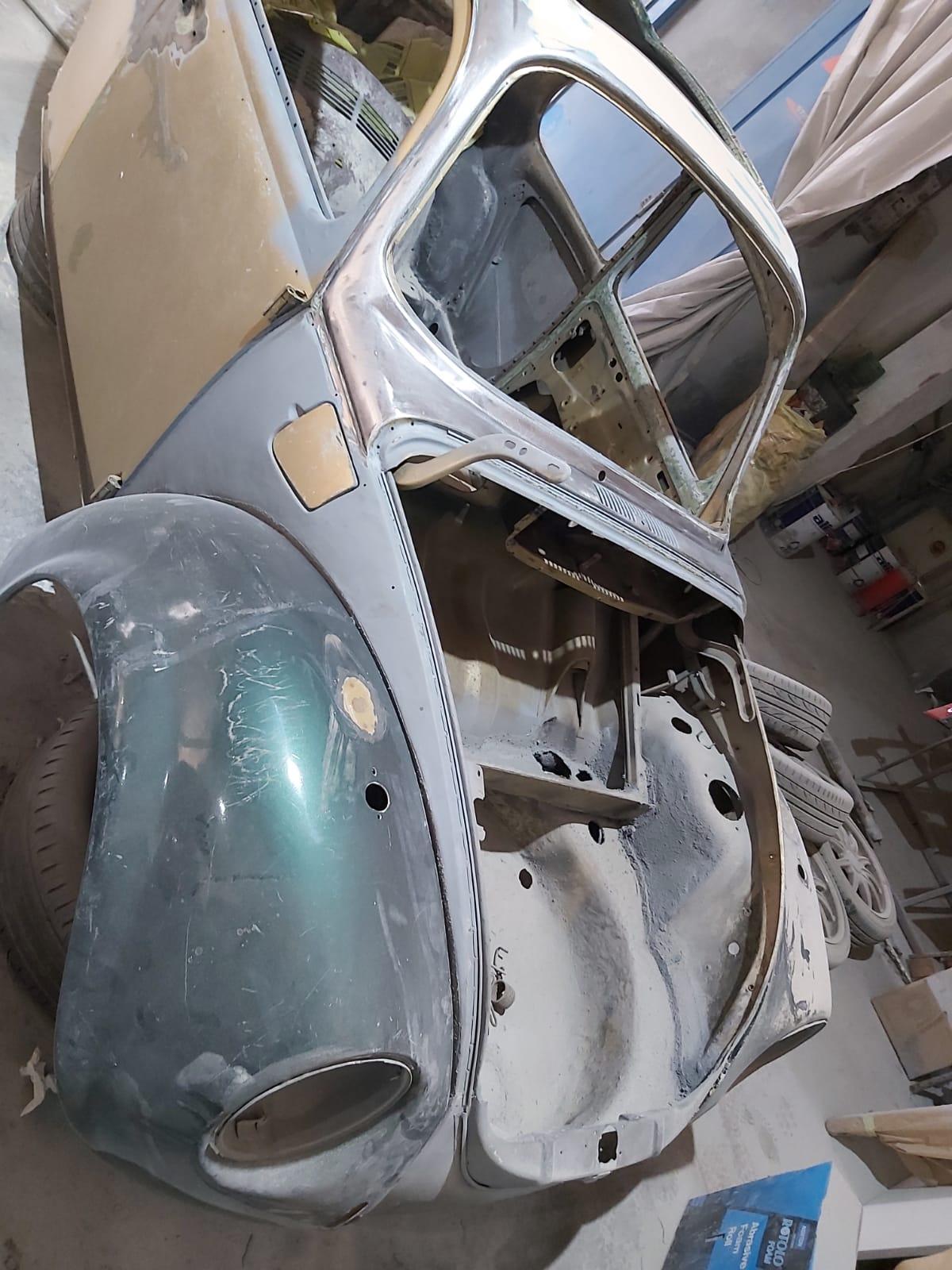

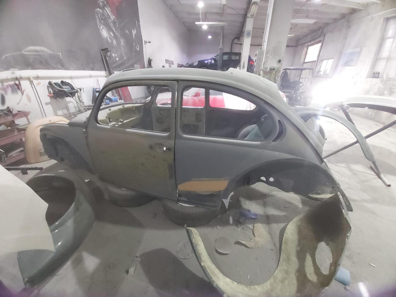

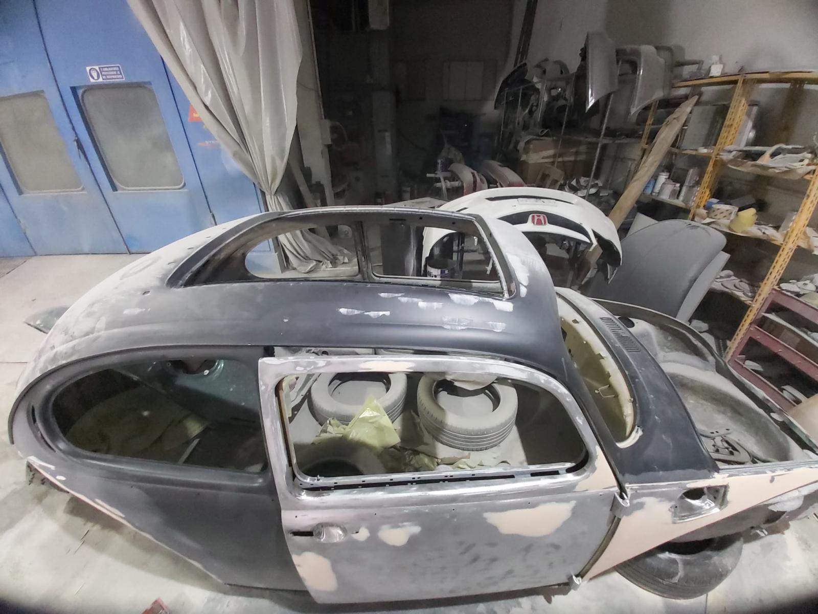

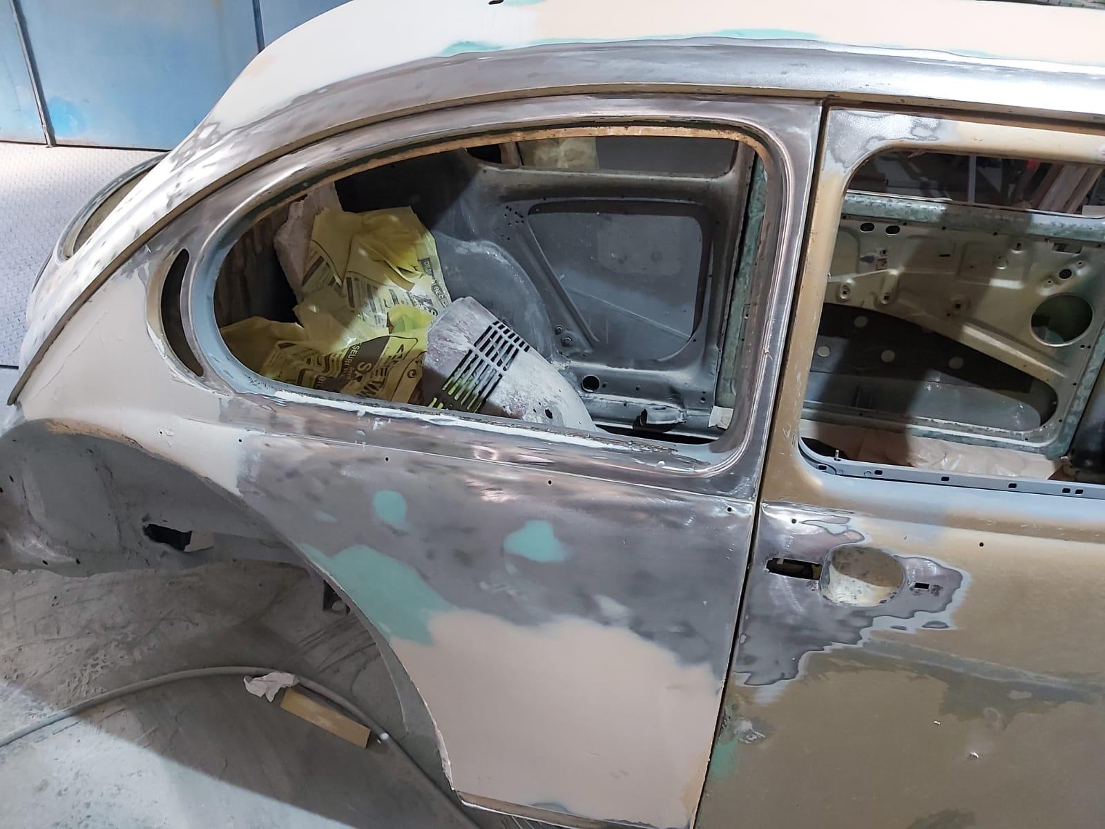

Today, not so happy. I went to the workshop and the preparer put waaaaaaay too much bondo on the front and rear line where the fenders meet the body. He did not realize that there is the fender beading that takes any issue. So he somehow made the bondo go over the fenders by a few mm. I asked to take down all that bondo and follow the body line, just to fill the imperfections in the body.
Why I am so upset is that I had given them the fender beads to check, and asked them to call if anything seems not to be right.
The poor guy had the best intentions and worked a lot to make everything look right. Unfortunately he got it wrong. Now, it will be corrected...
And I am not satisfied with the color (LY6W). It looks great out in the sun, not so good in shade/low light. Therefore I gave two more plastic RC car bodies to try L98B ('75-'77 Viper green metallic) and L96N ('76-'78 Lime green metallic/Viper green metallic). This is the hardest choice I have ever had to do.

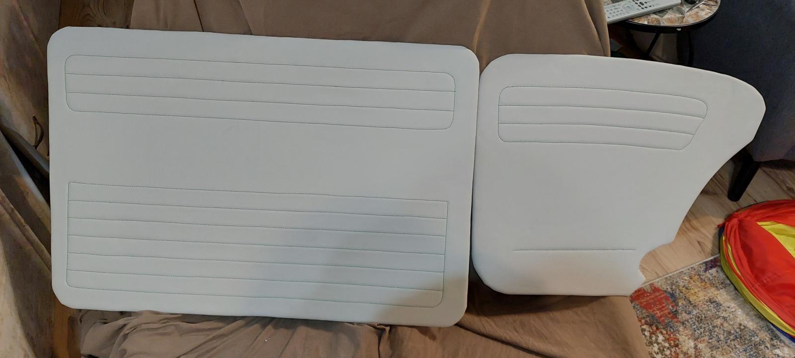

Small update, because I know you all like pictures. Door and rear panels. Sewing by my wife.

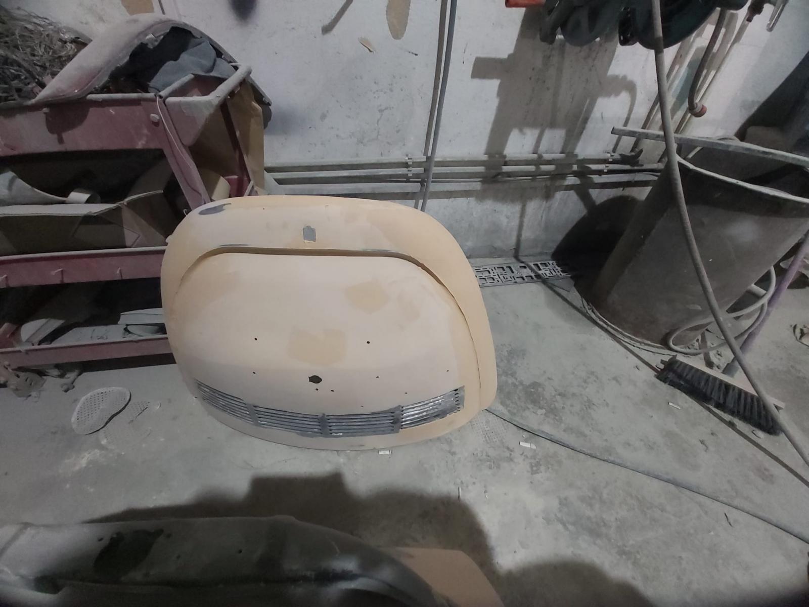

I bought a new engine hood, it fits pretty well. Left side is also done, now just the fenders need a bit of corrections and the front valance where it was welded. Then PAINT!

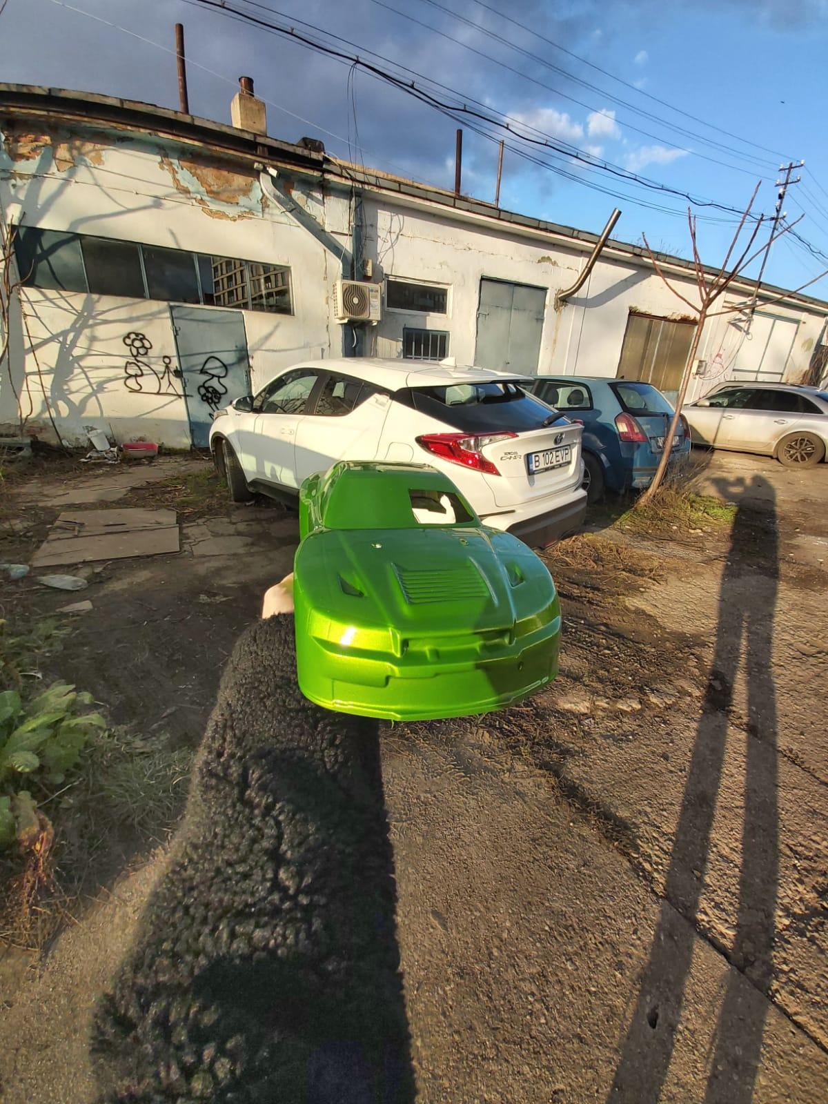

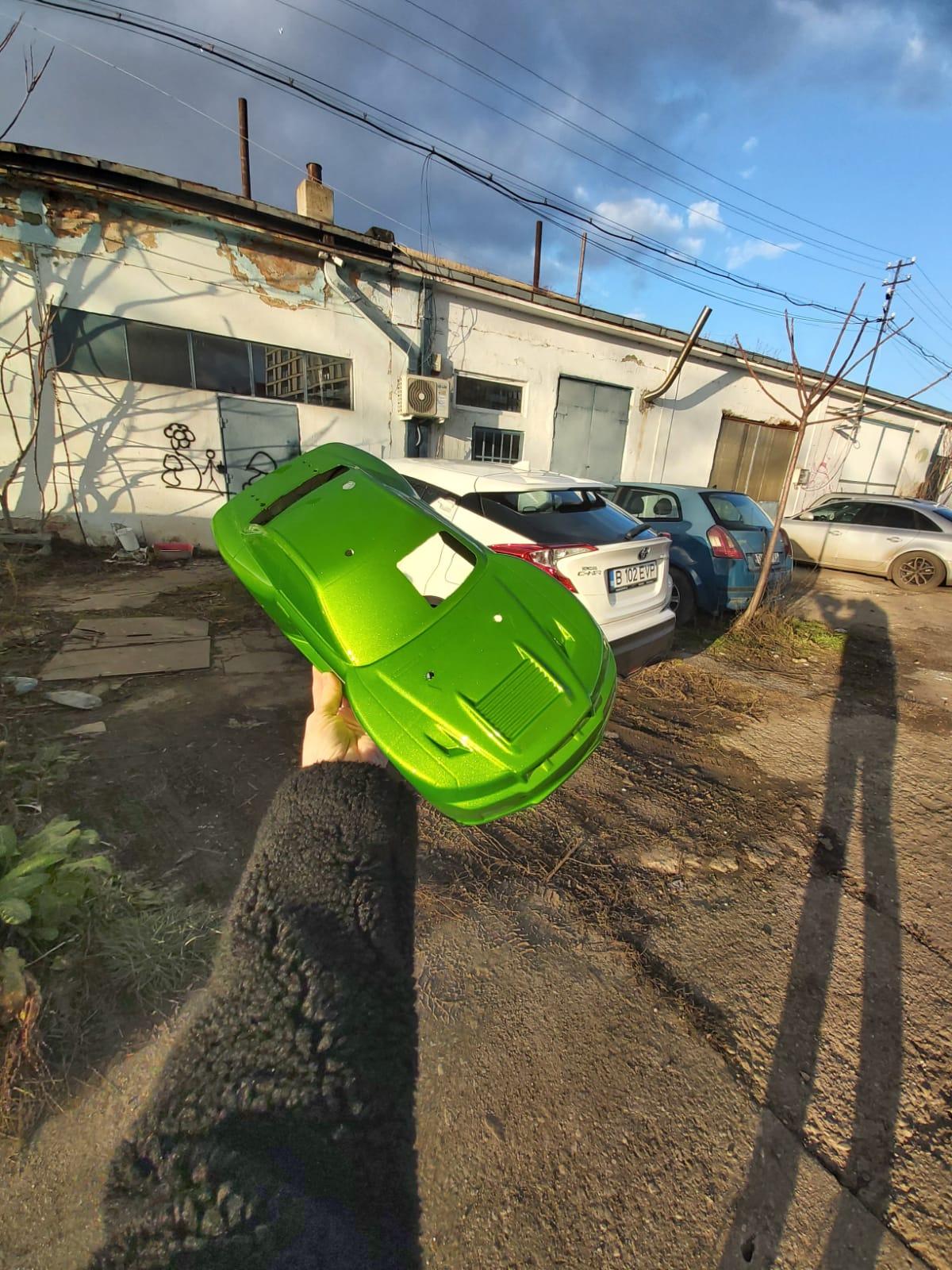

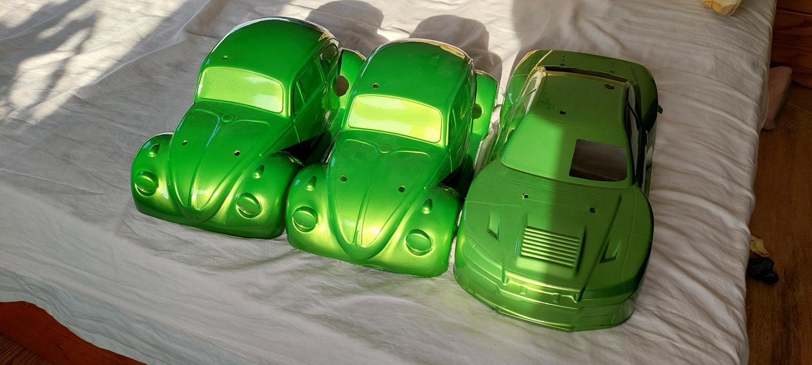

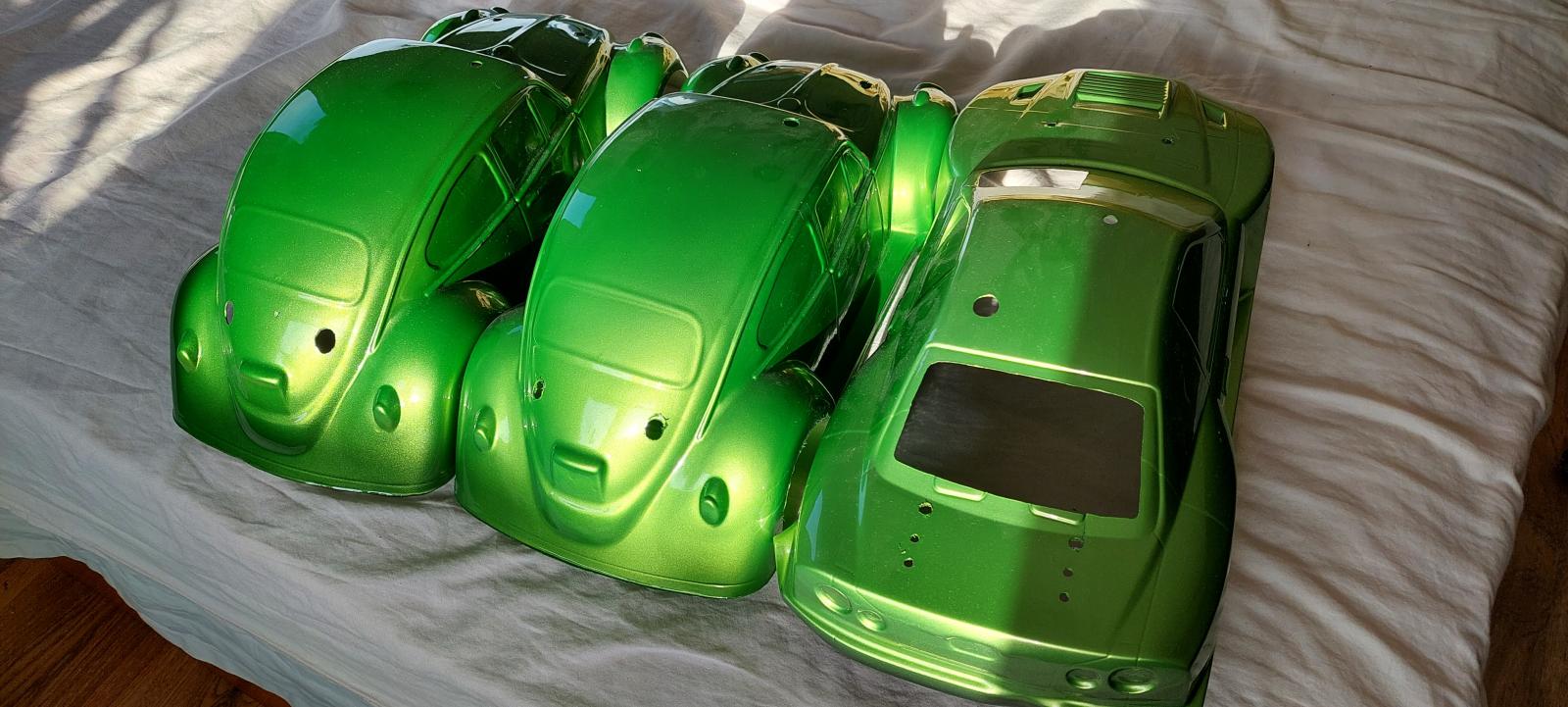

So, on paint: I liked the first option under light, but not under shade. So I requested to paint some other toys so I can compare them side by side. Beetle on the side: Audi LY6W, middle beetle: VW L98B, Nissan on the other side: VW L96N. I will go with the L98B, with some extra metal powder as in the Audi color. It looks like VW knew very well what they were doing.
Artificial light:
And in sunlight:

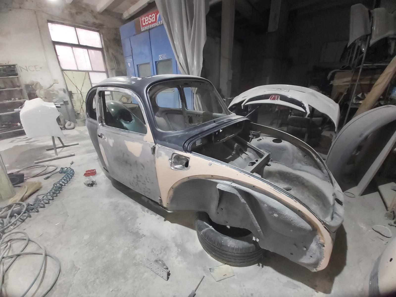

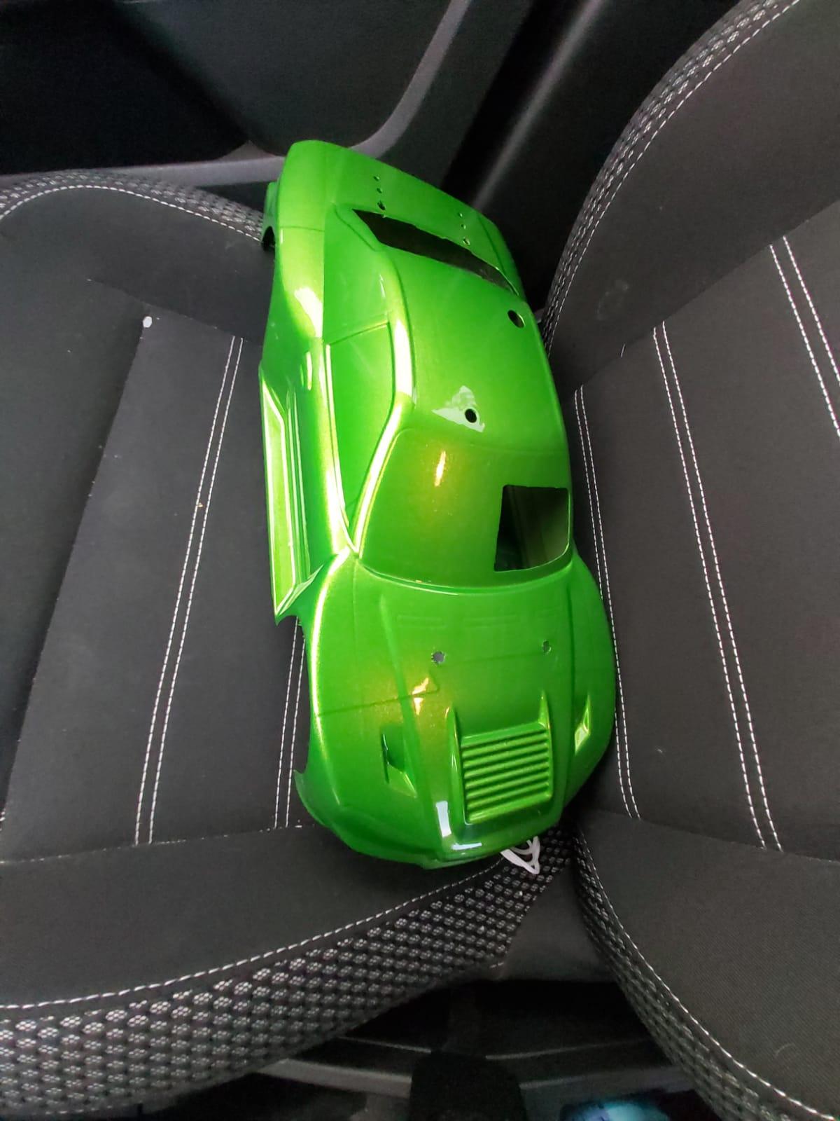

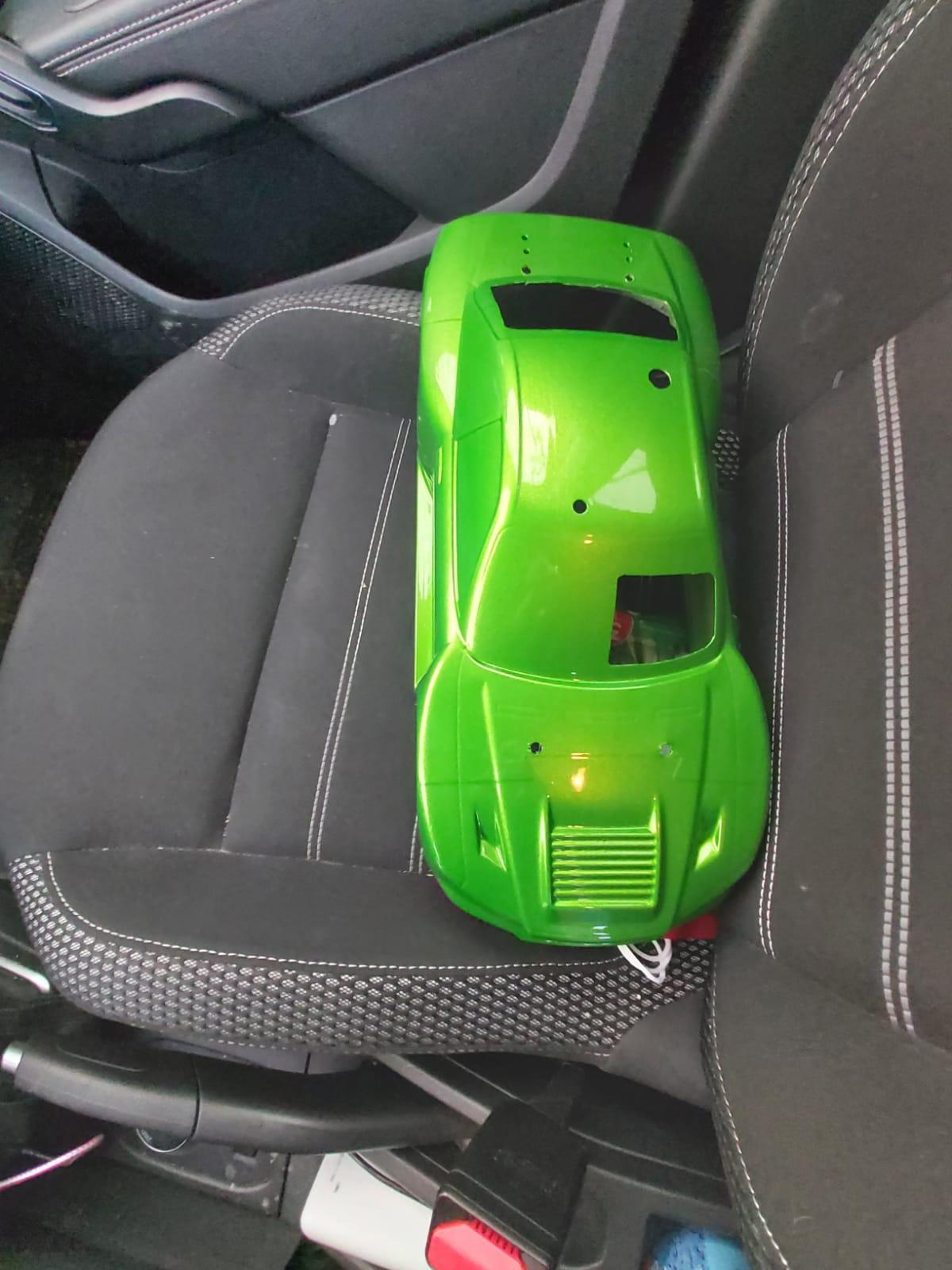

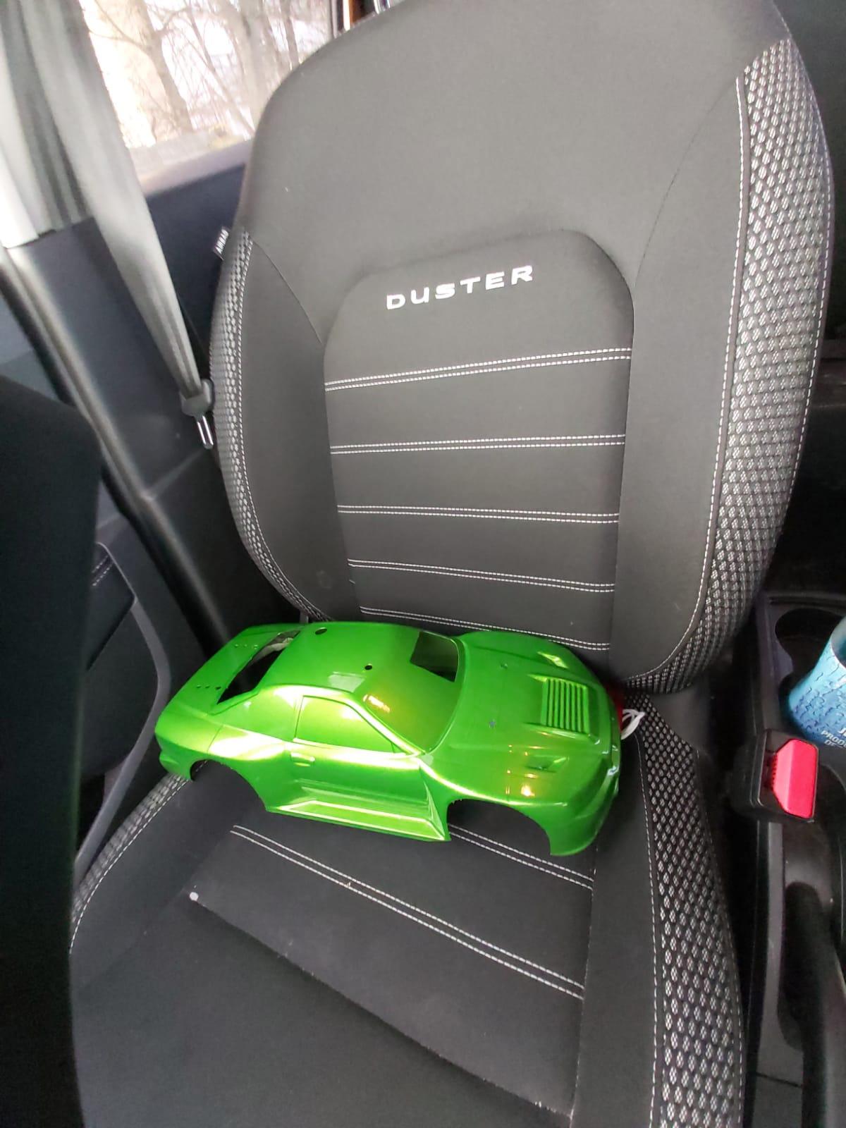

Getting really close to paint: preparation almost done.

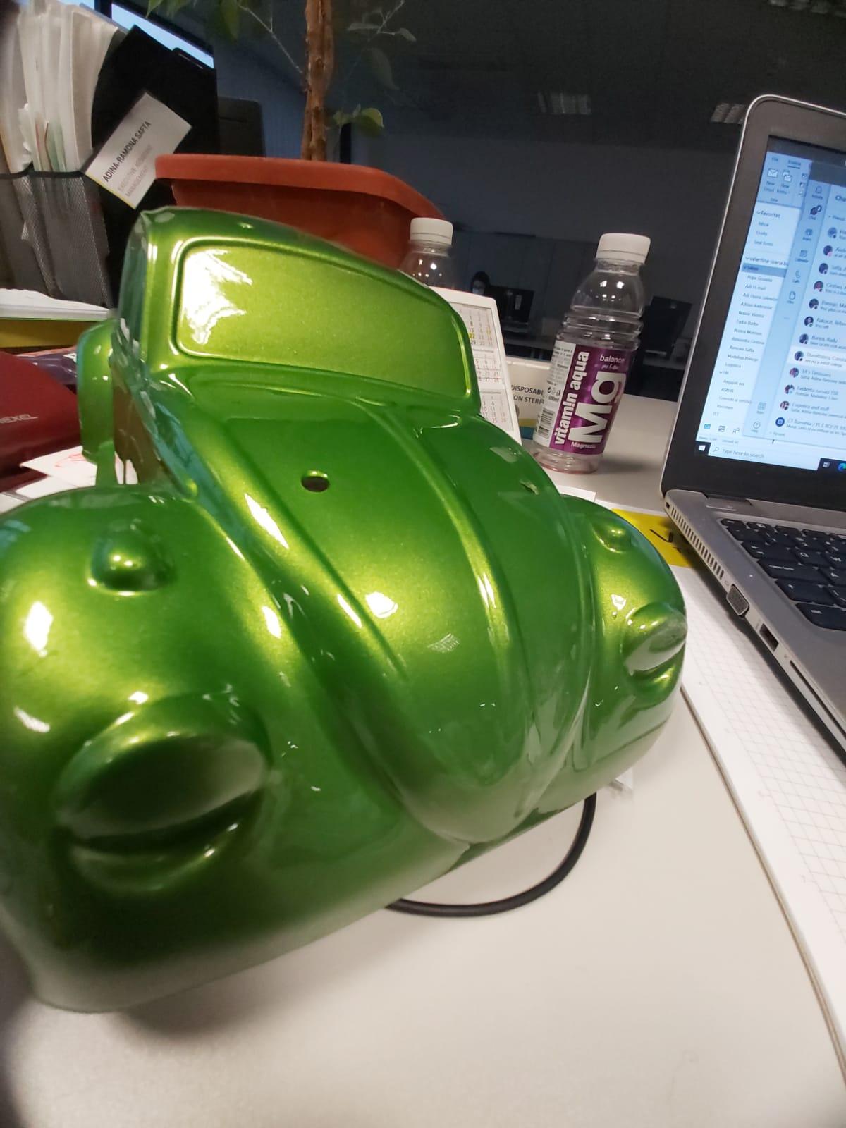

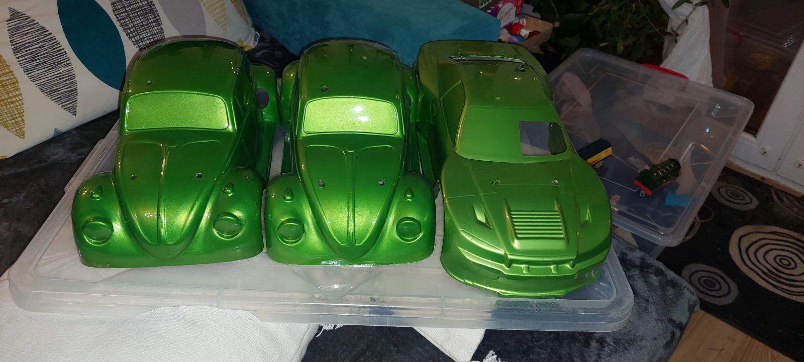

And the result of L98B with the metal pigment from LY6W. We have a winner!

PostPosted: Mon Dec 20, 2021 7:50 pm    Post subject: Re: Cipica, VW 1303S from '74 Reply with quote
It looks like pearl. That is a winner.

It is not pearl, it is metallic paint. It is actually the recipe of the original L98B (viperngrun) with a different type of metal powder. At the paint shop they told me that the difference is the shape of the metal flakes cutout (hexagonal vs rectangular or something else), therefore it sparkles slightly different. So it results as L98B with a bit extra glitter effect. Anyway this L98B is quite a special paint, it has different shades/tones depending on light, and it is very hard to appreciate from just pictures. I have seen lots of cars painted with it and all looked different...

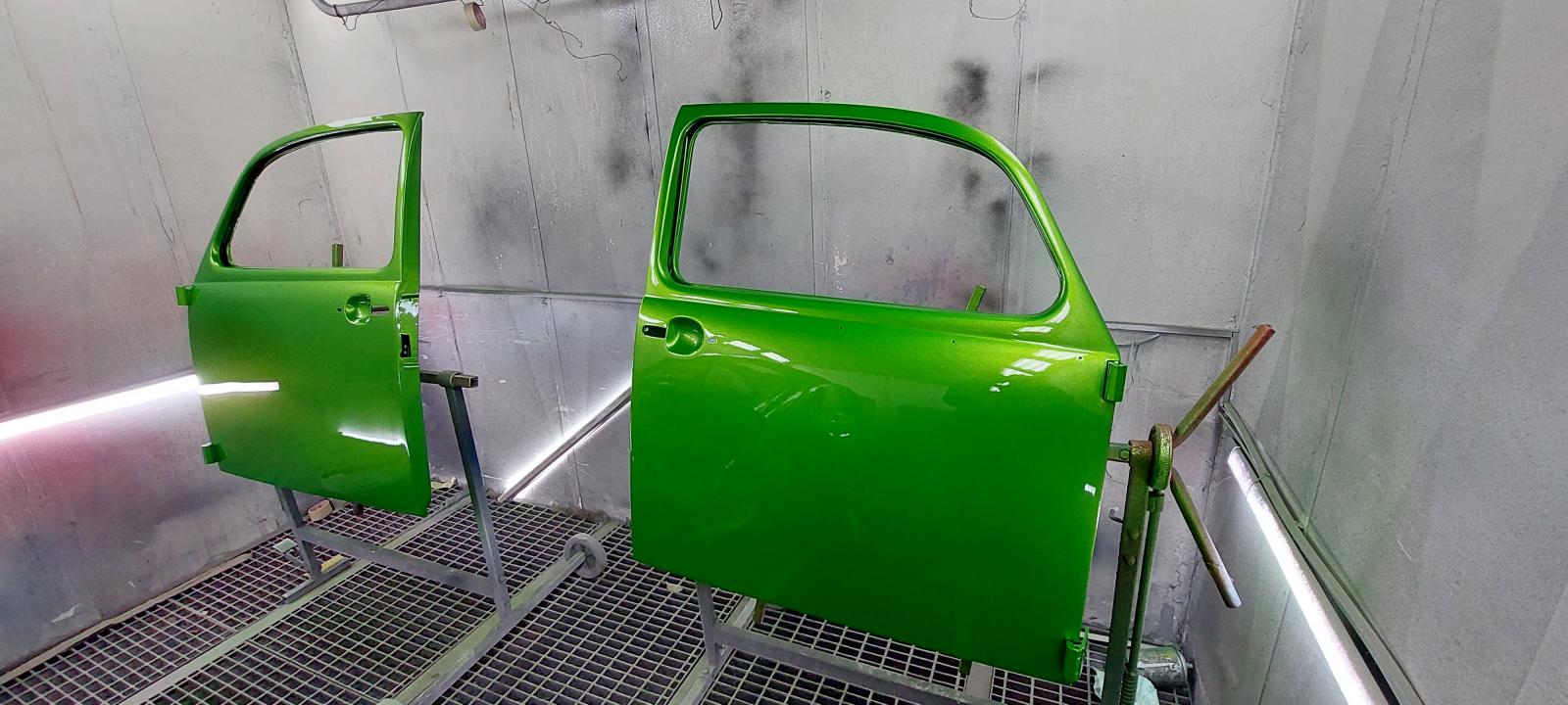

IT'S GOT PAINT!!! That's a great Christmas gift.
