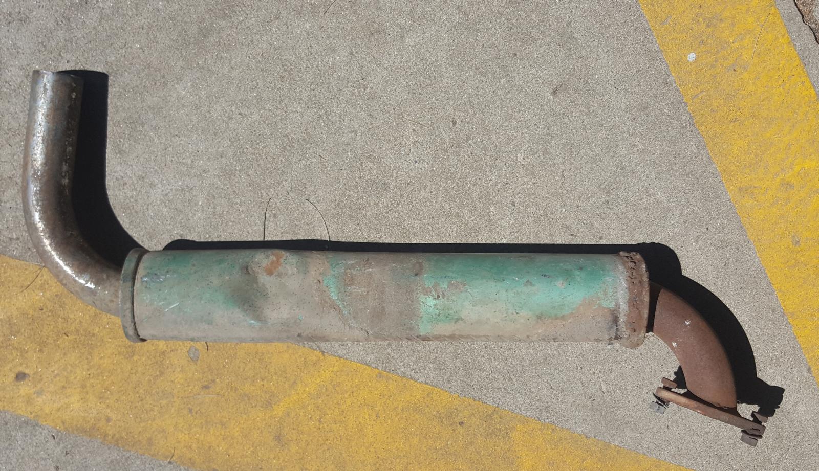

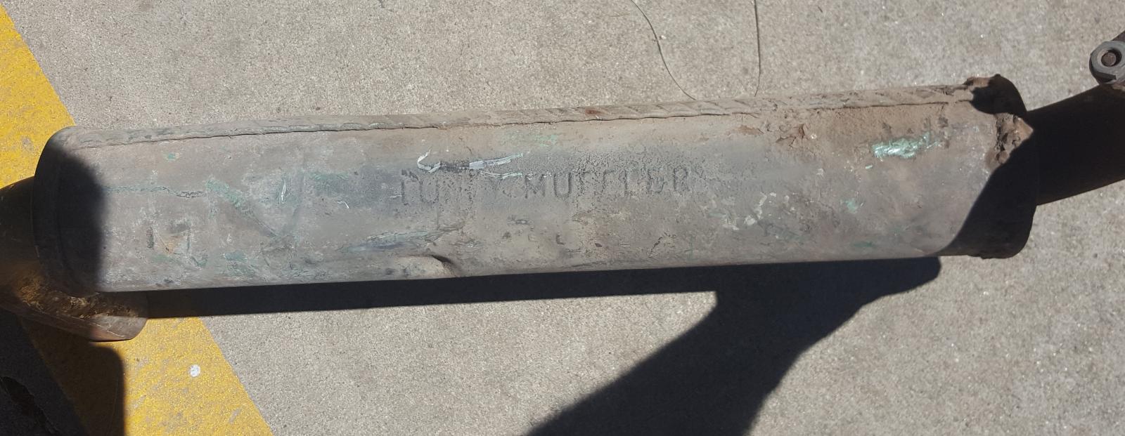

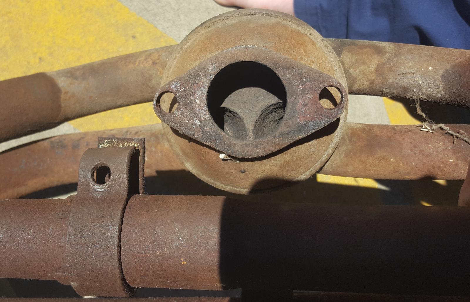

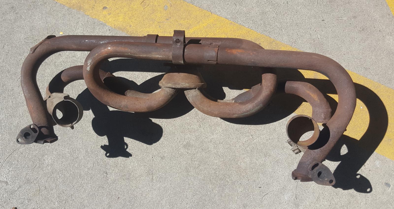

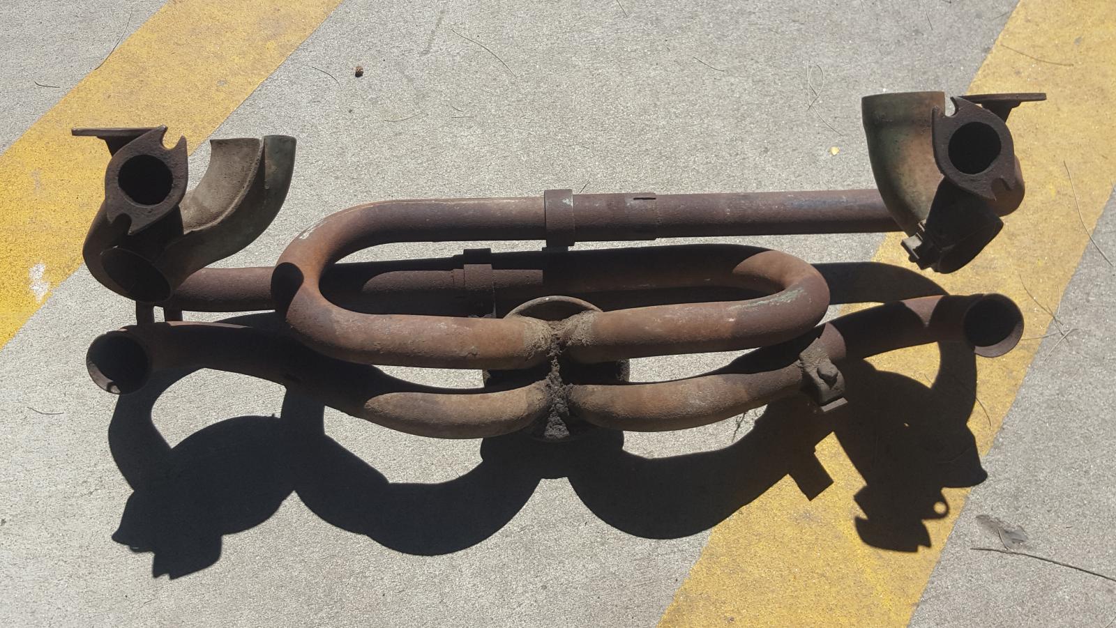

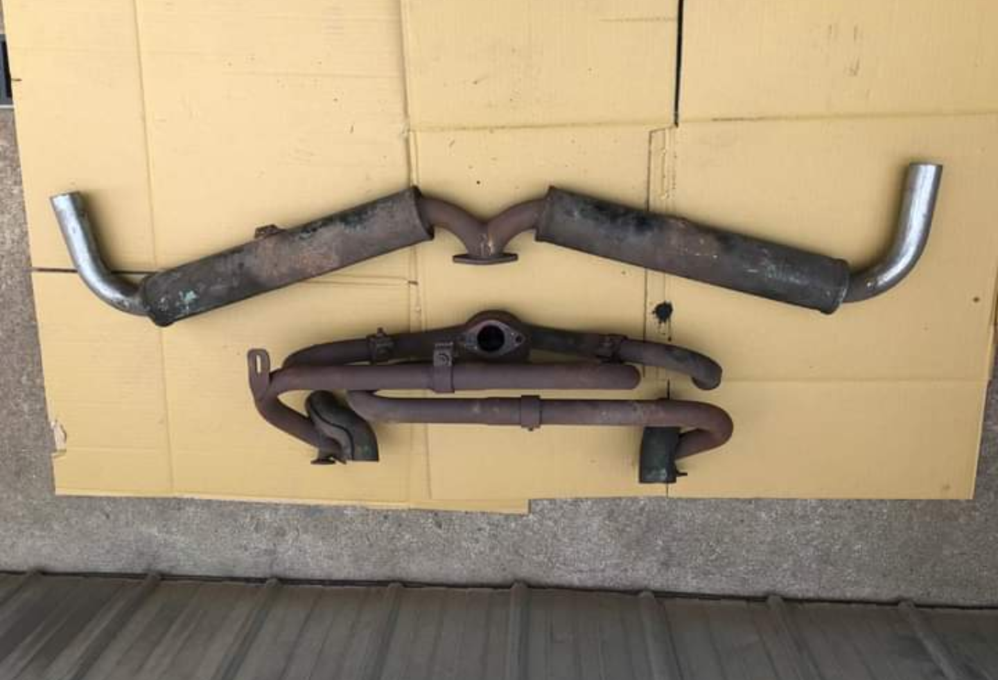

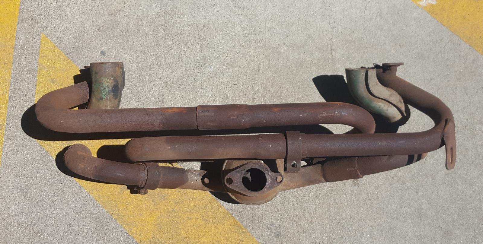

some pics of mine (in as found condition)
i thought this must be a modification of the tuck away style, then i saw this advertised \/, now i am wondering if they were variations.

PostPosted: Mon Jan 10, 2022 8:18 pm    Post subject: Re: Jack Brabham Exhaust Reply with quote
According to the flyers and adverts there was only the wrap around type
these could have been early Lukey muffles someone added

PostPosted: Mon Jan 17, 2022 3:10 pm    Post subject: Re: Jack Brabham Exhaust Reply with quote
I do remember the name Lukey from reading early VolksWorld magazines or even Foreign Car Guide from the 1960's though never saw one in person. Appears to be the first use of a "hide-away"/tuck-away muffler concept. Also, the left tailpipe seems to be non functional and was just included to fill the original left cutout in the Beetle's rear apron. Use of sliding pipes with clamps allowed a universal header for both the narrower 40 hp (34 ps) and later, wider 1300 cc engines.
