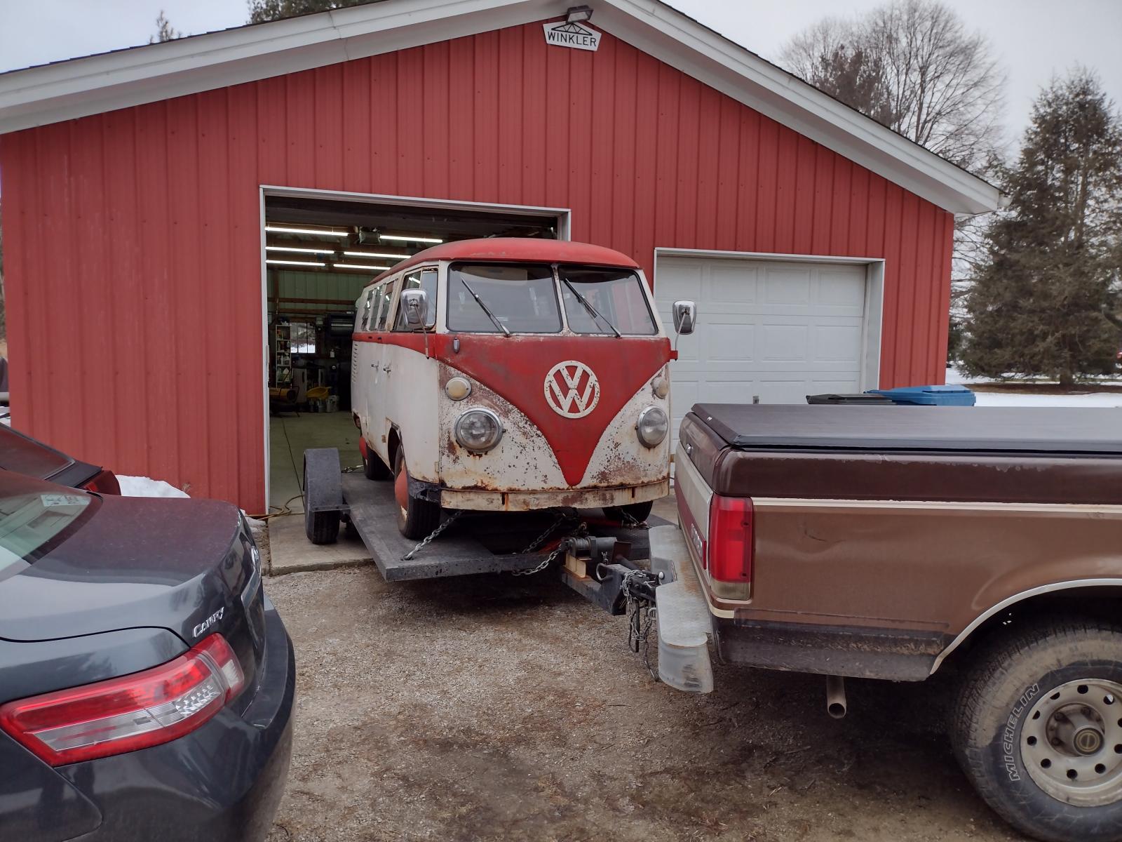

I haven't had a split bus for longer than many on here have been alive. It was a different world for these when I bought my 67 non-walk through passenger bus for fifty dollars. I sold it a few years later for two hundred and fifty dollars to a shoeless, shirtless free spirit who brought his own stool to sit on while he looked at the engine. "Every bus needs a stool" he explained. He opened the rear hatch, set his stool on the luggage tray, and that was that. More than once I have wondered what adventures those two saw along the years.
Never did I imagine that I would have another one. The world is different today, splitty busses didn't fare well in the midwest due to the salt we dig out from under Lake Erie and spread on our roads. It seems that even the ones in other places have succumbed to rust. Project busses nowadays are really templates for manufacturing a vehicle from scratch and I marvel at the fabrication skills on display in this forum. I'm not going to be manufacturing a vehicle on a rotisserie, however, as I don't have time for that. The days ahead are fewer than the days behind, and I have to be realistic. Another reality for me is I've got too many birds chirping in the nest over here to be mortgaging the house for a finished product. So, the split bus was a fond memory to be cherished, but that was all really.

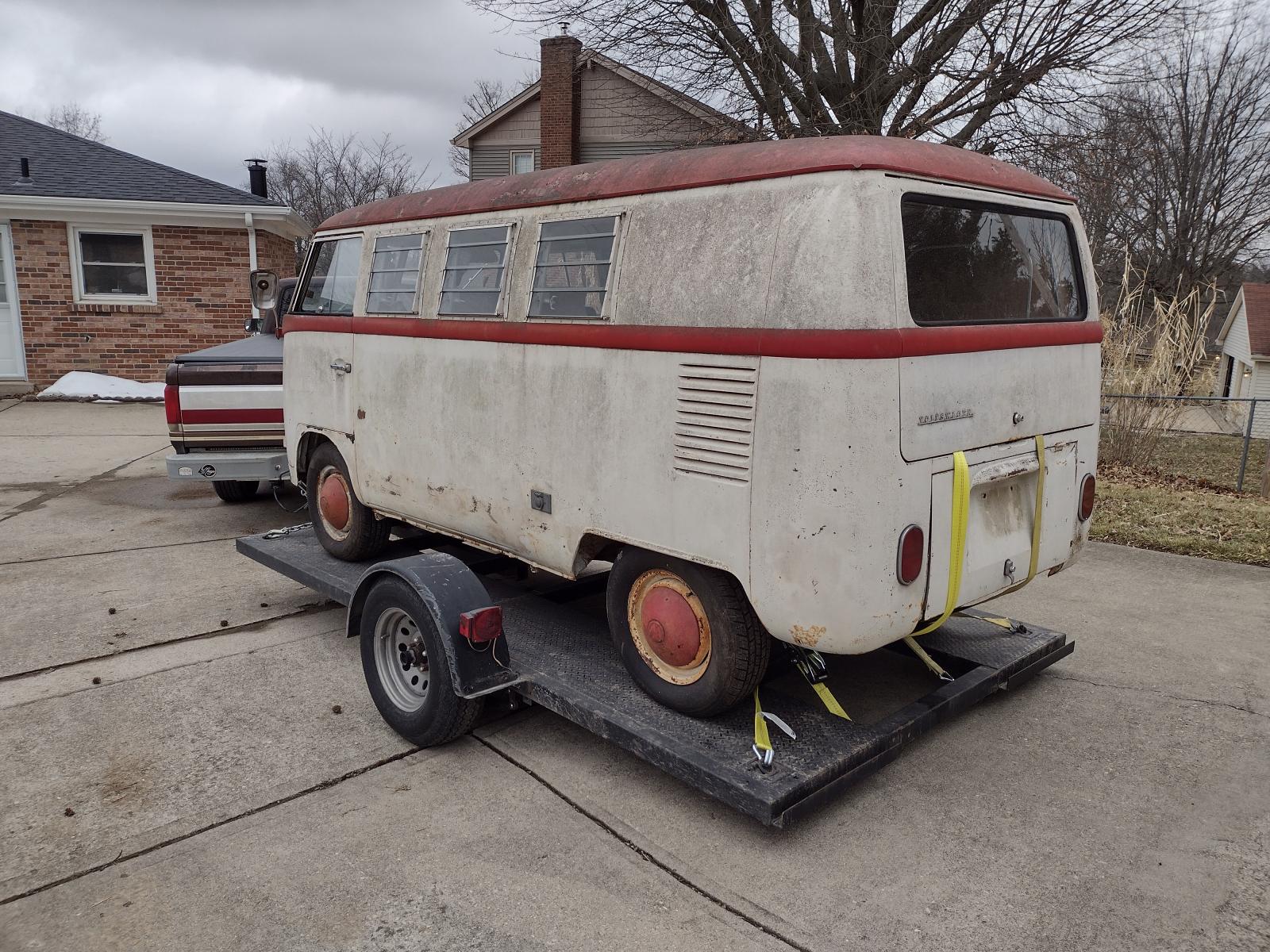

Then, this happened, and I loaded my trailer.

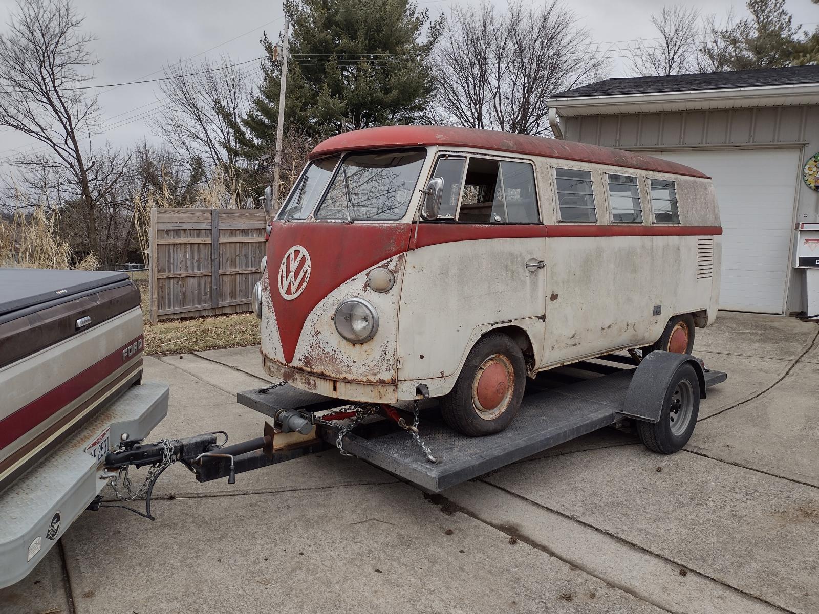

It's a 1966 Bus Camper converted in Indiana by Travel Equipment Corp. I have searched the threads but not yet found a camper by this company. So, I'll show you what it is.
Here we arrive home after a long day of driving dawn to dusk, ready for unloading.

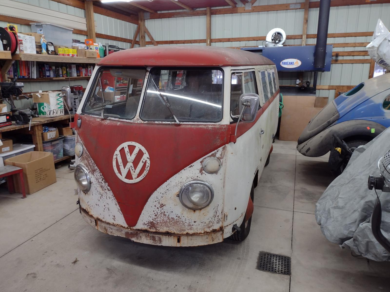

Home sweet home.
I couldn't wait so slid one of the bumpers on just to stare at it a bit before putting away the trailer.
Later that night I found some excuse to go out to the barn in my pajamas in sub freezing tempurature to adjust the air pressure. I really am helpless, and suspect I am in good company.

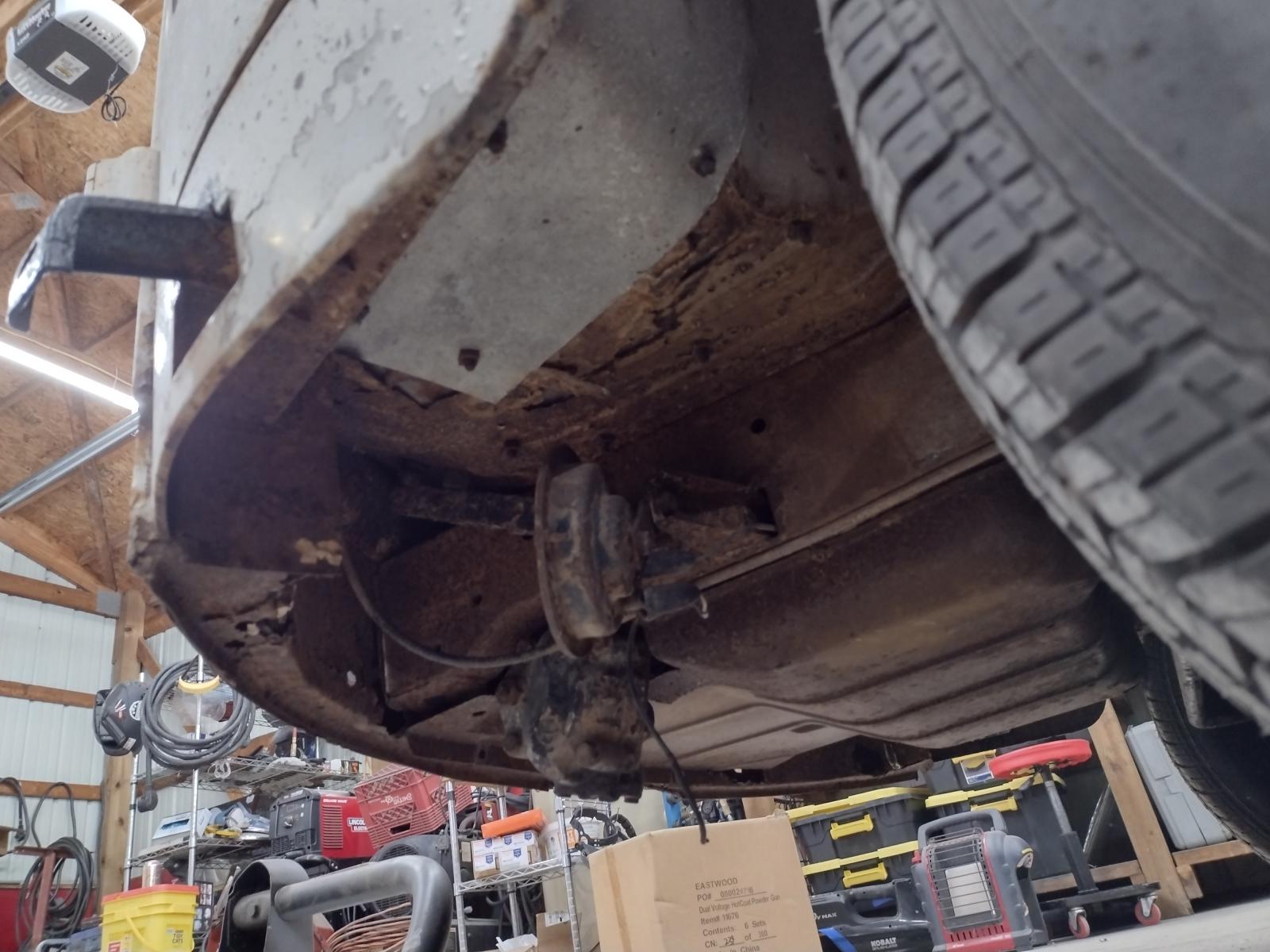

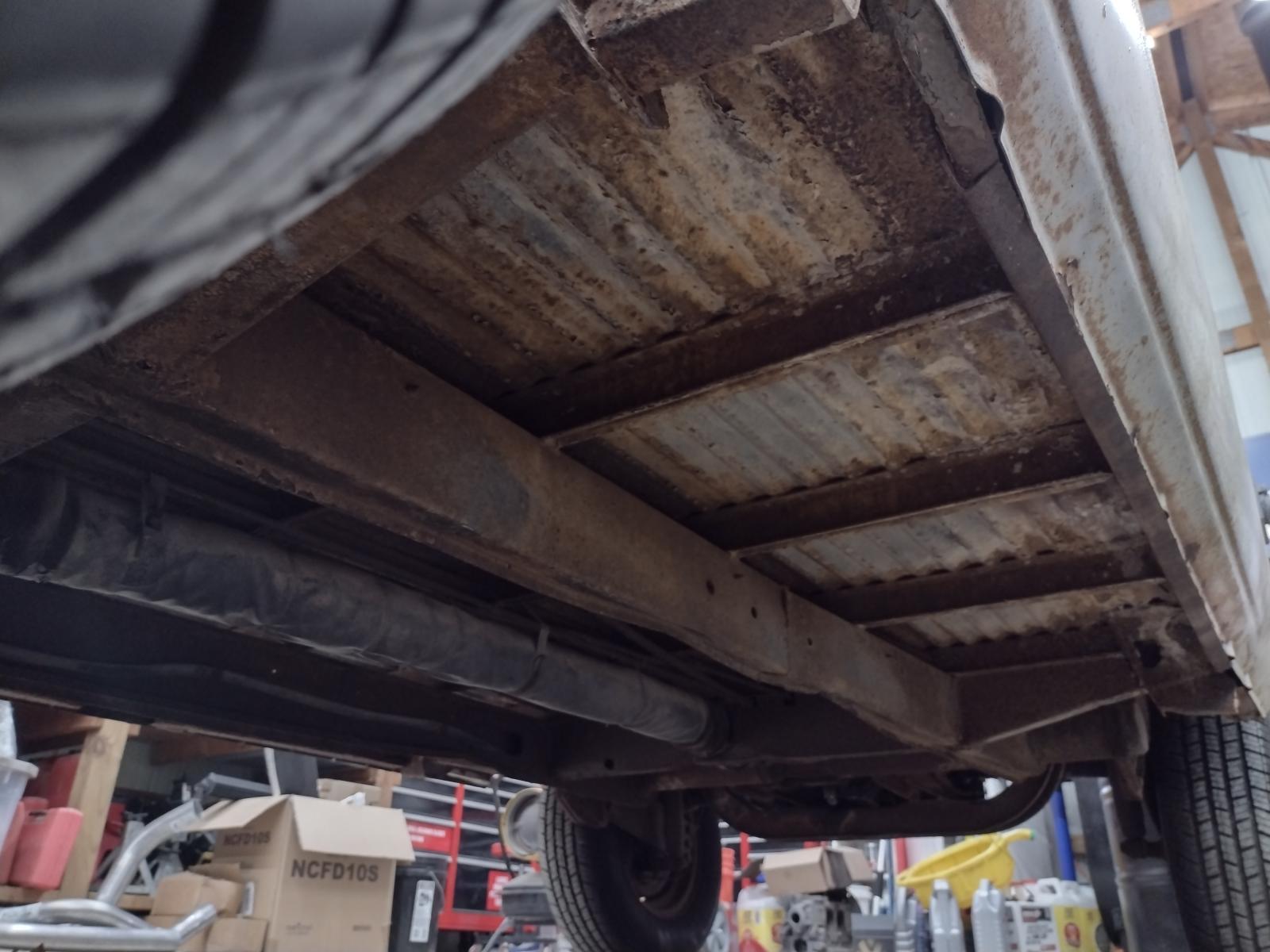

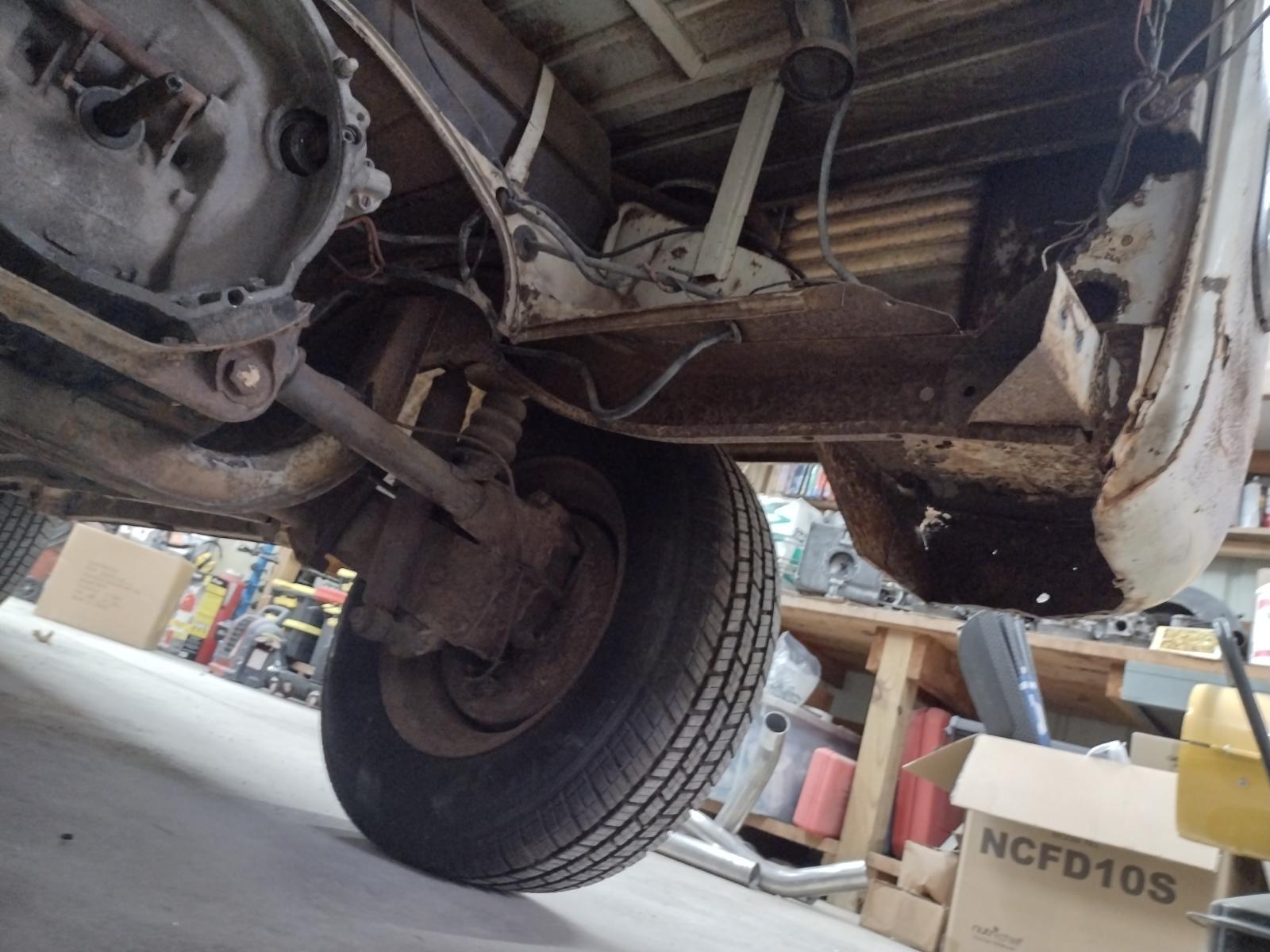

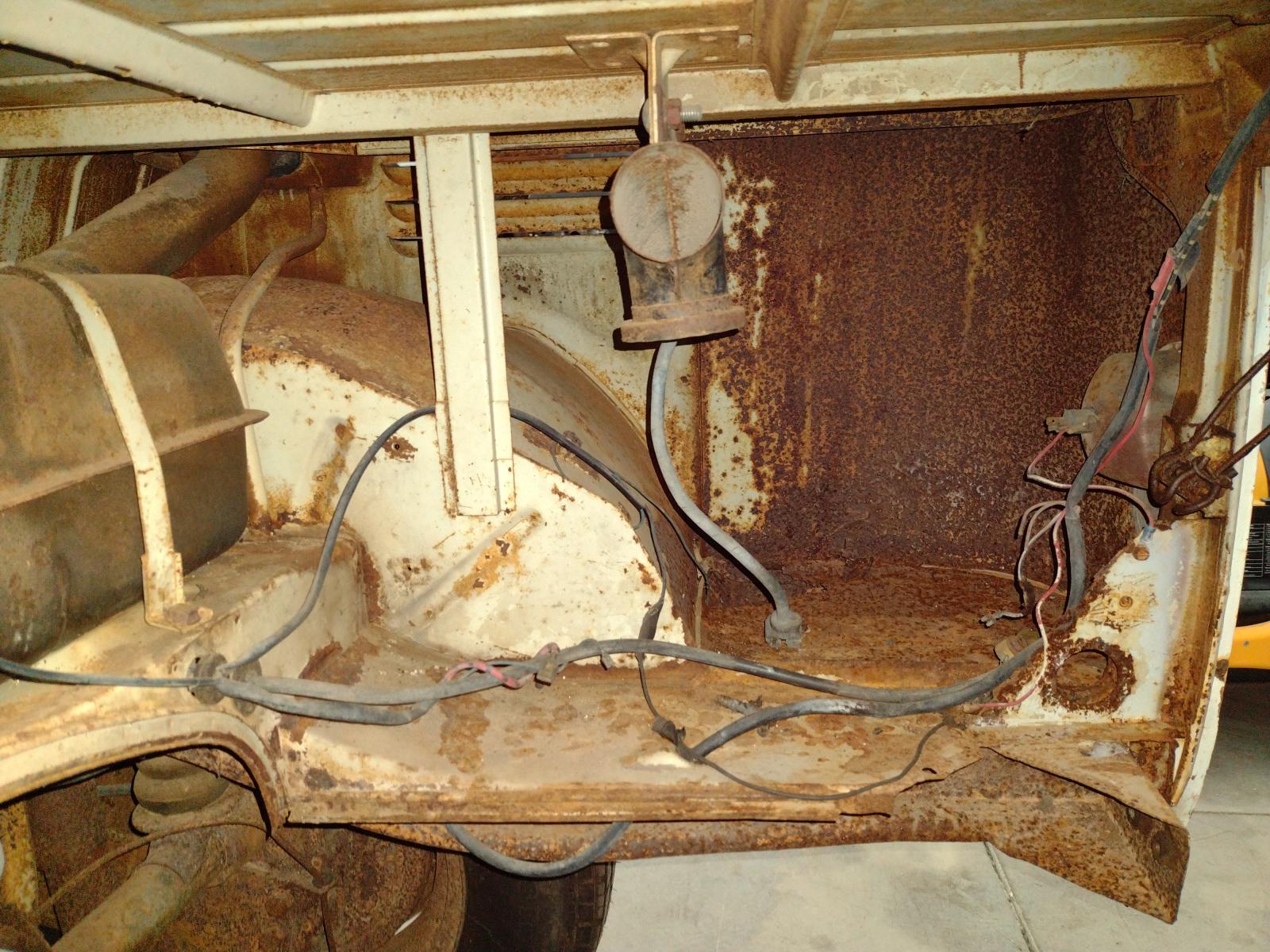

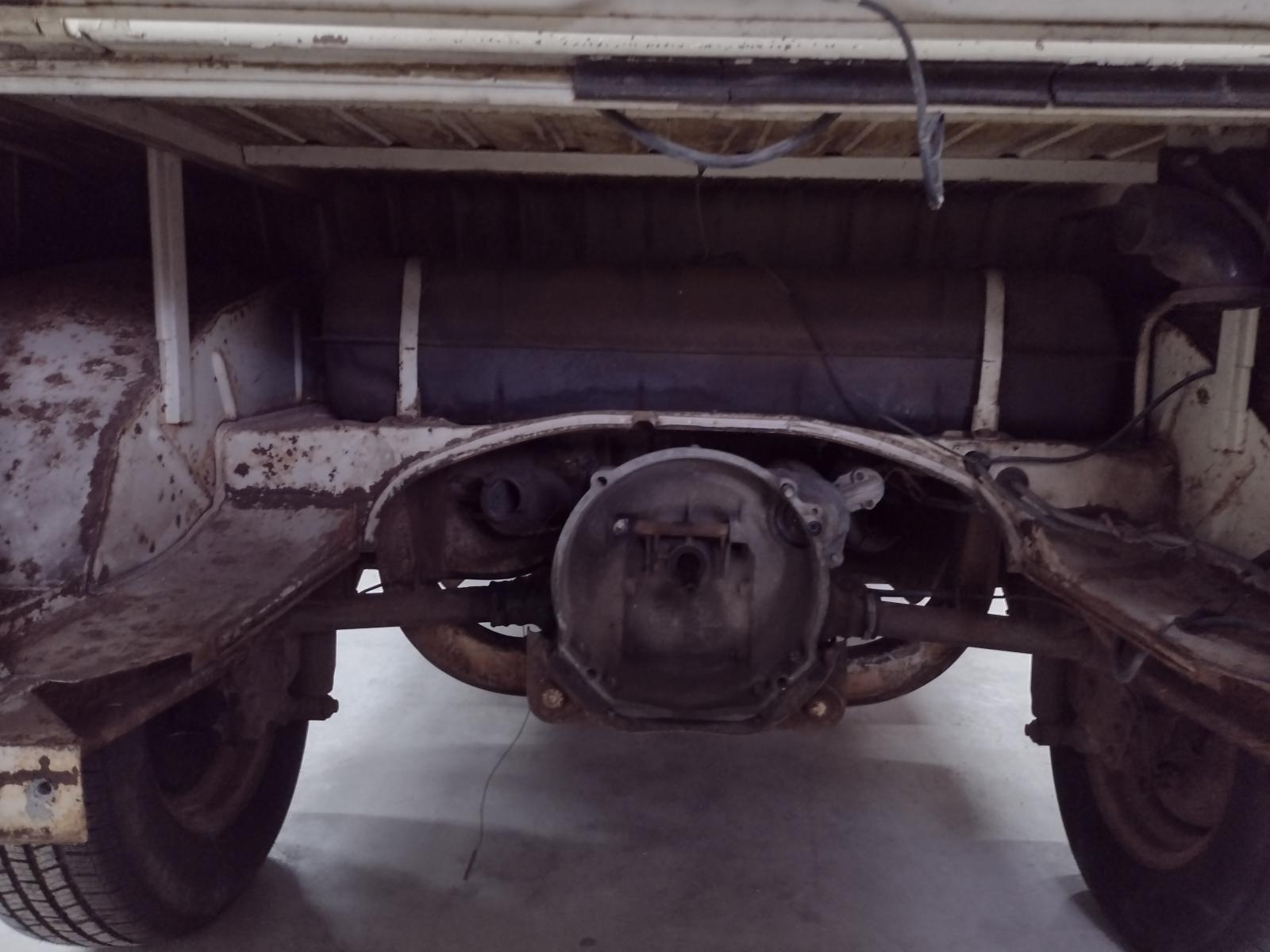

It has had the rockers replaced years ago and the work will not support a nice blocked-out paint job, but is good and solid from a functional camper perspective. I will not be tearing them out. I will be grateful that someone took the time to care about their bus, and now I will enjoy ther fruits of their labor as well. I will also be grateful for the patina trend. This is a first respray paint, not OG, but has weathered in a way that I am enjoying. The nose seam is an issue, inner as well, as is the jack points. The passenger dogleg is a little sad under some POR and there is a rivet patch on the floor at the drivers left foot. Thats the worst of it. Here is a tour of the foundation.

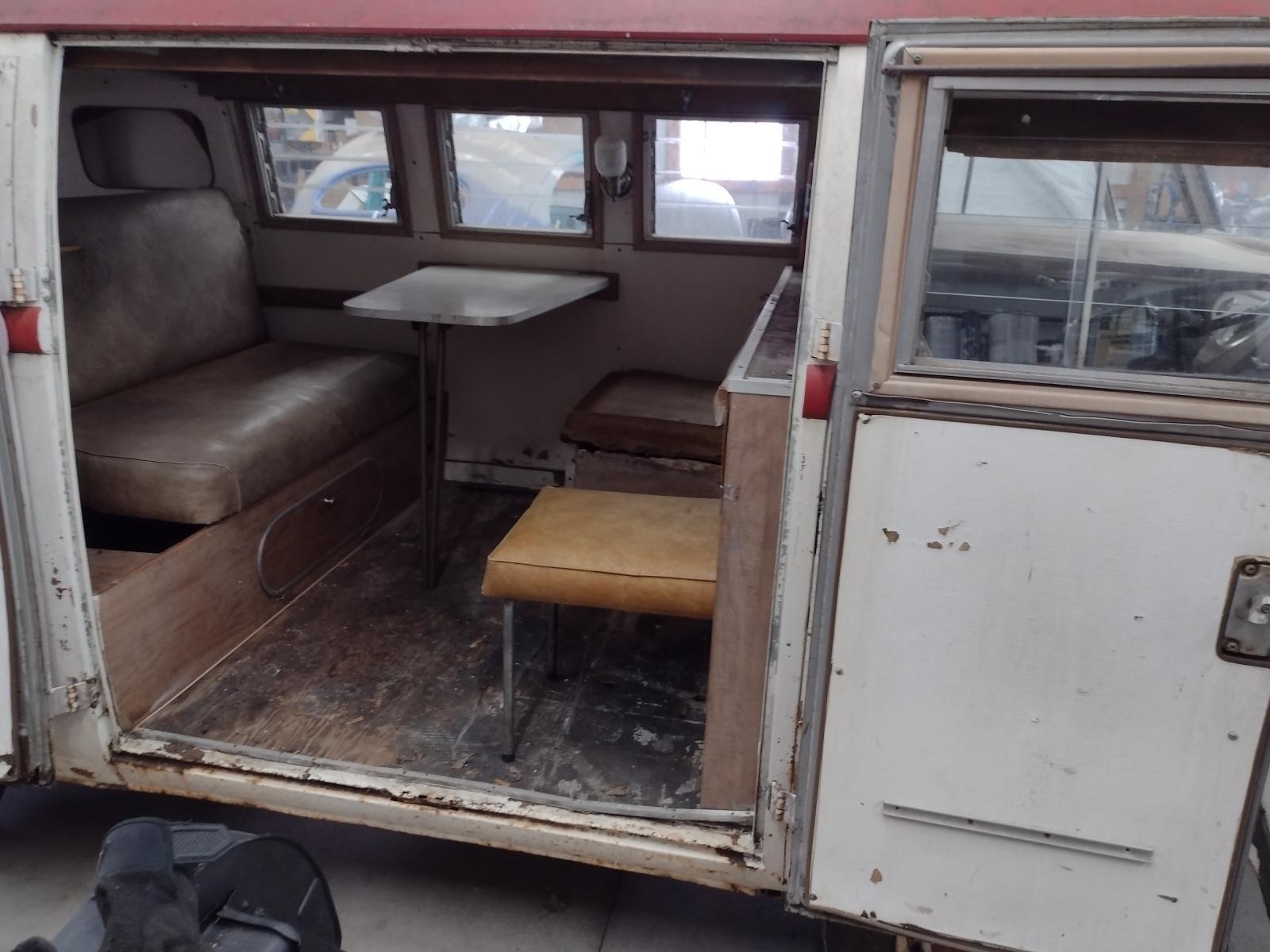

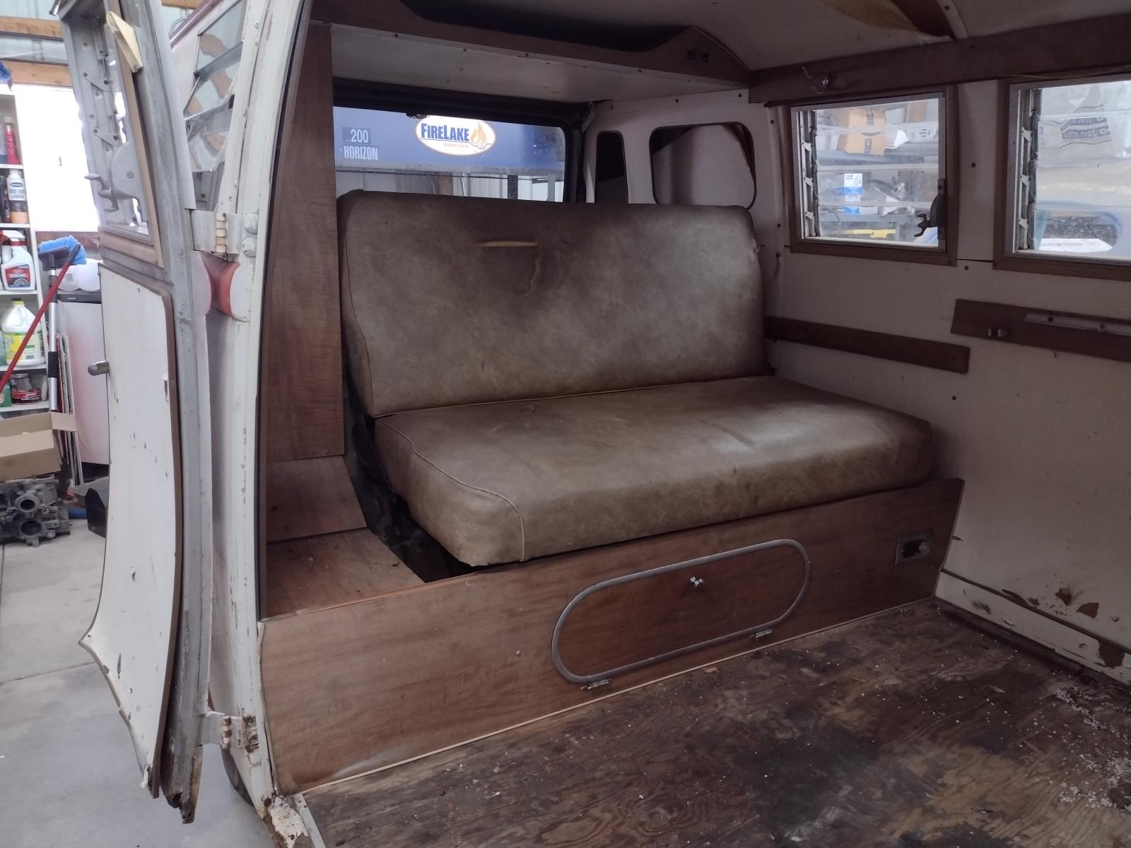

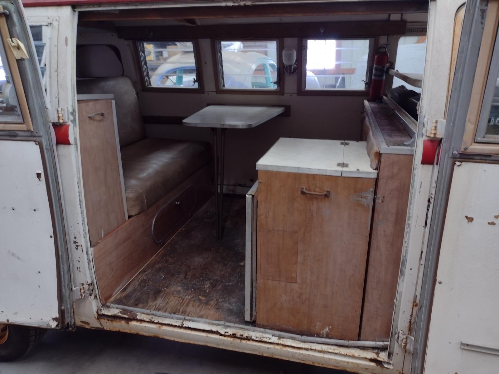

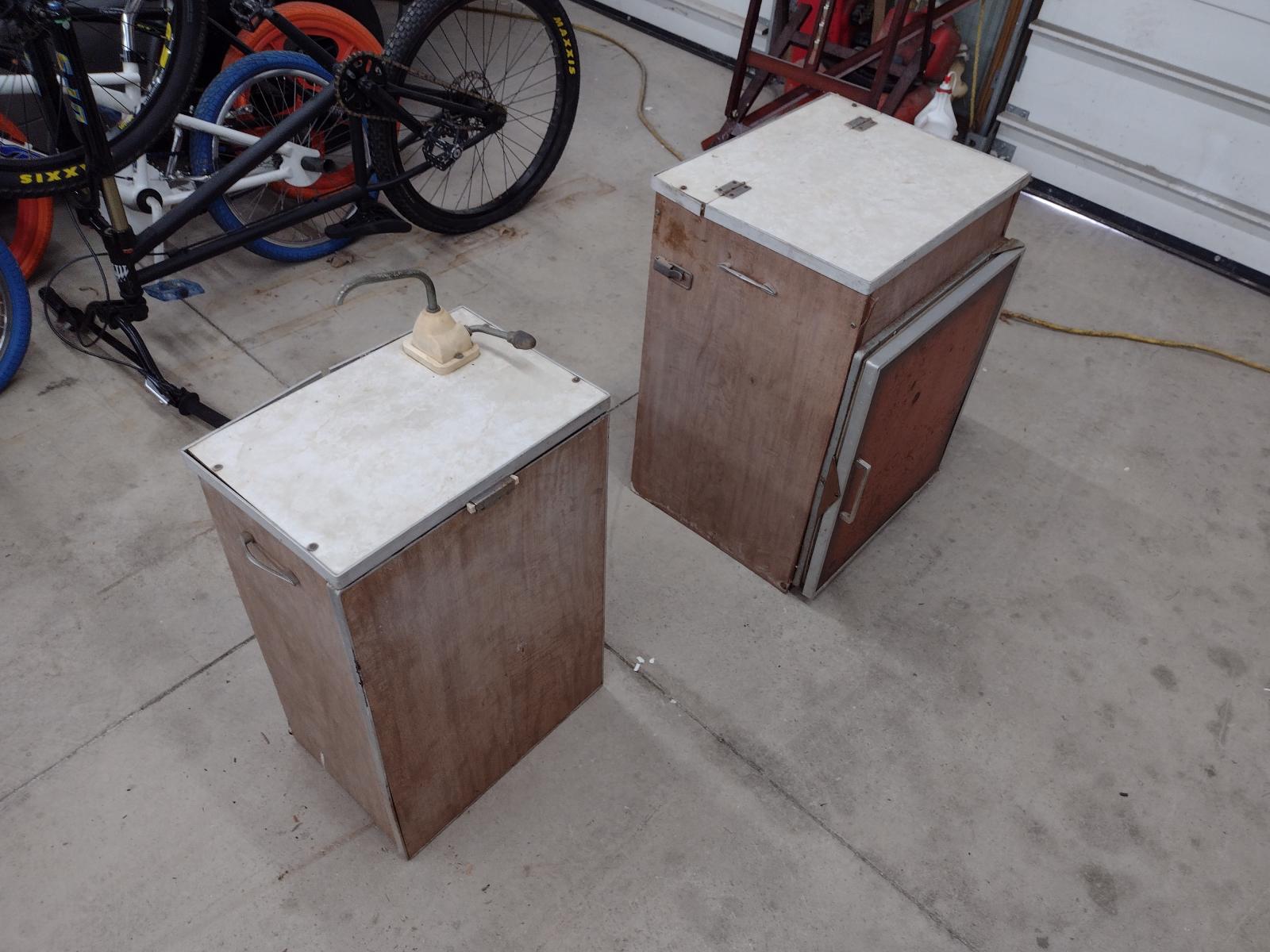

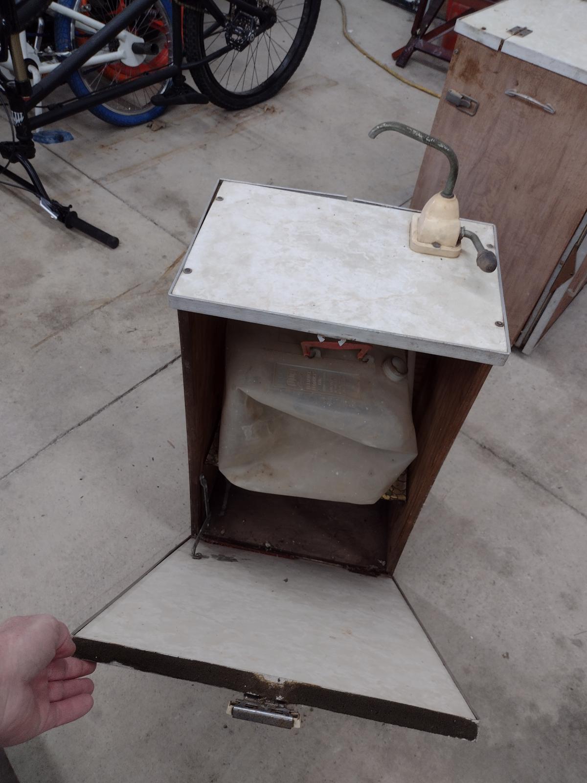

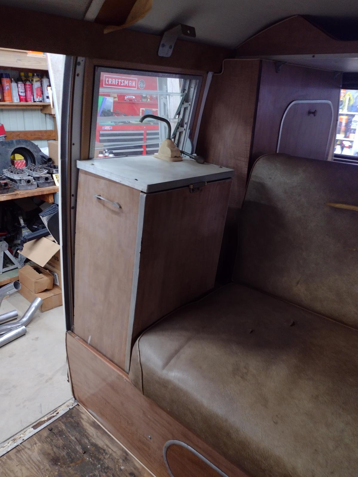

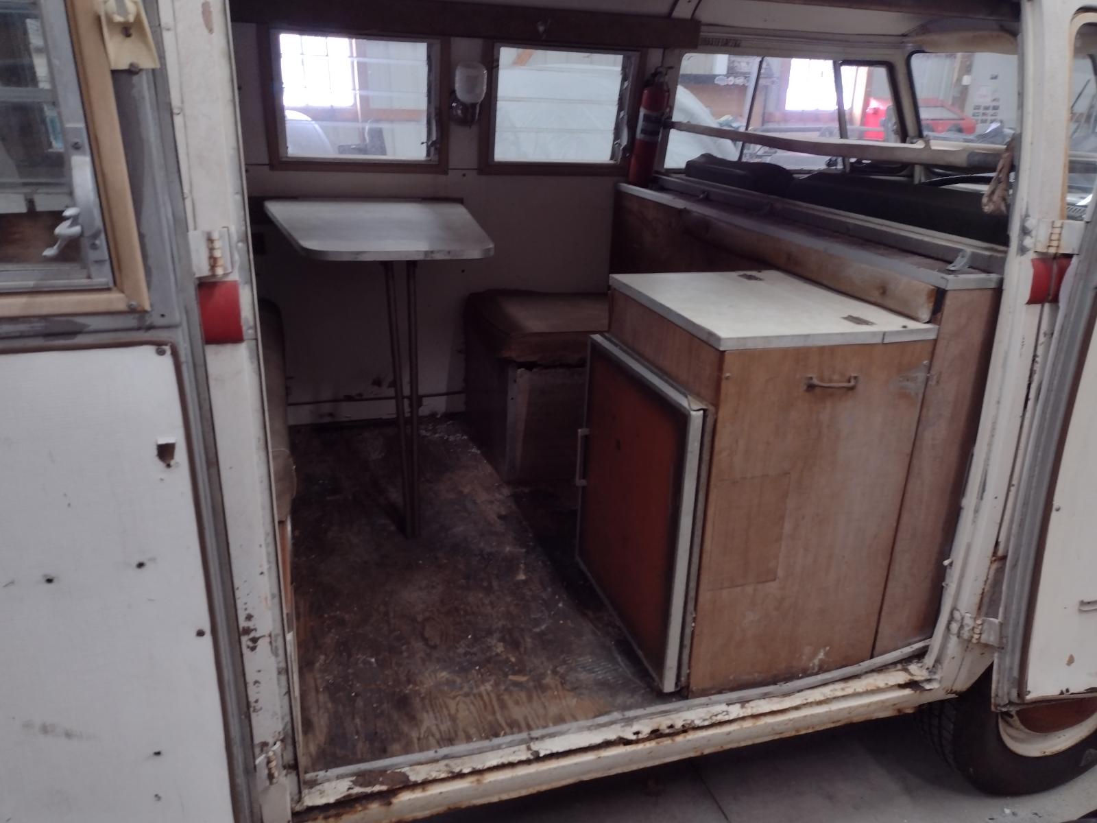

The interior and camping package is complete. Here is a pictorial.

It’s a good looking bus, tons of character and originality
The camper kit seems very complete. Some rust to deal with at some point, but not horrible.

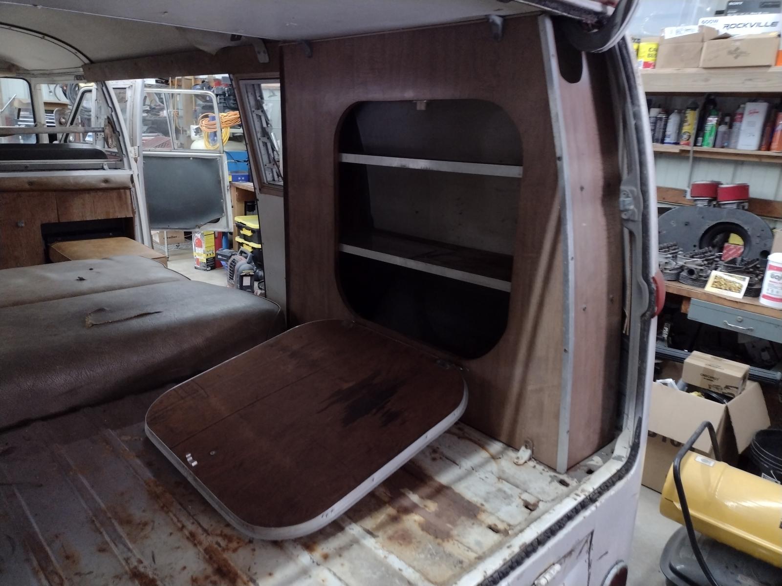

It looks to me like there used to be shelves or a cabinet mounted to the rear swing out door. I'll have to make something for this one missing piece, after locating some pictures of probable items to model it after.

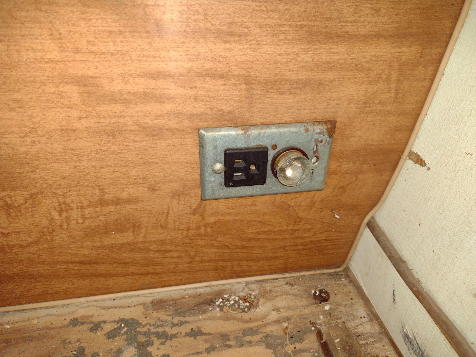

Here is the campground hook up to feed the single, glass-fused outlet and jelly-jar light fixture.

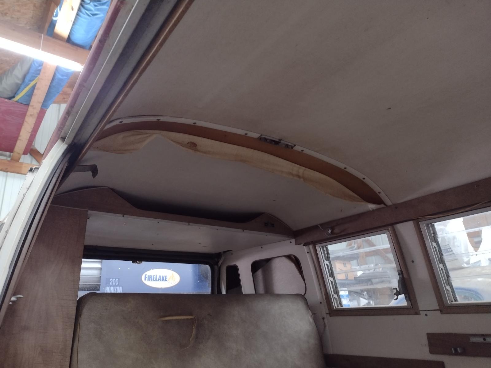

I think the roof panels would have been deleted by Travel Equipment Corp, in favor of the headliner panels.

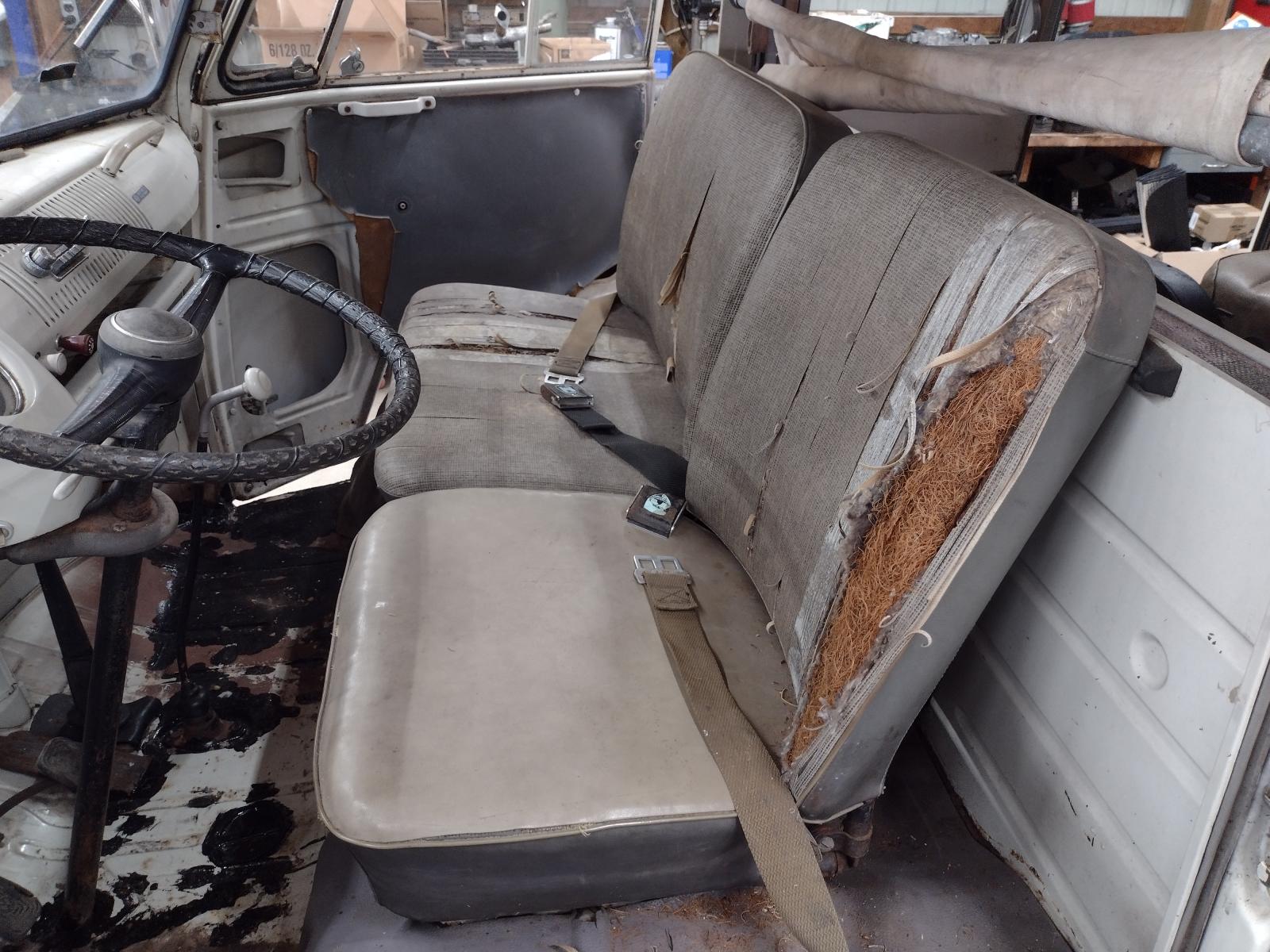

The front seats look to be the original upholstery, with the drivers seat bottom cover replaced at some point with different model spec light grey over dark grey.
The seatbelts are three grey/olive straps and one black strap. I'm guessing the one black one was a replacement sourced from another bus.
The rubber wheelhouse cover remnants are grey. There is no front floor cover.
One nose panel came with it, which is dark grey.
The camper package upholstery appears to be the mustard color seen on the hideaway stool that had been protected from UV rays behind the ice box, with the single seat and bench having the color ravaged by the sun. (I don't know if I can do the mustard. Its wildly out of place with the rest of the bus. Time will tell as the seating vinyl likely has to be replaced so that the seats can see active duty without disintegrating.)
There are curtain rods but no fabric scraps.

The single seat provides storage.
And, after rustling around the attic, I find it is perfectly sized to stow away a Coleman camping toilet. I wonder if that was the intent?

Looks like a very good start for a bus. A bit of metal work required but nothing huge, bonus is you can chip away at metal work while you continue to drive it after a mechanical refresh. Obviously complete fuel system refresh is critical. Goes without saying that ethanol resistant fuel lines would be on my shopping list and ensuring that carb has fuel line safety wired on. While the engine is out of the bus a good time to refresh your fuel tank and make sure that the sender works! Have fun

Wow, I love the conversion. I've never seen one like it. Really like how versatile it is with being able to pull out the ice box and water tank cabinets and that hidden flip out buddy seat is sweet! Looks like the other buddy seat can come out and be used as a stand alone as well. Looks like they did a pretty quality job on the conversion cabinetry and panels too. I also wondered about the missing upper vents.
Great find and looking forward to seeing what you do with it. Very Happy

With all of the boxes out it has the room of a passenger bus without the middle seat. When I brought it home the stuff was all loose and topsy turvy piled in there with an engine. I didn't know what to think so I just unpacked everything onto the barn floor and stared at it a bit.
It was like putting a puzzle together with clues from the shapes of the curved walls and shadow lines from the sun fading. Once it started falling in place I began to really like it. Plus on a sunny dry weekend I can see having those things staged around the campsite outside.
I'm starting to really dig it.
