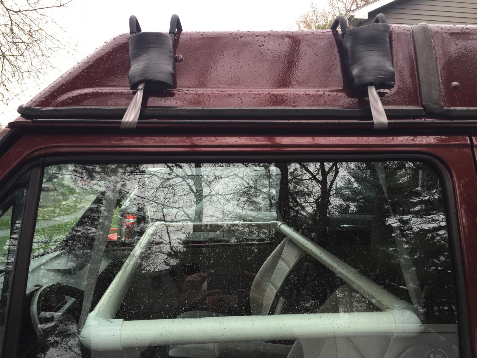

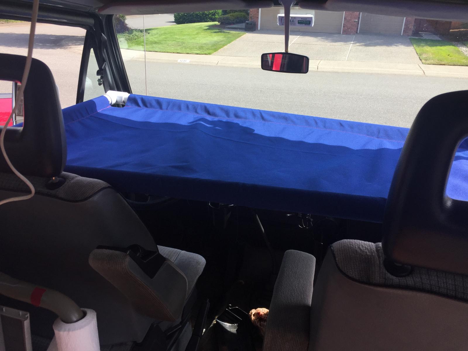

I ended up finally getting around to building my son's cot for the van. I'm pretty stoked with how it came out. It pulls apart and rolls up well for storage and I tried a different method for holding it up which I'm really happy with.
I used these: http://www.lowes.com/pd/Gladiator-3-in-Gray-Steel-Utility-Hook/3051817
I tied the 200lb test straps to them and wrapped them up in foam and electrical tape and they work beautifully. Best of all, you can still open the doors while the cot is up. It does drop an inch or so for the door frame, but that's fine with me...
I bought some grey canvas and had some help from the mother-in-law for the sewing. She did a killer job and it's really beefy. I wanted it to sag a bit so my little dude doesn't inadvertently roll out and I think we're in good shape.
Here are some pics:

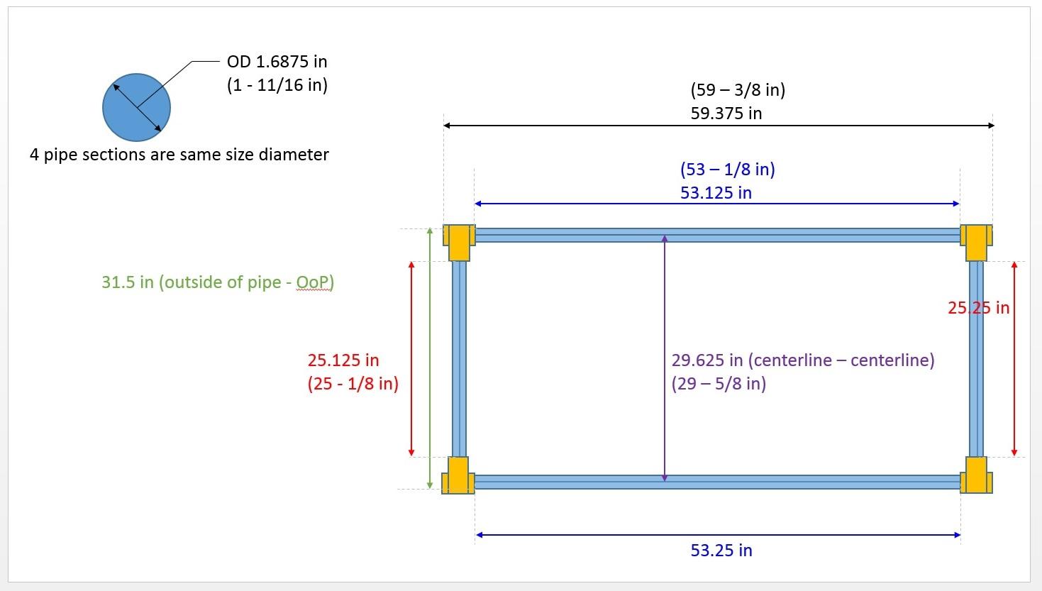

so I am tackling this project and have asked a friend at work to sew the cot for me. Below are the dimensions of the PVC piping:

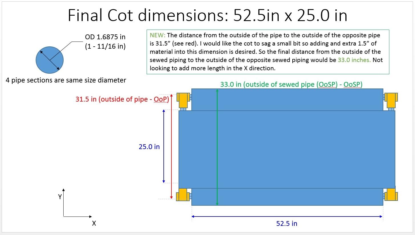

and of the Cot material:
The person I am asking to sew this though seems to be unsure of the best way to tackle it. As I am not a sewer I am not really sure what guidance to provide. I basically said to over cut the fabric (like an additional 8-10 inches) and roll it around the pipe, mark it where to sew and then sew it, then repeat for the opposite sides (thus sewing all for "pipe-ings").
What should be done though in the corners to prevent tearing?
Also I only am adding an extra "inch" of fabric so the cot isnt taught (tight) instead it will have 1 inch of droop, which should allow some bit of sag for my kid to sleep in to help prevent him from rolling out, but not as much as other pictures of cots posted... but who knows. I figure if 1in isnt enough i could trim down the PVC cross members.
Thoughts?

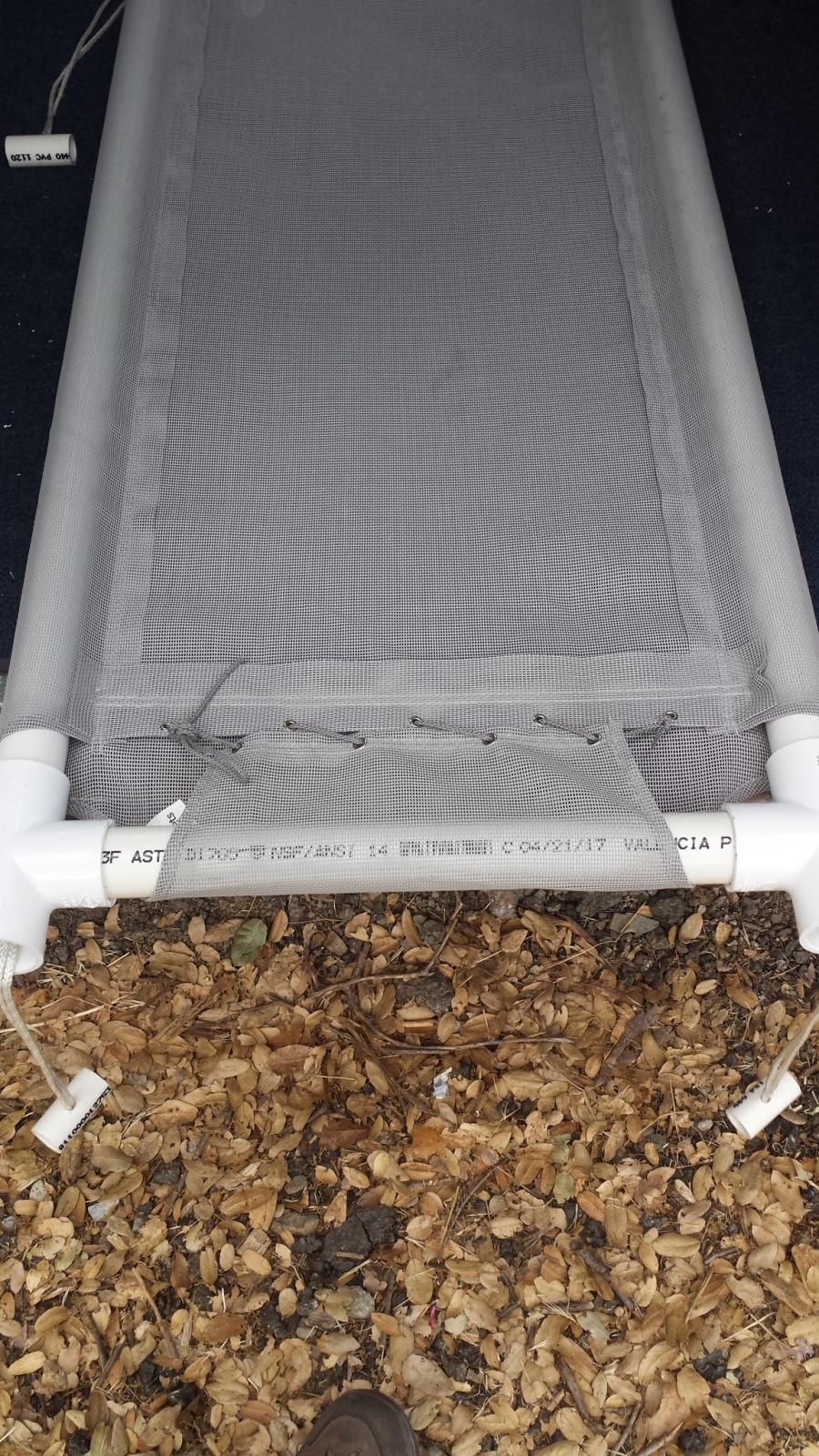

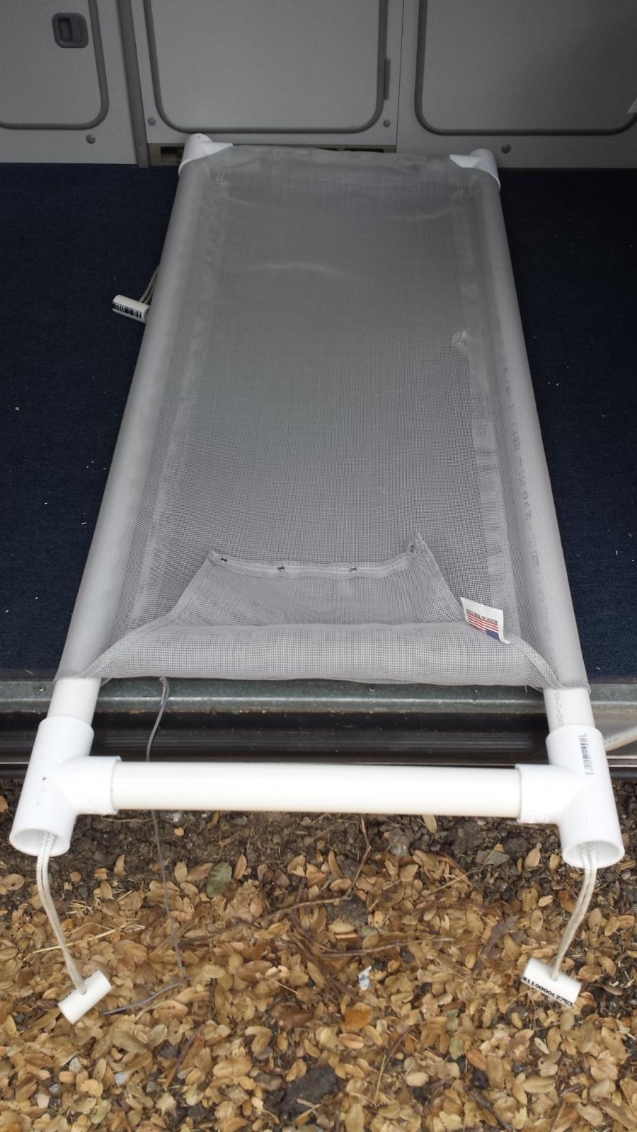

edit: 8/8/2017 I have the cot all sewed together and installed and working great. I do not think you can get too much wider or longer than the dimensions I posted above for the frame (assuming you have stock seats/steering wheel).
Here are pics of the final product, the frame is "crooked" because I didnt properly adjust the webbing straps for the pic, for i wanted to test it quickly after it was completed)

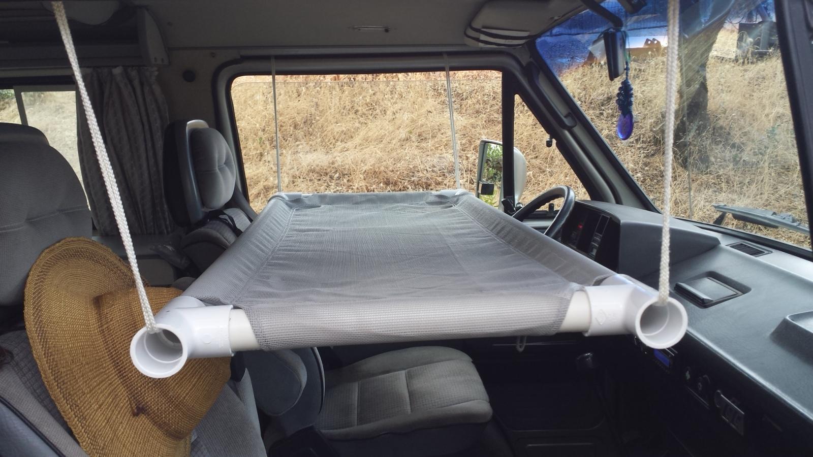

Useful indeed, thanks to all for your ideas. I recently built one using rough dimensions described earlier in the thread for our 3 year old, and she loves it. Of course, with two little ones, time is short, so I opted for a commercially available option that would be plug and play. I was able to find the Creative Colors cot cover 502R-GY that matched the gray interior of our westy. It's made in the US and available online for ~$20! Add some PVC framing, and here's some photos of the finished product. Cheers!
Rolled up for storage (stowable near upper bed while under way):
Layout and assembly (note drawstring can be replaced with something stronger if needed):
