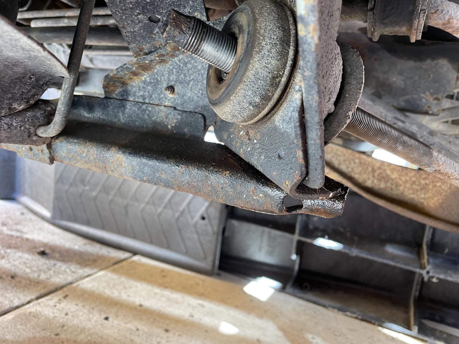

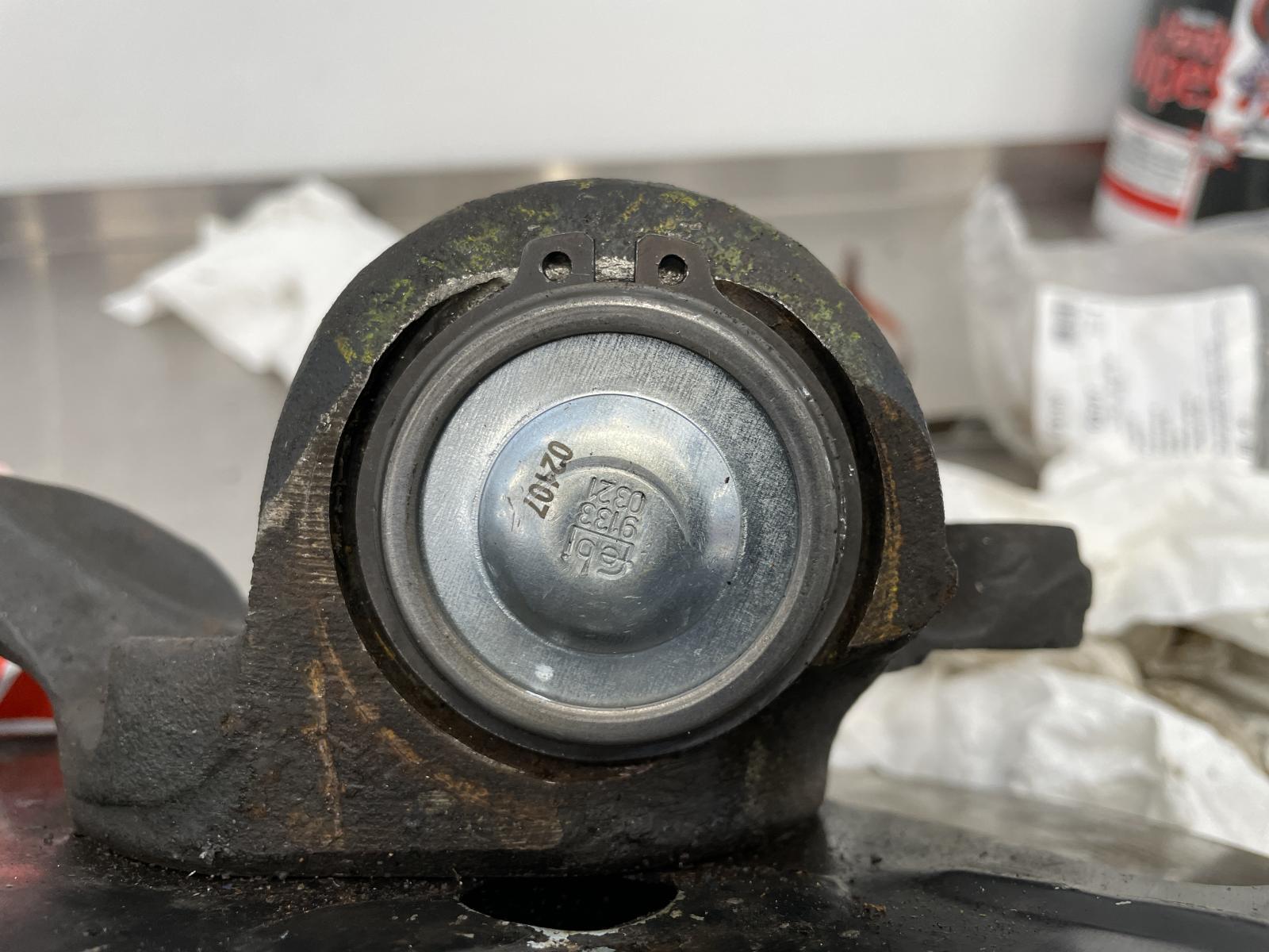

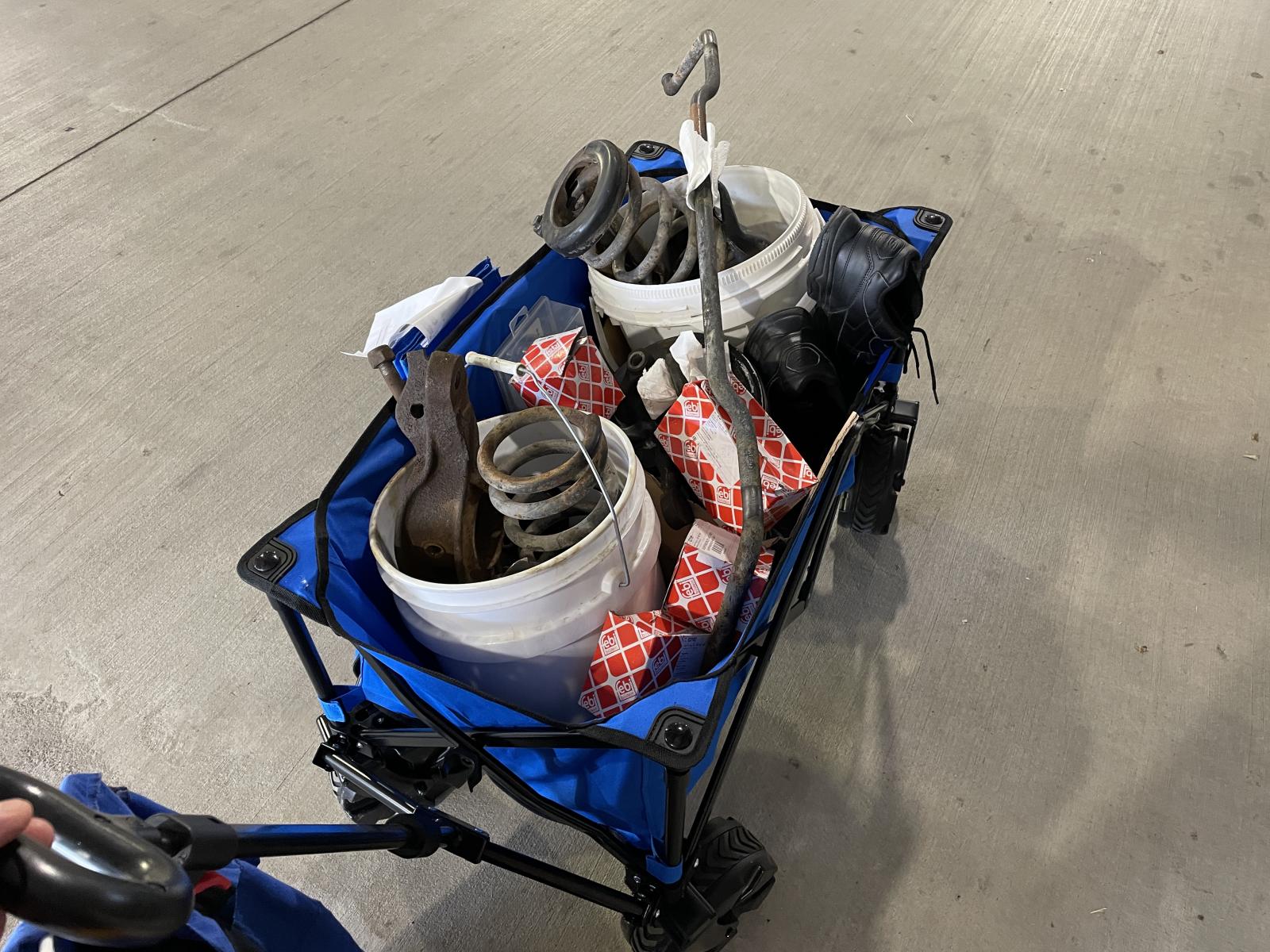

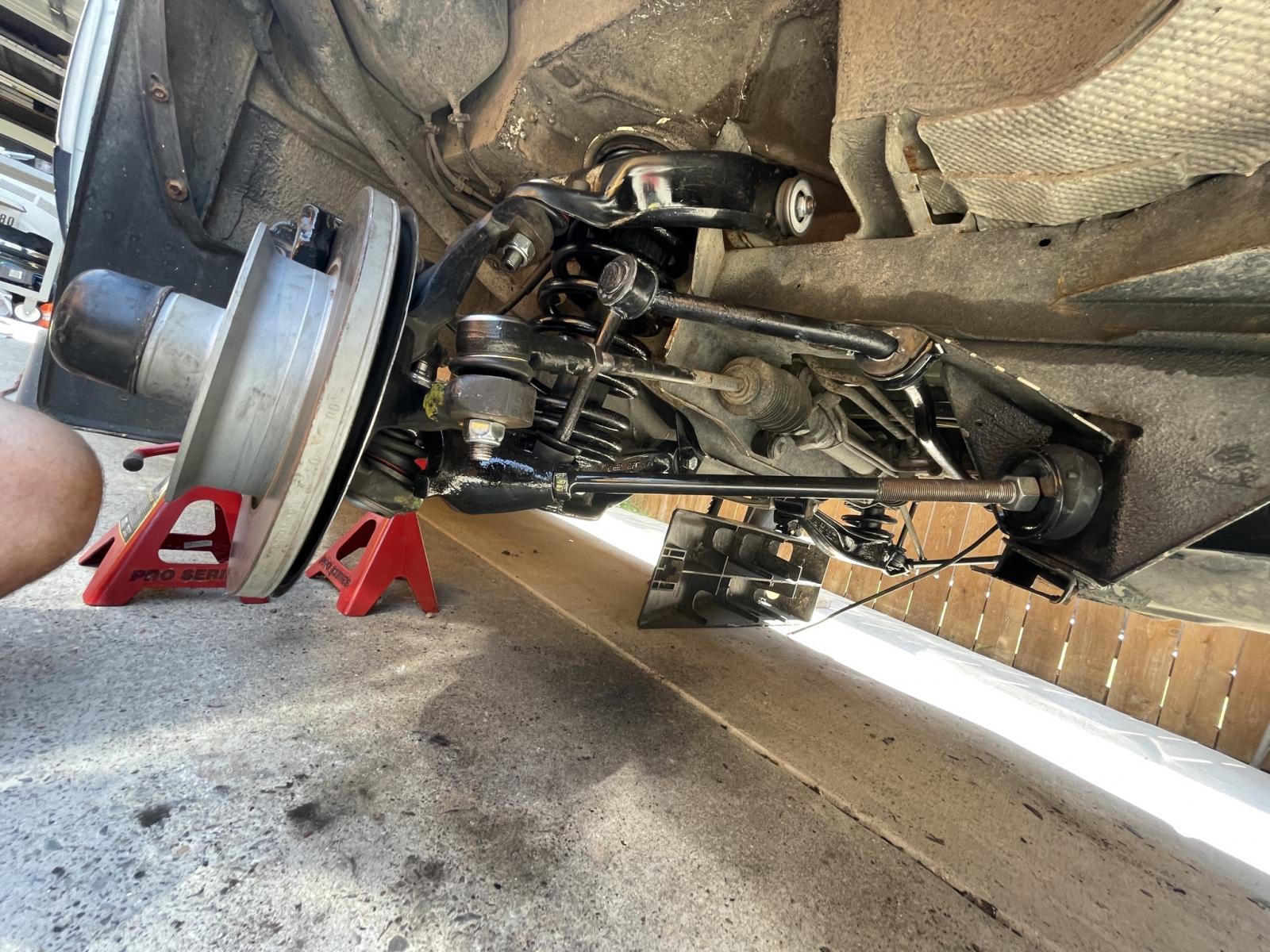

Lots of pictures. Doing every bushing and ball joint. Everything is original to the van and most is in really good condition for the age.

Nice !
What paint did you use? What springs, what shocks?
Have fun installing the new parts!

VicVan wrote:
Nice !

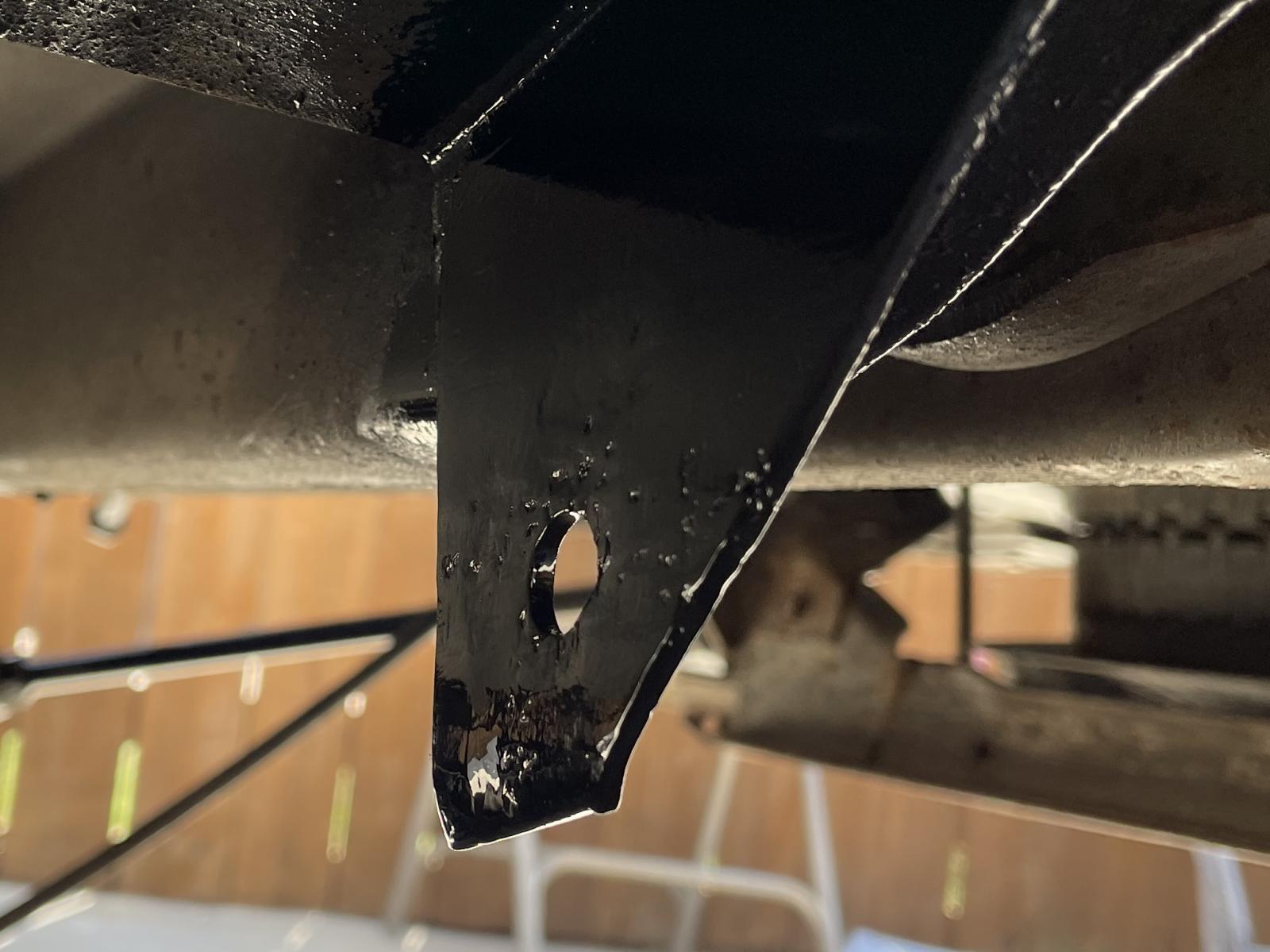

I used POR 15 on the parts. The springs and stabilizer bar I just sprayed with rust oleum.
Don't remember the name of the shocks. I just went standard. I didn't replace the springs. They look good. My van sits high.
I also have 4 new tires that will be installed.

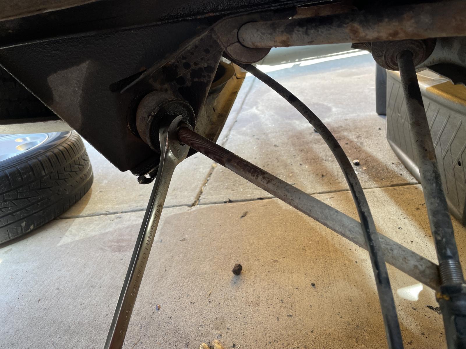

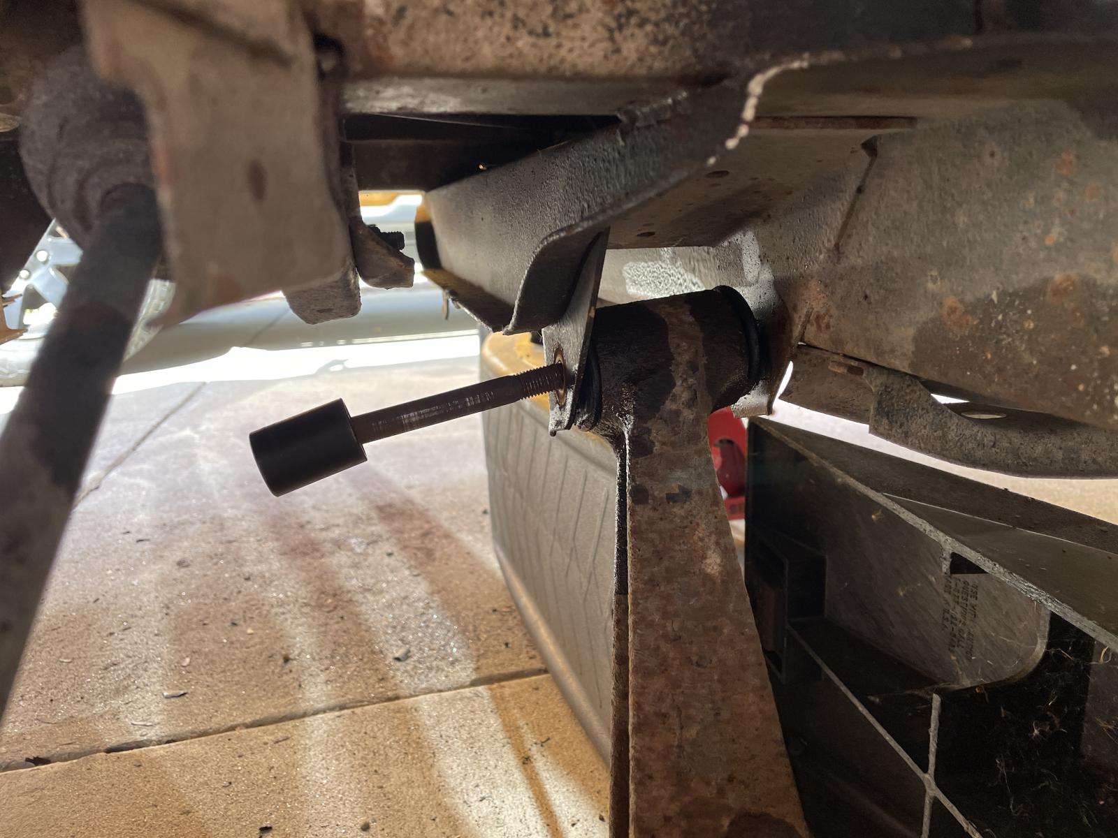

I spent Saturday (9am to 7pm) doing the radius arm and sway bar bushings and it felt like a massive endeavor. I’m so impressed with the scope of this suspension rebuild. Mighty fine work.

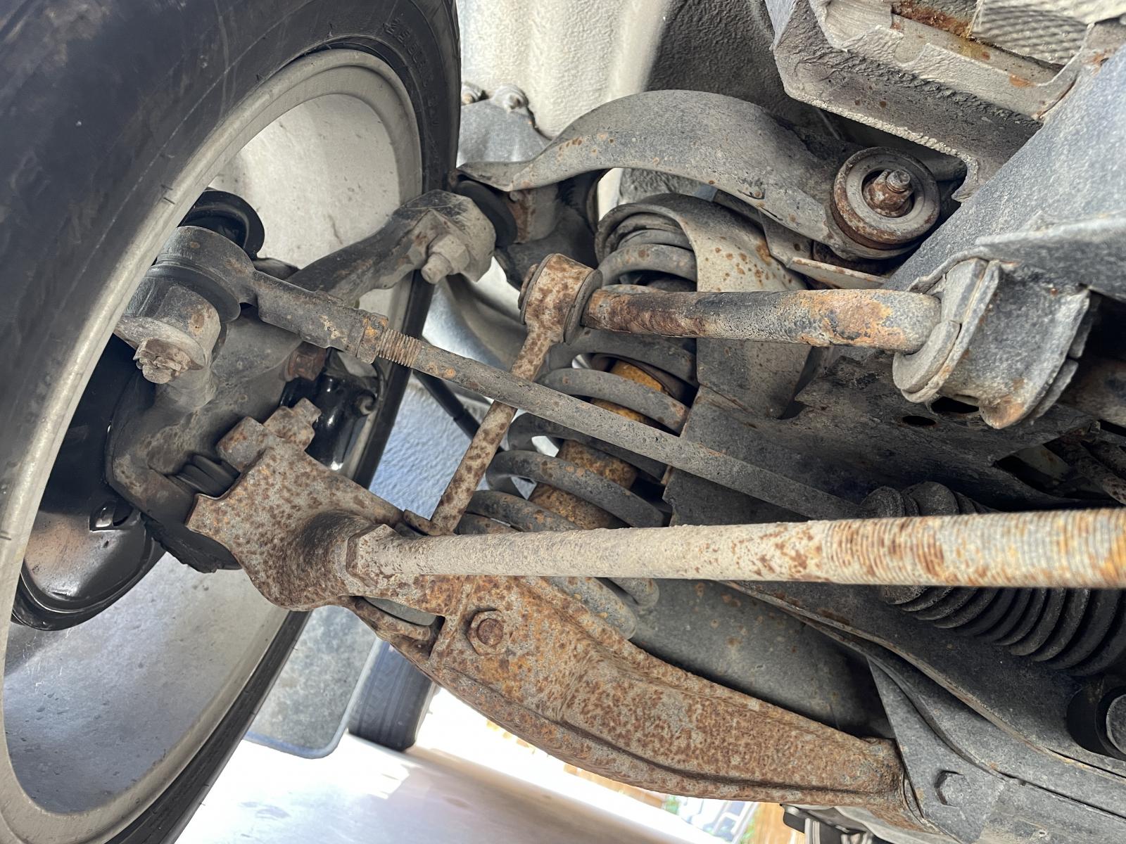

Why was it so hard?

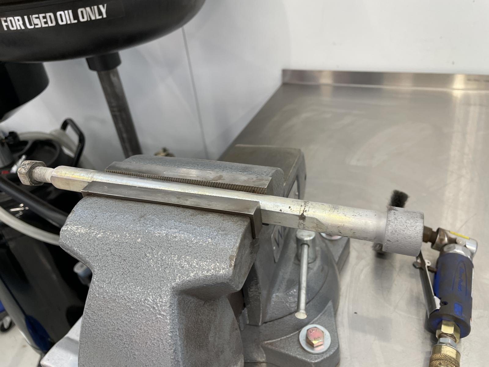

I had to really clean the rod and heat up the control arm to unscrew it but other than that it was not a biggie.

PostPosted: Sun Jun 19, 2022 9:29 pm    Post subject: Re: 88 Westfalia suspension rebuild Reply with quote

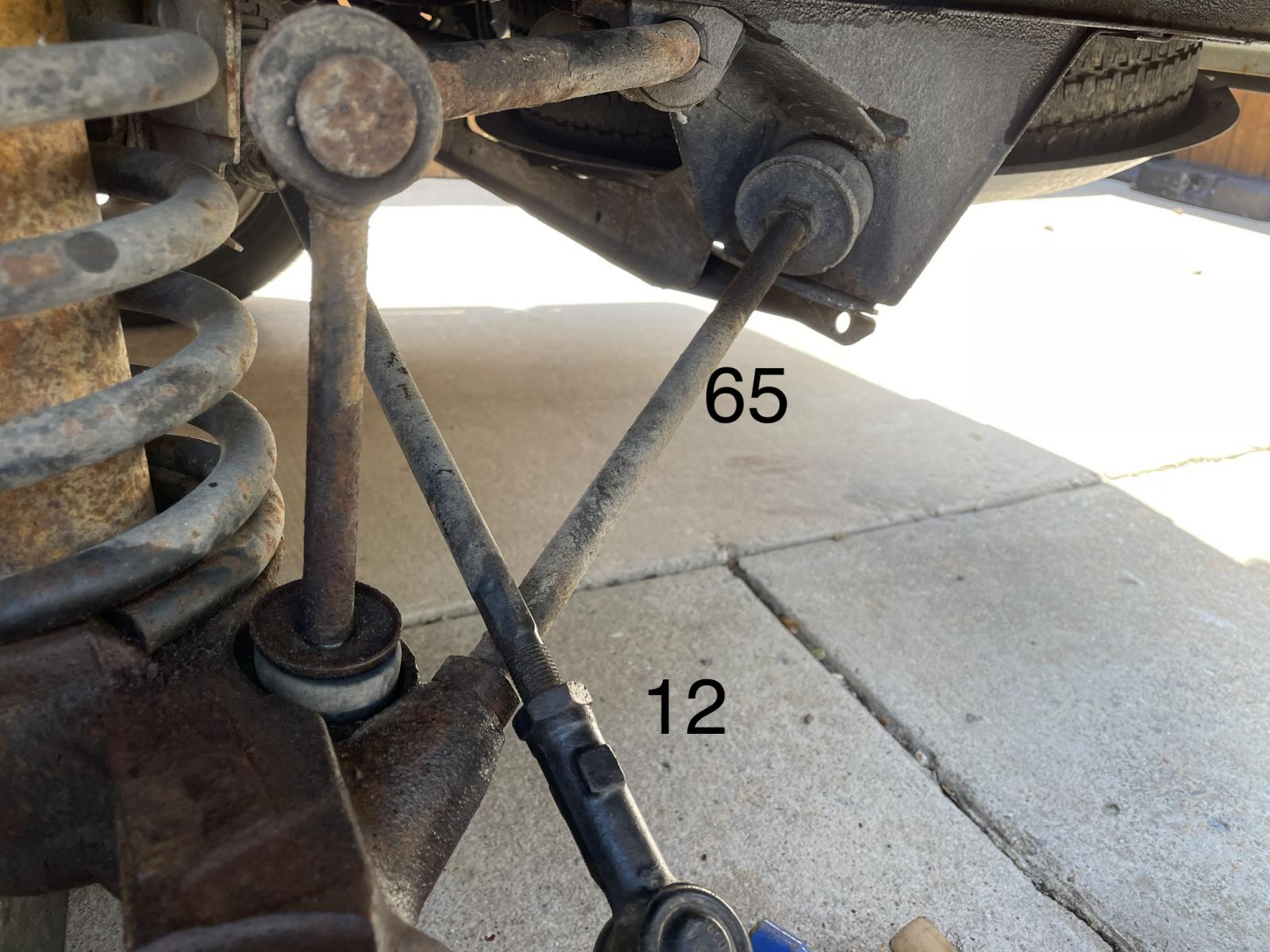

About 3 hours were spent getting the radius rods loose. Heat, penetrant, heat, penetrant. Some bad experiences with breaking bolts has gotten me cautious. I finally just stood on the 27mm wrench on the passenger side and it came loose. My van also has this wonderful rubbery, tarish underbody coating that was done sloppily 30 years ago, so several hours were spent cleaning with a wire brush and repainting everything. Then, I overlubed the drop link bushings and had a hell of a time getting them on the sway bar. Finally a team effort of my girlfriend using a quick clamp while I held it in place popped them both on in 3 minutes, after I tried to do it myself for an hour and a half. There is a lesson there about asking for help that I’m sure I didn’t learn.
And (despite warnings) I got bushing lube in my hair. had to wash it twice - lol.
I still have the upper and lower control arm bushings to do in a couple weekends. We’ll see if that goes more smoothly!

Very nice job! May I ask, what kind of de-ruster you used on the lower controlarms? Seems like a jelly consistence?
It's a POR15 kit. Has a degreaser, metal etcher and then the paint itself.

PostPosted: Mon Jun 20, 2022 10:03 am    Post subject: Re: 88 Westfalia suspension rebuild Reply with quote

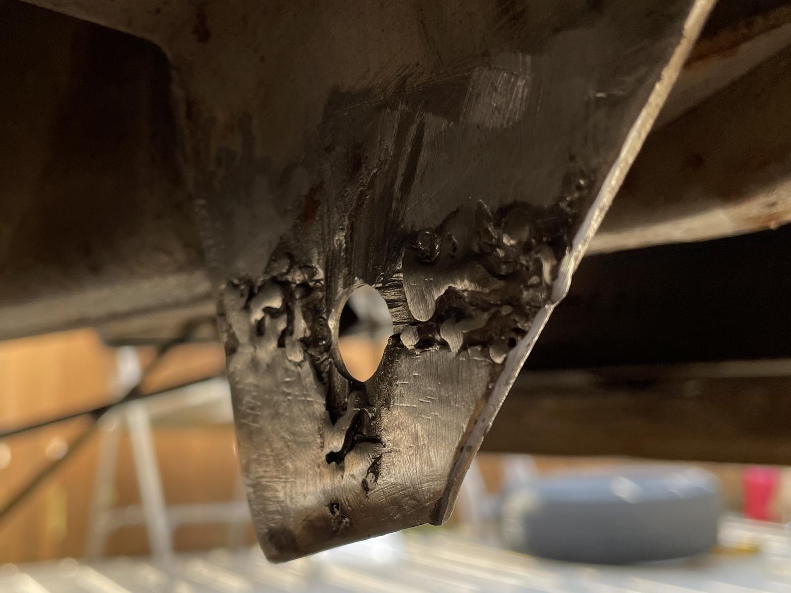

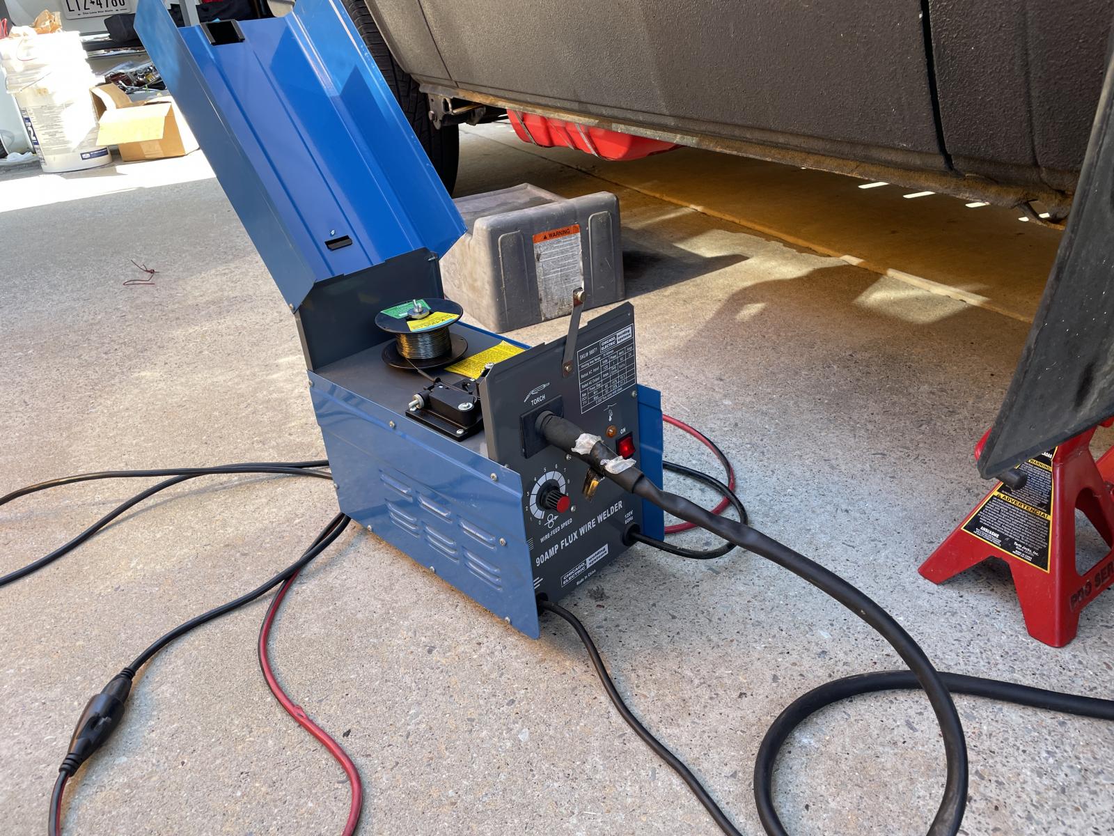

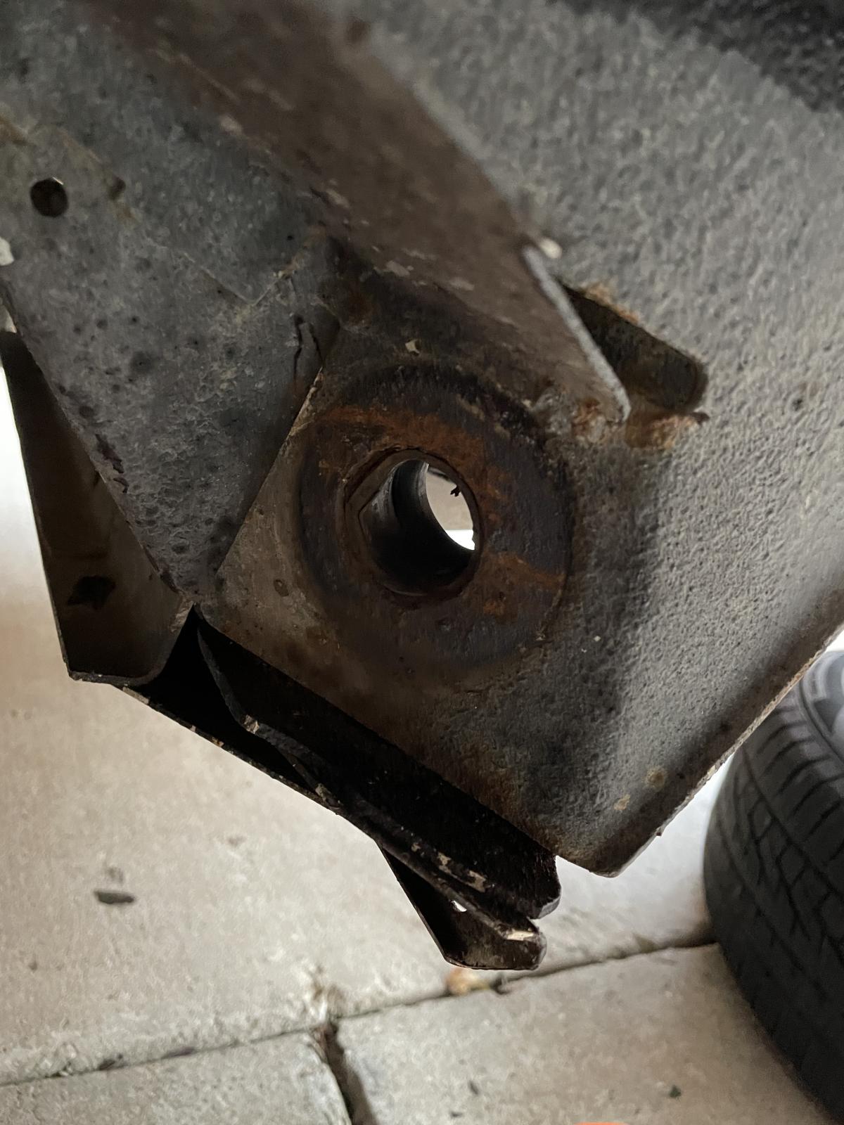

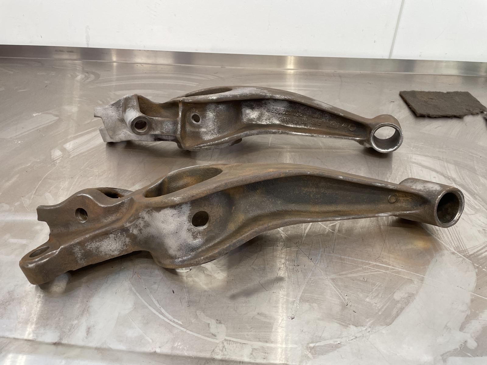

When I cut the bolt of the pass side lower control arm it messed up the mount so this morning I used my crappy welder to fill it and sand, fill and sand until I was happy enough with it.
I'm not a welder but this is good enough for me.

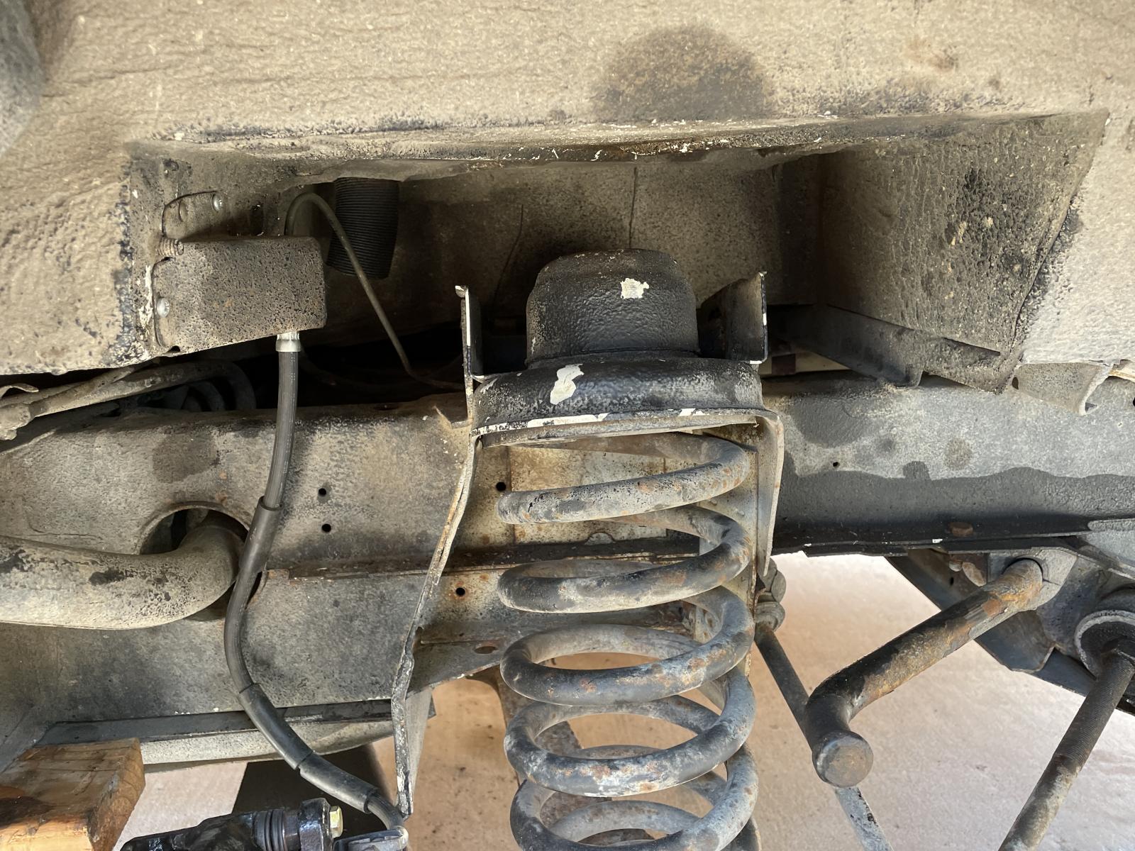

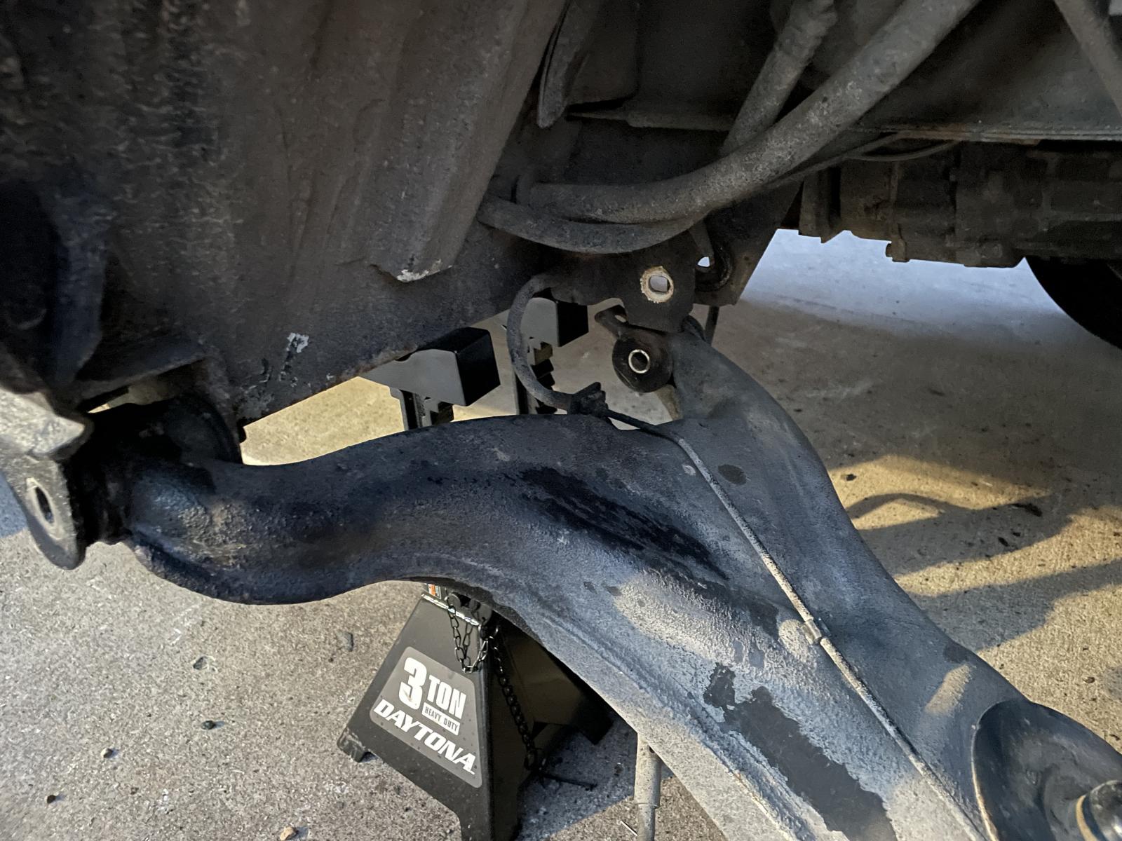

Finishing the front
zoti
Joined: December 26, 2007
Posts: 2114
Location: Plano, TX USA
zoti is offline
PostPosted: Sat Jun 25, 2022 7:46 pm    Post subject: Re: 88 Westfalia suspension rebuild Reply with quote
And start driver rear

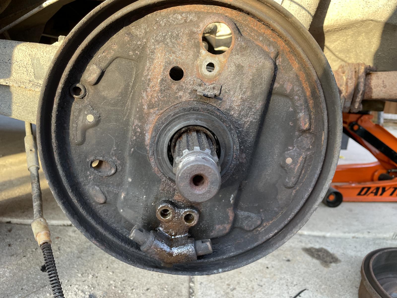

PostPosted: Mon Jun 27, 2022 2:40 pm    Post subject: Re: 88 Westfalia suspension rebuild Reply with quote

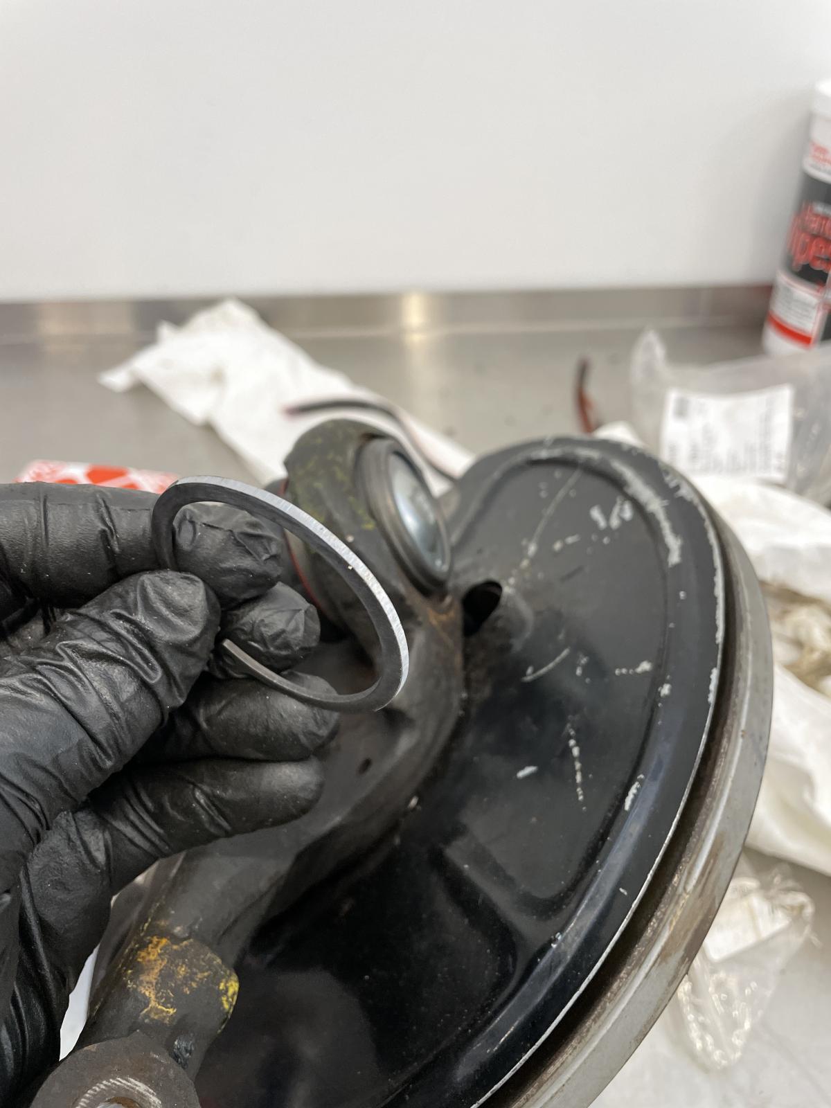

I thought I was being smart trying to use a condom to prevent the brake build from draining. Apparently, brake fluid is not a good lube. The condom broke from the fumes. lol. Ended up putting a plastic bag and rubber bands.
