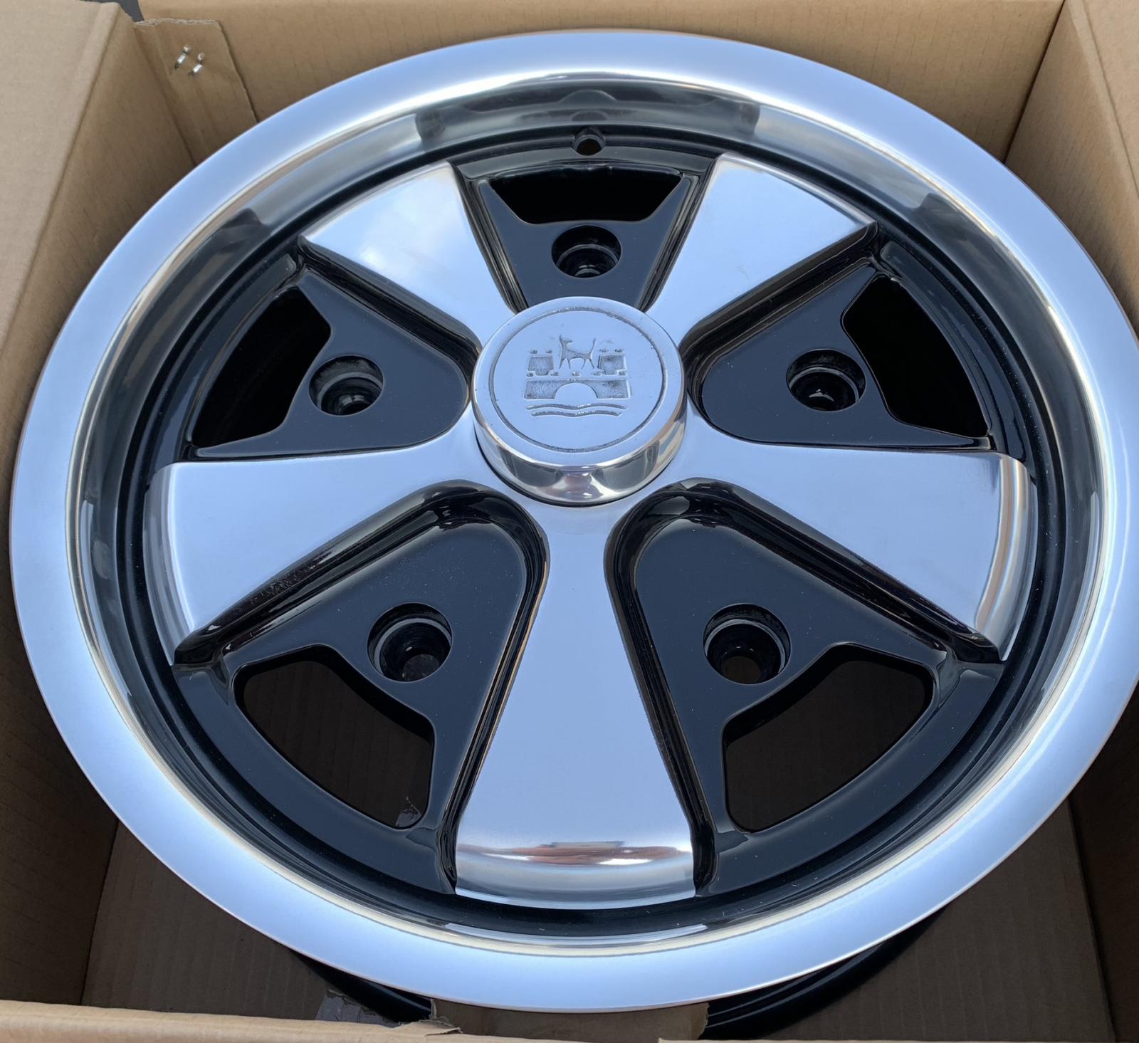

Finally got my new wheels
Empi fuch rims in 4.5 and 5.5 wide
Rear 195/65 front 155/60 falken brand
They are still dirty from the tire grease but I will polish that up.
I didn't have any lead left to balance them but I'll do it on Tuesday.
I also want to paint the center caps to break up the whole thing a bit

Let's see pictures with the wheels mounted Smile how will you make the change to 5x130?

i dont need to change Wink mine are 5x205 Cool
First i need to mount my dropped spindels before i put the wheels on Antoine

Nice car! Are you going to use wheel studs for the Empi Fuchs? Also, I understand that when using the Porsche center caps, some have encountered clearance issues with those wheels.
True, the centercaps come against the wheel bearing protective cover at the front.
You can't remove these because your speed cable is in there.
However, you can put a spacer so your wheel will be more forward.
That way your center cap will fit.... There are also companies that make wider caps.
I am not going to put centercaps on the front for now and I am going to polish the caps of my bearings. In the future I can look for spacers but then you would already have to put a narrowed axle or your wheels will come out too far
