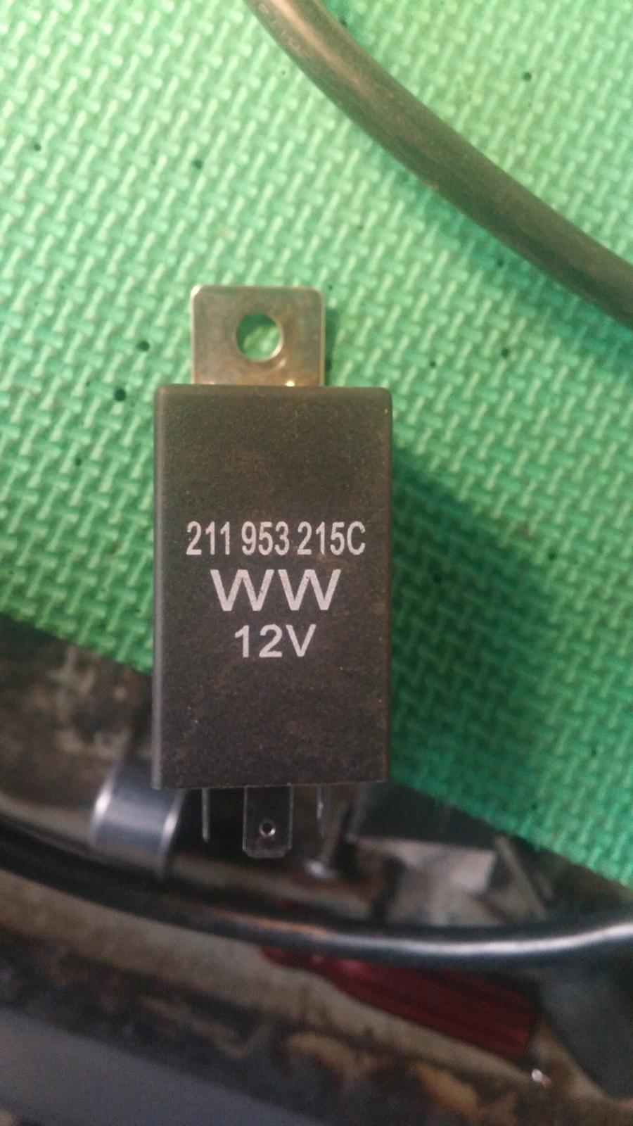

Yes, I have searched and read for hours. I got the Wolfsburg west 4 prong turn signal relay and don't know how to hook it up. No threads I can find deal with all the wires, and just using the terminal #'s I am still confused.

Where do these all go on the WW relay 211 953 215C?

Seen this?: https://www.thesamba.com/vw/archives/info/wiring/65bus_TurnSig.jpg
Does the WW relay have terminal numbers on it?

Yes, 31, 49, 49a and C. The relay I am replacing is "J" in the wiring diagram, which is not marked with corresponding #'s.

#31 is ground or brown
#49 is power (black/purple)
#49a is blue (and whatever else is attached on yours)
So that leaves C, see if it's the same as S which is the black/white/green (KBL on later cars)

Thanks, I was almost there. According to wiki, C is first turn signal flasher. This could sensibly go to the emergency flasher relay.
https://en.m.wikipedia.org/wiki/DIN_72552
I am not sure what the old S and KBL were, but the KBL on the 1970. Us does not seem to go to the emergency flasher. Perhaps I shouldn't focus on that - it is what threw me off in the first place.
Can anyone confirm my third wire (blk, grn, white to emergency flasher relay) goes to terminal C?
And is the metal hanger on the relay a ground or just a mount?

At first glance I'll speculate it's merely a mount, an ohm meter between 31 and the tab will decide.
The 1970 system is radically different from the 65 system, instead of a relay combining the circuits to make them all flash it uses a complex switch, but the end result is similar.
The black/white/green on the 65 also branches off to the signal switch, that's a similarity to the later system but without the relay, it's 54bl on the column switch in yours. Some later systems combine the blue with the black/white/green, it works in a similar fashion but deletes the burnt out bulb warning system that 4 pin flasher incorporates.

Yes! Thank you, Bus daddy. No emergency flashers still but I assume that relay is also busted. Was hoping fixing the signals would make the 4 ways work, but nope. Also have a problem with one signal light to resolve.
The WW flasher says I must have 21w bulbs but I have 1156 bulbs (26w) and they seem to work fine. Will I burn out my flasher like this?
Not likely, flasher ratings are usually the minimum required for it to flash normally, in the event one bulb burns out that side either stops flashing or goes into crazy fast mode alerting you to the problem, a few extra watts shouldn't be an issue.

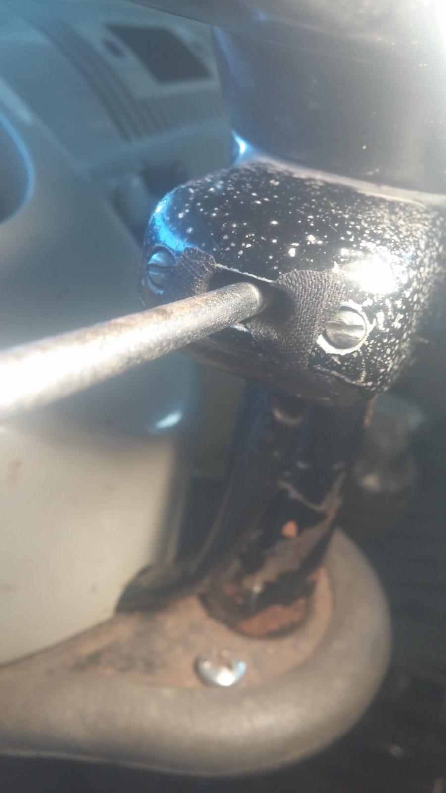

I thought I had a bad bulb or wiring or ground but it turns the signal switch is funny. It works great on the right turn, but when I signal left, if I pull the switch all the way, it clicks fast like when the bulb is blown. And the signal does not work. But if I just hold the signal down about 3/4 of the way, it works fine and flashes slowly.

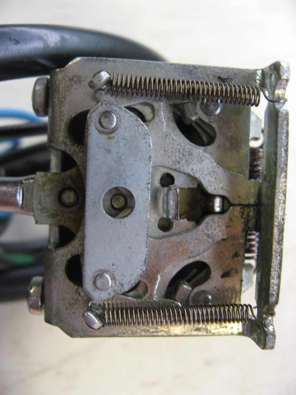

I fiddled with the turn signal switch a little. It seems not much on it is meant to be serviced. After fiddling, it started flashing fast signalling right and was better left!
Can anyone recommend how to service the turn signal switch and/or tell me what some common issues are? Again it works if I hold it in just the right position, either left or right, about 3/4 of the way. If I push it all the way on, it flashes quickly like the bulb is blown. In all cases, when flashing quickly, the rear lights don't flash. Do I have a connection issue on the switch that somehow affects both rear lights?

Disconnect your battery ground at the bolt by the engine lid.
You can remove the whole thing from the column, take off the surround, let it dangle and clean it with contact cleaner.
See if it is all intact and try to grease the moving areas including the sliding contact surface.
On the other side there are solder points that may need delicate resoldering. Yours will have more wires than this most likely.

Thanks, BarryL. Do I use dielectric grease? Will a couple loose strands on a wire make a difference? Soldering seems solid otherwise...
Dielectric might be good as the tube usually has a nice fine snout. I been using clear synthetic grease hand packed into little syringes.
The strands of wire shouldn't touch anything but as long as the main cross section of wire is copacetic then your good.

Well, did a really good clean this time and greased it up. It helped a little but still get the fast blinking sometimes. When I do, the taillights don't work. So the switch itself must not be fully connecting when pushed all the way. It works, so I am going to leave it for now- I have spent a lot of hours on these signals!
I put some tape in the hole so that the arm bumps into it before it can go too far. Seems to help a bit too. I can lightly flip the arm and it stays in place, blinking properly. If I push too hard it messes things up. I can live with it. Concours d'elegance, here I come!

Well, only 4 and a half years on, I think I have this resolved. I replaced the signal switch and got the signals all working fine. Not long after, I noticed I had no rear signals when the lights were on. I left it for a couple years as I don’t drive the bus much at night. Fast forward to the past 2 weeks. Tried again to get the 4 way flashers working. No luck. Traced a broken wire to the tail lights and got those working..lights on and all.
I reached out to WW and they answered next day. I figured I would start from scratch and asked for the wiring diagram for the signal relay 211953215C.
Response:
49A - TS Switch wire
49 - Power fuse box
31 - Ground
C - Speedo light
I had the wires mixed, but the signals were working perfectly. Add in the 4 way relay, and I could get it to about 99% functional every time, wires crossed and all. For a guy that knows nothing about wiring, this is surprising. With a couple wires wrong, I would have expected bigger problems- not all signals and lights working other than 1 of my 4 way flashers (ok, I did have to turn the signal on to get one of the front lights flashing with the 4 ways).
Also replaced the bulbs with 21 watt, as directed in the WW page for the signal relay. Tested all the wires for continuity and voltage to confirm they were correct. Cross referenced to the wiring diagrams from VW and WW and voila!
