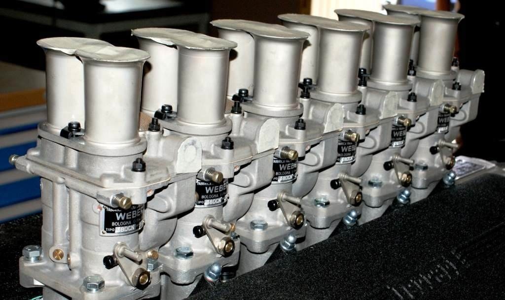

Weber 46 IDA ex Porsche 90# race motors
Good - serious race pedigree, look good, serious flow capability
Bad - very rare, very expensive, physically large, serious flow capability, like progression modifications to help tame them for street use.
Weber 48 IDA
Good - easily available, race pedigree, look good, serious flow capability
Bad - physically large, serious flow capability, like progression modifications to help tame them for street use.

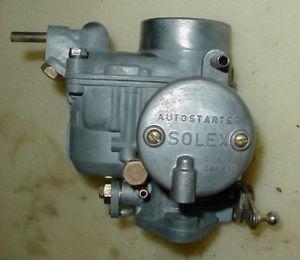

french made Solex F32 PBIC variation notes
all bar the PBICc (mine missing it's throttle shaft etc) have full round throttle shafts, not thinned with flat milled areas like the 32 PCI. the shafts look to be brass.
all bar the PBICT (missing it's top) have slip on fuel lines with built in filters before the float valve. these carbs have a smaller single entry for the choke air bypass unlike the larger divided entry on carbs shown in the original post.
all have mount holes in the base spaced +/- 60mm apart.
the jetting details are to help id potential spare part sources. I wasn't game to pull the E-tubes, otherwise, if it's not listed, it either isn't marked or is missing.
F32 PBICT ex Simca P60?
big "Autostarter" choke mech with at least one extra gallery in the body near the choke.

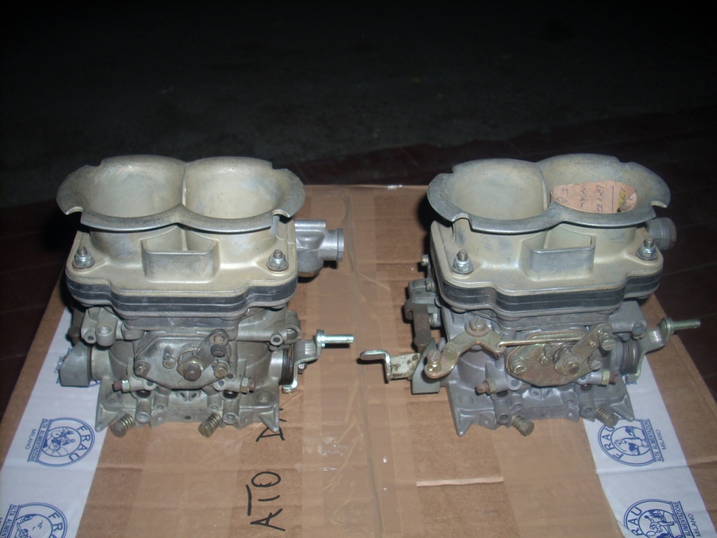

Weber 35, 38 & 40 DCNL
35mm fitted to some Lancia Flaminia's and competition Tatra's 603's
38 and 40mm fitted to various Maserati's
if anyone knows more about these please post.
Good: small throttle bores more suited to our engines, unless you hang out with the old Maserati/Lancia crowd you will probably never ever park next to someone else running them.
bad: rare, I can't imagine too many people that know anything about them.
35 DCNL
38 DCNL
pics from off the net as I have never even seeing one.
