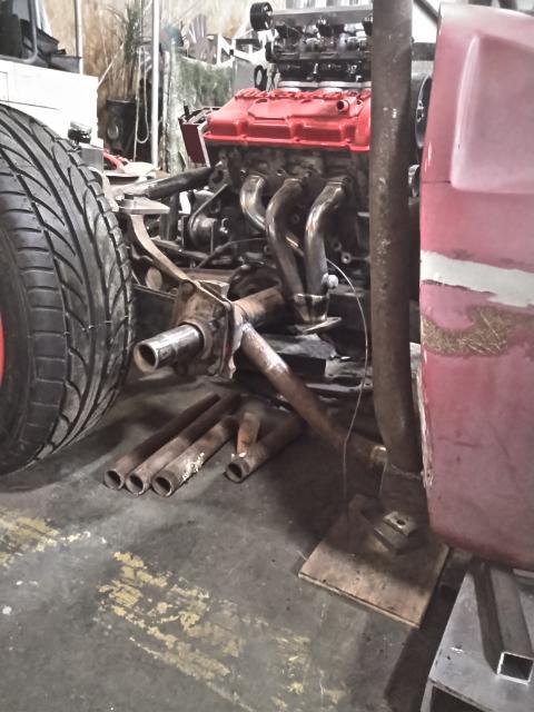

PostPosted: Wed Nov 30, 2022 7:25 pm    Post subject: Re: Vokaro project car Reply with quote
Yeah well.....it is not just little bit longer.....it is a lot lower.
Drop spindles, adjusters, pie cut, relocated Napoleon hats.......and a major body drop
Look at that down hill bar from the torsion tube to where it used to live at.

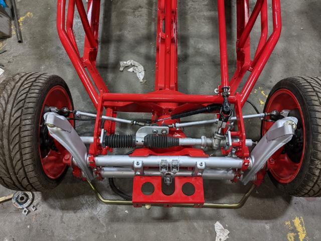

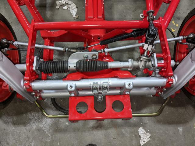

PostPosted: Mon Dec 05, 2022 6:35 pm    Post subject: Re: Vokaro project car Reply with quote
The assembled rack and pinion.

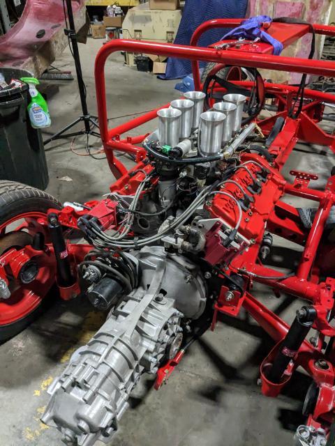

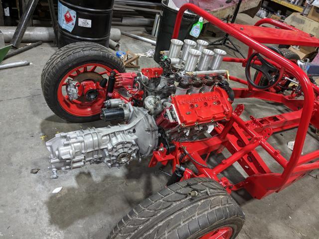

PostPosted: Sun Dec 11, 2022 5:03 pm    Post subject: Re: Vokaro project car Reply with quote
And some of the back end going together.
I did get the 28mm torsion bars set......at least for now.
It is just right..... right now.....I am guessing by the time all is together and settled in that I am going to need an upward adjustment .

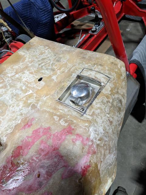

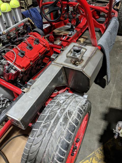

PostPosted: Sat Feb 11, 2023 7:51 pm    Post subject: Re: Vokaro project car Reply with quote
Made the gas tank ....

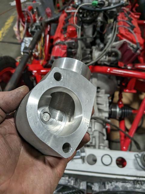

DeathBySnuSnu is offline
PostPosted: Sun Feb 19, 2023 2:15 pm    Post subject: Re: Vokaro project car Reply with quote
Spent a my half a day making an off thermostat neck.
One more part done....

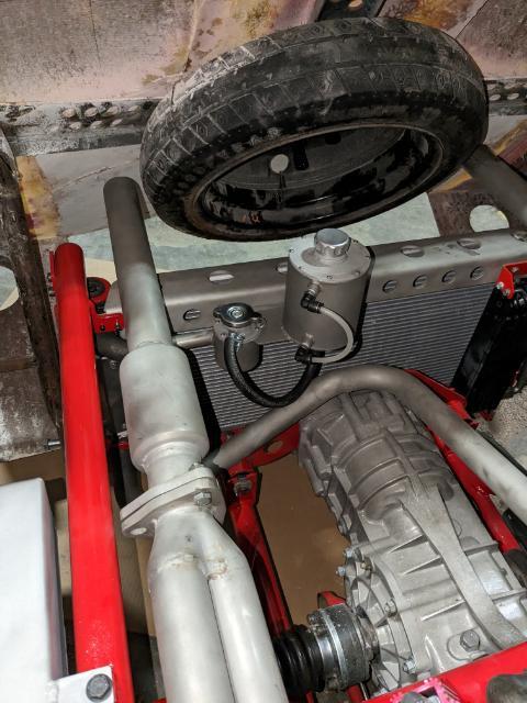

PostPosted: Sun Mar 19, 2023 9:12 am    Post subject: Re: Vokaro project car Reply with quote
Have you put some weight on the rear of the chassis to make sure that the inside of the rear right tire does not touch the right vertical face of your gas tank when the suspension is at full compression? I realize you have IRS so that there is minimal camber change but now is the time to make sure before all is assembled.
DeathBySnuSnu
Joined: August 25, 2012
Posts: 1238
Location: MS
PostPosted: Sun Mar 19, 2023 10:50 am    Post subject: Re: Vokaro project car Reply with quote
Yes.
The gas tank was made in place to fit ..... Mocked up and tacked together.....with no springs or snubbers installed....so on hard bottom.
That is also how the fender wells (cut and flair) were done......along with the ground clearance of the frame and body (roughly 2" at full bottom)

PostPosted: Sun Mar 19, 2023 11:07 am    Post subject: Re: Vokaro project car Reply with quote

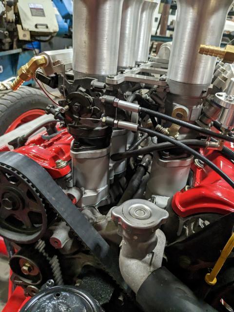

And here is the radiator fill and pressure cap.
Beside it is the puke can.

PostPosted: Sun Mar 19, 2023 11:21 am    Post subject: Re: Vokaro project car Reply with quote
And.....the hoses are all made up and on the remote filter and oil cooler.
Filled with oil and primed up.
Engine spun over after priming and the tdi starter on a type 1 ring on a Mazda flywheel in a Porsche bell housing all worked.
Now that the cooling hoses are newly done it is time to fill with water and check all that for leakes.
I did quickly check the gas tank, but did not hyro it (pressurize and monitor with gauges). I think I will fill it with water and let it sit for a long time.

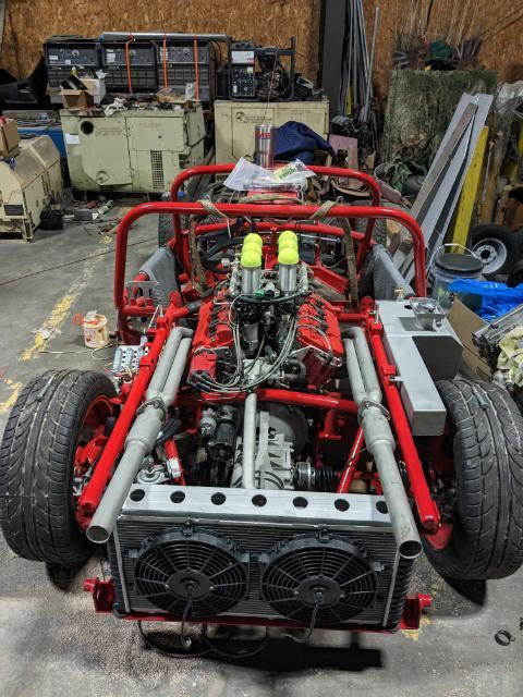

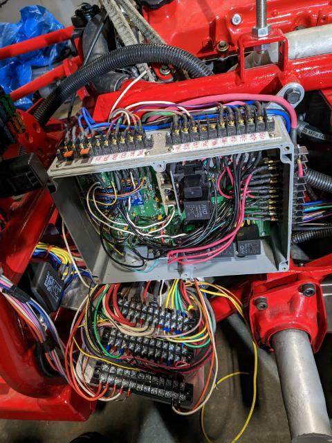

PostPosted: Tue Apr 18, 2023 7:07 pm    Post subject: Re: Vokaro project car Reply with quote
With the mechanical mostly done I have been on electrical.
The "body" wiring is mostly done. All on toggles in the overhead operating relays.
Wiring the "engine" up now with the modified kit computer (in a box with a disguise.
And the battery wedged in the front.

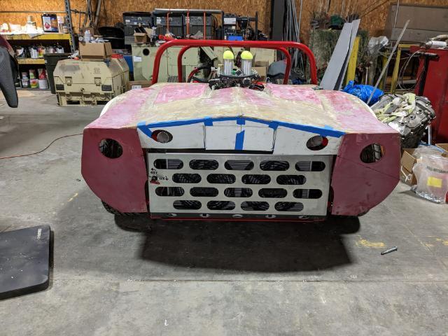

PostPosted: Mon May 01, 2023 4:51 pm    Post subject: Re: Vokaro project car Reply with quote
Still working on the electronics.....had some problems there. I will get there though.
Made a grill for the back end.
Still working out some shape ideas on what to do with the fiberglass. The rest of the body is made just gotta make something work on the back end
