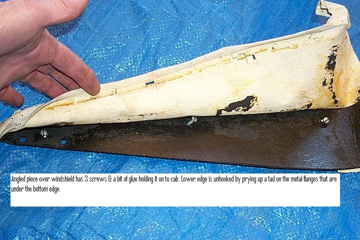

You have to remove the two long triangular pieces above the windshields by ripping off the headliner material and removing the 3 screws holding each one.

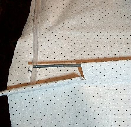

Put up the two short bows. Use hairdryer to stretch headliner toward front and over the doors. Here is where I used a can of contact cement to attach the headliner to the front above the windows and under the flanges over the doors. I got the cement from an auto upholstery shop and it dried much faster than the Home Depot kind. Need fast drying or else it will take you forever. If it comes through the holes, a little Goof Off will take it right off. Follow with a rinse of windex or water since you don't want to leave goof off on for very long.
Now, working your way back, I used a trick at each bow section to hold the bows tight. Otherwise, they flop over sideways. I ran a string to a hole I drilled (Ouch) in the next rib toward the rear and pulled the bow tight with it. Don’t do all bows at once, just one at a time.

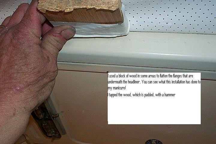

Contact cement as you tuck in edges of headliner & use hair dryer if needed. When dry, flatten the flanges over the doors.

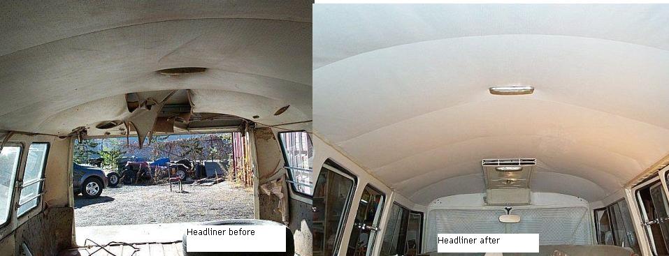

Headliner is up! Now I installed the headliner material on the pillars around the windows and doors. Save the stuff you cut out of the window area– you might need it for the rear panels. I glued these areas on with contact cement. Spray will make a mess. I glued six inches at a time.

The side cargo door seals had to be shaved on the back side to accommodate the raised hinge areas. Then I installed the long triangle pieces above the windshields and flattened the flanges along the top edge..

New picture of headliner job. Put in rear speakers. Used the original piece of cardboard & backed the speaker hole where the screws went with a donut ring of plywood to flatten that area of the cardboard. Still waiting on hinge covers to complete things.
