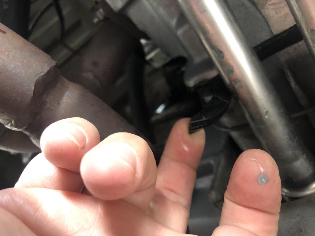

I am resurrecting a really old thread here. I am perplexed! I have rebuilt a handful of 2.1 wbxr motors over the last 10 years and always used a Victor Reinz gasket sets and the Right Stuff on the heads. I am pretty meticulous and take my time rebuilding these motors. All of these motors have over 100K miles on them and are going strong - except the last one. The last one I rebuilt about 6 months ago and has about 5,000 miles on it. I am still breaking it in.
On this most recent engine I ended up using a Elring gasket set with brand new AMC heads. The Erring set was not what I thought I ordered or was shown on the web site of one of our faithful and trusted Vanagon vendors. However, it is what came in the mail. So I forged ahead and used it.
Anyways, on this latest engine I have had both water-jacket seals fail within the first 5,000 miles on the rebuilt engine. When the first one on the driver's side went, I thought how weird, I must have pinched it or not had it fully seated when I torqued the head down. It split and was pushed out from between the head and the block. I pulled the head (with the motor in place) and used a Victor Reinz seal when I put it all back together. All was well for another 500+/- miles. UNTIL the the passenger side split yesterday in what looks like the exact same place. Fortunately both times I was within a block or two of my driveway and was able to limp home. Is this just a coincidence? Did I mess up both sides when I installed the heads? Or, is there something faulty with the gasket set I got?
I am interested to hear from this group and get your thoughts.
Once I get the passengers side a part I will take a photo of the water jacket seal and show how it has failed. Stay tuned!

Stretch diagnosis: is it possible the heads were machined wrong? If the deck and the combustion chamber depth was incorrect, it might allow the head to over squish the seal.
Iโ€™d also be curious of the manufacture date of the gasket set. Maybe they sat on a shelf too long in a poor environment. After you seal it up hopefully you are good to go. If not, your going to have to make some measurements. Bummer.

It would be easy enough to temporarily install the head and measure the gap between the waterjacket and the cylinder head sealing surface. Then measure the thickness of the supplied gasket on the bench. Doing the math you'll get an idea of how much the gasket is getting compressed. It needs some compression, but too much and the water jacket would likely cut into it causing it to fail.

I have a sheet stapled into my old Bentley book. It came from Foreign Auto Supply Team. The sheet recommends fitting the heads dry at 20 ft/lbs and measuring the air gap. The recommendation is to achieve 0.020 to 0.030 of an inch crush on the gasket. It is a little tricky to measure the gasket thickness. I use a machinists caliper to wiggle around the lip after I tighten the set screw. If there was too much crush the gasket should have split lengthwise above the crankcase.

Yes, Elring gaskets fail. It's been documented by rebuilders Mark Pluygers in Holland who had a lawsuit I think against them but nothing good came out of it.
Avoid entirely.

I have been asked to post a photo of my ancient tip sheet for waterboxer coolant jacket heads. So here it is.
That's where I was trying to go in the above posts. Thanks for posting that.

Does this apply only for aftermarket gaskets? I had no idea they came in different thicknesses, is this done one purpose or is it just manufacturers tolerances from one brand to another?
VW only had one thickness and part number 025101345.

I have one leg in VAG products and one leg in BMW land. Reinz is reviled by BMW techs and for good reason. Reinz BMW valve cover gaskets leak profusely. Oil filter housing profile gaskets also. Now I only use genuine BMW gaskets on any rubber profile gasket. The same with Mercedes. Only OE or for the old ones Bruss,
Elring used to be the standard. Two years ago I was in a pinch for a Valvetronic motor gasket on a BMW valve cover job. I ordered an Elring. The Elring package contained a Reinz gasket.
I talked to the Elring rep at the BIMRs meeting about it. Unlike Reinz, Elring is still owned by the founding family. Most of the mittlestand firms have been sold to the very large international corporations. The rep told me that when they have a lack of a product that they will repackage other brands. Next time I see the Elring rep I will discuss this with him. I will say that I still use Elring gasket and seals in many applications and have no trouble with them.
I have probably done less than 30 Waterboxer head jobs in my time. I have measured every one and never found one to be outside the desired crush. But I am extremely averse to machining those cylinder heads. I have done my share of machining in the past and getting both cylinder bores fly cut square and to the same depth and then the same on the water jacket sealing surface is asking a bit much.
I am certain that I have used Elring in this application before. Something to consider is that there are a lot of counterfeit parts around. I have found them in the WorldPac supply chain. But They never made OE waterboxer parts in China. So that means that it is unlikely that counterfeits are making their way into the OE supplier pipelines. But on Amazon? FCP? Etc.. But this is the second thread on The Samba with failing gaskets branded Elring.
