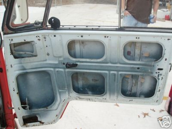

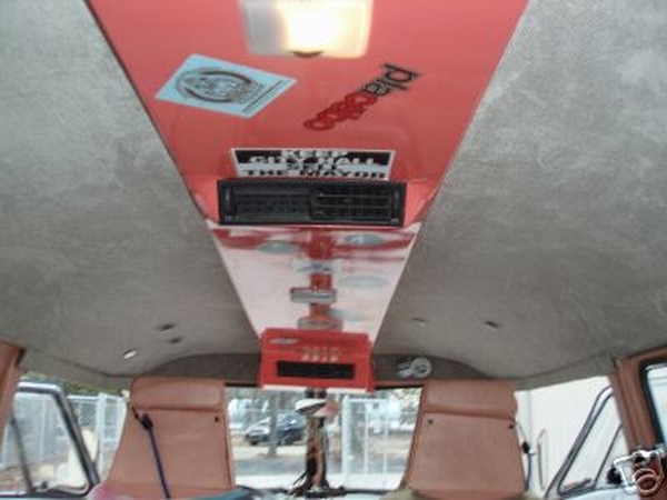

1967 VW 11 window Bus with split front window. 1600 dual port engine. Has new starter, alternator, and Ranco transmission. New tires in July. body is good condition, there is a place on the drivers side floor pan that is rusted through as you can see in pic. other than that spot the rest of the bus's floor is solid. few bubble spots of rust along bottom of van. does not look to be major. It's lowered 17 inches. the bus does run, it is a daily driver to the owner, she is just ready to have a car with heat and air.
Please call Darcie at 561-6##-#### for any other information or questions.
The lack of interior was not a problem, the paint looked excellent and shiny, and in my excitement, was not even concerned about the Jetta steering wheel and how the heck they got that in there.

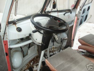

First thing I noticed was the extra sloppy steering. Everything was as I had expected, but the steering was unbearable. That and the just as sloppy shifter, which I did not think was a big deal...very fixable

The seller informed me the color was an original VW color called "Flamingo Coral". Nice story, but after searching so long and browsing thesamba.com for so long, I knew better. She said it was an ex show bus. That I believed after seeing the custom speaker pods on the cargo door, and the Porsche bucket seats.
The airbrushed image above the driver's headlight is a guitar with the word Woodstock across it.
I got the bus home, and she had sent two old copies of VW Trends magazine with it, and one had a feature article of the bus.

The surprises after delivery were:
The sloppy steering as I mentioned,

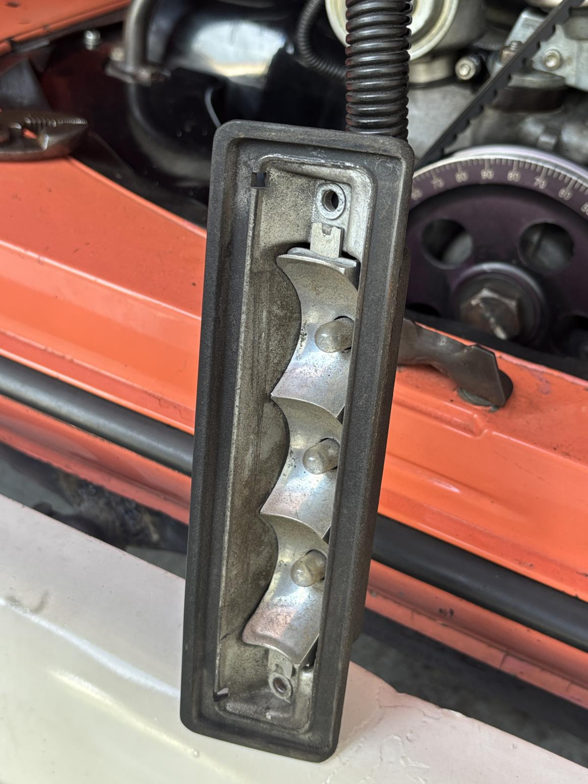

the sloppy Scat T-handle shifter (I had one on my bug, and don't recall it being that bad),
a crack across the width of the passenger side safari window,
and a mural on the back hatch under the tree-hugger stickers that just had to go....
The mural was of a VW graveyard of old buses and Freddy Kruger driving a peach colored bus up out of a grave with the headlights on. The wife and I were like WTF? I meant to say what the heck? (we have kids now.)
The black object above the passenger's headlight was an electrically amplified, manually retractable car stereo antenna. Out of place does not begin to describe what I was thinking...WTH? It required 2 distastefully places holes that could not be covered with an antique style antenna.

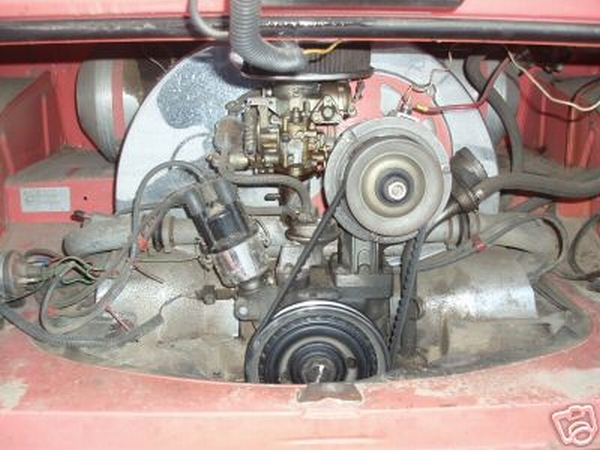

Too bad all the high tech stuff got stripped out. Listening to cassetes and playing Nintendo would have been fun. Looks like the 914 seats are still with it.
Does the engine still have the second alternator?

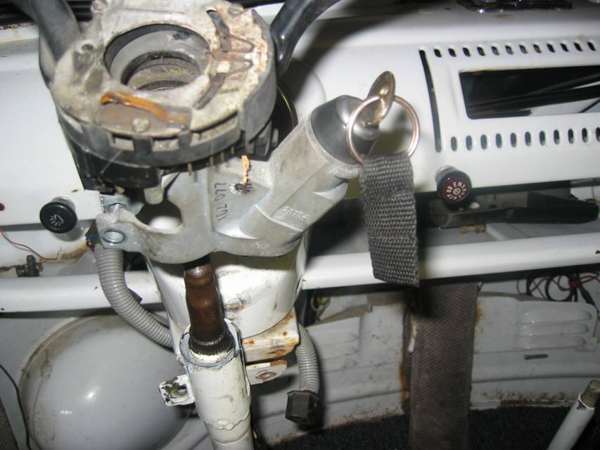

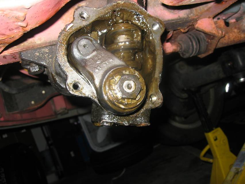

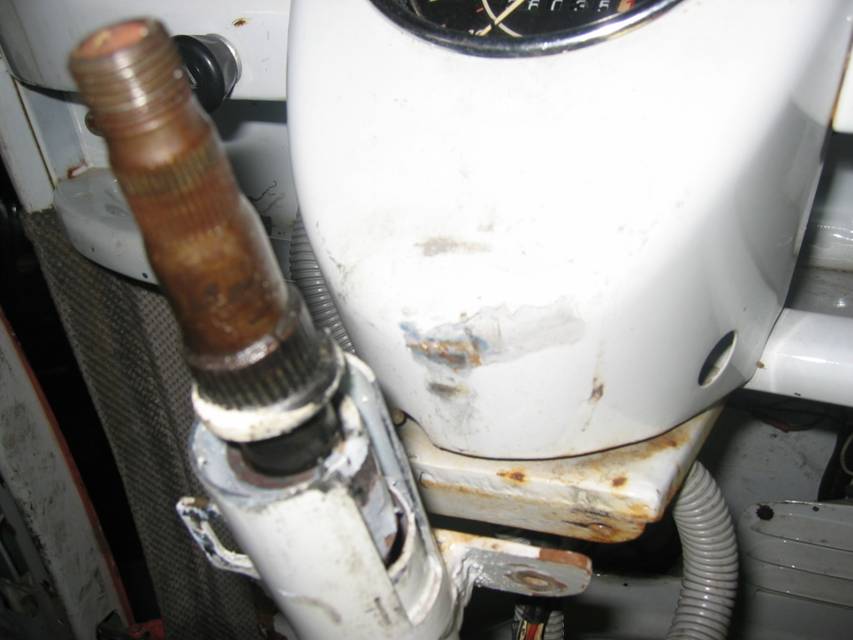

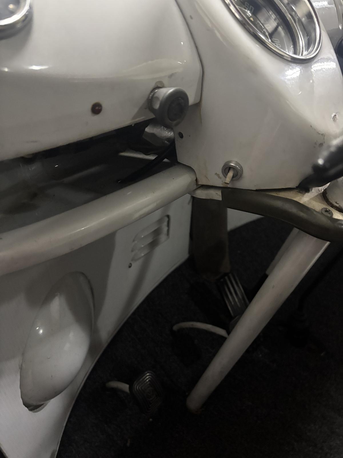

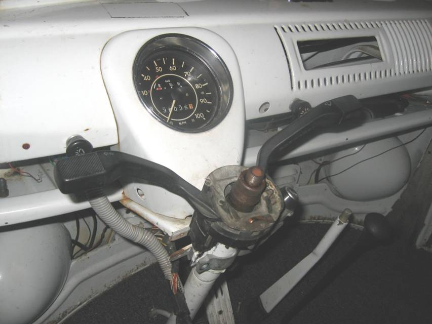

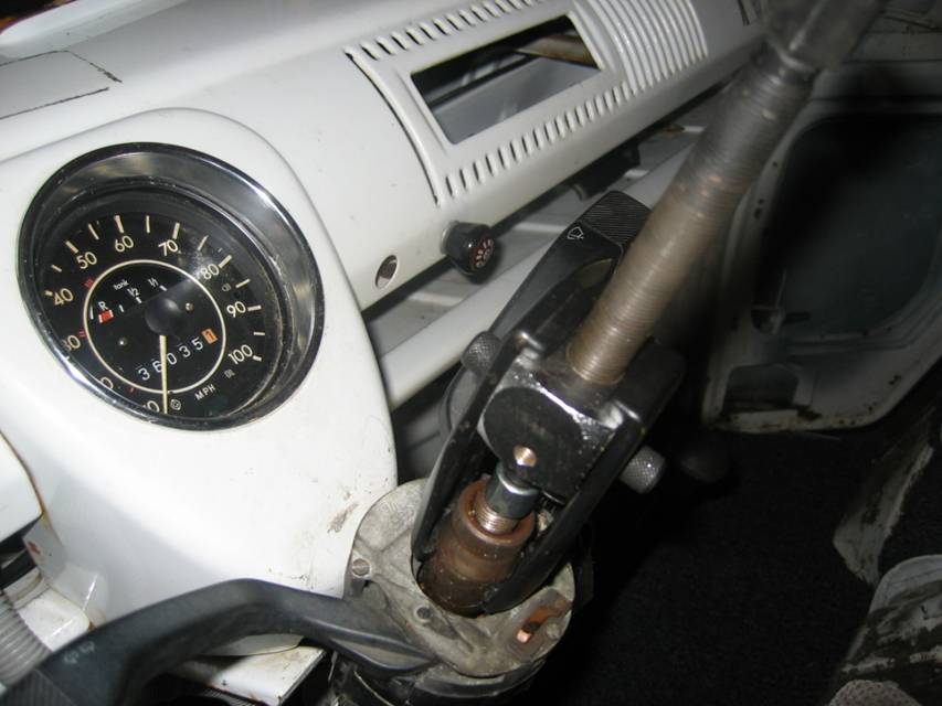

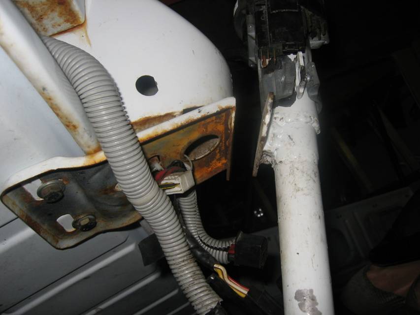

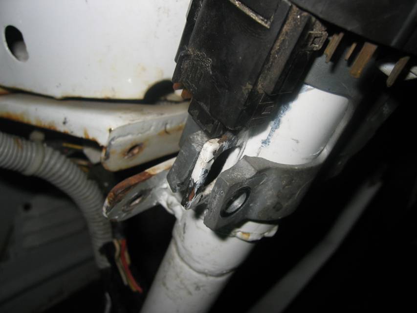

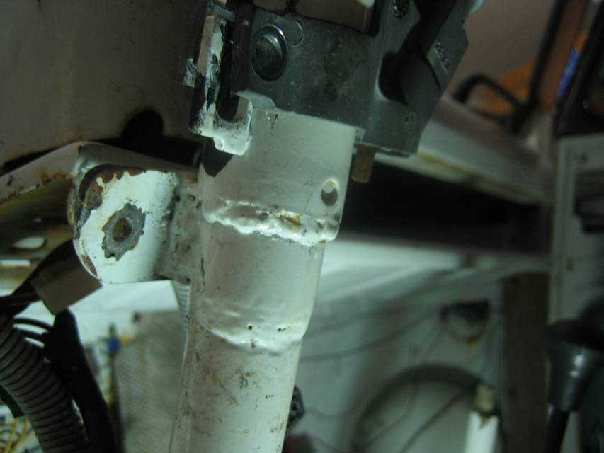

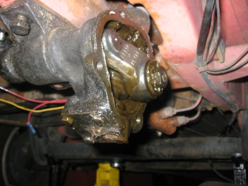

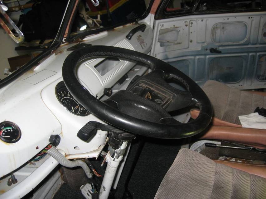

PostPosted: Tue Dec 16, 2008 8:13 pm    Post subject: Steering Box Rebuild Reply with quote

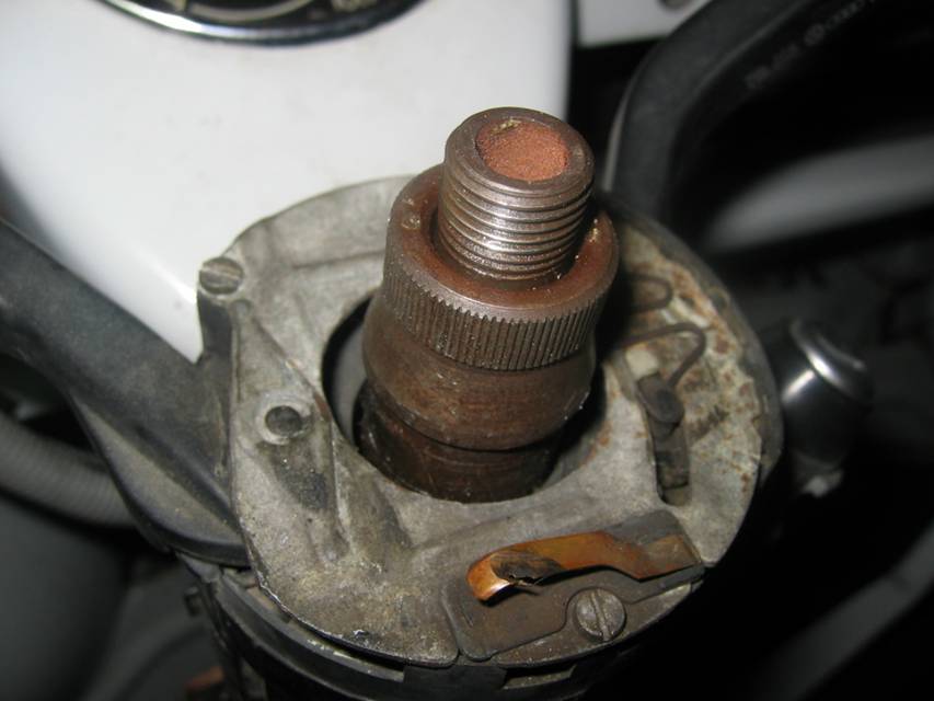

OK, I tried all the tricks for adjusting the steering play using the adjustment screw, no success. Tie rods were OK, with no play.
I bought a link pin kit, and a new drag link and rented the reamer and went to work in installing the center pin. My shoulder was sore from reaming, that was tiring....
Still had play.
So I have the wife rock steering back and forth and see the play is in the steering box.
Next task was getting a rebuilt steering box. Ordered one from BFY Obsolete parts (bad story), and tried to remove mine to send back for some CORE money ($250 to be exact)
Removed steering wheel (yeah, it is a Beetle Speedometer, shut up)
OK, some welding went on here...
Looks like some kind of adapter that I can just slip off....wrong.
Taking off the adapter
Adapter off, now what
Maybe I can remove it from below by disassembly...
No go.
That b*tch is cut and then welded on
Old parts:
I had to cut the outer column and the inner shaft. this meant that I was not going to be able to return this box for core money. My steering box just doubled in price...
