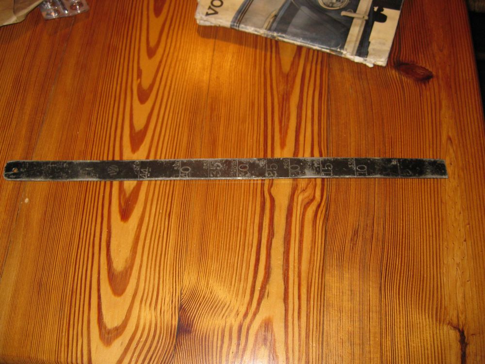

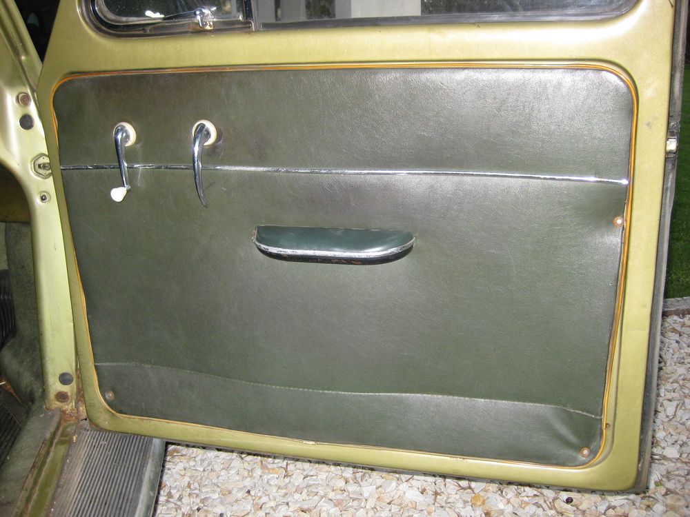

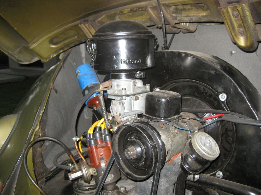

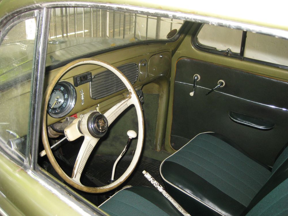

Here you have some photos of my oval, and the fuel dipstick wich come with it. It appear to be original, but I'm not sure, what do you think?
Thanks
Marcos
