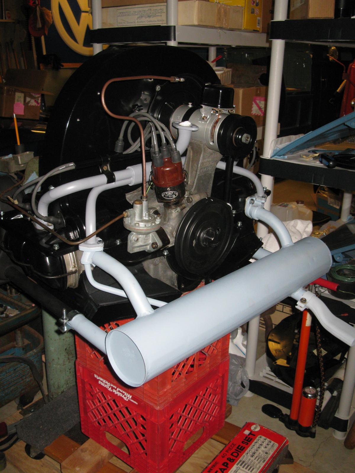

PostPosted: Sun Nov 18, 2012 9:15 am    Post subject: Reply with quote
I used the Ford Gray high temp engine paint on this intake:

PostPosted: Sun Nov 18, 2012 11:47 am    Post subject: Reply with quote
BarryL wrote:
So you're talking "New Ford Gray" since it's gloss: same as Clara's?
Rustoleum engine enamel, 500*, Ford Gray 248958. No reference on the can to "new".
