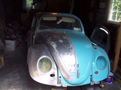

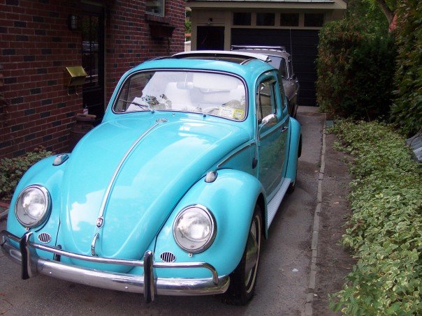

As I got it.

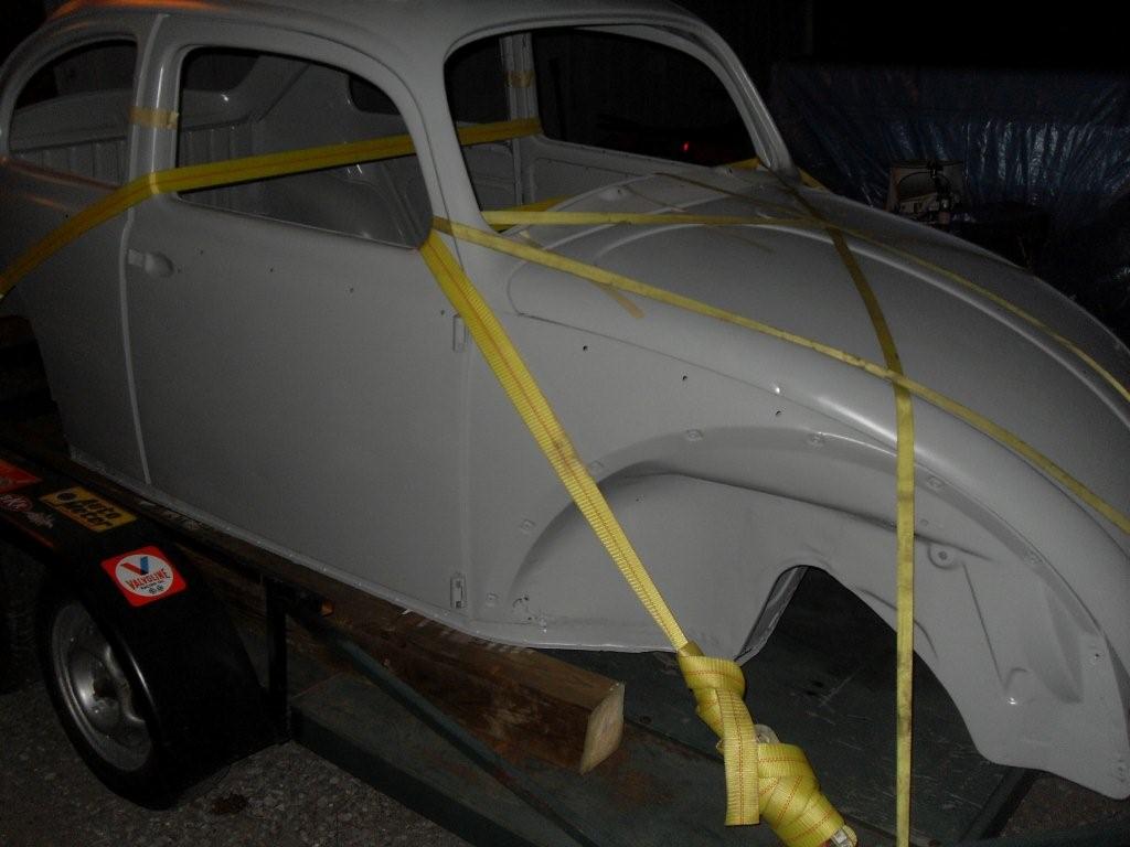

Body coming off. My oldest, Drew, turning wrenches and bustin' knuckles.
Stripping the old nasty paint.

Back from mixed media blasting. Walnut, glass chips, and sand. Hand sanded then expoxy primed.

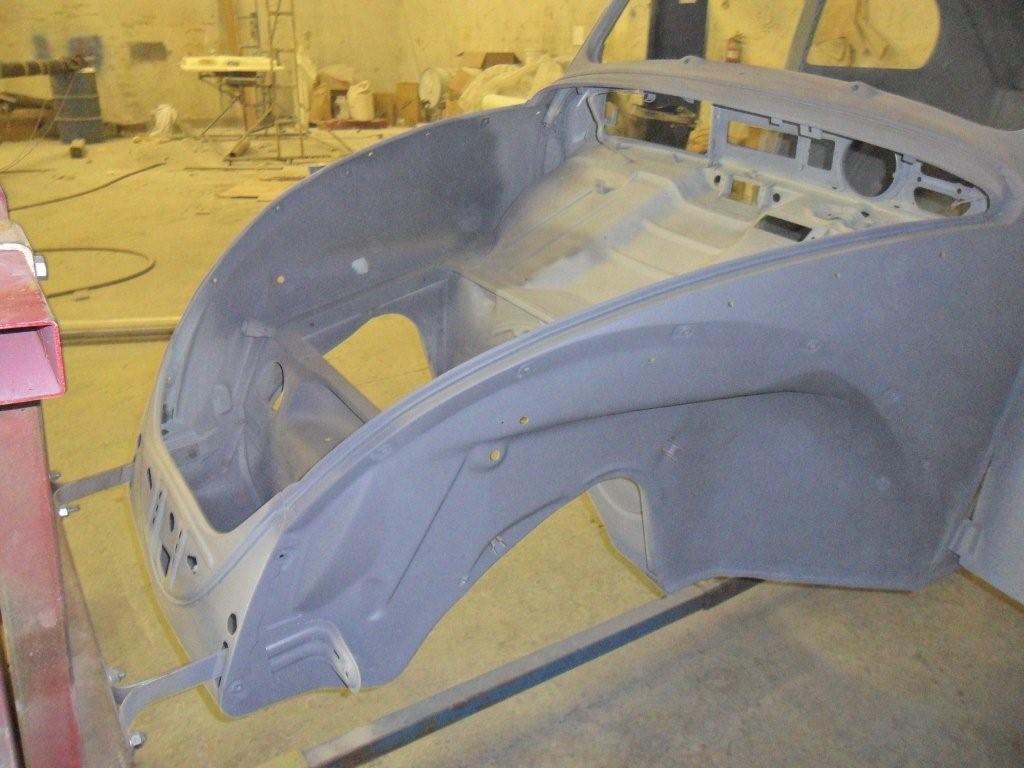

Dave, what stripper do you use? What's your process? Does it bite through in one application, or do you go layer by layer? This thing is looking great by the way!
Hey Brad,
I used to buy Aircraft paint stripper from Napa and it worked well but the guys at the store suggested that I save some money and just buy furniture paint and varnish stripper from Home Depot. It worked just as well as the expensive stuff. It took two applications to get down to bare metal.
That being said, the media blaster was waaaay faster and very reasonable. I'd never strip another car by hand again.

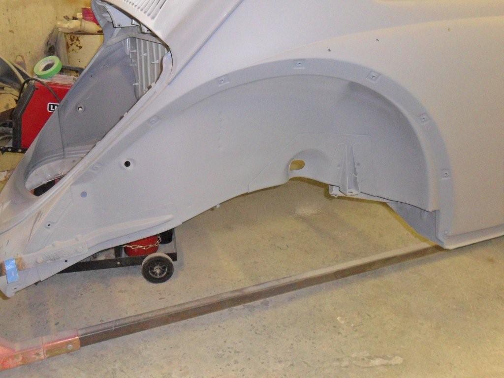

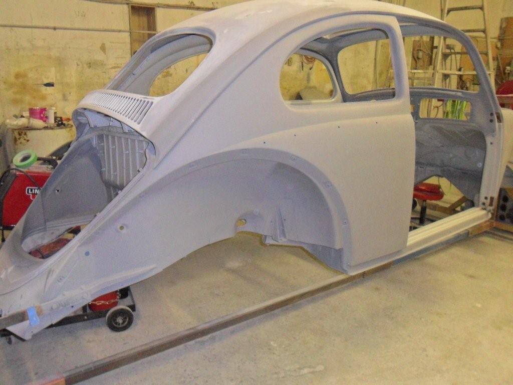

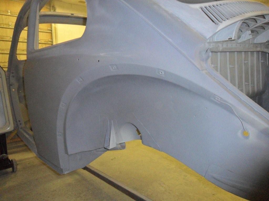

Welding is done as is most of the body work. Almost ready for first full prime. Hoping to shoot colour after the Vegas show in October.
