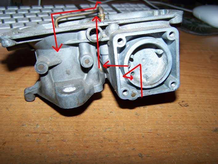

Here are a couple of thoughts, based upon my general understanding of Kadrons, and a lot of years of tinkering with them, rebuilding them, re-bushing them, and fixing other people's cars that were set up wrong. That's not to say I'm anywhere near the expert that AJ is, but I do have a fair understanding of what's going on. PLEASE correct me if I'm wrong on anything:
First of all, starting from the bottom where the fuel is sucked into the pump circuit, I drew arrows to show the path of the fuel. The ball (check valve) is in the tube where the arrow points straight up. It's job is to prevent air (and fuel) from being sucked back into the pump chamber when pump diaphragm is on the "rebound" cycle. It works with gravity, and with the vacuum that is created by the pump diaphragm.
Think for a minute about the fuel level in the bowl. It is somewhere near the top in a normally running carb. Let's say that the float is not floating properly (perhaps the float and dogbone are reversed, the float is sunk, the float is bent, etc...), and the fuel level is higher than it should be. The fuel level could rise to the point where it is close to the top of the bowl, but not spilling out the vent yet, or if it was, perhaps it was not discernible due to the small amount. Now, with the added vacuum created by the air funneling down the venturi, the fuel could possibly get through the whole circuit and creating a p-trap, or a syphon, sucking more fuel as it got started.
The check valve ball, as I understand it, does not prevent fuel from going up, it prevents air (fuel)from going down, although its very weight may somehow regulate the amount of fuel that goes up.
Bear with me, I'm thinking out loud...
If the fuel pressure was too high, contributing to the fuel level being too high, that could cause all of this. I would add some extra gaskets under your fuel pump before going any further to eliminate that as a possibility. I personally think that might solve it. We KNOW what the fuel pressure should be, so why not start there and get that behind us as a possibility?
You have two separate carburetors that are doing the same thing, right? The only thing that both carbs share is fuel supply. I would start there. If one carb was doing it, I'd say you may have a float problem, or possibly another issue. The chances of BOTH of the carbs sharing the same problem is highly unlikely, though, unless they were incorrectly rebuilt by the same guy.

PostPosted: Mon Feb 08, 2010 8:32 pm    Post subject: Reply with quote
the carbs that do it are set up simply. The arm of the accel pump diaphragm pushes in the checkball at WOT, opening up the circuit to vacuum.
Seeing that picture it is NOT setup for WOT enrichment thru the pump circuit.

well, you don't want it to hit metal, you want it to hit air and have that airflow carry it to the cylinders. That's the most effective way to provide the fuel to the cylinders during throttle opening.
It's just advice, do whatever you want with it!

Great - that's kind of what I was thinking. Thanks
