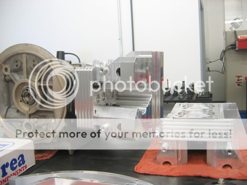

A co-worker emailed me some very interesting photos of a type 1 engine setup. Apparently these are Hayabusa heads modified to work on a type 1 engine. This modification surpases my limited knowledge on this subject, so I'll let you fine folks take a peak, and make comments on what you see!

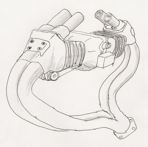

I love when the game changes a bit. I drew these up (quickies) of some of the perversions I would like to experiment with. All I need is a milling machine and a million dollars. Yes there will be some injuries in the process.

That engine belongs to Brian Hyerstay. The heads are 100% custom, not modified Hyabusa heads. As far as a "sloppy" Subaru goes, Brian has made more HP in 1679cc's than most of you will ever pull out of a VW. It's good to know the standard is judged by those who do so little Rolling Eyes
Oh, and considering those heads are going on a 1679, some of you folks will be even further away from ever making the HP Brian puts down.

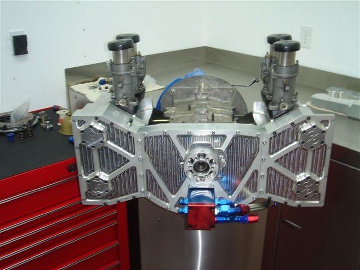

So...are they oil cooled?

Cooling isn't too much of an issue for a quarter-mile drive.

spose not, just wondering about the line setup. It's a wow setup for sure. Some people can't appreciate innovation. If it's not broke don't fix it, but by all means, make something better.
Dry-sump oil pump; he's probably supplying the cam bearings with the oil they need and scavenging the oil from the heads.

That engine belongs to Brian Hyerstay. The heads are 100% custom, not modified Hyabusa heads. As far as a "sloppy" Subaru goes, Brian has made more HP in 1679cc's than most of you will ever pull out of a VW..
Fantastic! I knew someone eventually would enlighten us! Smile Is there anymore information on these heads? I'm curious to see their design, and how much hp that setup can achieve! Its quite genius actually!
oldskoolbug
Joined: December 07, 2008
Posts: 434
Location: Toronto, Canada
oldskoolbug is offline
PostPosted: Fri Oct 22, 2010 8:17 am    Post subject: Reply with quote
Actually, I just did a little digging up online. There is quite a bit of information posted by Brian himself on the Cal-Look.com forums, where he goes by the username of 1649vw.
Its a 1679cc motor, putting out about 220hp. His car runs in the low 9s and can achieve 11,000rpm. There was also mention that he uses 5" Carrillo rods with a ratio of 1.84:1. Those heads are 2-valve, 2 spark plug heads. Very impressive!

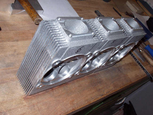

There another user on that forum that was/is working on a 4 valve DOHC setup. Here are some shots.
Here is some data he posted in regards to the first flowbench tests on the 4 valve dohc heads.
Flow at 25" is:
1mm - 38,2
2mm - 70,9
3mm - 107,9
4mm - 144,1
5mm - 183,3
6mm - 210,7
7mm - 230,7
8mm - 245,8
9mm - 256,0
10mm - 263,7
11mm - 267,6
12mm - 272,2
All measurements above without manifold.
12 mm with a primitive manifold 285,4
13 mm with this manifold 289,1.
