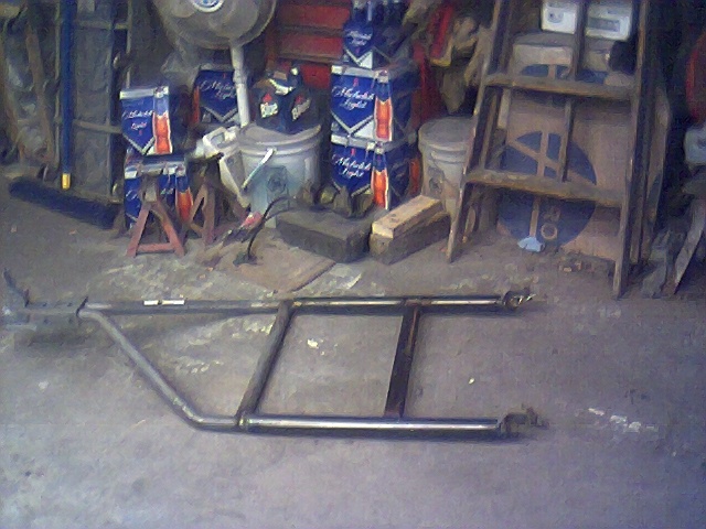

PostPosted: Wed Aug 08, 2012 5:06 pm    Post subject: Modified Super Beetle to Type 3 Towbar Reply with quote
Secretary Sue here,
I'm writing this under Bob's name, cuz the pics are all in his name, in T3 parts and accessories. These pics are from 2008, when Bob needed to make up another Type 3 Tow Bar, cuz our other one that he made was still down in Texas.
I've included the caption, and the pics in hopes that it'll make searching for it here in the Type 3 forum easier.
(quote)
Since this question comes up quite regularly, here's how to modify a Super Beetle towbar for use as a Type 3 towbar.
After I cut off the "ears" on the Super bug towbar, I welded on 24" long, 2" diameter tubes to extend the total length and then welded the "ears" back on to each tube end. I also added a 21 inch long , 1 1/2" X 1 1/2 " piece of angle as a crossbar for extra support.

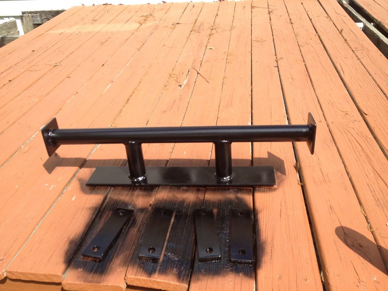

jeremyrockjock
Samba Towbar Builder
Joined: January 01, 2002
Posts: 5008
Location: Richmond, Verjinya
jeremyrockjock is offline
PostPosted: Sat Feb 04, 2023 4:24 pm    Post subject: Re: Type 3 Tow Bar? Reply with quote

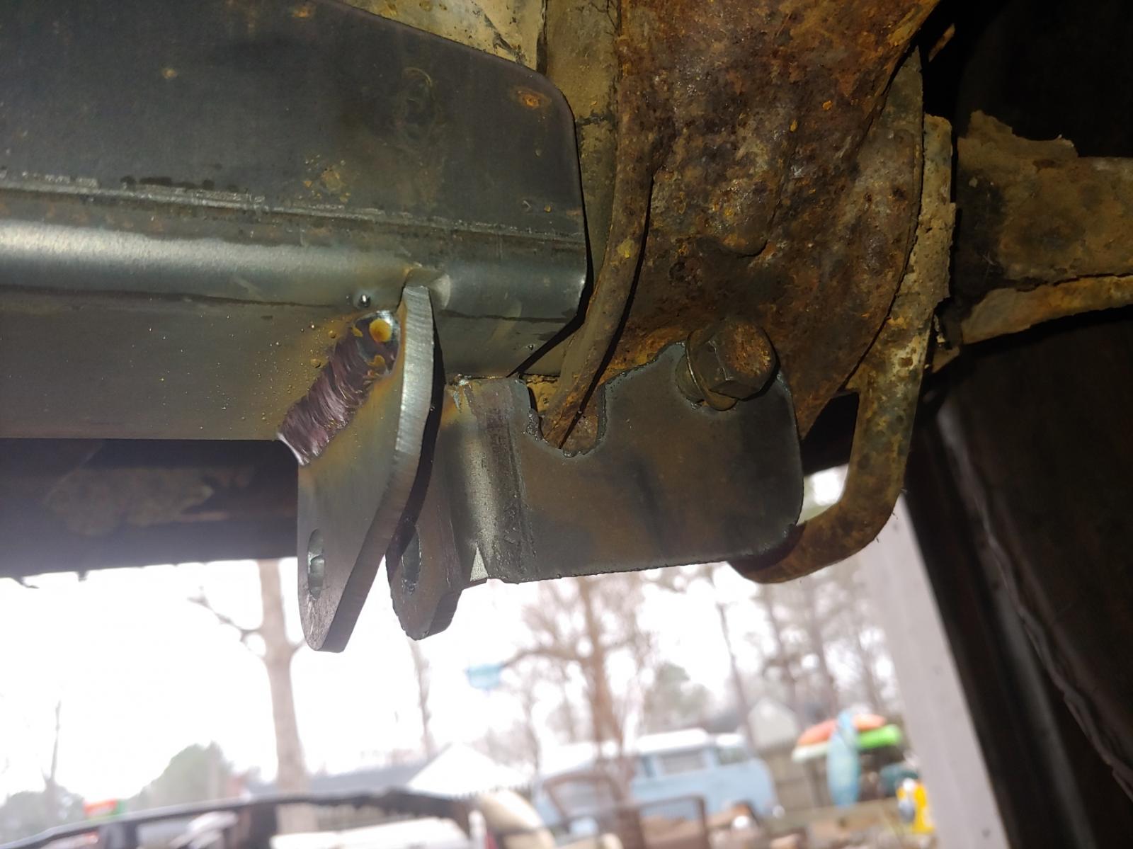

I have finally come out with a Type 3 tow bar. It is a bracket that attaches to the opening of the front beam and the two lower beam bracket bolts. It stays attached to the car and then the tow bar attaches when needed.

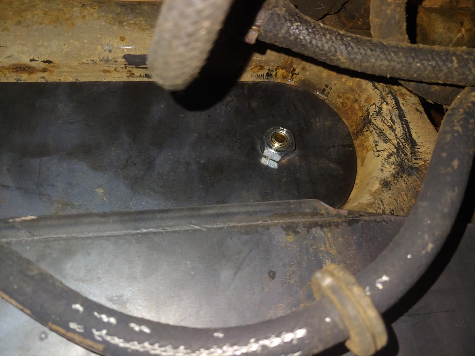

PostPosted: Mon Feb 06, 2023 3:37 pm    Post subject: Re: Type 3 Tow Bar? Reply with quote
The only problem I see with that plate set up, is that some of us who use the Airtex E2000 electric fuel pump move our pumps to that middle opening, versus keeping the fuel pump in the stock opening and kinking the fuel hose.
That's not taking into account that some of the guys who want to get even lower are relocating that lower beam clamp bolt and hole (on each side). Just a few thoughts.
It looks like for a stock height non FI car it would be a great solution.

old_man
Joined: June 19, 2018
Posts: 1414
Location: Newfoundland
old_man is offline
PostPosted: Mon Feb 06, 2023 5:39 pm    Post subject: Re: Type 3 Tow Bar? Reply with quote
Interesting design for the hook up. Sort of similar to what I did once. Yours probably has a bit more ground clearance though.

PostPosted: Tue Feb 07, 2023 4:40 pm    Post subject: Re: Type 3 Tow Bar? Reply with quote
Thanks for the feedback Bobnotch. I know next to nothing about type 3s so any feedback is appreciated. Is the pump relocation something I could add a bracket for?
Yeah old_man I saw your design and I do like it Thumbs Up I was trying to make it all in one piece for easier installation.
Again any feedback is appreciated.

PostPosted: Wed Feb 08, 2023 2:15 pm    Post subject: Re: Type 3 Tow Bar? Reply with quote
I think an FI type3 owner who has already converted to the Airtex style pump, would probably zip tie the pump out of the way while using the tow bar plate. Keep in mind that the pump bracket uses 2 pieces of steel trapping the lip (sandwiched) with 2 M-6 studs on rubber bushings. The pump normally resides in the far right opening (LHD cars), hence why the hose from the tank to pump has a tendency to kink, and why we relocate the pump to the middle due to it's length (the pump itself). If an FI owner still uses the stock pump, then there's no problem with the plate mount set up. Same applies to the carb cars, as there's nothing attached to the beam in that area.
I hope this helps.
