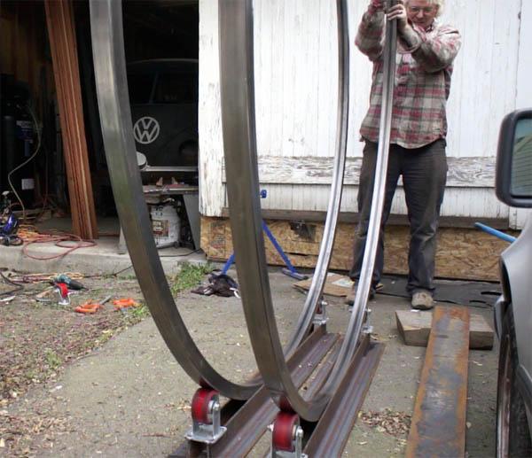

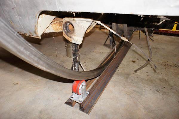

I will be building a rotisserie Based on photos on this forum. The tubing is 2 inch square 1/8 thick. It cost $200 to have three 20 foot pieces bent to a 100 inch outside diameter. The third piece will be used to complete two circles as 20 foot was not long enough. The bender left straight sections at each end to be cut off.
Here is the machine used to roll the tubing.
Overhead crane to get them on my truck roof.

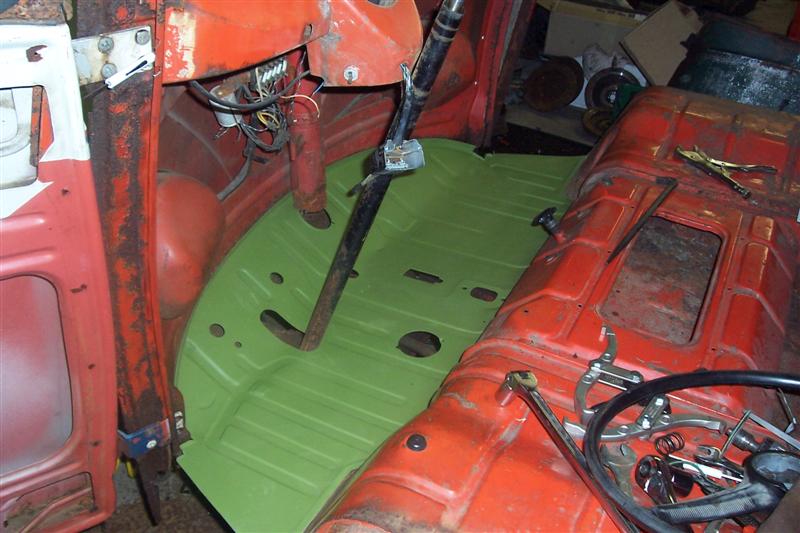

Some references give June '59. VIN #492610 Here is my dilemma. My brake and shifter are to the rear on the floor but steering column is a small hole not a slot. I need to know what replacement floor to order.
This is my floor.
This is a '59 or early replacement floor with slot and rearward shifter. I hope it is ok to link to others photos. I am still new here.
This is a replacement floor for '60 and later with small steering hole but forward shifter.
I am thrilled that we have such a choice in available replacement parts. If my truck is an odd in between year thing I would like to keep it that way. I could weld up the large slot or find a rare? steering hole plate. Will Klassic Fab supply an early floor with a small steering hole?

492610 is early August, 1959 so yes, that is a 1960 model year Truck.
The front floor is not a 1960 model year change, it changed at:
VIN # 501707

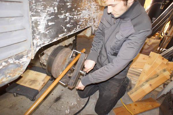

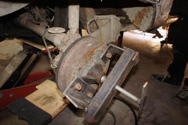

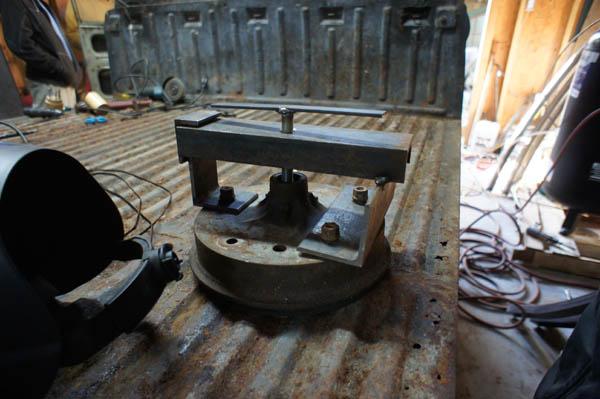

My older son is learning to weld. He welded this brake drum puller for Funky. One drum came off but this one was stuck on with hardened grease all the way off. Splines are in good shape with some cleaning.
Yes that is a broom handle.
Not beautiful but it was low cost and works perfectly. It will go in the tool chest with honors!

At the end of this you'll have an entire tool box dedicated to "homemade" tools that aren't pretty but work great.

It is great to see a father and son project that gets the kid thinking outside of the box like that drum puller.... Wink

That drum puller is brilliant Exclamation You should see the one I hacked together Embarassed
