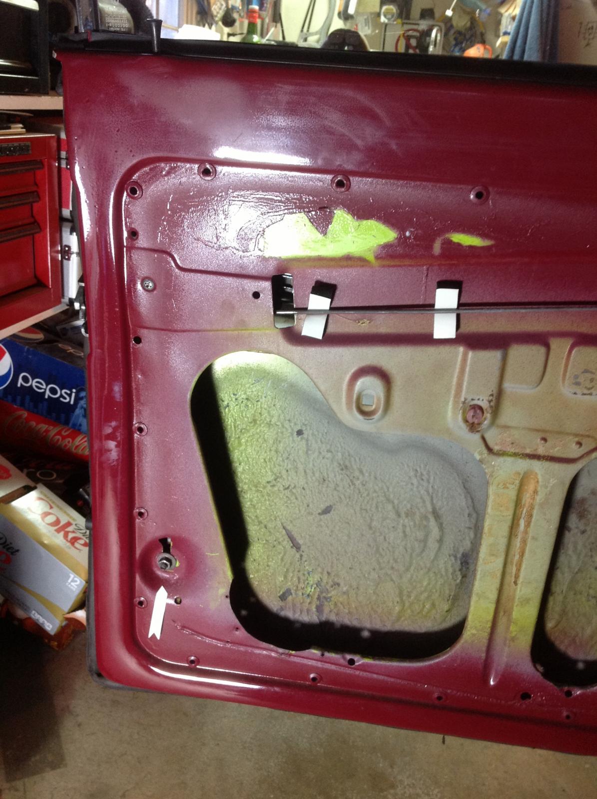

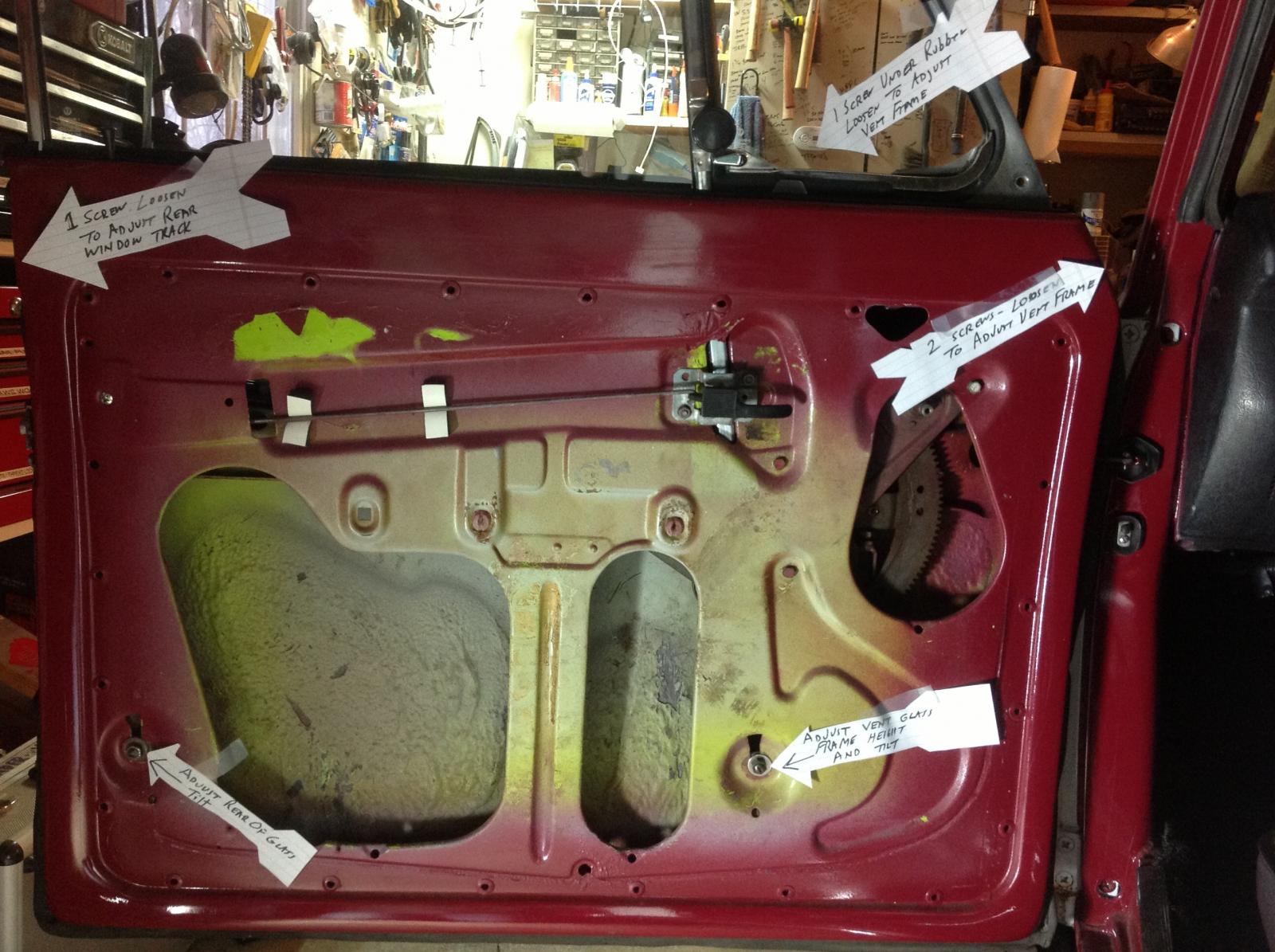

First a picture of my Drivers door, I crudely marked where important points are located that must be accessed for adjustment........
Here are close ups of these points......
These units have a sheet of glass with a track mounted to the bottom which fastens into the WINDOW REGULATOR arm.
The top edge and the rear edge have a chrome trim mounted to them, the bottom of the rear trim HAS A NOTCH which rides in the rear window guide.
There is a REAR WINDOW GUIDE that fastens top and bottom with the bottom having the ability to adjust glass tilt.
The front of the window glass rides in the WING VENT ASSEMBLY, this has a large groove with a felt channel pressed into it to securely hold and guide the glass. This vent assembly concept is probably the only part of the system that is similar to the Sedan.
This vent assembly also has provision to adjust tilt of the unit.

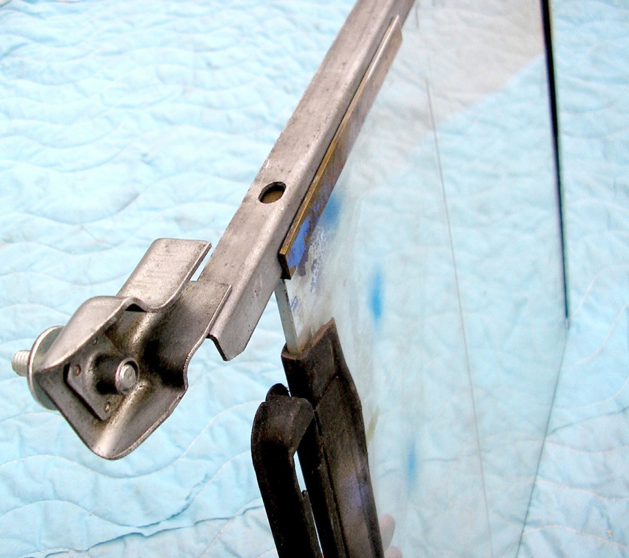

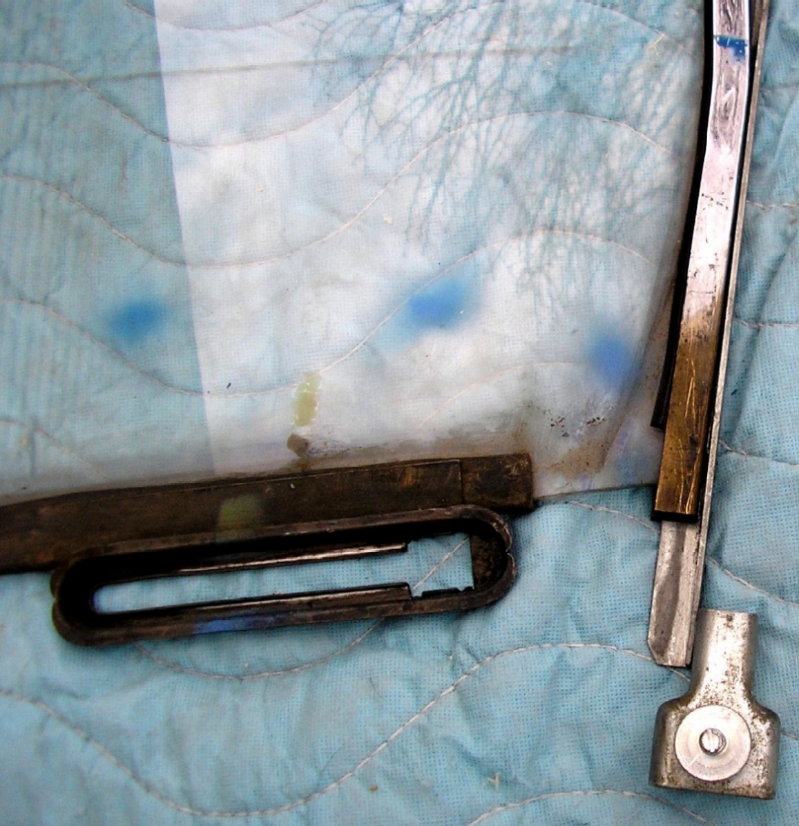

Photo of window components.....
Bugs'n'Pugs wrote:
Ssstang67 wrote:
The glass yes but the chrome trim has a L shape on the bottom back and I need to know if it goes toward outside of door or inside of door???
Okay, here are the pictures that I took of the passenger side door window components from my 1978 Super Beetle Convertible.
(So there is no confusion, all pictures are of passenger side. I left the driver's side components wrapped up. Wink )
This 1st picture shows (L to R) the vent window assembly, the window/window frame assembly, and the window guide. The orientation is as if the viewer were seated in the passenger seat and looking out.
This 2nd picture has the same orientation as the 1st picture, but shows the interface between the window/window frame assembly and the window guide.
This 3rd picture shows how the window/window frame assembly and the window guide come together. Here I have picked the components up so that the viewer is look at things as if they were outside the car near the rear passenger tire and looking forward and into the car.
I hope that this helps.

*Remove the 10mm bolts for the window regulator, there should be three of them, I've painted them white in the photo below..........(ignore the white arrow)
Step 3

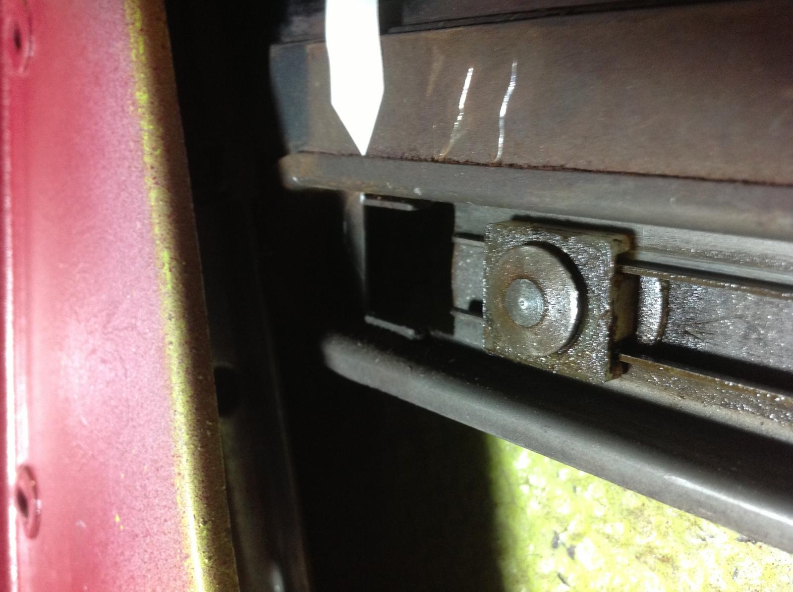

*Slide the window lifter towards the rear enabling the white plastic guides to exit the window lift channel via the rectangular holes. You may need to reinstall the window crank handle and raise or lower the mechanism to successfully get everything lined up properly.
(Window Regular and bottom window channel, Arrows point at both Rectangular holes. White Plastic guides? Well.....not so white!)
(Close up of rear window guide and hole)
(This rear guide is an adjustment point, it has a slot in the Regulator and is held on by a Nut, the Front guide is riveted onto the regulator.)
(View inside door looking up at the nut)

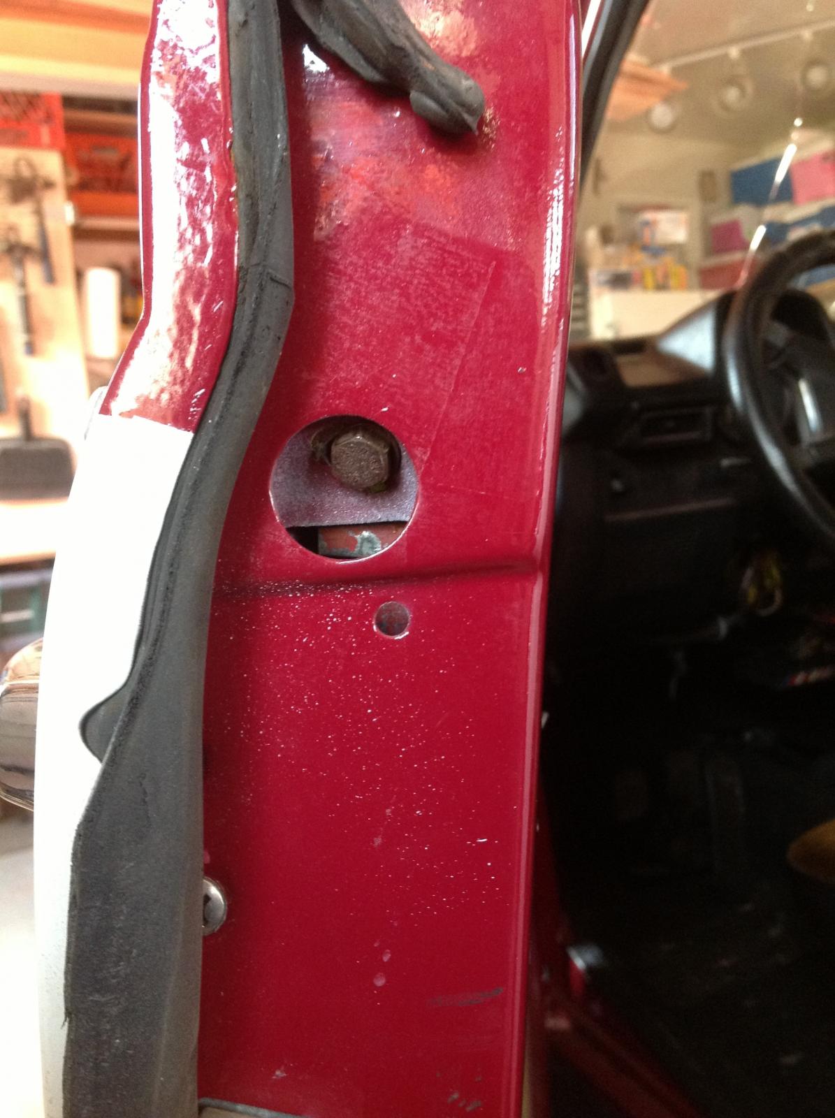

*On the rear edge of the door, pop off the plastic cap towards the top and remove the 10mm bolt that secures the rear window guide in the door. ( I suggest doing this before you remove the door glass.)
Step 7
*Remove the 13mm nut at the bottom of the rear window guide bar, remove the bar from the door cavity, it may need to be maneuvered around the door latch and the side impact reinforcement. (Found on newer doors)
