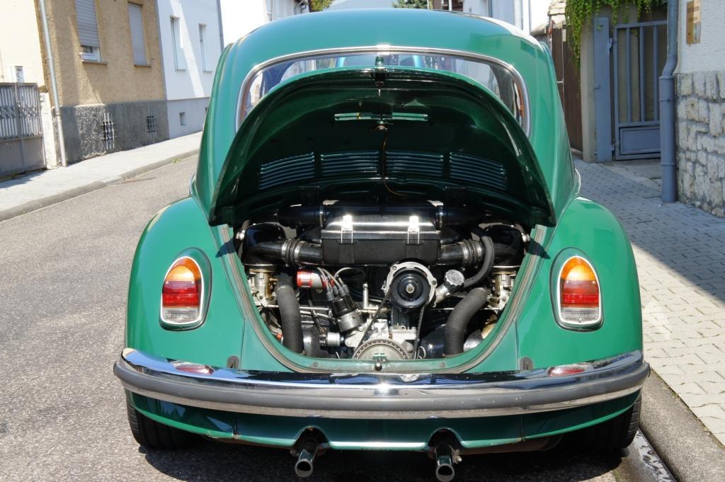

Hi folks, welcome to my build thread. It’s supposed to become my project diary. If you expect a quick happy end, I may disappoint you. It’s going to be a long build, because I have big plans and limited time available…
It was in Osnabrueck where the T1 Ghia Convertible started his live in 1965, before it was shipped to a VW dealership in Detroit, Michigan. It was checked regularly; proof is the service book which is still with the car, together with the original service manual.
One of the previous owners must have gotten into trouble as the Ghia was turned in at a local pawn shop. It was hidden there until the shop went bankrupt in 1999. Everything went for auction and a lucky guy from Monroe bought the Ghia.
I do not know how long she was stored away, but she did not see many Michigan winters, that’s for sure. The underside is in incredible solid condition with only surface rust. First time I noticed her was in the parking lot of Michigan Bug-In 2001. She was for sale, but we were expecting our second child and I was not in the mood to buy another Volkswagen. I took a couple pictures and went to the show. The Ghia had left when I returned. I forgot about it, until I watched pictures of the show with a buddy of mine, many months later. I told him about the car and how good it appeared to be. He called me a fool for not buying it. Well - that’s what friends are for - right? Very Happy I called the number from the picture the same day and the Ghia was mine 2 weeks later.
Here is how I bought it:
She has not been welded and has had no accidents. The top is in fair condition and seems to be the first one. Some ugly bolt holes in her body tell stories from two big air horns, Rolling Eyes as you see them on semis, mounted to the front fenders, a large Alfa type fake grille Rolling Eyes bolted over her nice nose and some kind of rear carrier mounted to her engine lid - all long forgotten and repairable. Of course, the Manila Yellow paint is sratched and marred and has seen better times, but she is solid and complete!

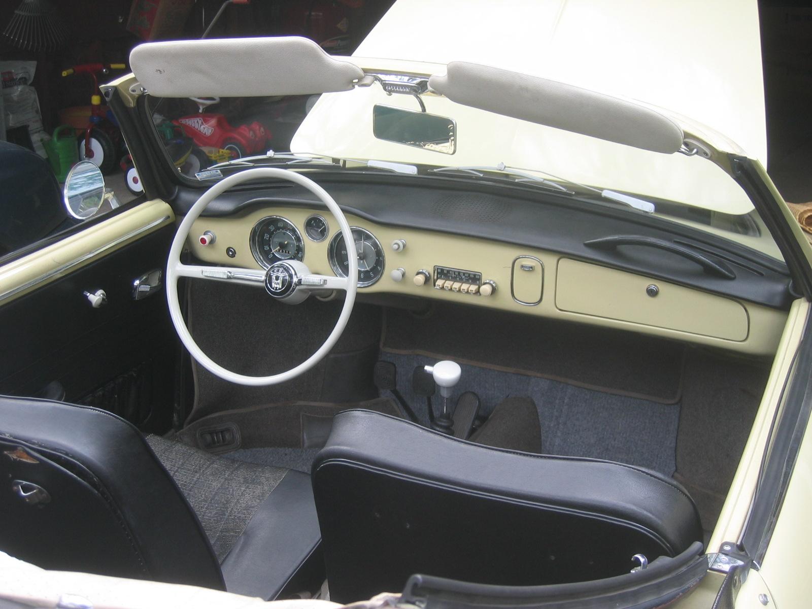

The original engine had a bad rod bearing, so I pulled and redid it completely, including powder-coated tin ware. The original generator was rewound for 12V.
The bumpers where shaved off their over riders (1965 Euro style) and rechromed.

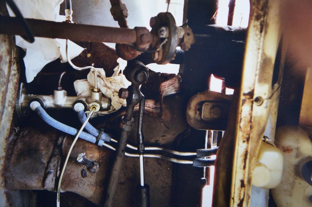

The brakes where redone and a 67 dual chamber brake reservoir plus dual circuit master cylinder where fitted. While the tank was out it was fitted with a return line and powder coated.
Koch’s did an awesome job restoring the original steering wheel.
The Shifter knob is an exact 1:1.35 scaled larger version of the original, powder coated, now able to operate a Berg looking shifter. Oh, Yes it is a B5 shifter – more to come on this...

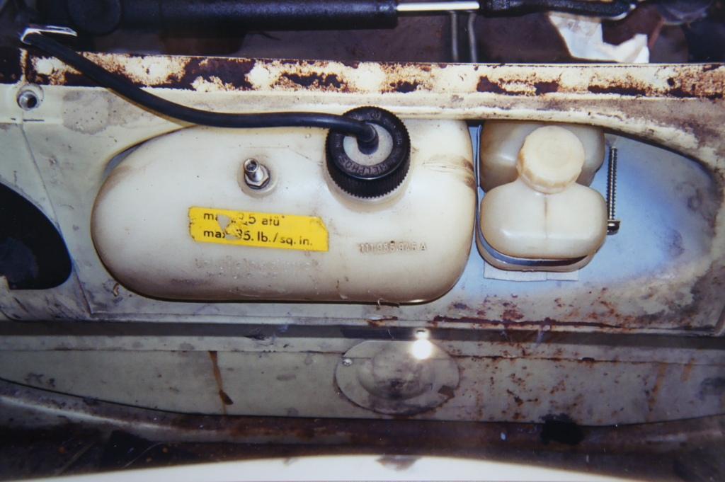

The 12V battery moved underneath the rear bench.
Not all original??? – Well, right!!! If you are worried about that, you’d better do not read on! I have owned perfect original bugs and fast ones. The latter ones are more my cup of tea.
So I started collecting and buying go-fast goodies while I was living in the US. At that time I was going to maintain the original swing axle chassis.
I drove the Ghia with its original 34 HP during the Michigan summers, until I returned back home in 2006.
Some furniture had to stay in Michigan, so the movers could fit my Ghia and lots of parts into the 40 ft container. Twisted Evil Twisted Evil Twisted Evil

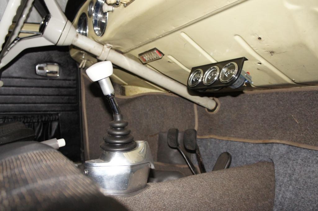

I really like to hide the performance potential. Good examples of what I mean are the shifter knob or the two main gauges: The speedo is an original 140 km/h unit that is recalibrated to show miles/hour with the km/h reading somewhat hidden in an inner ring. So it will show me speeds up to 140 m/h.
The tach face used to be an original time clock, the housing an old speedo, now fitted with an AutoMeter tach. 12 o’clock is neutral, 1 is 1000 rpm, 2 is 2000 … The minute hand is fitted with a counter weight and then repainted in matching color. The hour hand is adjustable from the outside.

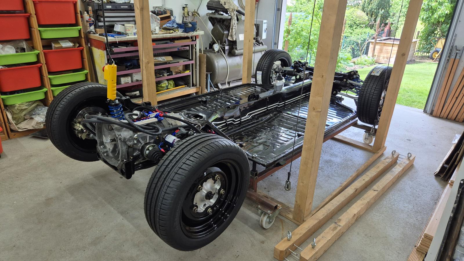

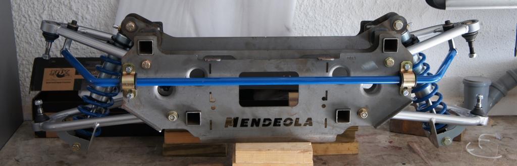

The majority of actual modifications will happen on the chassis. With a totally new bottom I can do any wild changes without touching the original chassis:
Mendeola front suspension with OEM modified spindles
Mendeola rear suspension with narrowed trailing arms
CSP disk brakes, 5/205 pattern
Berg 5 speed transmission, by Dave Folts
2,1 (82x90.5) engine with Haltech fuel injection – almost done building
Oil and fuel lines
New seat track mounts
Some reinforcement brackets

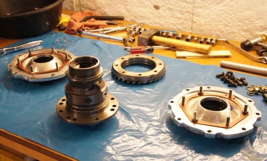

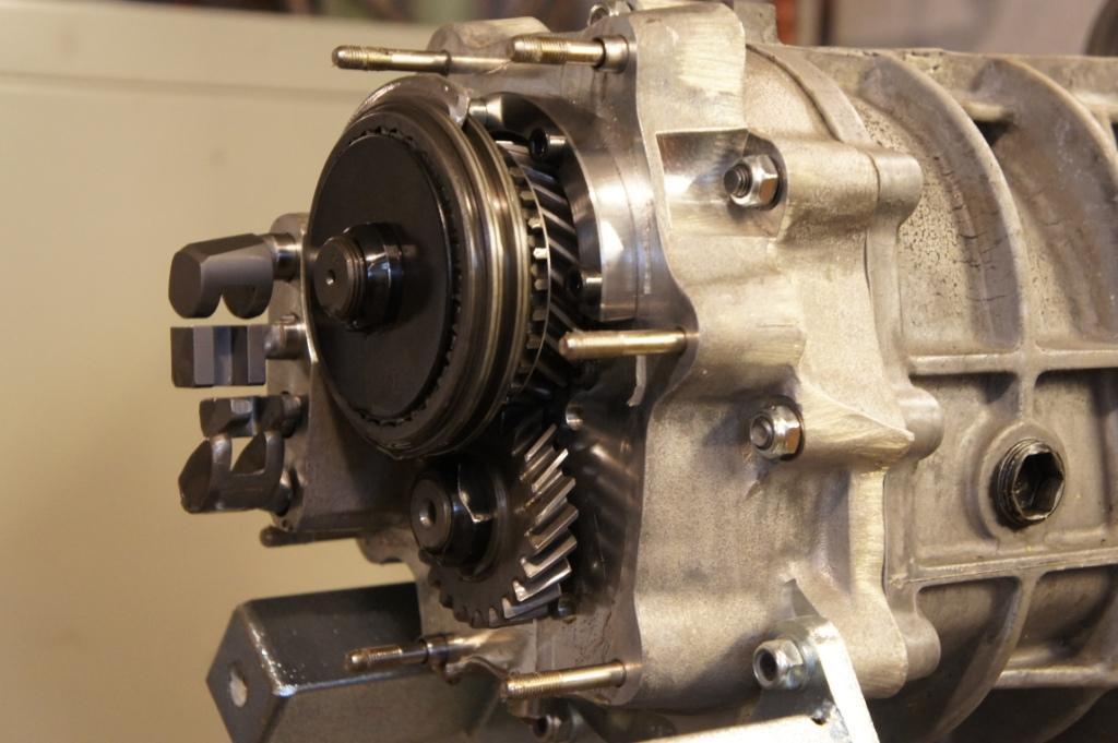

I had some time over the WE and worked on my transmission.
I had Dave Folts build me a tranny with Gene Berg 5-speed kit during my stay in Michigan. I had it build for swing axle with a .88 fifth gear set. I need to change it to IRS now (see above) and decided to do the swap myself.
So I unpacked the B5 for the second time since I own it:
I took the side plates off and the differential out:
My bug has the same final drive as this Berg5 and I prefer something longer yet meanwhile. So, I took the end cover off:
... and pulled the 5th gear set:
... and had Dave Folts sent my a new set, a .82 this time. He ground it exactly to the same hight. This made the re-installation pretty simple. Except for me "dropping the ball" big time when pushing the little detent steel ball of the fifth shift rod too far, so that it fell into the main housing Embarassed . This made me having to pull the whole stack Evil or Very Mad . Well that was another lesson learned - the tranny is closed from that end again.
Next I will have to buy a new differential. IRS super diff or a Quaife diff, I will have to do some more research...

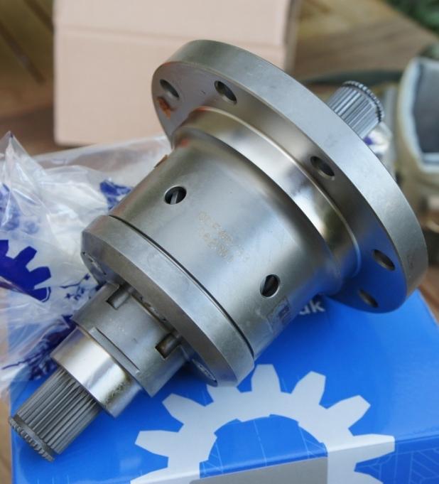

I went with a Quaife differential Twisted Evil
I have never set up a differential from scratch, so I decided to save the labor for assembling a super diff and install the already assembled Quaife myself. I got it yesterday. The set up of the drive flange to the splined shaft is different to the original, so will have to find out how to get this done right. Here's a shot:

OK - No spacer needed according to Quaife. Now I have an issue with plenty of clearance between the drive flange and the splined shaft. Will see how this goes Evil or Very Mad

Diff. went back to the dealer. Quaife in England was very uncorporative and the thing had just too much clearance between splined shaft and drive flange.
I hope Gary Peloquin will have one for sale soon.

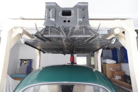

Today I built the frame for my body hoist Shocked
I will use it to store the chassis above my bug, while I am not workin on it. This way I can still park my bug in my tight garage Laughing . It will also be used to lift the Karmann body off its old pan and lower it onto the new one...

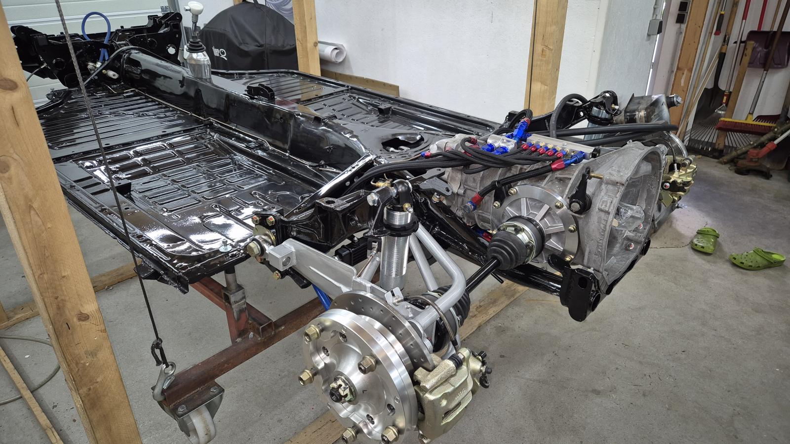

PostPosted: Mon Oct 06, 2014 9:30 am    Post subject: Reply with quote

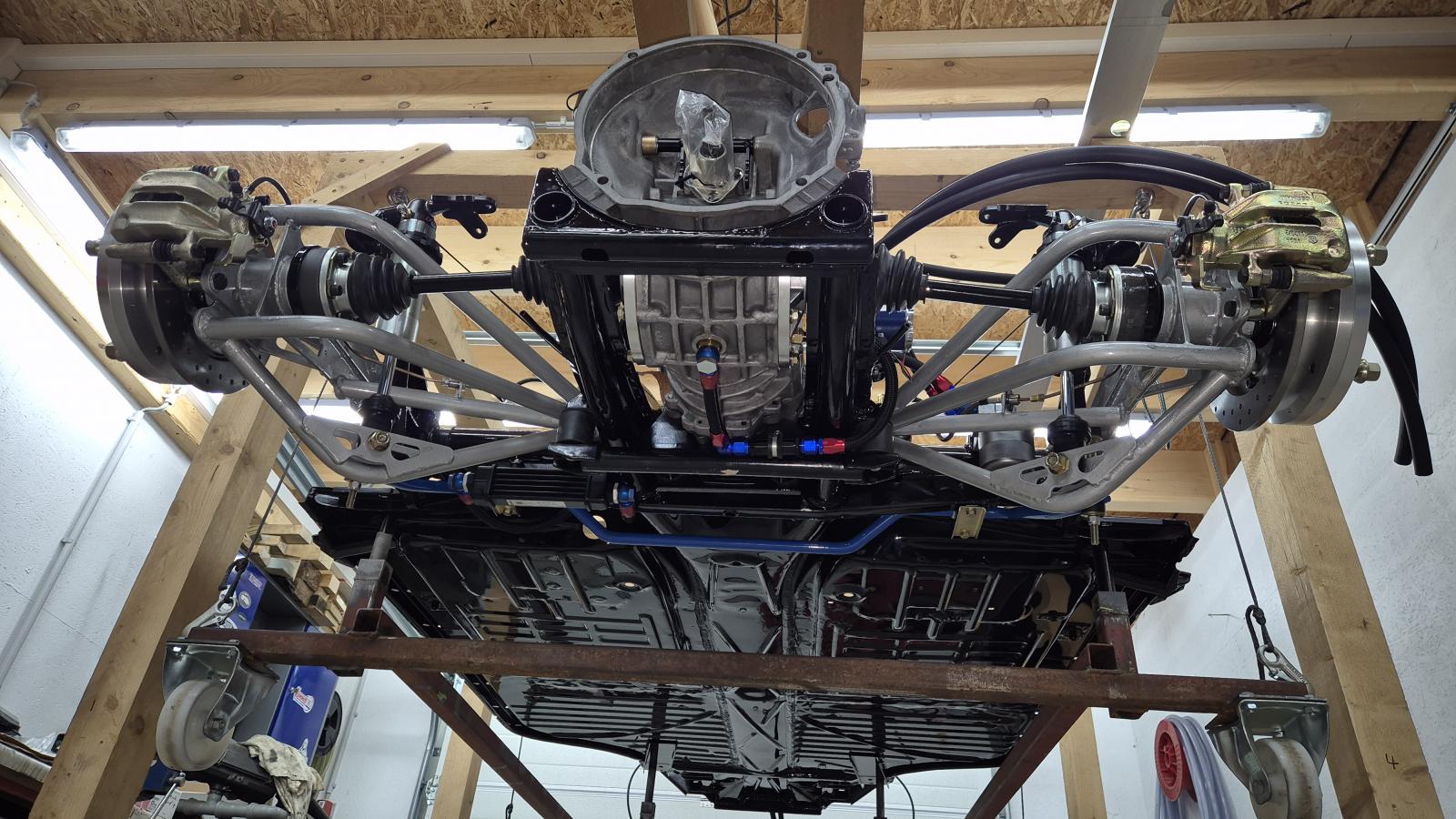

Kevin has sent most of the missing parts. At least I have the important stuff together now Cool .
Kuebel Chassis hanging off the hoist, waiting to become transfomred...

Back from winter break:
Clearing the Berg5 to the Frame is complete:
During the winter:
I received a new a differential from Gary Peloquin, what a difference in service to Quaife. And the technical things I did not like about the Quaife are all good here.

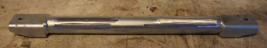

Mendeola stuff is still not complete, but I measured the welded spindles that came with the kit and developed adapters to make stock spindles work without the need of welding them. I cannot get welded spindles approved for street driving, so had to come up with a solution for stockies.
This is the CAD, parts will be made soon.

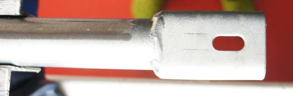

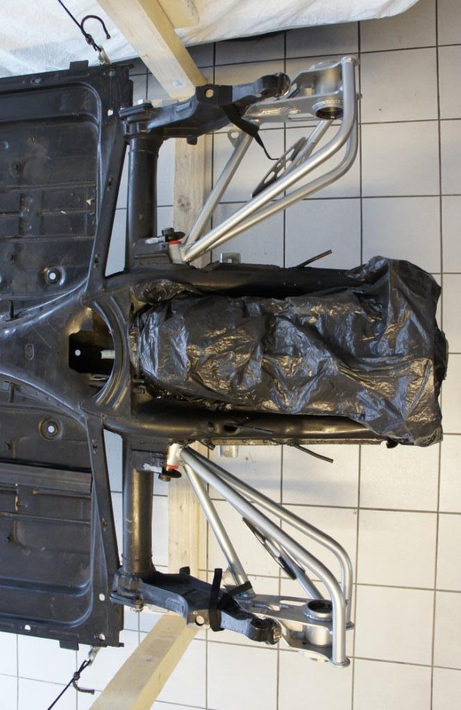

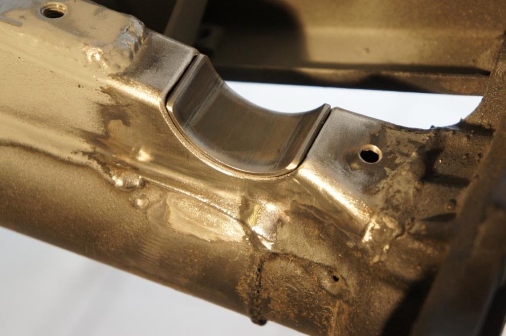

First try fit of the Mendeola rear trailing arms yesterday – looking cool on my own chassis Cool
The rubber mount for the Berg 5-Speed did interfere with the arm, so I cut the lower tube off the mount to realign to the chassis and fit further rearward.
I made slots to move the rubbers further inboard.
Everything clears now, but I will have to make my own brackets to the frame horns.
I experienced the first surprise with my Kübel chassis – even thought, I was told it should fit all right Rolling Eyes – the rear shock towers are different to bug or Ghia. Kübel tower left. Most obvious is the lower hard stop (arrow) and the different angle of the upper shock mount hole Crying or Very sad

Lots of grinding on the weekend:

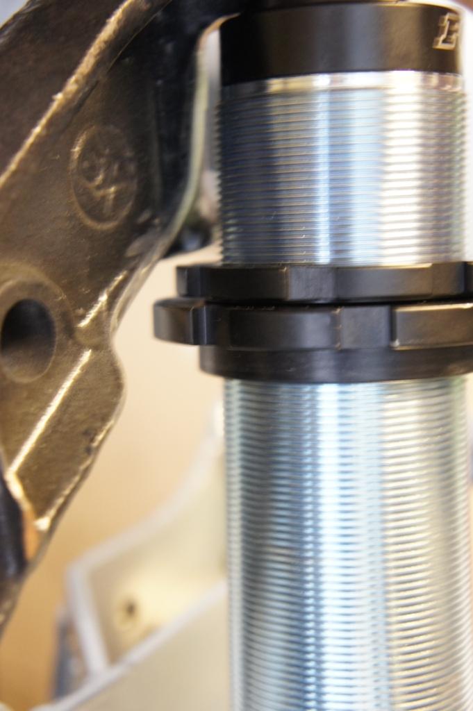

The cast-in hard stops are cut back to clear the spring plates:
Shock towers cleared for Mendeola (Fox) struts with a minimum preload of 1/2". Less preload is propably not required and not a good idea anyhow:
Voila:
Stabilizer bar attachments are next. This will be fun too, because of the Kübel (Type 181) truss bar under the torsion spring tubes Twisted Evil

Brackets to mount Berg Transmission mount:
Used a piece of square tube:
Made to fit and welded to the chassis:
These will clear the Mendeola rear trailing arms Very Happy !

Sway bar for Type 181 / Thing Chassis
I wanted to keep the stock reinforcement bar under the torsion spring tubes and maintain the right geometry as Kevin had designed it.
This solution puts the sway bar where it needs to be, without lowering it.
Just as is sits in a bug Wink
Making parts:
Space for a solid insert:
Insert generates flat with threaded hole, this will hold one side of the bracket:
Custom mount for the other side, shown with 2 brackets for sway bar:
Clearance for the sway bar:
All welded up:
Everythings clears and fits Cool Cool Cool Cool :
