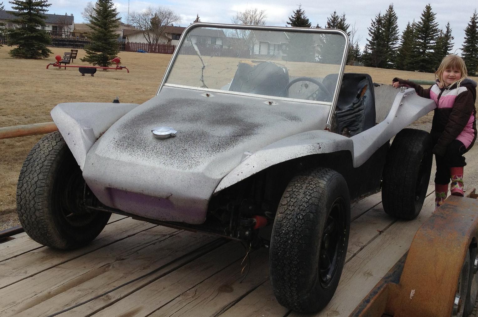

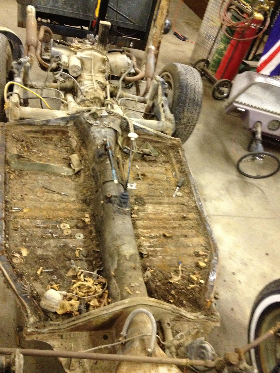

So i aquired a buggy from a friend of mine a few years ago. i was all ready to get it on the road and have my fun with it. upon tearing down the motor i found ou that it was worn out. so 2 years later i have got a couple of motors to rebuild and so now it is time to get this project going
back when i got it i started the tear down but ended at the boat anchor engine so i will post the pics that i have to date and will update when i have new ones
this is what it looked like upon getting it

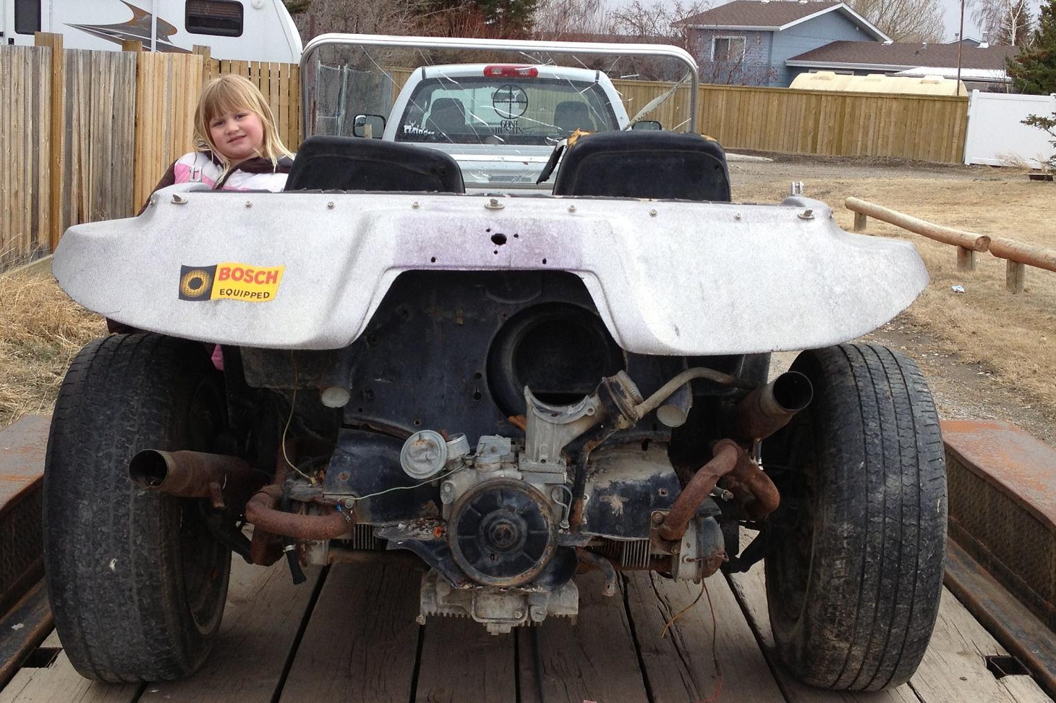

PostPosted: Mon Mar 30, 2015 10:31 pm    Post subject: Reply with quote
and a shot of the dash

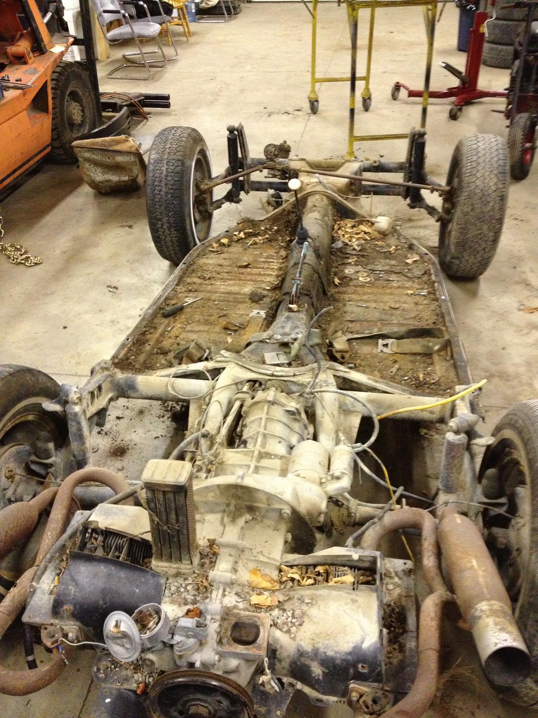

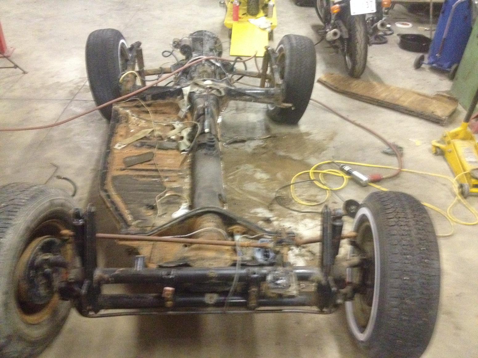

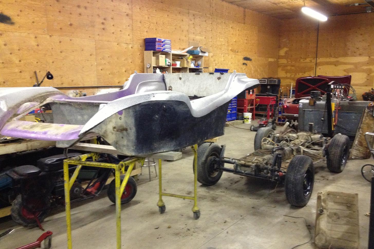

and the start of the tear down

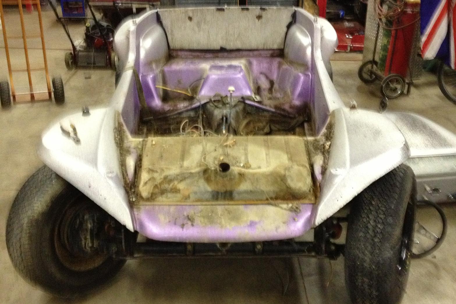

and the pan stripped of the body

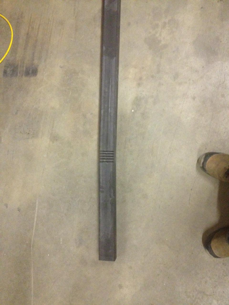

PostPosted: Mon Mar 30, 2015 10:34 pm    Post subject: Reply with quote
and the removal of the floors
which was done tonight, the rest of the pictures where from 2 years ago
i am planning on using some 1"x2" tubing to build the outer frame and then use some 1/8th or 1/16th sheet for the floor

PostPosted: Mon Mar 30, 2015 11:40 pm    Post subject: Reply with quote
Cool Buggy! Except for the dash, it is a close Manx clone.
I suggest the 1/16 inch thick floor. 1/8 is way overkill and adds a lot of un-necessary weight. I use 14 Gauge metal for floors and it is a touch overkill, but works nicely. The 1 X 2 tubing does make a nice outside rail.

PostPosted: Tue Mar 31, 2015 11:40 am    Post subject: Reply with quote
thanks for the info
but now i am wondering if i should go 1" up or 2" up
i am going to do some more research before i start making it

PostPosted: Tue Mar 31, 2015 2:04 pm    Post subject: Reply with quote
cdnltded wrote:
thanks for the info
2 X 2 boxed tubing makes a nice 1 inch lift on buggy. If you use the 0.120 wall, or 1/8 wall tubing, you do not need to sleeve the inside to keep from crushing the tubing.
A 1 inch lift is subtle and nice that it raises the windshield a touch and gets your eyes looking through the center of the windshield. And effectively sits you lower in the body.

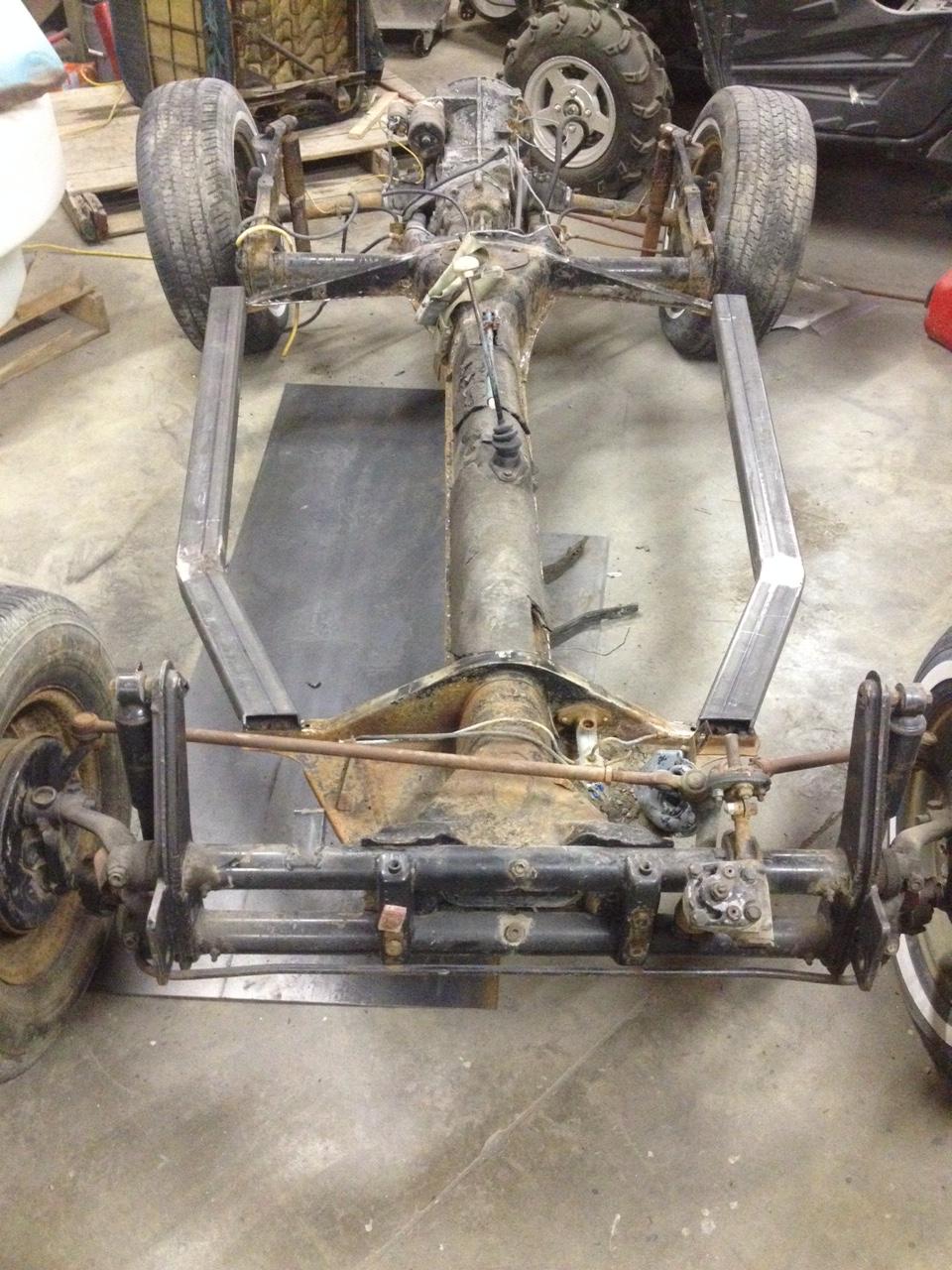

PostPosted: Sun Apr 12, 2015 9:53 pm    Post subject: Reply with quote

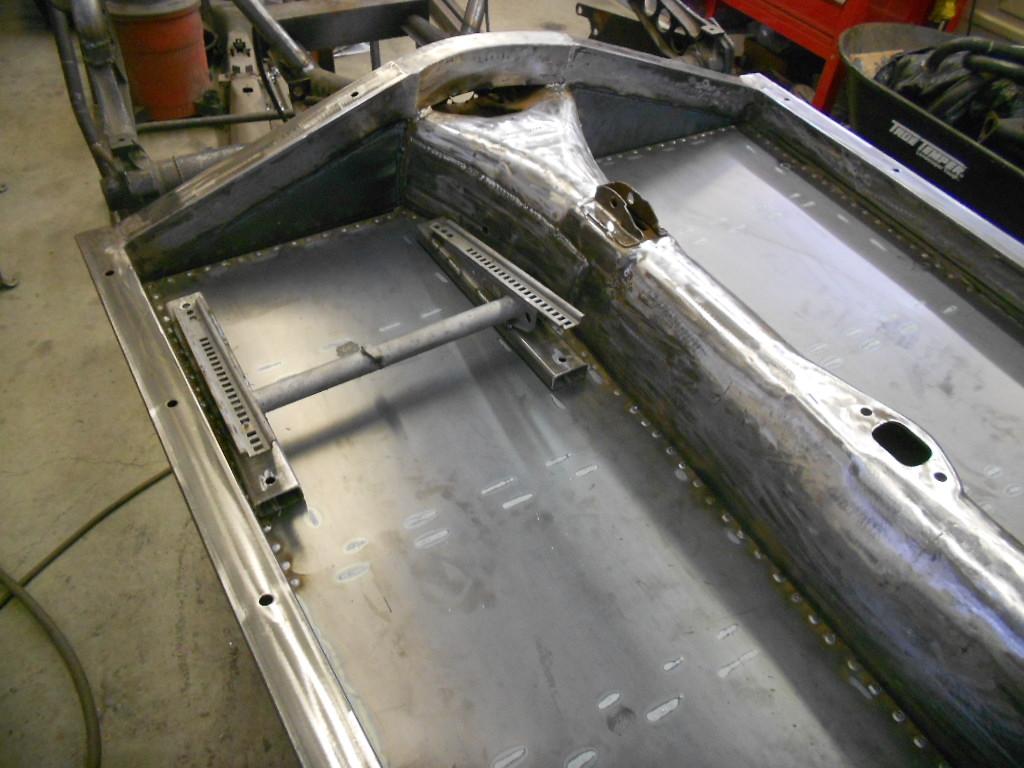

well i started my floors tonight. got both the outer rails done, now i have to grind the up and cut them to length. way easier then i thought it would be

PostPosted: Thu Apr 16, 2015 9:59 pm    Post subject: Reply with quote
anyway got some progress done tonight
got the outer frame smoothened out and tacked into place
i am really happy with the results, some fine tuning of course but a welder is only as good as his grinder
