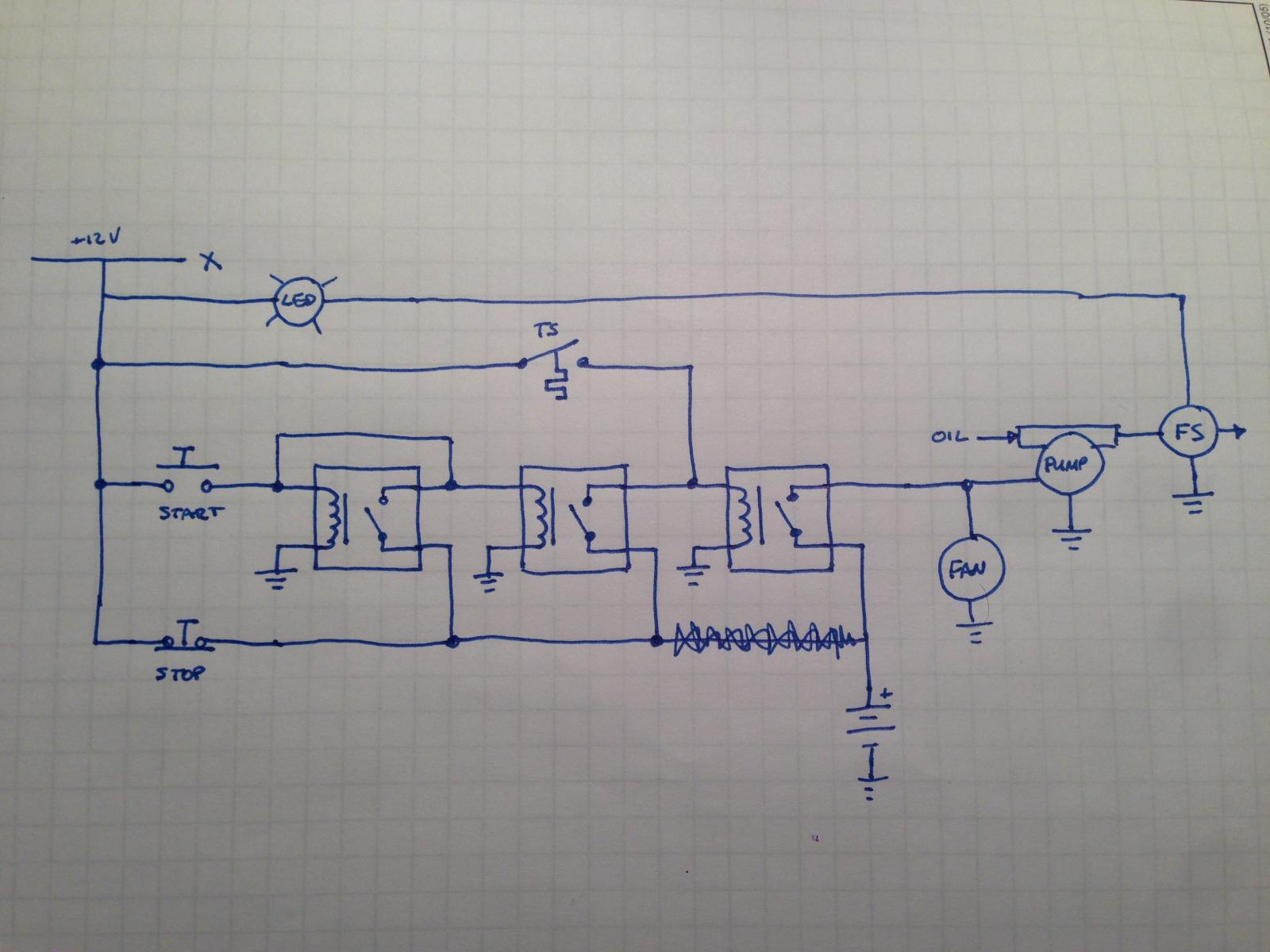

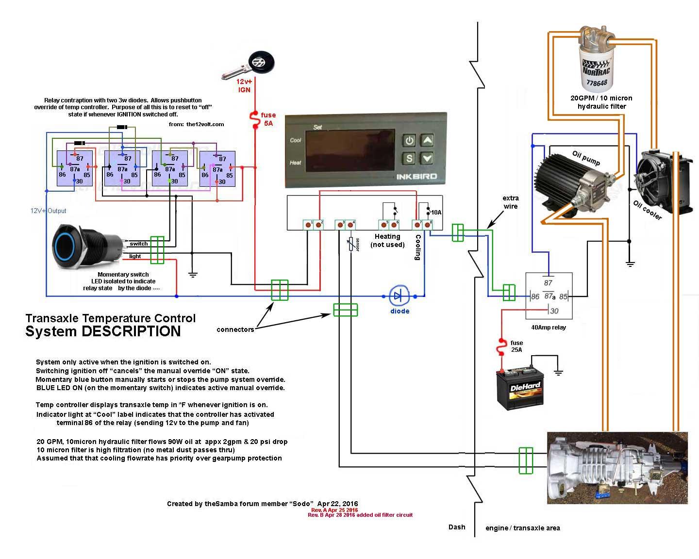

Here's my wiring diagram. I want it to run fully automatic, always. With an override switch so I can turn it on whenever I wanna screw with it. Or maybe early when approaching a long climb.
======== NOTE ====== No longer using this schematic or method. It does work, but look down the page to the new system schematic onpost 19.
Normally the indicator LED turns on when the temperature switch closes and energizes the relay, starting the pump. A manual switch bypasses the thermoswitch and connects ign. signal to terminal86 to energize the relay so the pump can be switched on manually.
Interested to hear other thoughts on how to best control this system. Certainly a simple manual switch will work for some drivers and doesn't require much discussion. Manual is a great starting point for sure. This thread could provide good insight how to add controls later without drilling the gearbox.

PostPosted: Mon Apr 04, 2016 12:45 pm    Post subject: Re: TEMPERATURE CONTROL (electric) - Manual Transaxle gearoil cooler Reply with quote
If the 25 amp fuse blows the pump can't run. The so called "pump on" led would still come on when the temp switch or manual switch was on. You could think the pump is running when it isn't and can't.

PostPosted: Mon Apr 04, 2016 12:53 pm    Post subject: Re: TEMPERATURE CONTROL (electric) - Manual Transaxle gearoil cooler Reply with quote
Yes 12v+ from Ign would light the "pump-on" LED if the 25A was blown.
The pump draws 5 - 9 amps sustained, so there's a bit of headroom in 25. Temperature guage rising beyond normal could inform you that system is not operating.

PostPosted: Mon Apr 04, 2016 1:10 pm    Post subject: Re: TEMPERATURE CONTROL (electric) - Manual Transaxle gearoil cooler Reply with quote
That's fine, but it is just a "switch on" led, not a "pump on" led then.

PostPosted: Mon Apr 04, 2016 2:38 pm    Post subject: Re: TEMPERATURE CONTROL (electric) - Manual Transaxle gearoil cooler Reply with quote
Whenever the 25A fuse is "not blown",,,,,,(99.9% of the time?),,,, the LED will indicate that "relay terminal86 is energized". IF that's what you mean by "just a switch-on" then agreed. The LED lights to inform you that the thermoswitch has closed. Iif you notice it at the moment it turns on that's the switching temp.
Assumption that LED-on = relay-on = pump-on. But it's not a big stretch to assume that the systems are functioning. But you're right it IS an assumption.
I've already wired the van with only 2 wires (as the schematic). I probably should have run extra wires just in case of good suggestions. I have some really nice 2-wire Sure-Seal connectors so "2 wires" was compelling. Cool Another wire could indicate there's system pressure.
Anyone have discussion/ideas regarding control systems for the temperature? Something better than the Weddle thermoswitch....

PostPosted: Mon Apr 04, 2016 9:06 pm    Post subject: Re: TEMPERATURE CONTROL (electric) - Manual Transaxle gearoil cooler Reply with quote
Programmable temperature controller.

Here are the control system posts (repeated) from where they're buried in the other thread (pages 5 and 6). Sorry I hope this isn't boring y'all to death but if this cooling thing proves itself someday, the control system deserves it's own searchable (and on-topic-able) subject.
crazyvwvanman wrote:
You have come this far so why not run a couple more wires that could make a difference? I would want the indicator led to be powered by the pump side of the relay so I would know that the pump was actually getting power, not just that the relay was being asked to turn on by one of the switches. Also, as already suggested I would wire the relay to self latch when triggered by either the temp switch or a momentary switch and then self reset to off when key was turned of off. Finally I would think about a second momentary switch for the ground wire of the relay, an NC switch, so the driver could turn off the relay and it would stay off unless the temp switch turned it on again or the driver turned it on with the first switch. The system would always automatically turn on when needed and reset to off with the key off but the driver could still trigger both the on and the off states. This adds 2 wires from the relay to the dash, one for the pump power led indicator and one for the relay ground at the dash through a second dash switch.
How many amps does the pump pull? (5-9Amps)
Mark
SteveMc wrote:
Can't sleep so I thought I'd doodle based on the suggestions above. I think it works but seems kind of clunky. There's likely a more streamlined way to do this. Temperature auto starts no matter what. Driver can turn on as they desire and off if the temperature is below setpoint. Ignition off unlatches the relay. Flow switch lights the light. Relays powered from 'X' branch to remove load when starting engine. And I think that's three wires between dash and tranny.
boroko wrote:
Here is an example of what I had in mind:
Either the momentary ON switch or the any activation of the TEMP switch would latch the pump, fan, and indicator on. My thinking was that if you were underway and got to the point that the temp were high enough to kick it on, you would probably want it to stay on for the duration of the trip until the van was shut off again. Doing it that way maintains the automatic function in case anyone else is driving, or you are just having such a good time that you forget to turn it on. If, say you came out of a hard climb out of the mountains and the heat dropped to the point you wanted to turn it off, once the temp switch stayed open, you could momentarily push the OFF button and it would shut down until the next time the TEMP switch closed, or you pushed the ON button. Seemed to me the least amount of fuss and parts, while still accomplishing the goal.
A couple of side notes:
The diode can be almost any part with enough voltage rating (almost all would meet the 12v in a van), and carry the current of the relay coil. A 1N4001 is good for 1A. Any 1N400x will do nicely. You can probably find one in some junk electronics laying around.
Sizing the fuse is obvious. It may be easier to fuse the fan and pump separately, but a fuse at the supply also protects the wiring and is a good idea.
If you wanted run it without the fan, a regular switch could be added downstream of the relay to open it's path while still running the pump.
The indicator: if you choose to use a discrete LED, something close to a 1k ohm resistor would be needed in series to limit the current, and the little flat side on the base of the LED is the negative side.
Hope that clears up some of the questions.
Bo

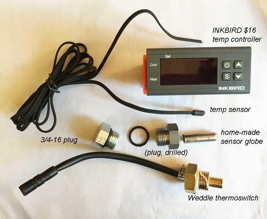

Moving on to the temperature control component.... I'm not getting a lot of satisfaction from the Weddle switch although it is the SIMPLEST. If it would simply work. Turn ON, then OFF somewhere near 150*F that would be the BEST. Also if it was 1/4NPT that would be great for you other fellers. But I already drilled and tapped that HUGE 3/4" hole in my trans. Shocked
Now trying something else, a micro-processor controlled unit. I bought the INKBIRD controller $16 on AMAZON. I do not know if they are reliable. Note that the temp controller also serves as a digital trans temp gauge.

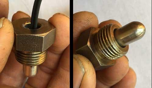

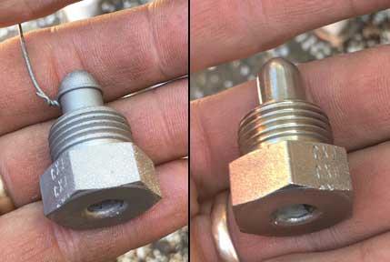

To resemble genuine non DIY temperature sensors, I decided to make a globe-end "thermowell".
3/4-16 "plug", drilled and "thermowell pipe" inserted then welded.
Need to pot the sensor into the thermowell. There are several "heat transfer compounds" available. It seems like you'd want the tem sensor to react quickly to the oil temp, so filling the 'well' with this compound, then epoxy-ing (potting) the sensor in, is next. The 'well' will be screwed UPwards into the trans, not like a 'well' .... (holding water like buckets don't). If the potting is not reliable, it's possible the 'heat treat compound' could leak out. Not sure what to do there yet. Some compounds are silicone based which might cause trouble with the 'potting'.
Fitting nickel plated, then polished.
========== EDIT rather than a new post ======
OK after a discussion with Samba member Boroko (control systems tech/design) decided to pot the sensor into the housing with JBWeld. Reason being that the system is not monitoring temperature swings in "seconds" but "minutes". Bo felt that the JBWeld would conduct the temp in less than a minute, and I can observe its behavior by testing it in a pot of boiling water or ice water. Will add a heat-shrink tubing strain relief and pot that in too.
Anyway, this is where I'm at on my project. I've been messing with the temp control unit, pretty easy to set. Waiting for JBWeld to cure so I can test the sensor. Looking forward to the day I can put oil in it (all the holes are plugged)!

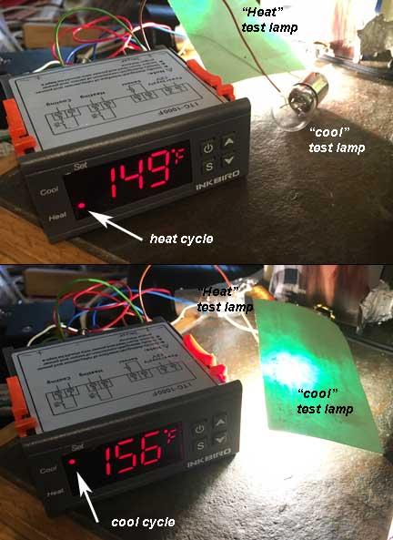

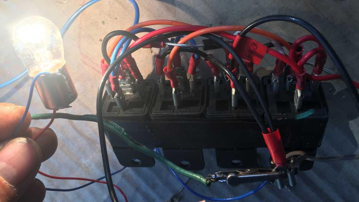

Sensor is done. I put some heatshrink on as a strain relief and then potted the strain area with black "Shoo Goo" E6000. Onward to testing, I think this is going to work out great.
Stovetop testing with a candy thermometer.
Works as expected. I can't think of any use for the "heating" cycle, but connected a test lamp to it just to watch it work. The "cooling cycle" will energize the pump relay. The relay in this INKBIRD controller is rated to 10A but I've seen my Weddle pump draw 9A sustained (but this was while 90w was cold 50*) so I'm going to use the INKBIRD to energize a 40A Bosch type relay to start the Weddle pump.
In this example, the "cool test lamp" is the Weddle pump. At 150+*F, the controller has turned on the Weddle pump. Current plan is to run the radiator fan and pump in parallel (Pump+Fan on & off concurrent).
The controller is set for 150*F but it does not turn on the pump right at 150*, it has a delay to prevent cycling around the setpoint. At 150*F the "cool" light starts blinking, while it's doing the 'compressor delay'. At about 154*F the "cool" light went solid and the "pump bulb" lit. However the pump shuts down precisely at 149*F. This is going to be kinda fun.

OK here's my updated system schematic. I have all the components, now it's down to mounting them and getting the wiring tidied up. I tried to put all important info on the schematic, but probably missed some stuff.
NOTE: This schematic REV B was revised on Apr28, 2016, adding the oil pumping circuit.
Also forgot to mention that the INKBIRD controller has an on-off button.
If "ON" it retains that state. So if IGN is cycled off then back on, the controller comes back "ON". Perfect!
In abandoning the "old" system I have an extra wire going up front, perhaps it can be an LED indicating system pressure.
Here's what the momentary latching relay system contraption looks like. I'm not sure what to do with it, wrap it in tape?
There are circuitboards out there that might do the same job, for example this one for $7. But they don't tell you if it cancels or retains the STATE when you switch off the ign key. Need it to CANCEL whenever Ignition key is switched OFF.

PostPosted: Fri Apr 22, 2016 6:46 pm    Post subject: Re: Temperature Control (electric) - Manual Transaxle gearoil cooler Reply with quote
Fully insulated connectors may have been a safer choice. Also, relay sockets and small terminal strip could clean up all those jumpers and make it easier to follow and troubleshoot.
Example: https://fbcdn-sphotos-b-a.akamaihd.net/hphotos-ak-...5215_o.jpg
