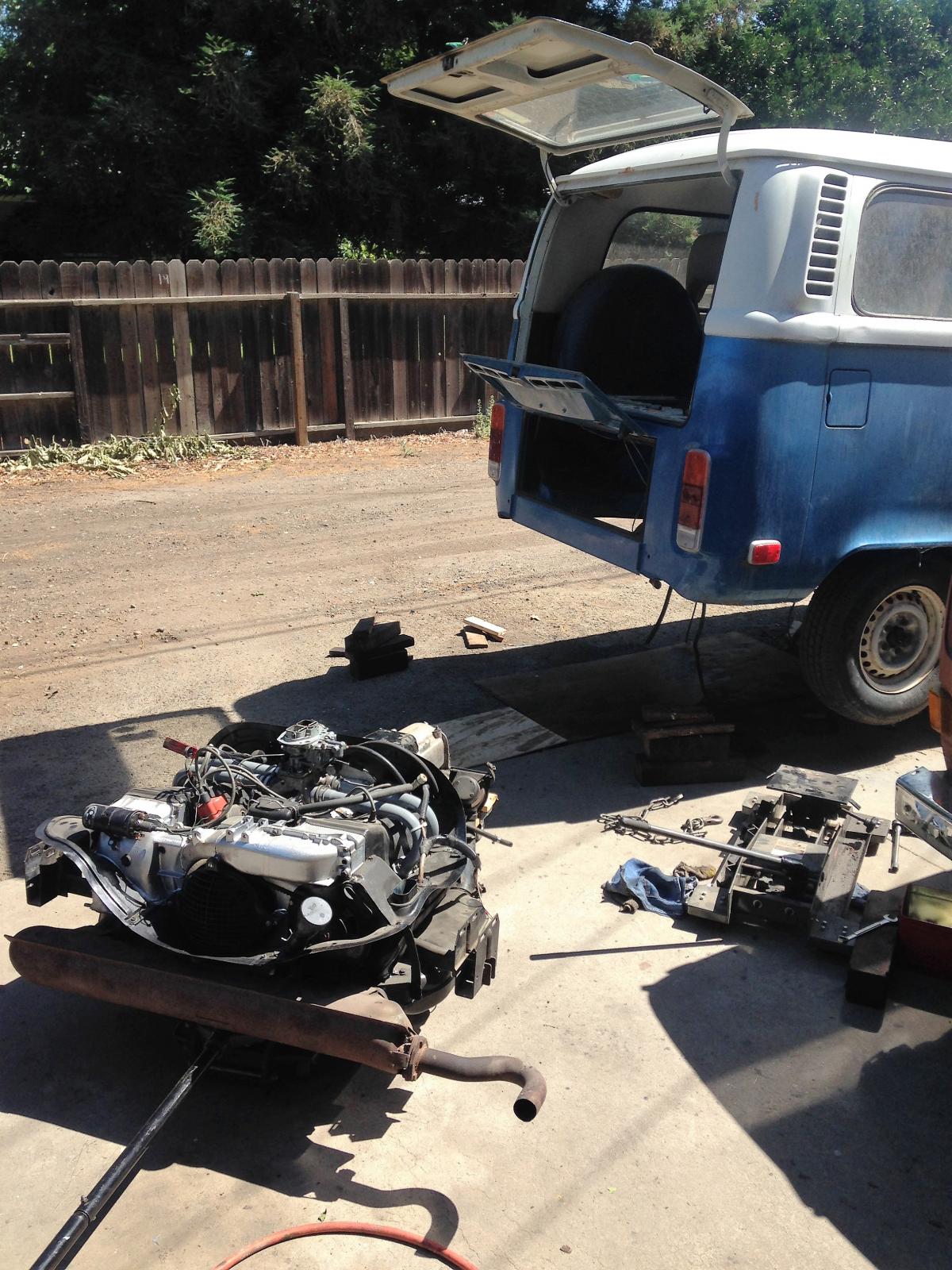

PostPosted: Tue Jun 13, 2017 4:55 pm    Post subject: Re: 003 Automatic Type 3 in Baywindow: No shift / No fluid pressure. Reply with quote
This morning, I pulled this all out again...
So I could try to find out why my refreshed engine that I married up to my rebuilt transmission still did not get me down the road...
I have discovered that I have ruined my oil pump. The Oil Pump Driveshaft was not seated properly and ruined the impeller when I put it all together. This happened because I failed to install the Torque Converter onto the Turbine and Oil Pump drive shafts once I verified they were both properly seated.
What I actually did was leave the Torque Converter installed on the Flex Plate on the engine, then carefully aligned the TC onto the aforementioned driveshafts and married up the engine and transmission. I did it that way based on my memory... which served me poorly and was grossly incorrect.
You should not do it that way. Shame on you
Always install the TC as mentioned above, marry the engine up and then rotate the mass while lining up and installing the three Flex Plate bolts that hold the TC to the Flex Plate. If you don't, there is great risk in having the Torque Converter not marry up the Oil Pump Driveshaft on both ends of the splined shaft... one end to the TC and one end to the Oil Pump.. and the damage could occur. It can seem like you have them indexed, and you probably do at the beginning of the move. But the natural movements and shaking of the two units coming together likely jarred the driveshaft out of its seat in the Oil Pump. Kiss it all good-bye once you bolt everything in place. Of course, you won't know how fucked you are until after everything is completely installed and you try to drive the bus. Boo hoo!
I did find some information in the Bentley about TC install, and also on how to remove it from the Flex Plate, but nothing so far that warns of the danger that doing it the way I did could allow the Pump Driveshaft from dropping out of its impeller in the Oil Pump without me knowing it. The damage occurs when this is all buttoned up, and the shaft now press back against the impeller with nowhere to go except shattering the impeller.
I found this thread, where this poor guy suffered what seems to be the same problem:
https://www.thesamba.com/vw/forum/viewtopic.php?p=4023187#4023187

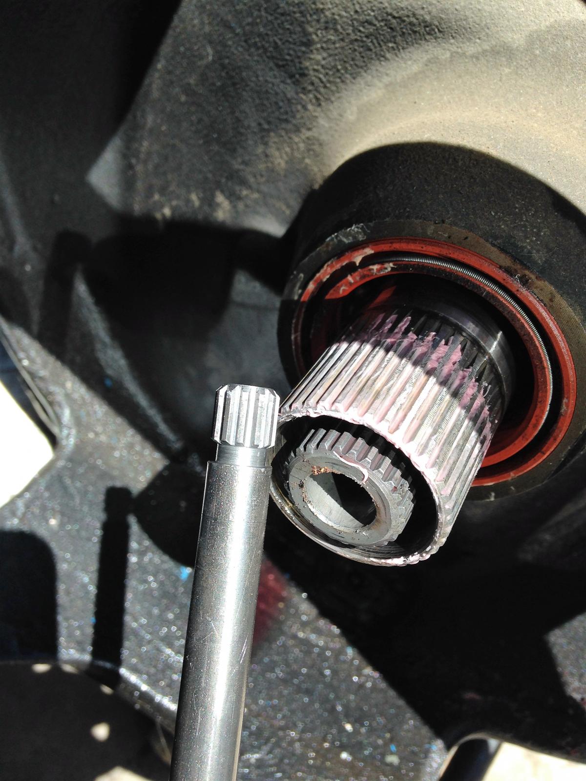

I removed the Turbine Shaft and the Oil Pump Driveshaft and took a mini maglight and looked down in there. I can see the broken impeller, and cannot ever find the seat for the driveshaft.
The Oil Pump Drive shaft splines looked great and indexed nicely into my rebuilt Torque Converter...
But it didn't matter, because the Oil Pump impeller was all broken up so there was nothing the driveshaft could turn... which is why I could not develop fluid pressure! It is not supposed to look like this: The Oil Pump Driveshaft is too far down into the Turbine shaft indicating serious damage to the oil pump.

PostPosted: Tue Jun 13, 2017 11:18 pm    Post subject: Re: 003 Automatic Type 3 in Baywindow: No shift / No fluid pressure. Reply with quote
Thanks, Xevin... will be looking.
Also, I will be digging around for information, but does anyone know off the top of their head if the oil pumps were interchangeable through the 010 series (later models, up into the water-cooled Vanagon era) transmissions?
Wonder if I can replace the damaged impeller off this 003 with one off an 010?

PostPosted: Wed Jun 14, 2017 3:04 am    Post subject: Re: 003 Automatic Type 3 in Baywindow: No shift / No fluid pressure. Reply with quote
This mistake will never be made again on the Samba.
Thanks for the write up and share. Painful, but this is how we all get smarter.

PostPosted: Wed Jun 14, 2017 7:03 am    Post subject: Re: 003 Automatic Type 3 in Baywindow: No shift / No fluid pressure. Reply with quote
Ha! Wish that were true, but I bet within three years we will be reading a fresh and nearly identical thread. I'm also willing to bet that now that I know what happened, I could probably find several other threads along the same vein.
