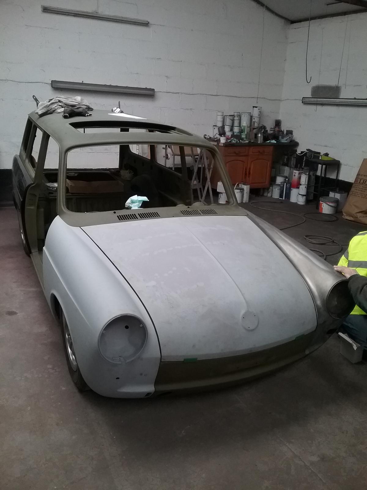

Gaz Wooton welded up the trim holes for the hood, doors, and wings.

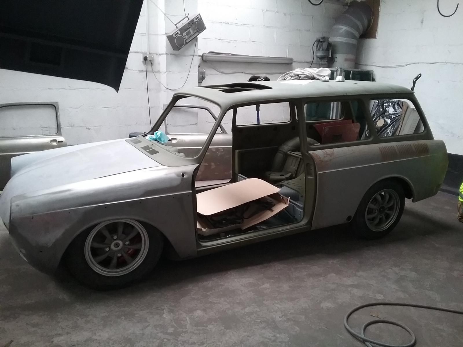

The car uses original empi 8 spoke split rims.
The calipers are Porsche Brembo with the much larger discs, and dropped spindles, together with a pair of air shocks for the front only.
The design was to keep the car simple in style, no complex air ride.
To fit the calipers a narrowed beam was needed, then billet hubs made. The narrowed beam simply compensates for the offset and the wheels run only 1/2 " narrower when it is all bolted up.
A T3 original beam runs very low so just using one with dropped spindles means your beam can bottom out on speed bumps or poor roads.
MARTIN WADE
Joined: August 08, 2011
Posts: 92
Location: STAFFORDSHIRE, ENGLAND
MARTIN WADE is offline
PostPosted: Fri Feb 08, 2019 4:05 pm    Post subject: Re: Uno Momento (Vintage Squareback show car) Reply with quote
The picture shows the Empi 8 spokes and the porsche calipers. The wheel nuts were CNC machined with the correct shoulder for the wheels then chrome plated at Derby plating in the U.K.

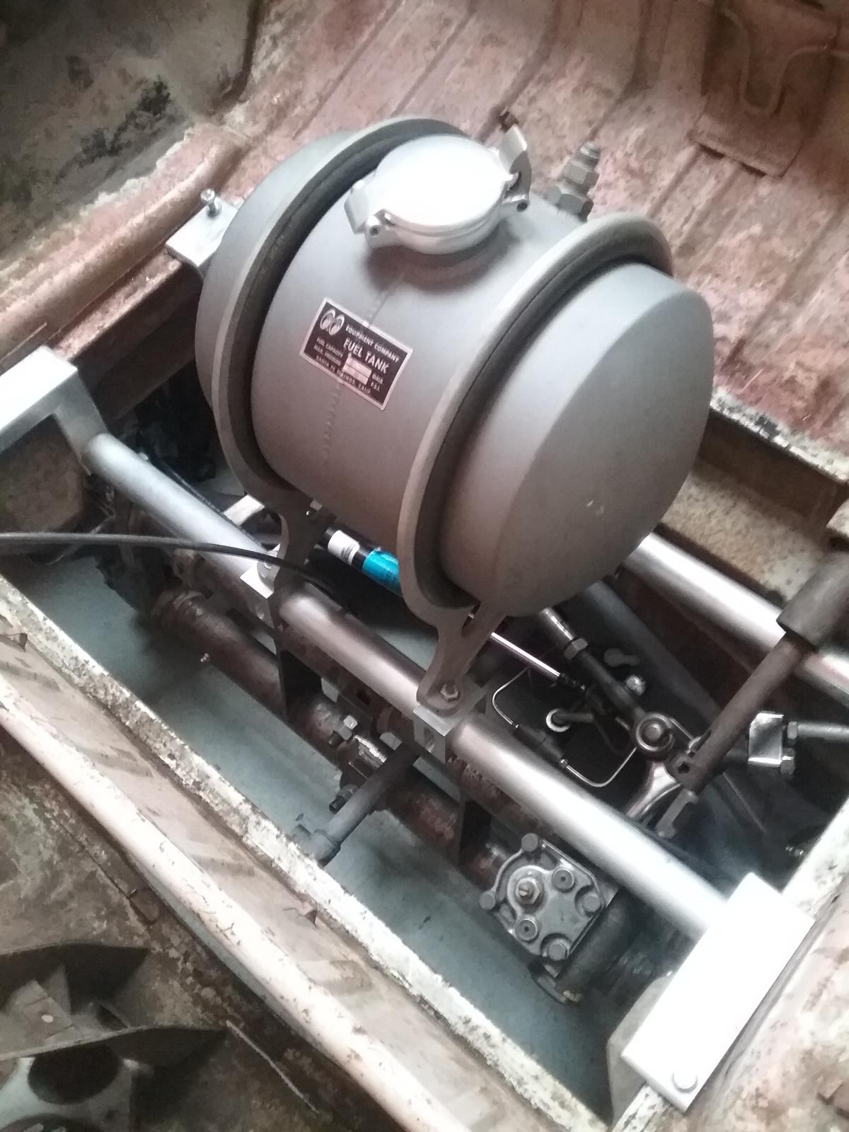

The fuel tank is replaced with a n.o.s moon tank from around '65. The tank was for a dragster and is large capacity. It also allows the detailed front beam to be seen from above.
We have built an aluminium support which bolts to the inner wings.
