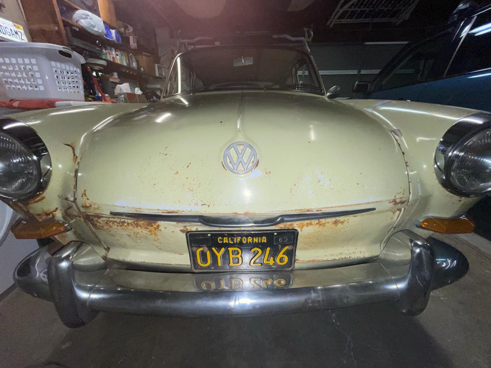

Well, I've been putting it off for a while now, but finally decided to start a build thread for my car. After having this car for 2 years now, I've finally gotten the ball rolling well enough to have a good running project. This is my slow, college student preservation to get this car as factory spec as possible while preserving the character and age it has acquired. Hoping to get advice and knowledge along the way. Motor pics are before and after.
Side note, the white wheels are hideous and are being painted black soon before getting trim rings.

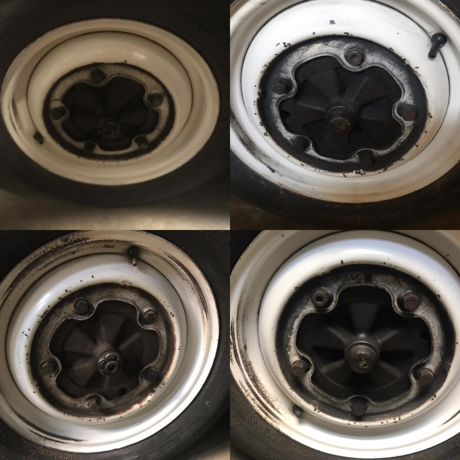

Didn’t do a lot but got some wheels painted and painted the generator strap, it was dirty and didn’t look right so I painted it and it looks better in the engine compartment, not a lot of progress but progress is progress, below is a before and after of the wheels, I sanded down areas where there were rough spots on the rim, I decided to spray paint them black since the car isn’t going to be a show car and trim rings will eventually cover them up, but I’m actually happy with the result

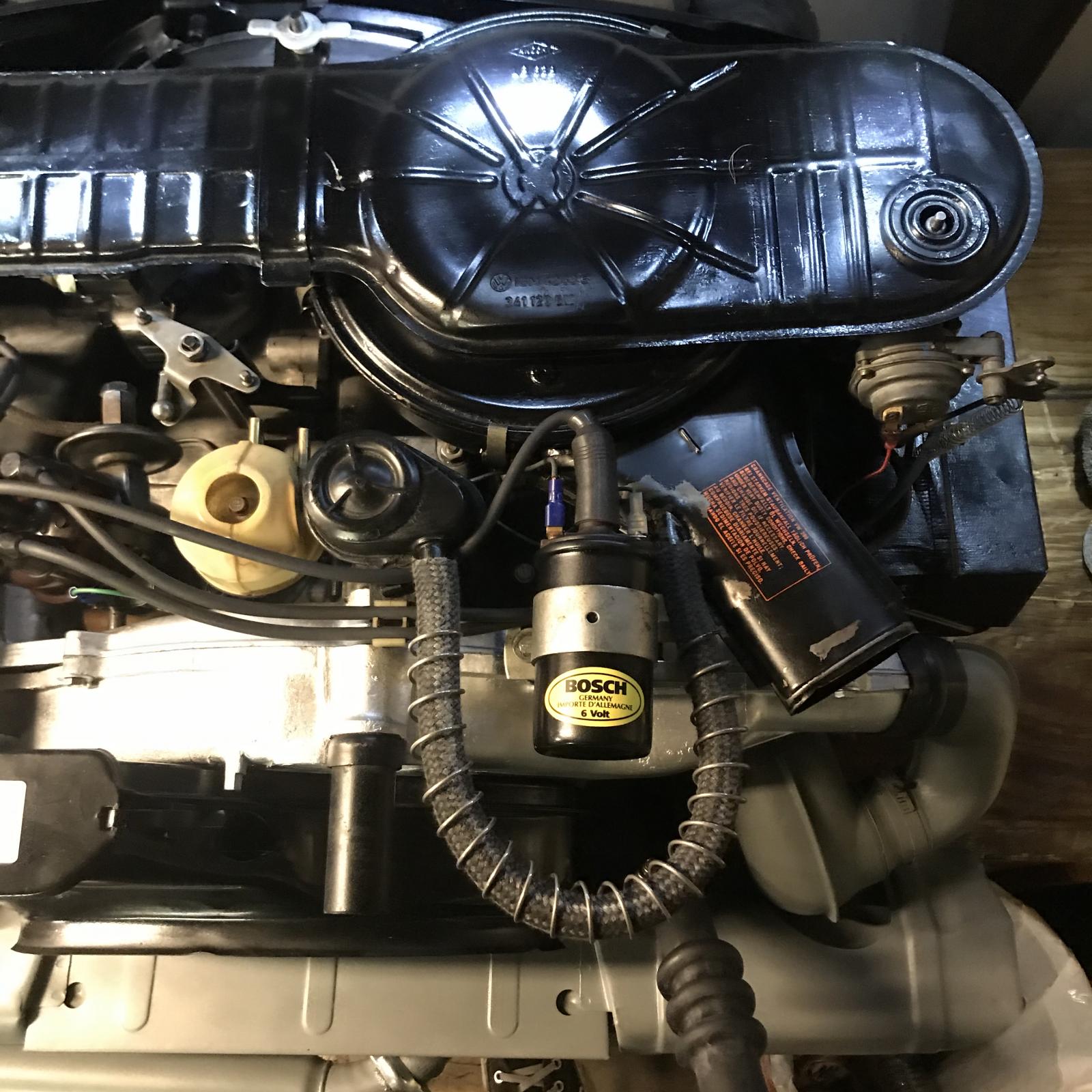

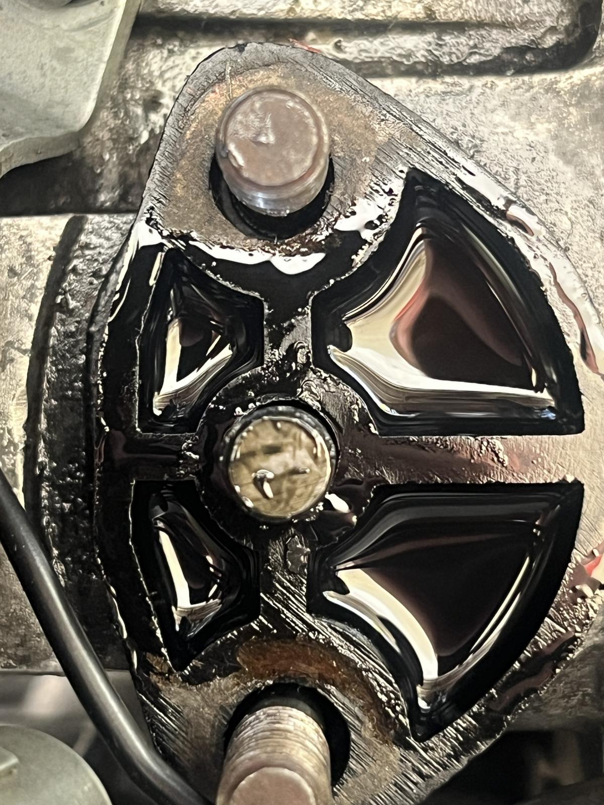

Been a while, decided I would post an update. A few months ago I was driving back from San Marcos and my car had a really bad ping and I couldn’t get it past 60, I decided to rebuild the motor since it was old and probably needed it anyway, I took it down to Ron smith who built the long block, as he tore it down the rest of the way he found this
#1 cylinder ring busted into pieces Shocked no wonder I lost a lot of power and burned a lot of oil, while Ron was building the long block, I got some parts sand blasted and painted some parts and
Got the block back it was looking good

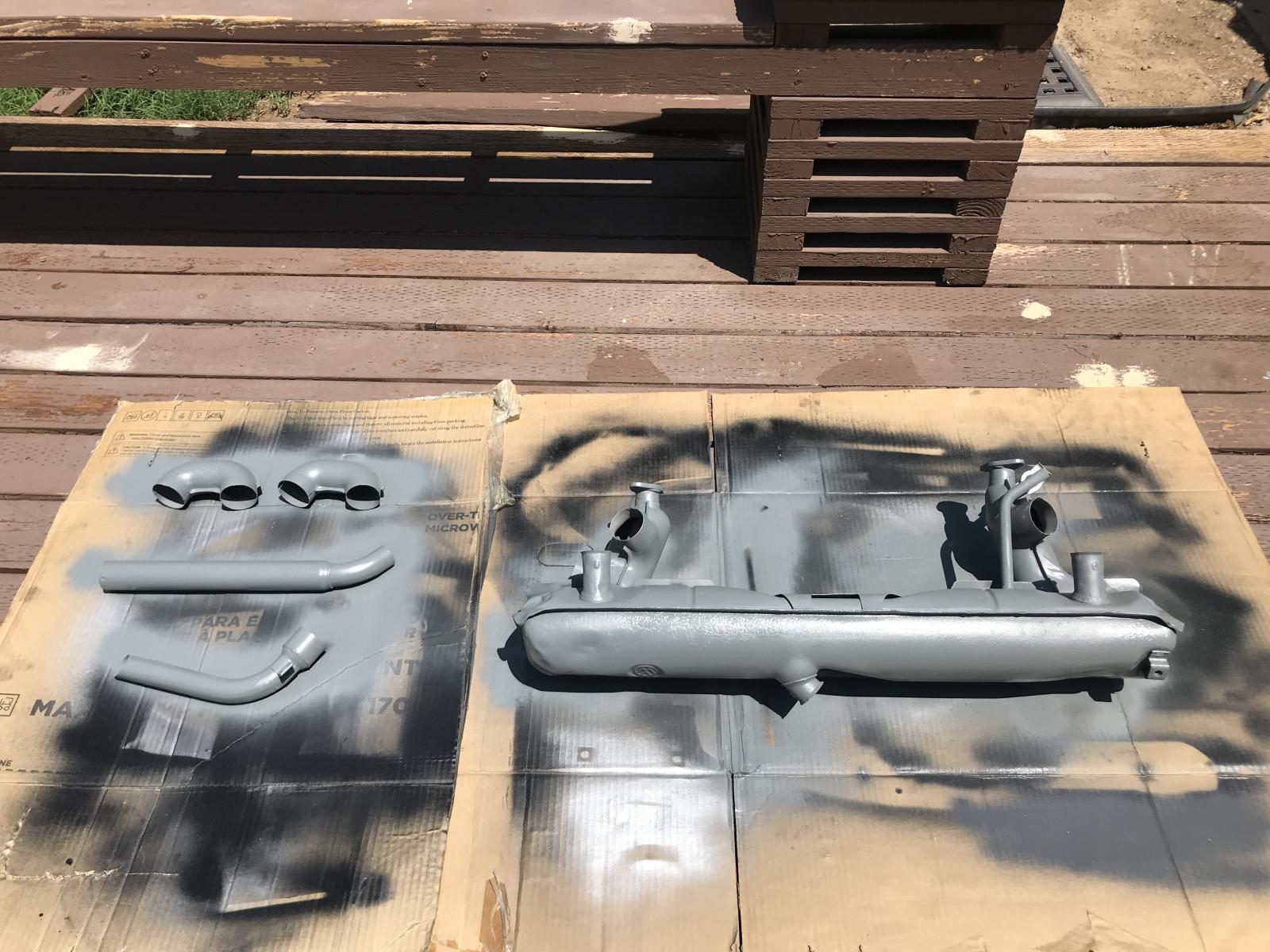

Finally got to the fun part, assembly! Only ran into 1 issue, couldn’t get the heater boxes and the muffler to line up at all, tried everything. Walked away and went for a skate, came back and tried it again and finally got it to work for me
I couldn’t sleep knowing I was so close to having it all assembled so I was up til 2 a.m. finishing up assembly and I have to say I’m happy with with the finished product, in the pictures the fuel line and heating elbow clamps are missing but have been fitted since

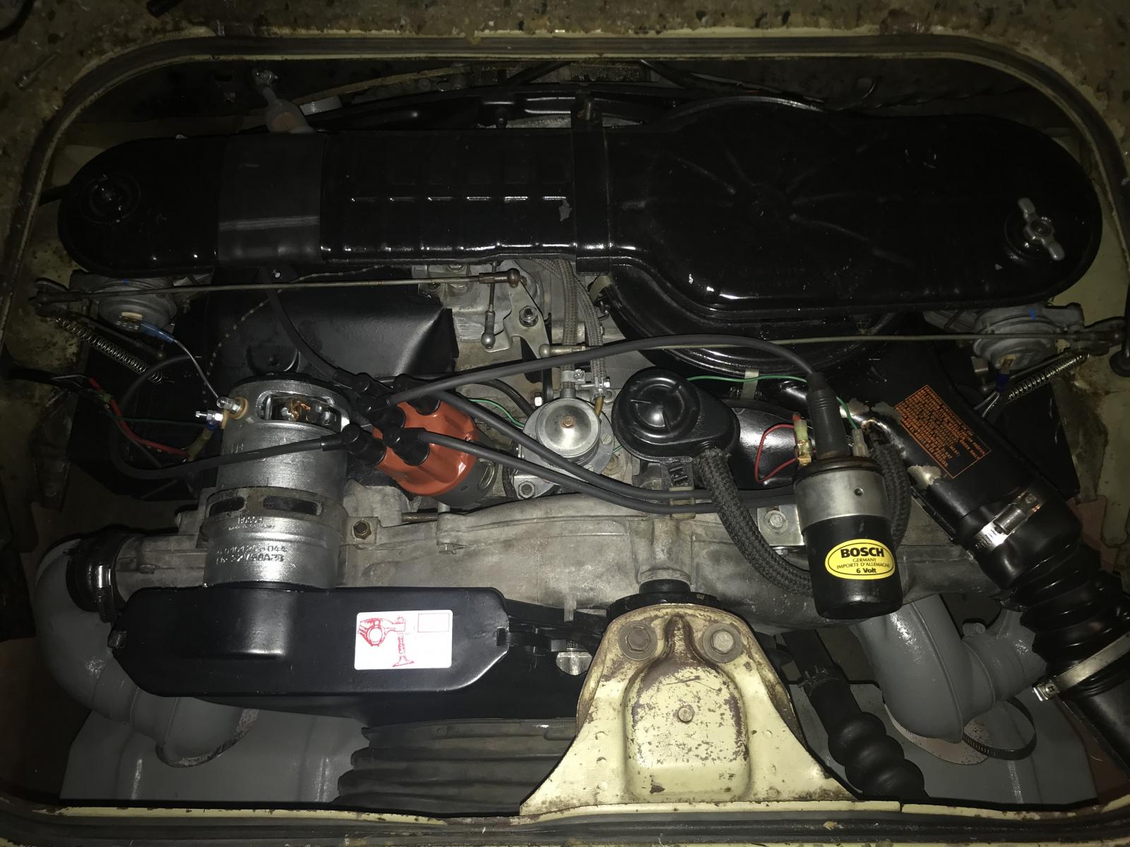

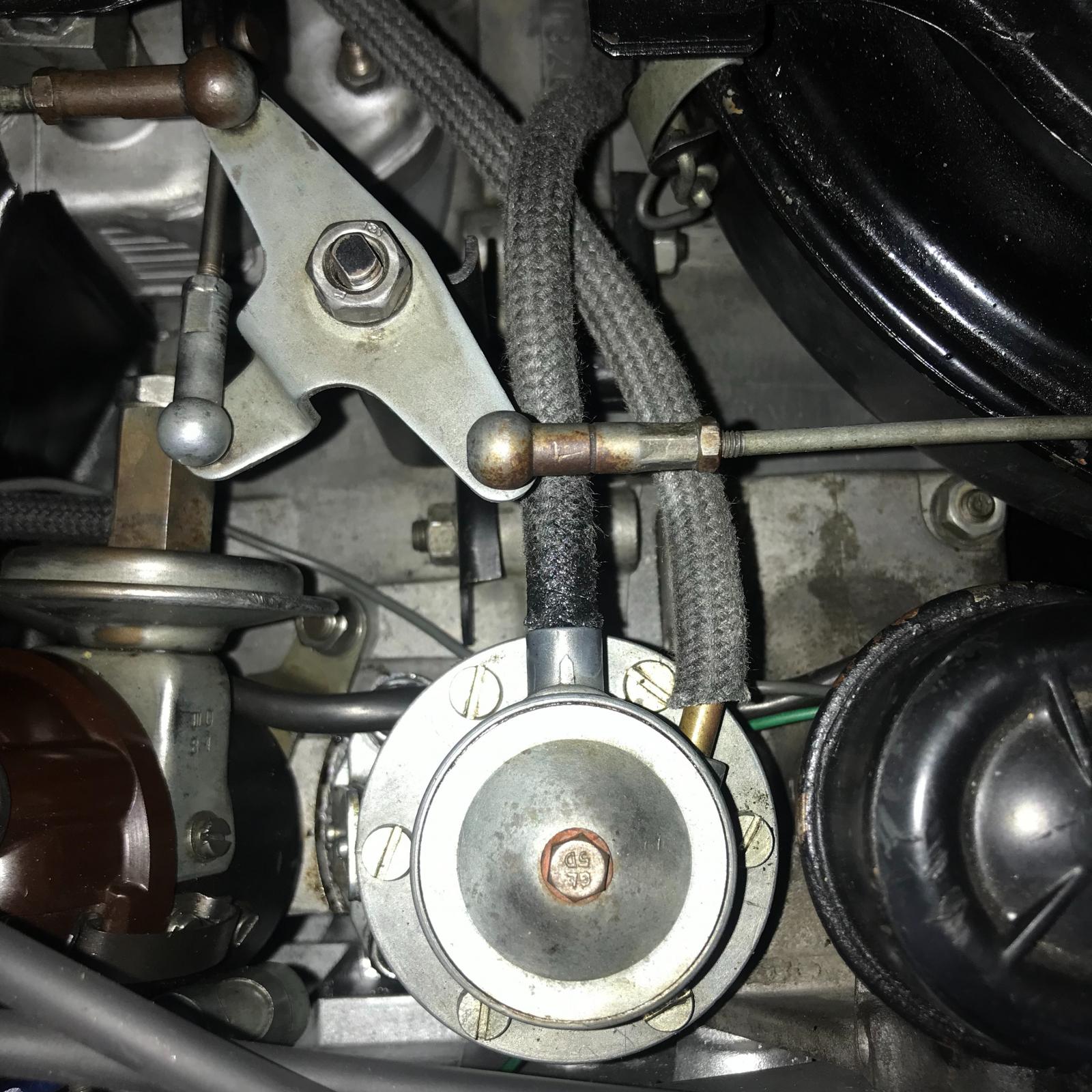

Been a while since I posted anything. I've had quite the adventure with this thing.. Laughing I'll start with where we left off. Finished the motor assembly and got it back in the car. Well, I was hooking up the accelerator cable and the little linkage piece for the early dual carb cars where the cable attaches it has this piece where the cable actually slides in.
That piece is loose and it slipped through my fingers and down through the tiny little gap from the left side tin on top of the cylinders. SO.. took the whole left top half apart for that stupid little piece but you know.. Gotta have it to be "period correct" and to use the linkage I have. After about an hour of that and getting it out, I had it all back together, and it was time to finally try to start the car

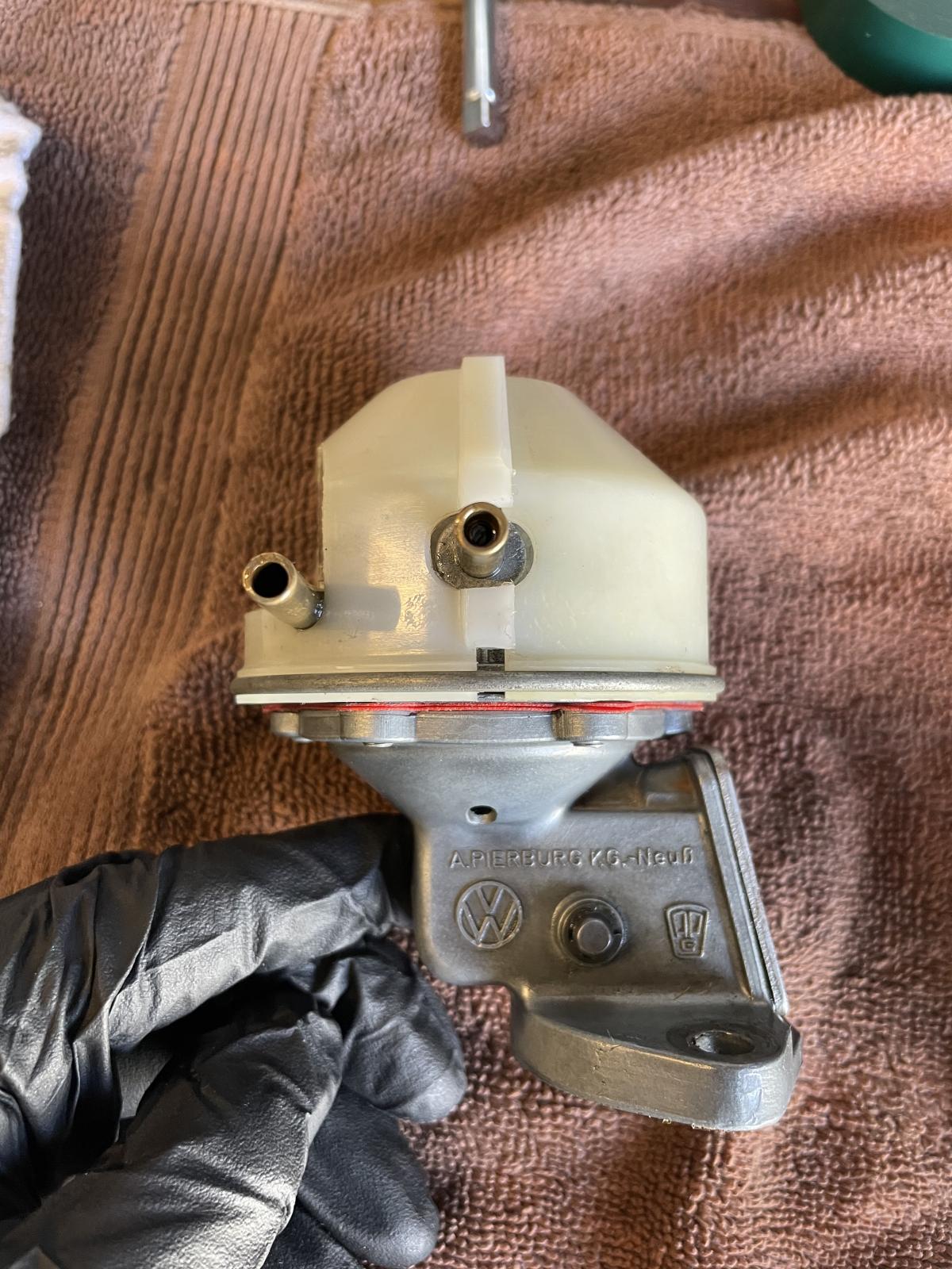

Now as if I wasn't frustrated already.. I turn it over and it wouldn't run at all. turn over but not fire up. checked my points and my points looked fine and then I looked at my rotor and that was fine. Cap was in good shape. brand new spark plugs and brand new plug wires as well. changed the condenser out for giggles and it fired up but ran like crap... And I mean it sounded horrible.. Found some exhaust leaks, fixed them and even ended up installing a 64 only early muffler since it has no preheat pipe but still hsa the early heat exchangers on it, gave the carbs a good cleaning and it still wasn't right. I also had noticed that my fuel pump was leaking at the nozzle.

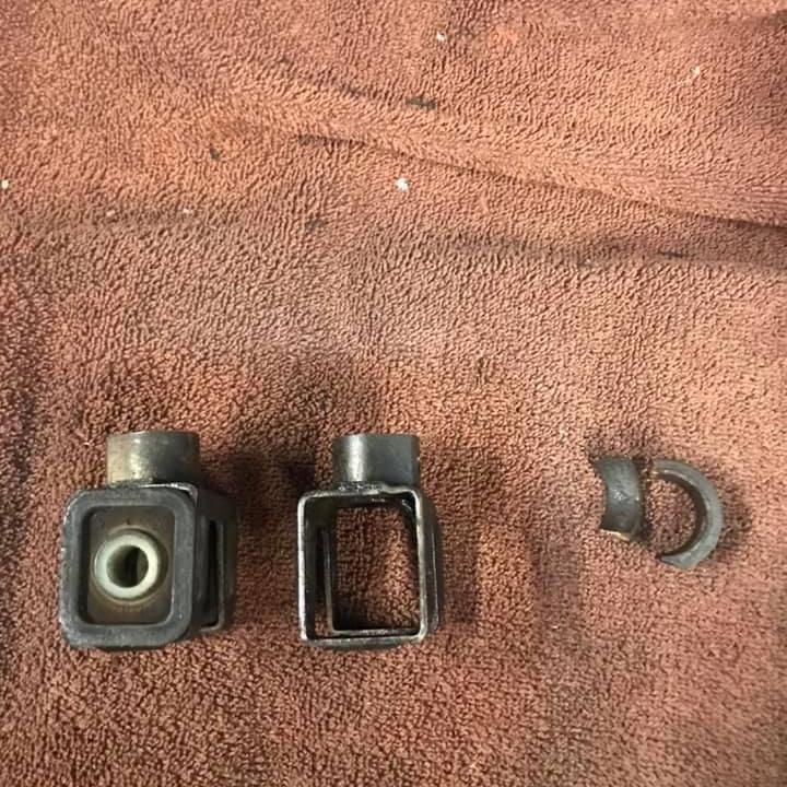

I messaged Pedro about that one since I got the pump from him and we tried a few tests and tricks but it kept seeping. Ended up replacing it with another early pump and no seepage. My carbs continued to be an issue.. Brand new rebuilt motor and I couldn't get it to run smooth. I have a recently rebuilt and barely even used Bosch 4R3 dizzy in there as well and my timing was spot on. I was scratching my head so I reached out to the big guns. Don, our mechanic at ISP, and asked him if he'd be so kind as to help me out. Sure enough, for a young kid like me, he was more than happy to. We took the carbs off and also looked at the plugs and the left side was really lean and the right side was really rich (almost fouled). we looked at the jetting as well and the jetting was 45 idles and 115 mains when the stock size for dual 32 pdsit's was 135. we bumped the main jets to 145's in hope to richen it up and we could lean it out if needs be. Upon even further inspection, Don noticed that I had 2 different sized floats... Confused I don't have a picture at the moment but I'll see if I can grab one at a later date. One float was larger than the other which would not allow the bowl to fill up as much, so we quickly swapped it out for a matching set and we thought it was good. Went back threw them on and we were able to get the car to sound really good, I mean holy crap I was excited just to hear it idle nice and smooth and quiet too! Took it for a test drive and still no dice.. The car felt gutless.. no power. No power at all. I was feeling like I'd never get this thing right.. Brick wall But low and behold I wasn't gonna give up. We thought it was just the carbs I had. Maybe they were just bad. I reached out to some people and Ron (my long block builder) was nice enough to throw me a set to try and I swapped guts out and synced them up and tried it and it felt a lot better. but still wasn't 100%. As I was out for the test drive my shifter decided to crap out as well so I was left with another issue. I got a good OE shift rod coupler and new bushing to put in and when I finally tackled that I was amazed. Utterly amazed. I don't know how I was able to fun anything let alone shift.. This is what I was left with when I pulled the old coupler and what was left of the bushing out.. Shocked Shocked
ABSOLUTE DUST. The bushings inside the side of the coupler had even fallen apart.. well I put the new ones in and it was solid. shifting was no problem and nice and tight. Back to the carbs.. I decided to send them off to Tim at Volkzbitz and man.. let me tell you. That guy is an ARTIST!!! Laughing

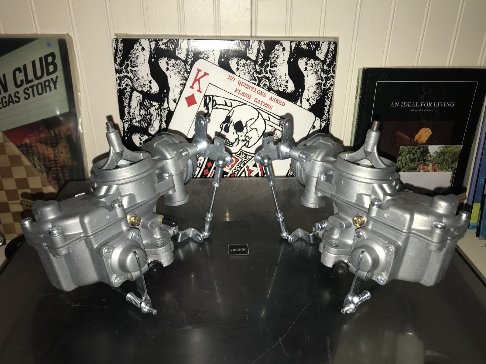

These things Look amazing! Brand new! Cad dipped bodies, Zinc plated linkage bits and all new innerds with stock jetting back. I ended up changing out the tiny linkage pieces on the side of the carbs. I wasn't thinking that they would be zinc plated but I have the 64 only linkage pieces I put on so it has the period correctness for a 64 model. I threw them on the car right when the mailman dropped the package off, I was so excited, and wow what a difference it made. 1st and 2nd felt great! Good response off the start but I noticed at the top of third and 4th it still didn't feel right.. The next day after pondering more I decided that I would just try to throw a spare rebuilt 4R3 in just to try. Why not, right? What could it hurt? Slapped that baby in and timed it up and BOOM! The car felt great! It's funny though.. I took it for a test drive and it's a good thing I brought my big bag O' tools with me. I'm driving along with a big smile on my face and I get in an intersection and my gas pedal goes straight to the floor.. I coasted through the light and thank goodness there wasn't any cars.. and I went to the back and looked and the stupid head of the early linkage piece that connects on the linkage tree had unscrewed itself.. Well, I sat there on the side of the road adjusting linkage pieces for a few minutes and then finally got it dialed and turned the car on and started down the road again. I'm motoring about 45 miles an hour down the road and the car instantly shuts off. no idle not sputter not anything it just full on dies.... Shocked Embarassed
Pull over again and I look and I looked and my ignition wire on the positive side of the coil slipped off.. Had a pair of tiny needle nose with my and crimped the spade a little better so it was more snug and back down the road we went. I remembered that when I pulled the old distributor out from the storage drawer I was keeping it in that it had fallen over sometime while being stored and oil was all over it and my assumption is that oil got inside the vacuum canister and made it bad. Therefor since the Bosch 4R3 is a mechanical and vacuum advance it must not have been pulling good enough vacuum at higher rpm's. And We did check to see if it was working prior to me installing the original one and the wights in the bottom were moving but nevertheless its good to go now. The car has been running great ever since. I've been driving it to work and cruising 70-75 mph on the freeway and its purring, not eating any oil, and driving nice and smooth Cool Here is how the engine looks in it's current state
Really happy with the car and its performance lately. Since I havent been worried about the mechanical side of things I decided to get cracking on the interior part of things. The PO had the "brilliant" and when I say "Brilliant" I mean absolutely horrible idea to cover the complete inside of the car with this multicolored puke looking foam for "sound deadening".. well it's a messy job but it has to come out. After getting heckled for some time I decided to finally start the process. I mean he has it inside the doors. on the sides of the rear seat, the rear parcel shelf area, all the pillars, the ceiling, and the rear trunk.. The stuff is gross and it just falls apart in your hand.. Mad now I'm left with this in the back seat and the rear trunk

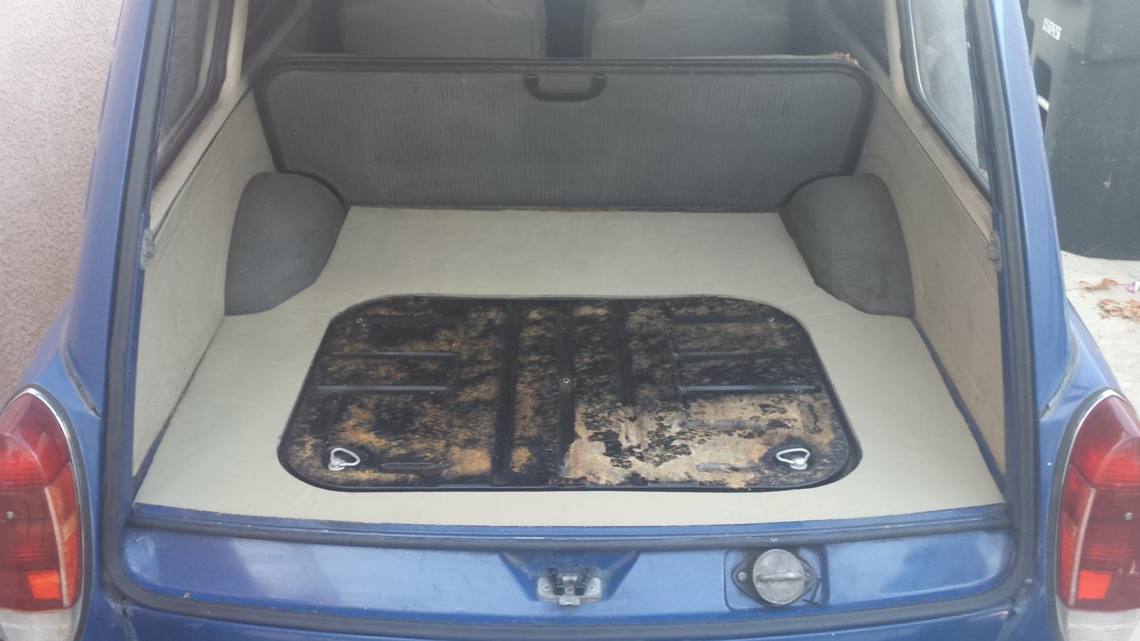

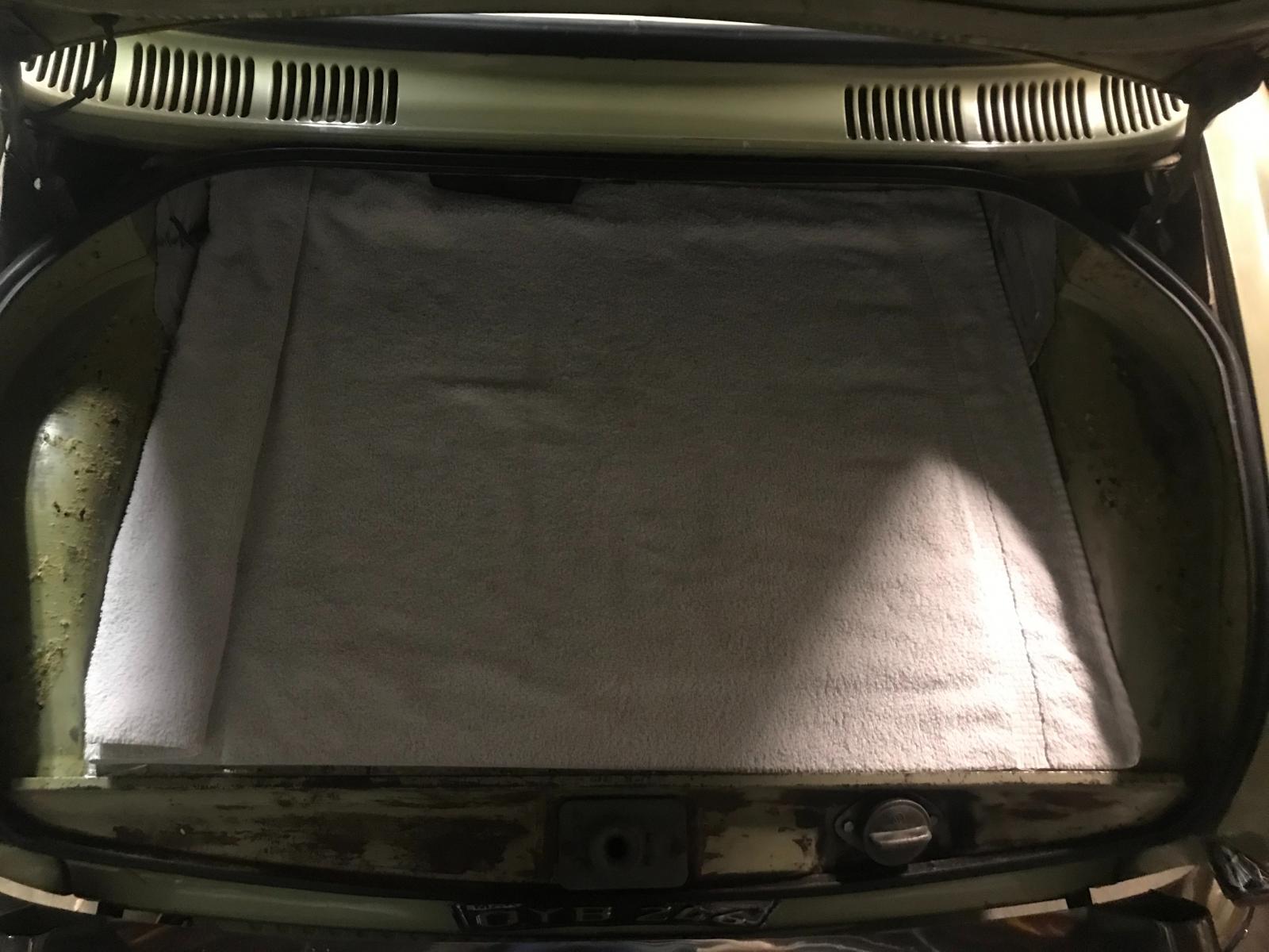

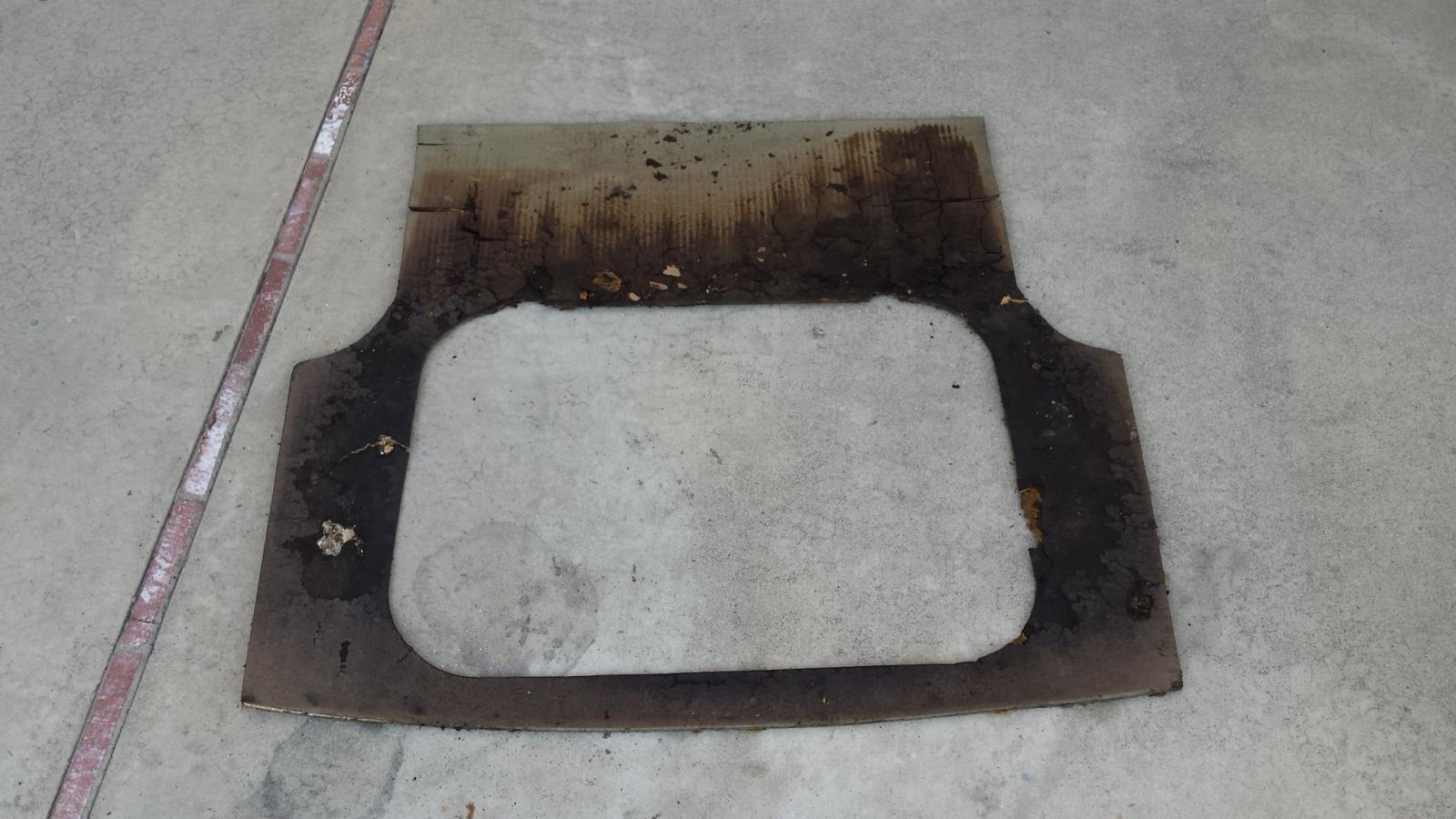

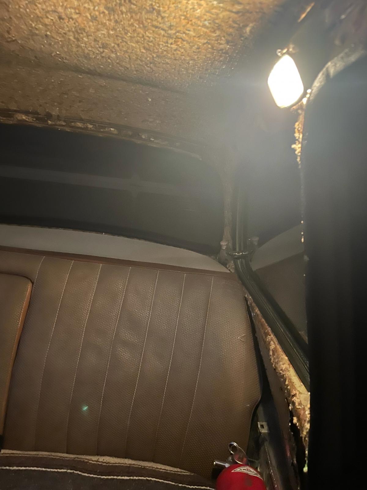

Still doesn't look great but it looks better than having that foam in there. I laid some towels down in the rear just for my own personal liking to make me feel better till I get the rear trunk all made new.
That is the next project and I should have that done to show for the next update. I also plan on making the motor look just that much nicer as I plan on zinc plating some linkage pieces and installing an NOS fuel pump cap that I got from Mario. Anyways, here are some photos I took on a little drive I took with a friend of mine down in Laguna Beach today before we get some rain here in Southern California.

Super solid project car- always dreamt of finding a Notch in similar condition but it never happened. Guess I am destined always to be a Variant guy, which is fine.
Tip on muffler installations- leave everything loose- including heat exchangers- till everything is together. This approach saves many needless headaches. If you are replacing only the muffler, new gaskets at the heat exchangers ain't a bad idea anyways. Wink

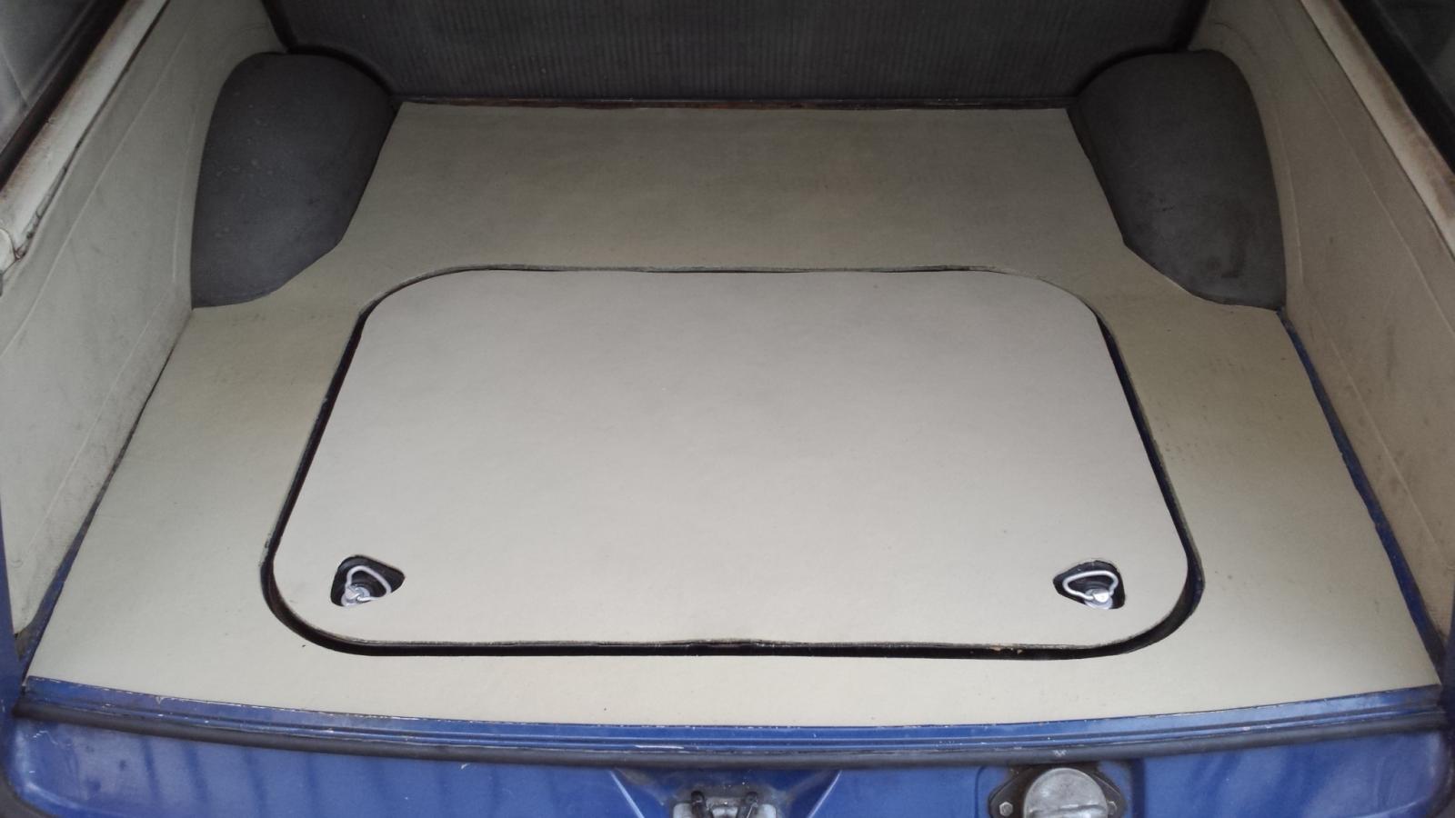

Looking really great, Ky! Shouldn't be too much to do a new trunk liner.
