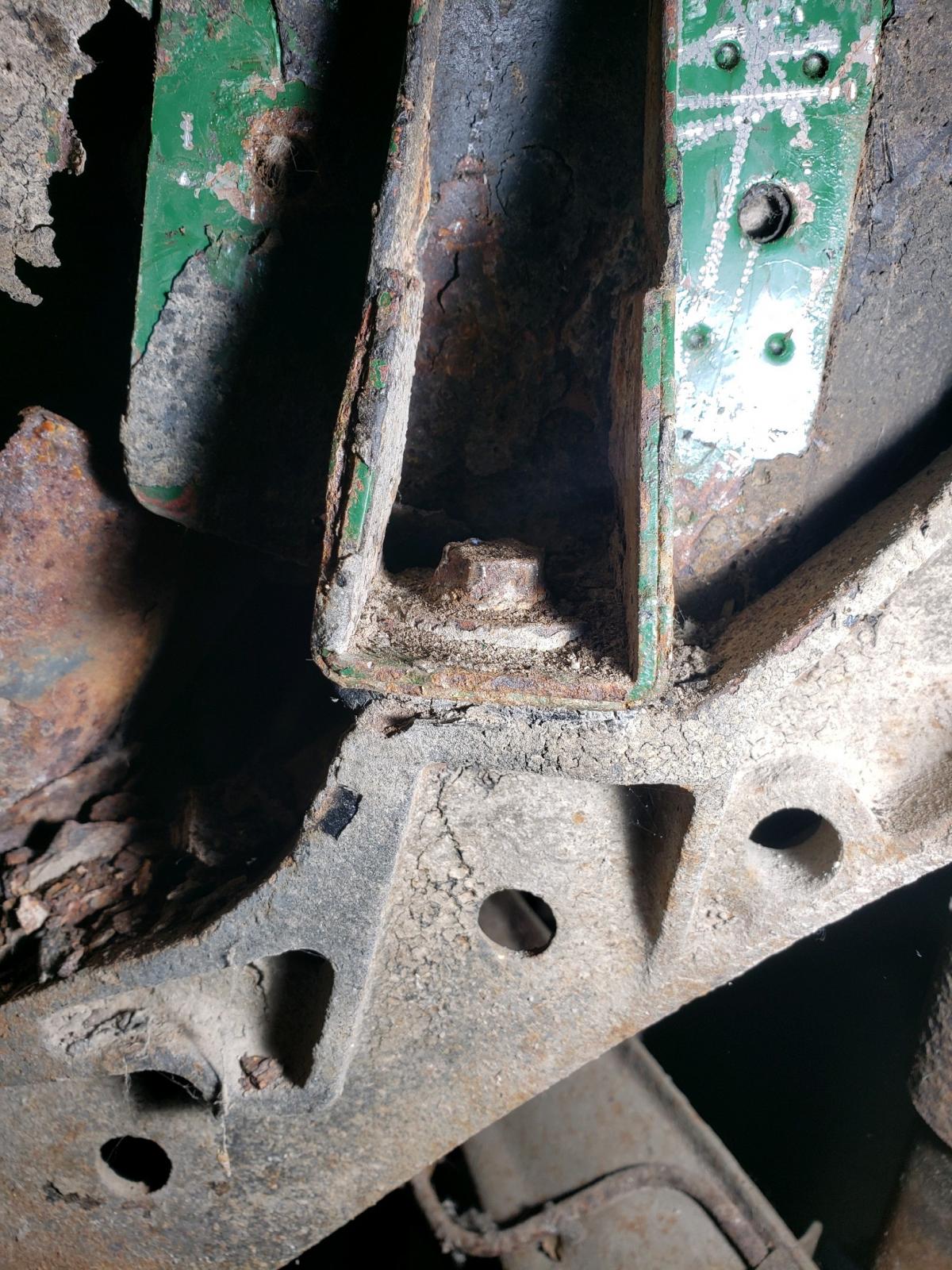

Well, good news bad news. I finished my sawhorses. I can get the body off! Yay! Oh wait!!
Bad news, the left rear body mount bolt is STUCK!
I thought I read it was a 17mm? This one is 15mm, maybe 14mm? I believe it has been on for 40+ years.
I stopped trying and decided to call it a night when I started to feel the bolt head "rounding" while using my 6 point socket.
What can I do to get this off? I haven't even tried the right side yet, but it does look better. I am soaking them in Liquid Wrench as we speak, and will attack with a vengeance tomorrow... Ideas??
Wire brush it clean, try some other wrenches, heat it with a torch, these are all what I am going to try. I read here where someone even melts candle wax on the hot threads to loosen 'em up a bit....

PostPosted: Sat Nov 16, 2019 9:27 pm    Post subject: Re: Help! My rear mount is stuck and I can't get (my body) up!! Reply with quote
Drill the head off by using a 7/16 inch drill bit. Start with a 1/16th bit and work your way up.
Lift the body to expose the work ahead. Get a steel nut that will thread onto the remaining threads. Thread the nut as far as you can get it to go. Get a wire brush and clean up the top of the broken bolt and the inside of the nut. Get a welder, a MIG works really well for this, and weld the nut to the stud, starting down inside the nut.
By the way, use a steel nut that is not galvanized.
After the nut is welded and still red hot, take a socket and ratchet and remove it! Easy!

PostPosted: Sun Nov 17, 2019 8:38 am    Post subject: Re: Help! My rear mount is stuck and I can't get (my body) up!! Reply with quote
take a hacksaw and cut the body on both sides of the bolt and after the body is lifted off it will be easier to work on. Looks like you're going to have to replace that body sheet metal around the support anyway.

PostPosted: Sun Nov 17, 2019 5:32 pm    Post subject: Well, now my body is stuck!!! Reply with quote
I got the two, yeah, TWO rear body bolts. Yup, they both snapped....I'll have a busted bolt removal to look forward to on that issue.....
Oh, the four 17mm bolts in front edge under the pan, both sides? well, I was 3 for 4. Yup. They looked like studs, with almost NO threads. Guys, these bolts were TOAST!! 1 came out nicely, the others I've never seen bolts like those.
So I got all the bolts out (I tough, and had the ass end high in the air, with the sawhorses underneath, started to lower the jacks, and NOTHING! Argh! I forgot the four bolts under the seat...try again, almost, but still stuck...... ARGH!! I gave up. The boss said it was time, and I didn't argue. So, in retrospect, I THINK I know what I forgot... Yup, the 2 17 mm bolts on the front tunnel area.....OK SO i'll get them next time......
