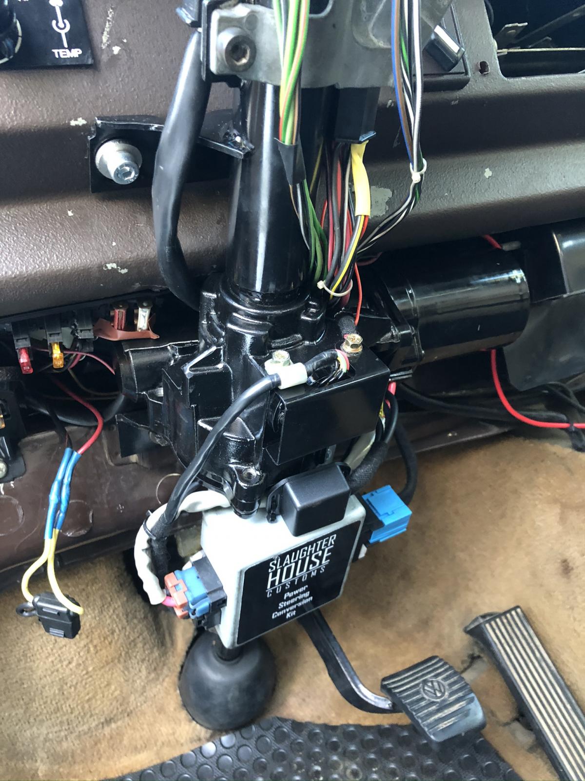

So one successful project for today was installing an electric power steering unit in my 85 Vanagon that has a stock power steering system full of leaks. I bought it off ebay from the below company. It was 473 GBP delivered to FL. It took maybe 2 hours to install and the only mods involve trimming the heater box and some of the trim pieces around it.
In terms of electrical connections, it is one wire to the battery and one to the ignition. All of the mounting points lined up perfectly and I am thrilled.
It is not connected to a speed sensor so it is the same assist all the time, but I think it works great and it should be very reliable. It also allows me to free up space in the engine bay by removing the pump, lines and tank.
If anyone is considering restoring their old PS or wants to add it, I would highly recommend this vs. replacing lines and pumps and belts and so forth.

Here are some pics of the install. I need to order a new steering column cover as the screw holes are busted out of mine. It includes a boot to cover the hardware once you trim the bottom cover. Really slick and neat install.

Looks really nice, do you have any more photos detailing the installation? What all is involved with the wiring? It seems pretty straight forward, I assume it comes with detailed instructions. Seems like a really nice kit, very well put together. I'd love to add P/S to my 82 van.

I completed the installation of the Slaughterhouse kit a few weeks ago and can heartily recommend it! Its a superb kit and turnkey.
We have already done a few extended trips and it is transformative to the driving experience. Having said this, some background for relevance - my '87 Westy had its PS kit removed two owners ago. It has a manual steering rack, power steering knuckles at the wheels (less leverage, harder to turn) and the standard PS Steering Wheel (smaller diameter). Effectively, it was a bit of a chore to park. With the Slaughterhouse kit and its automatic and variable assist, when parking the wheels can be turned with finger pressure on the steering wheel. At speed, no assistance is provided and the "feel" is as normal - actually improved as the one steering linkage in the column is changed to a universal joint. This actually tightens up the feel somewhat. When corning, the assistance comes on gradually and is unnoticed. I will say when parking, the assistance does feel somewhat over-boosted, however that is a very very minor note.
The installation was easily done in an afternoon - 4 hours which included modifying the center plastic fan cover and trimming the plastic on the fan box to accommodate the EPAS motor. The electrical is as easy as it gets - two wires - one to the column ignition switch and one to the battery.

I've just fitted the EPAS. OMG - should have done this ages ago! Mrs fxr is very happy. Very Happy
A couple of points for those who might be doing it in future:
The splined coupling at the base of the old steering column was seized solid on mine - I had to undo the two bolts that held it on (and *they* were pretty rusted too) in order to get it in a vise and gradually tap it off. 50:50 ATF and acetone helped here. Wink
Also, the splined coupling in the new universal joint was very tight - I had to open it a tiny amount with a chisel in order to get the new steering column to start to engage with it. Even then the new column had to be 'persuaded' with a large rubber hammer to gradually slide into place.
All together this took nearly six hours rather than the 2-4 hours suggested. But oh so well worth it!

It failed on me today - but easy fix. The crimped butt joint on the main feed from the battery failed on the EPAS side, right by the motor. Used a new butt joint, all now good.
It was a huge reminder of how *WONDERFUL* this modification is. No way would I ever go back. Smile
