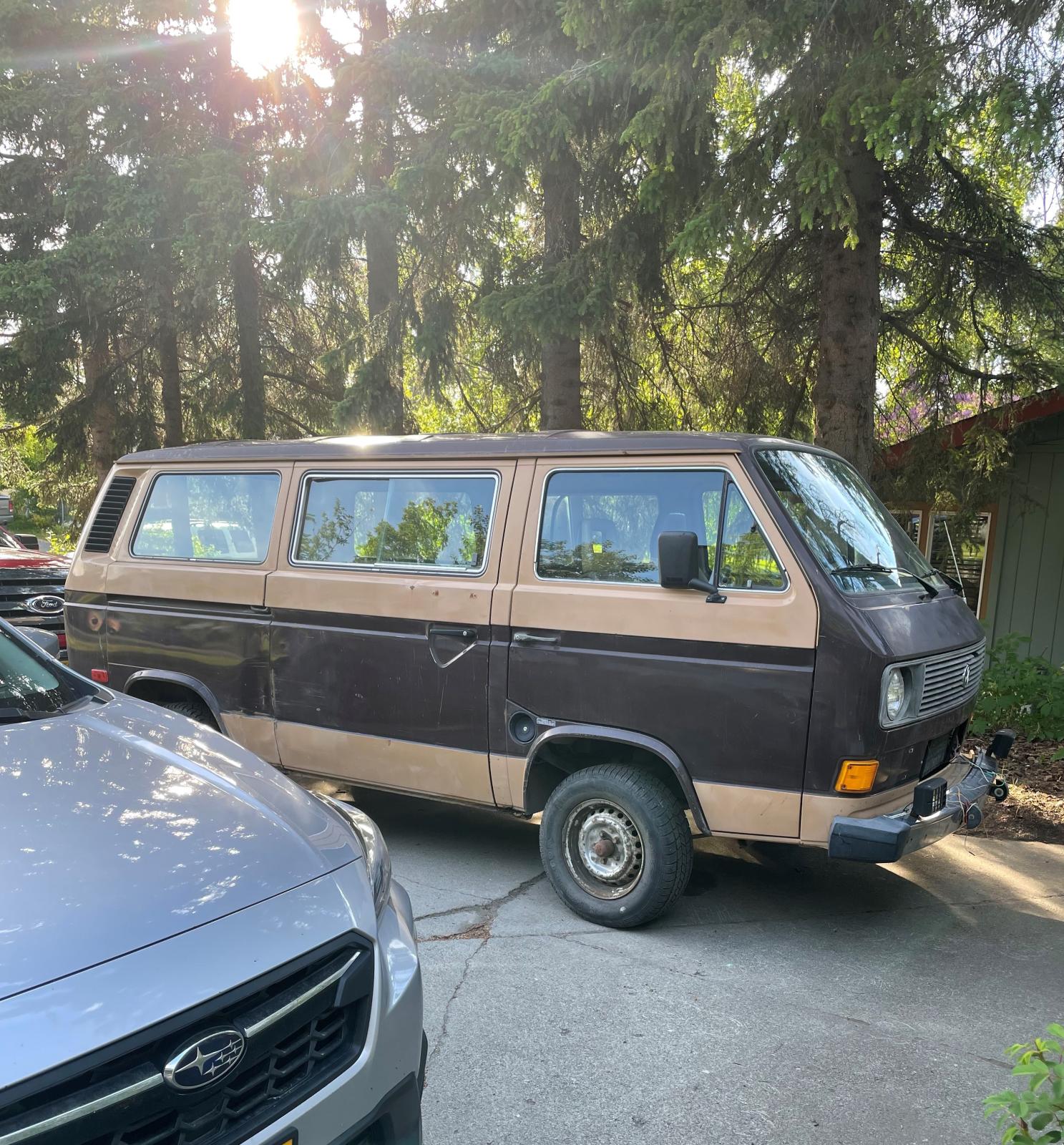

So, for better or worse, I bought the first Vanagon I looked at. Laughing
Here it is as I brought it home a few days ago.
I runs and drives, but I wouldn't trust it outside of the neighborhood at this point. Needs quite a bit of work before I take it on any adventures into the wilds of Alaska.
So far, I've rekeyed the front doors and hatch to match the ignition key. Next up , there's a tank seal kit, engine fuel line kit, plastic bulkhead fitting replacement kit, and various fuel tank/expansion tank grommets on the way from GoWesty. Next priority is brakes (minimum new pads and shoes and hoses and fluid flush), then sort out the janky dash wiring, then change the oil in the transaxle along with a complete tune up and cleaning all the electrical connections I can find around the engine. After that, suspension rebuild with powerflex bushings all around and new springs (leaning toward Schwenk but they seem to be out of stock, might go with Moogs and spacers to get a little bit of lift) and shocks. Then wheels and tires (hope to find some 15" steelies and get some Yokohama Geolanders.

Nice! Congrats, I like those two tone vans.
I see you got the list all set (my favorite part). Looking forward to the progress. Subscribed.
Do you have a garage or is this a summer mission?

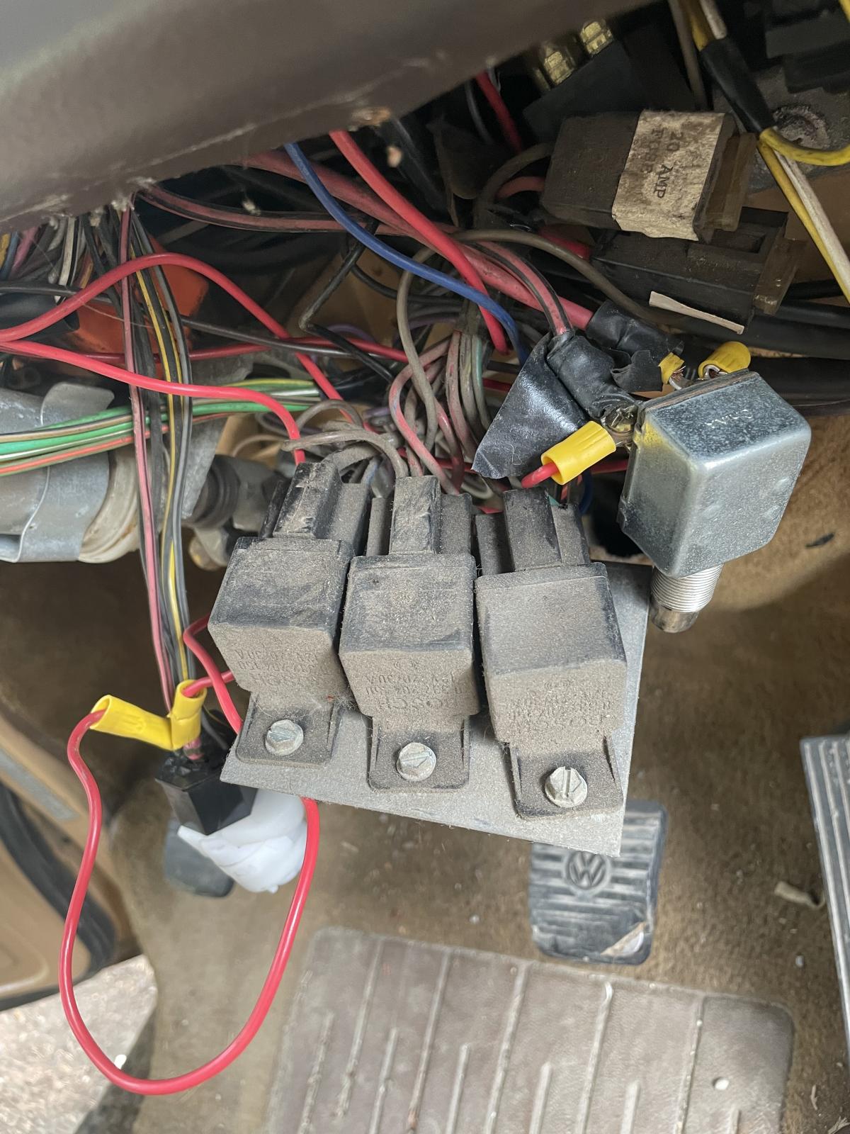

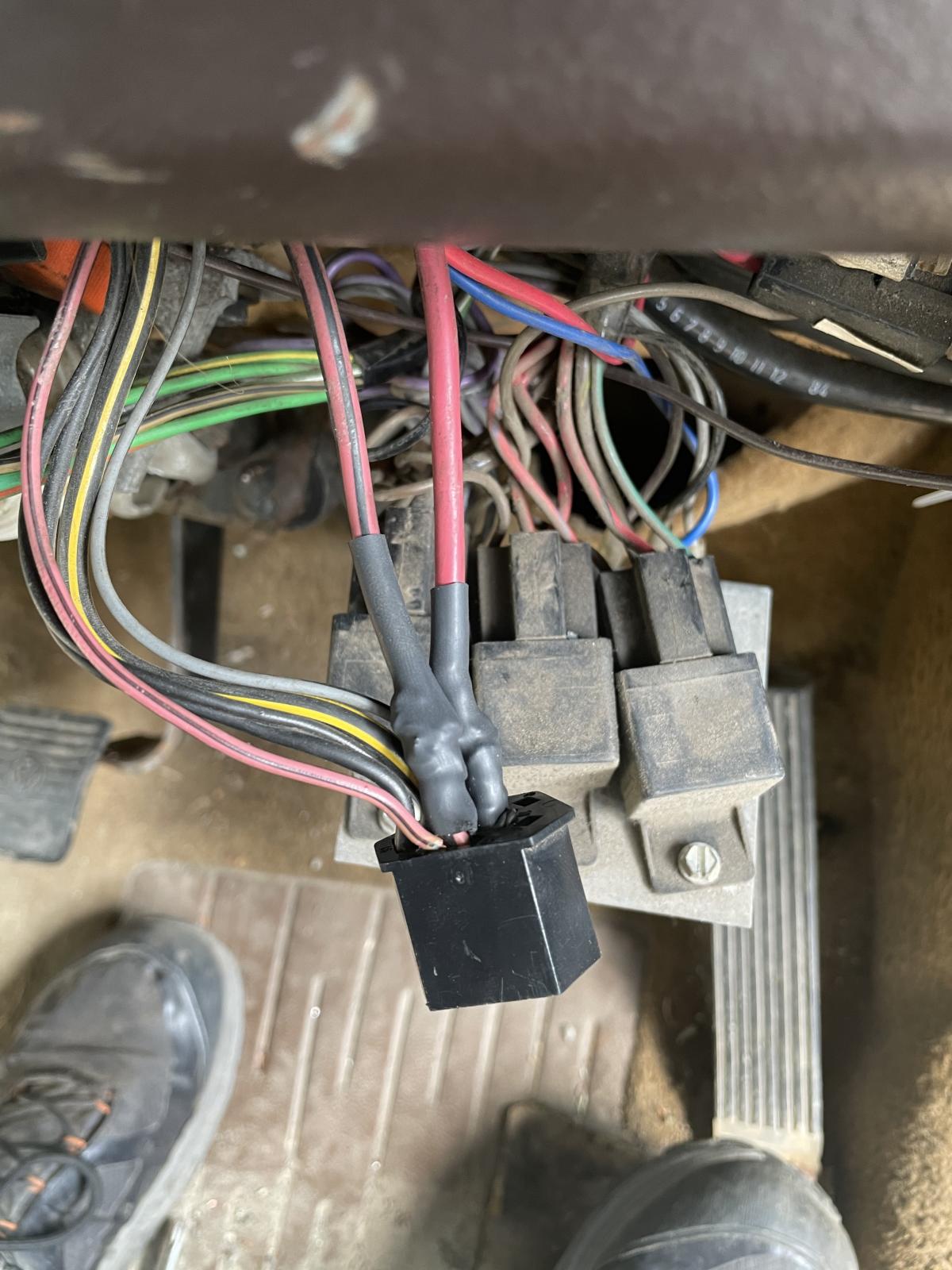

Today’s task is to try to get the dash wiring back in shape. A previous owner must’ve been a fan of Mad Max Fury Road and so wired in a couple of switches and a starter button in addition to the regular ignition switch. I’ve removed all that crap and soldered and heat-shrunk the wires back together.
Ignition switch now works like it’s supposed to.
In the interest of not pulling out stuff that’s supposed to be there, do these relays look factory? Or some aftermarket junk for fog lights maybe? They are wired to a non-factory looking rocker switch that is driving-off-fog ?
And I’m not a locksmith or anything, just followed the instructions in a couple of the threads here on how to reset the tumblers in the lock cores. Easy-peasy once I figured out how to get the cores out of the front door handles. It involved a drill btw.

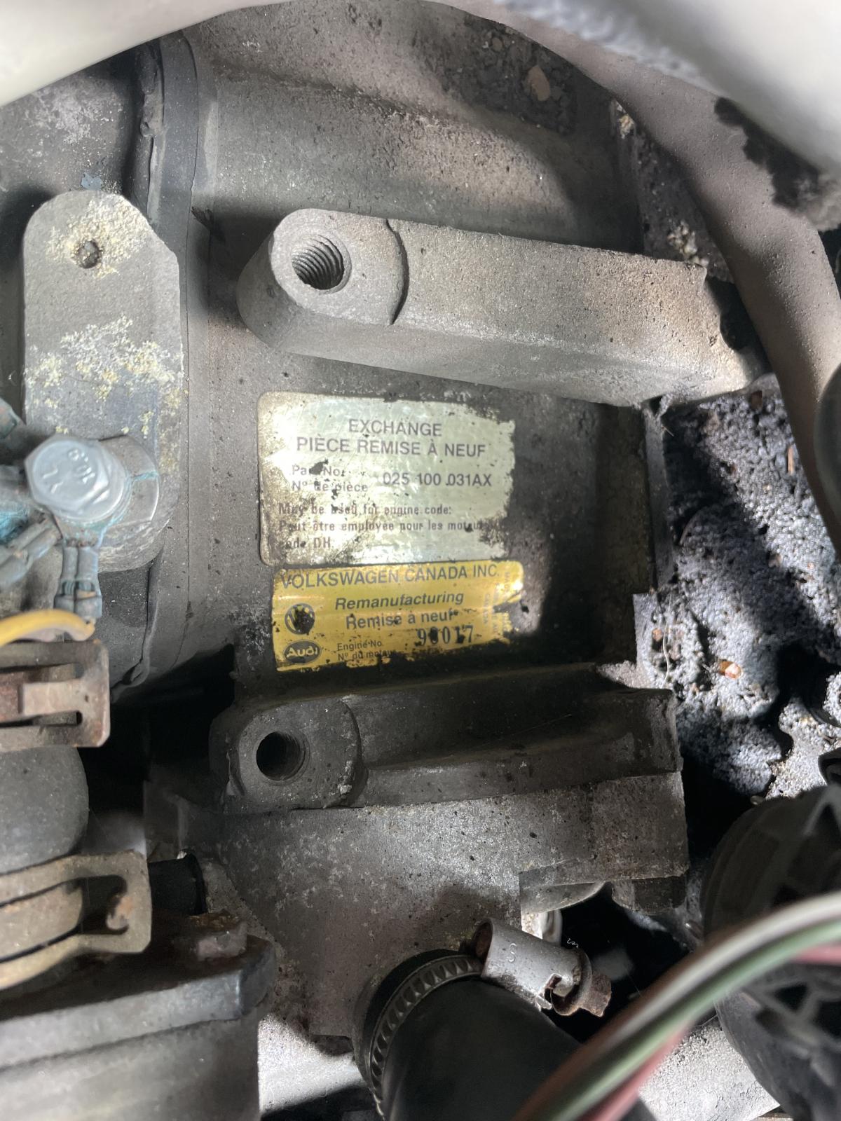

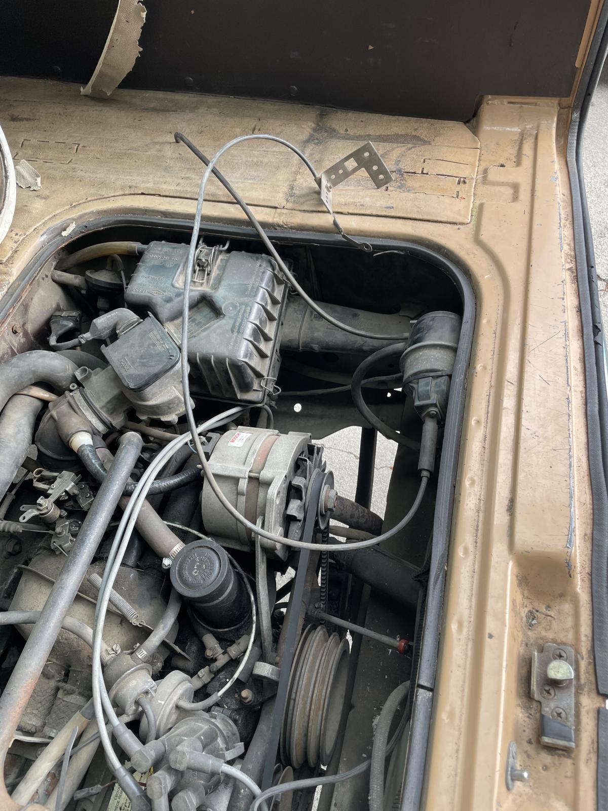

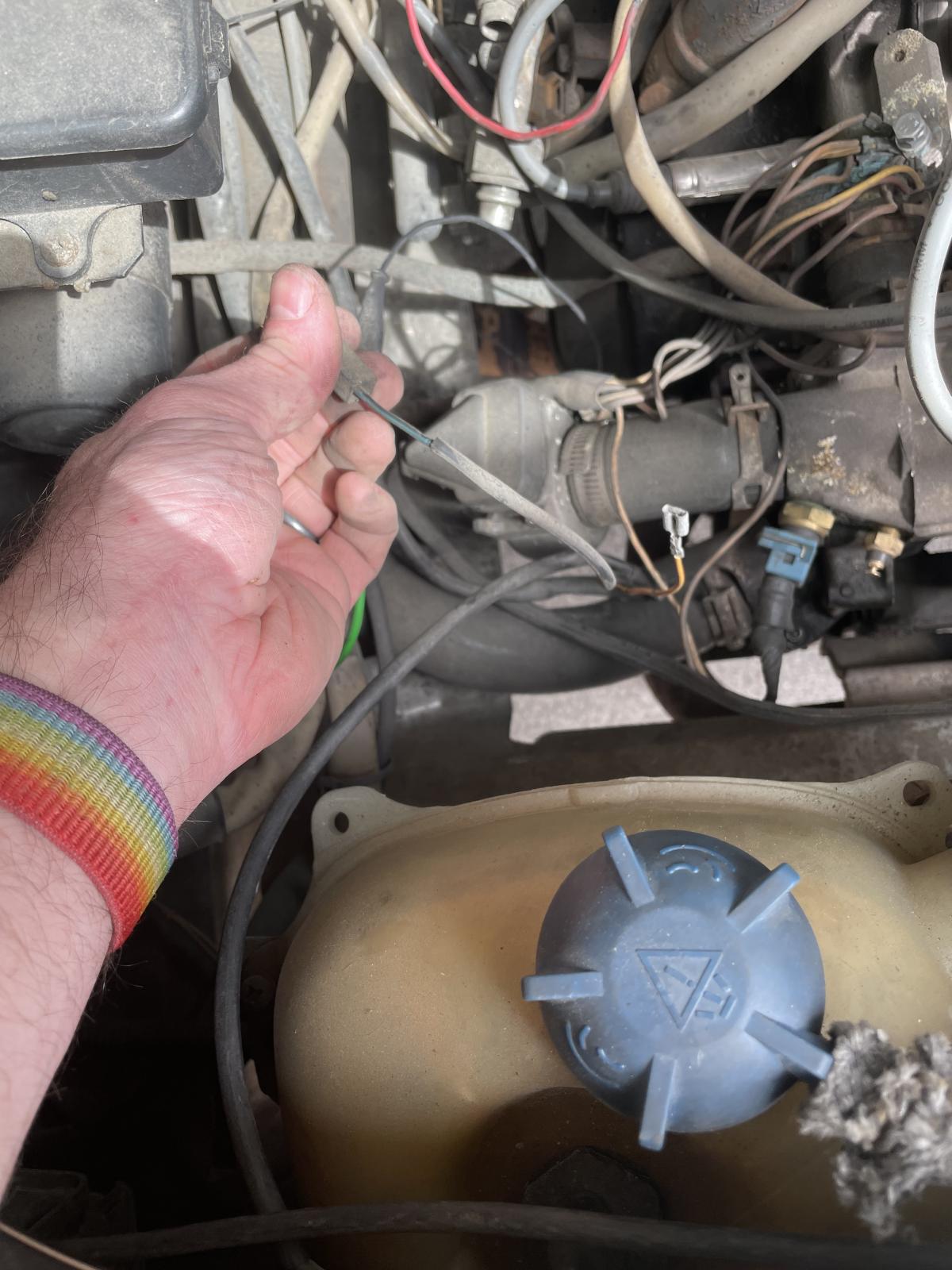

While poking around the engine compartment I discovered something interesting:
Also, a previous owner had wired in their own water temp gauge and tach running loose wires from the sensor through though the passenger area under the carpet up to the dash. I think the yellow/red wire is supposed to be connected to the coolant temp sensor, correct? What about the blue/black wire?

PostPosted: Sat Jun 19, 2021 6:08 pm    Post subject: Re: Does this mean I have to change my username? Reply with quote
I'd guess relays are: one for low beams, other high, third for fog lights.
1985 wiring diagrams show a yellow/red wire from coolant sensor and blue black wire from oil pressure switch on engine.
What year Vanagon? '85?
It took me about a million years before I started including my vans in my sig. Wink
If you search VWoC or VW of Canada you should find a range of opinions on those remanufactured engines. That info is likely in the stickies here.
If the PO wired toggle/push switch in parallel to existing wiring, there may've been an issue with the ignition switch cutting out intermittently. i.e. they didn't bother replacing the ignition switch. That job can be perceived as difficult but it isn't.

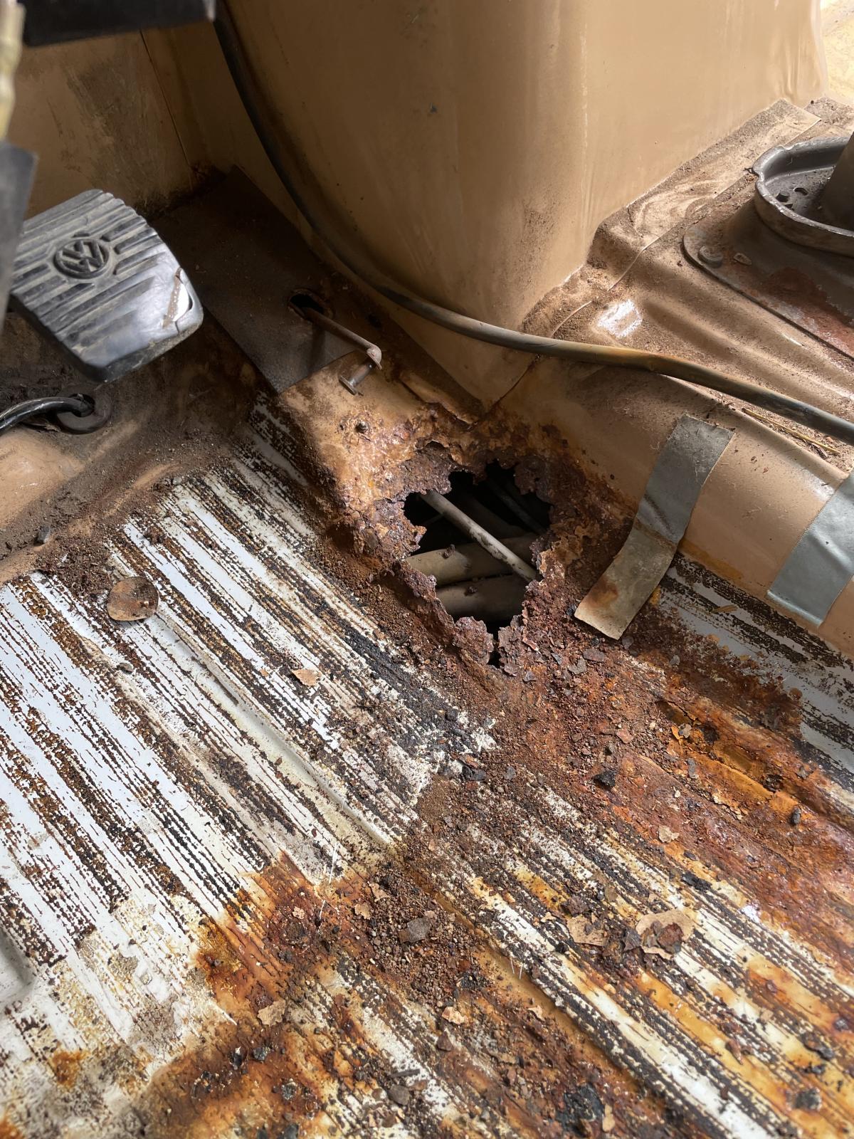

Well, looks like I’m doing some rust repair next week, too. 🙃
I also discovered that in addition to once upon a time having air conditioning, this van used to have cruise control!
Next work session I’ll try to figure out those three relays and get the oil pressure wire hooked up. Oh, and if you look closely at the pic of me holding the wire above the engine, you can see another aftermarket accessory that’s been added, a plug-in block heater! It’s kinda fun to see a little bit of the history of a car like this from finding all the modifications and stuff that have been added to it over the years. A little forensic mechanics?

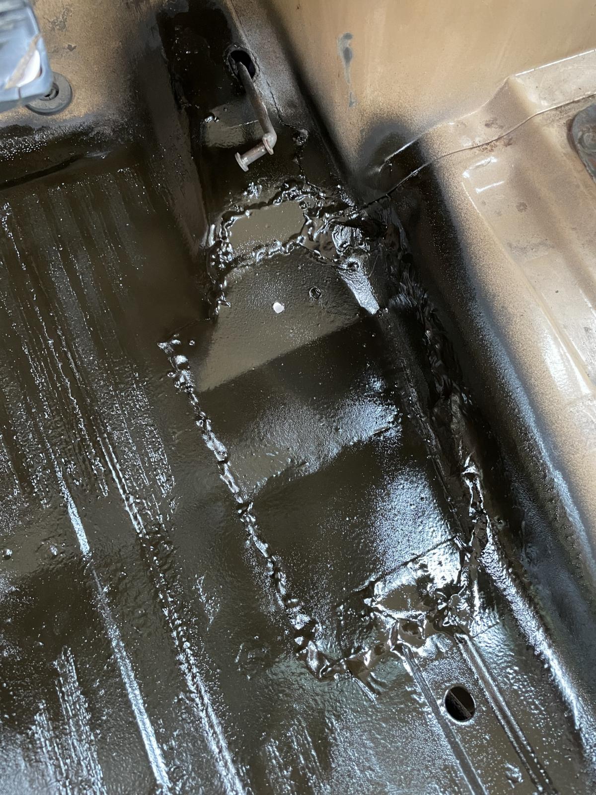

PostPosted: Wed Jun 23, 2021 9:15 am    Post subject: Re: Does this mean I have to change my username? (build thread) Reply with quote

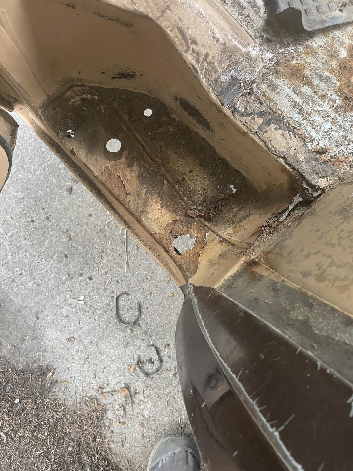

Today I'm going to try to tackle some rust repair starting with this. I found this thread:
https://www.thesamba.com/vw/forum/viewtopic.php?t=686138
showing a nicely fabbed patch panel with the correct contours and raised area where the pedal bolts down, but since I don't have any reference for those things, would a flatter, less 'correct' panel work just as well?
By the way, I plan on cutting out the rust back into good metal then cutting a panel (or panels) to fit as close as possible and then welding them in (MIG with shielding gas). And then painting and sealing with rubberized undercoating, obviously.

PostPosted: Wed Jun 23, 2021 5:16 pm    Post subject: Re: Does this mean I have to change my username? (build thread) Reply with quote
So it’s kind of a quick and dirty patch job, but it’s a darn sight better than what it was! The rest of the rust in the fender wells will wait until I drop the gas tank(s) for a reseal next week.

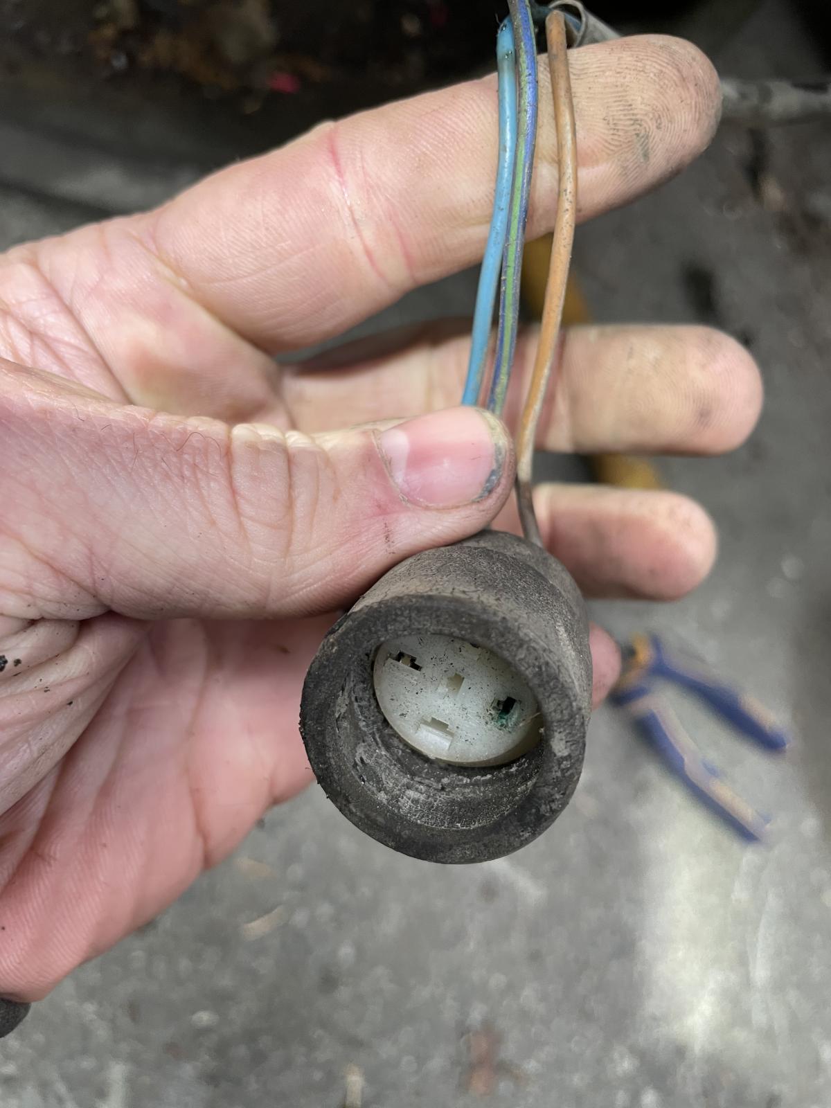

Today I'm working on continuing to straighten out the electrics including this plug I found yesterday while patching the floor under the gas pedal:
I'm having a hard time finding any corresponding wires in the diagram in the technical section on the site here. Any thoughts on where this should be plugged in? Could it be part of the defunct air conditioning system? Fog lights?
