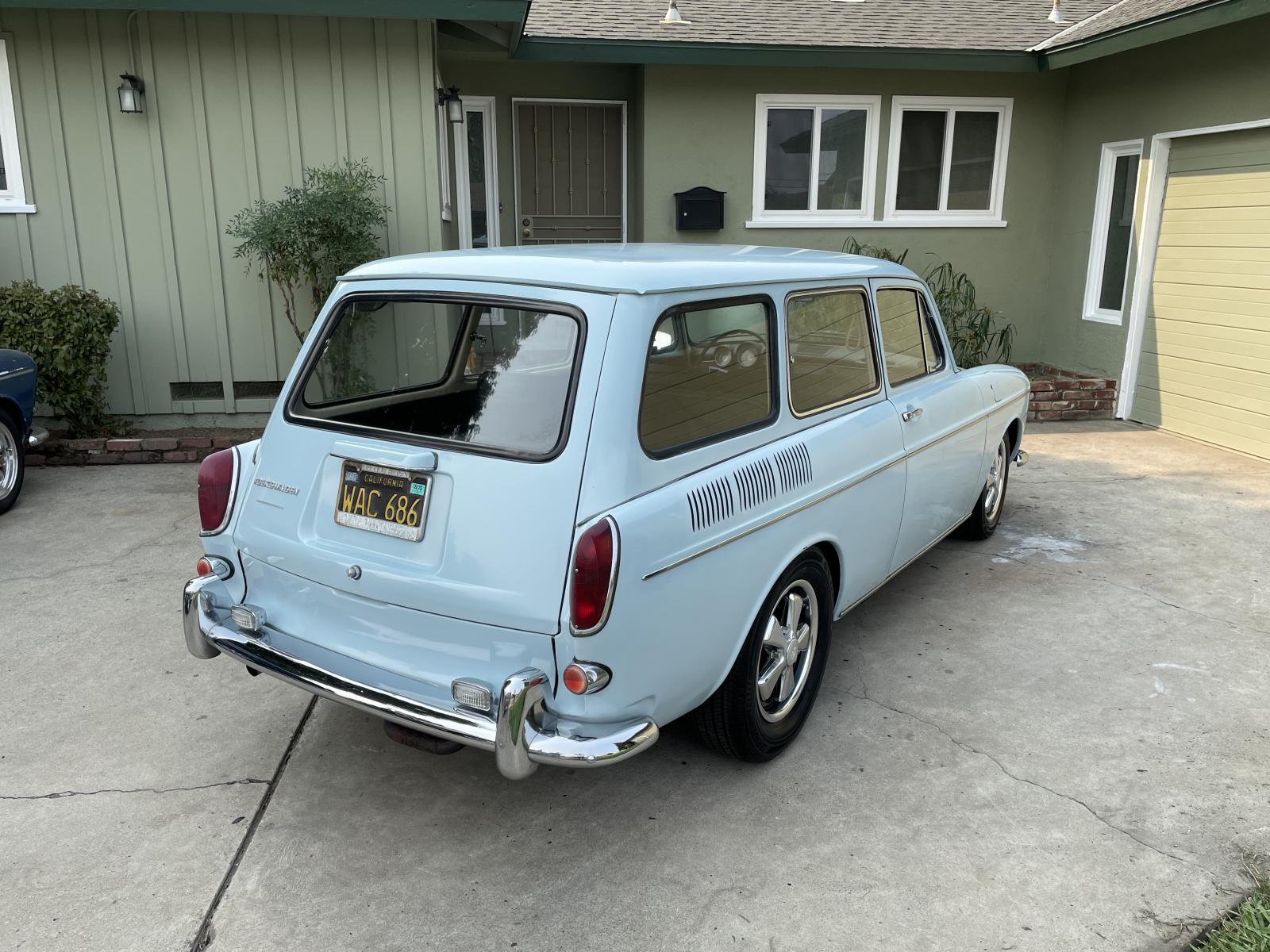

I`ve owned 3 Fastbacks, several Buses, and Bugs, and I currently own a Thing, and a 63 Bug project. but never a Squareback. Not by choice though. It just never happened..... until now. I wasn't even looking but this popped up on Facebook marketplace over the weekend. It looked familiar but the person that listed the ad wasn't the owner. They were doing it to help them out. After contemplating it for awhile, thinking things like "I don`t need it" and " I already have enough cars"... I called the number. It turns out I was right. I knew the owner fairly well. In fact I tried to buy it a few years ago before buying my 63 Bug project. But he wasn't selling. Now he was. I went to look at it the next day and couldn't say no. It`s a very clean 1968 Squareback that he had did a semi restoration over time. Repaint, new interior, rubber, refreshed engine with Solex carbs and rebuilt transaxle, and rechromed bumpers. It has the original black plates and dealer frames, along with service record and receipts from Vista Volkswagen in Goleta, California. My friend was the second owner. Its nice having something that doesn't need a full restoration for a change. I will be doing a few things to it like a slight lowering of the front, possibly a set of Fuchs, or Pedrini`s, a Berg shifter, and probably a smaller steering wheel (I`m 6'2"). But nothing crazy. Here`s a few pictures I took after I got it home.

Sorry, although I like very correct and original VW`s, and have restored a couple, I`m a Cal Look guy at heart. I cleaned and rebuilt the front end, and lowered it a couple inches. Put Porsche pattern disc brakes at both ends, and put on a set of Hans detailed EMPI Fuchs copies. And did my usual LeCarra steering wheel and Gene Berg shiter. After replacing the shift coupler and non existent shift bushing.

Looks really great. I live the rims, and the shifter. Looks really great. Going to leave the Solex duals on it?

Thanks, unless I build a bigger engine for it (With 40 Dellorto’s), I’ll leave the Solex’s on it.

Really love the look of your Squareback. Looks so original. I like what you have done to modify it subtly. I’m still looking for one over here in the UK. Hopefully one will come up as nice as yours!

Thanks. I`m a hardcore Cal look fan. But some things are better off left alone. More power would be nice though...
