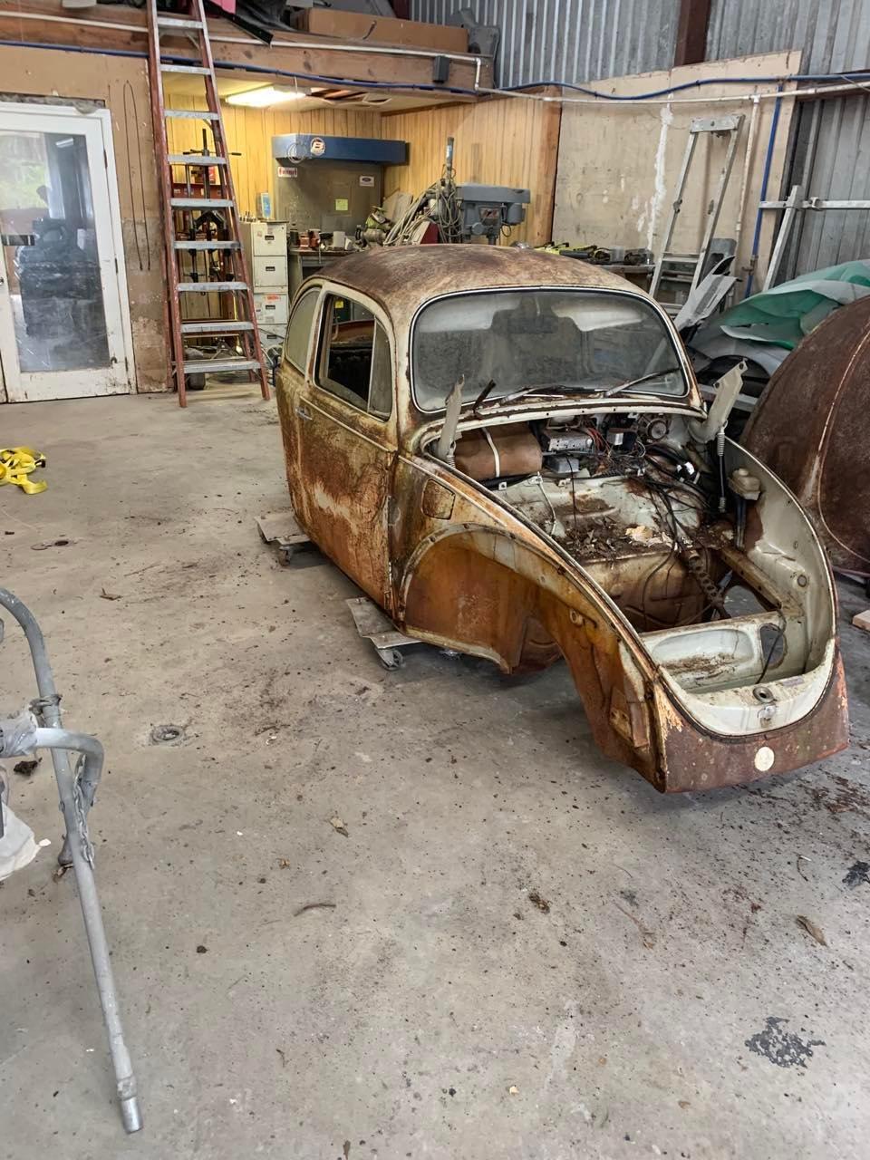

Just starting this body off redo. not for the purist on here. Plans are a Porcshe 5 sp trans, twin turbo Subaru 2.0 . Lots of work but I'm hoping to be done sometimes around mid next year, Surprisingly the heater channels are in great shape. rest isn't too bad. I own a body shop so the body isn't a big deal. Wiring the different motor and putting a Porsche trans and adapting it all together might slow me down a little. I'll start slow right now cause we have the holidays upon us but after the first of the year i plan on moving right along.

Plans are 2 in front beam. change over to 5 x 205 all around. disc fronts,dropped spindles.out back drop a little cause i want room for the widest tire i can fit. still not sure of what color to paint it or the wheel/ tire combo. but i have time for that.

Actually the rust is mostly on the outside panels . And not deep or through too many spots . Nothing I can’t handle with a little soda blasting . Since I’m changing it over to an early body most panels like the fenders,trunk and front and rear body panels will be changed anyway . I have 3 sets of doors off of other cars also

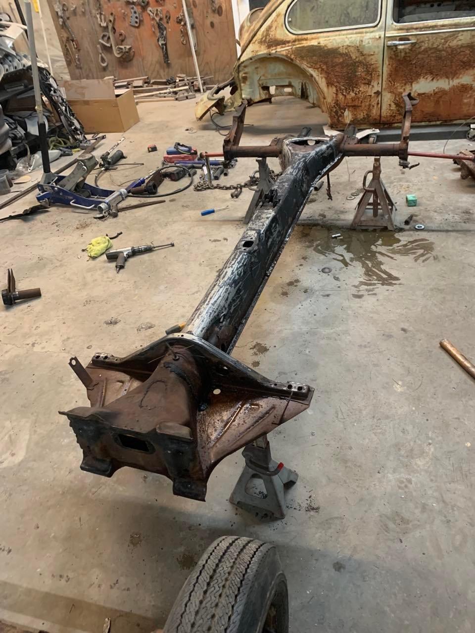

bruceo98
Joined: February 23, 2021
Posts: 713
Location: LA
bruceo98 is offline
PostPosted: Wed Dec 21, 2022 2:35 pm    Post subject: Re: So it begins Reply with quote
Ready for the blaster
