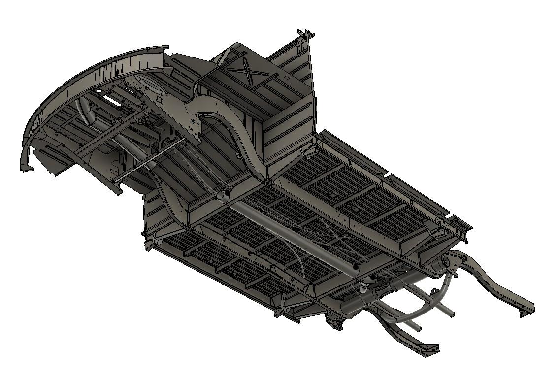

I decided to make a CAD model of my 54 while restoring. Found I was making drawings of the models to help with restoring/building parts. Having 1:1 prints of panels can be quite useful.
Putting all the time into creating models and drawings just for myself seemed like a bit of a waste so I started uploading them to GrabCAD after restoring the parts. Have had almost 500 downloads so thought a thread here for suggestions, comments, questions and experiences with the drawings would be helpful for insuring they are as useful and accurate as possible.

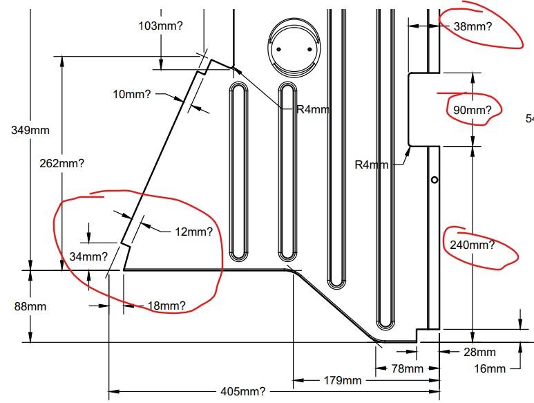

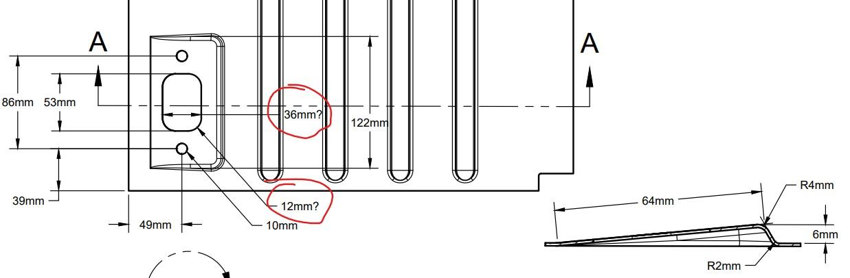

Looking for some details for 54 front floor panels. Anything circled in red. These are the bits completely lost on my 54.
Hoping someone can fill in some of these. I think they are close but want them as exact as possible before I share the drawings... and build my floor.

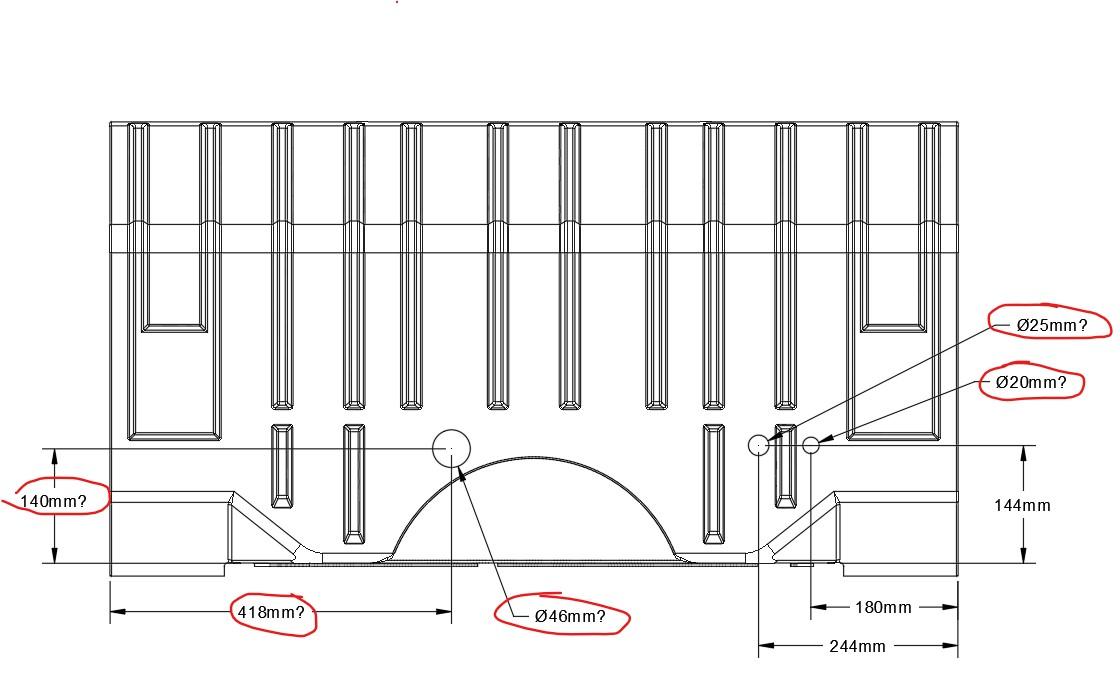

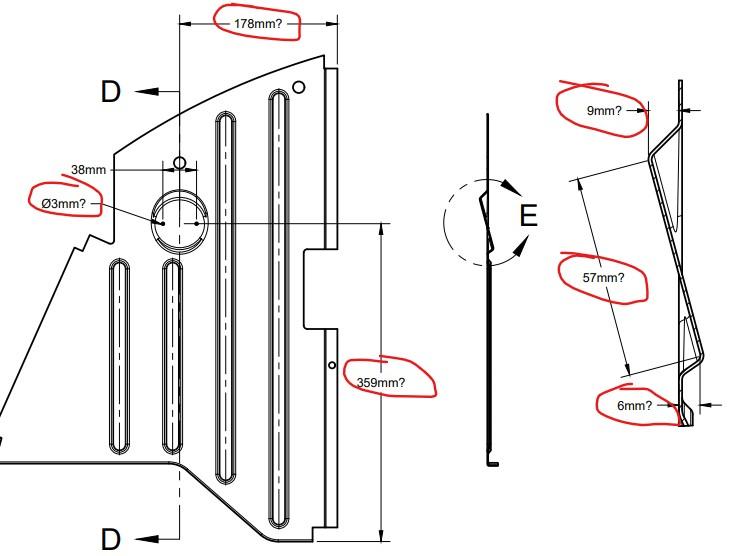

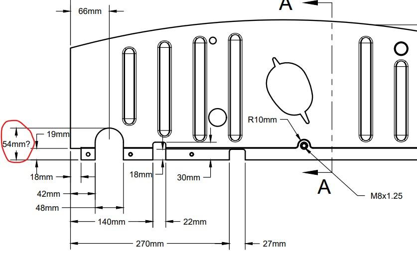

Looking for a few hole details on the transmission hump panel. Hoping someone has some original steel they can measure.
Also is the drain tube hole round on a 54?
